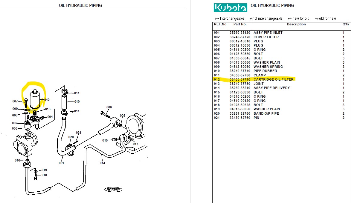

I'm having trouble locating the hydraulic filter on a L2002DT!
Hidden in the steering wheel? Haha
Seriously, where is it please?
Thanks a lot in advance,
Flow
6,999
2,464
Right side of tractor near your feet when sitting on the tractor.
There is probably a fuel filter and oil filter in the same general vicinity so you should be sure that you identify them correctly before you start
34,342
9,578
Give us a picture of the right side of the tractor just under tank and just in front of the floor boards.
