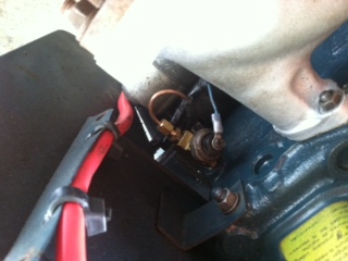

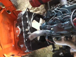

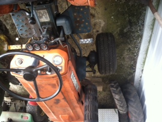

This is a very interesting thread to me. My B7100 has the thermosyphon system as well and is close to the same horse power of the L185/L1801. I installed a mechanical temp gauge near the top of the radiator just above the flutes. My temp readings slowly climb to 180 degree range with no to light load. I worked it pretty hard last weekend to see how the engine was doing following a complete rebuild. I hooked it to my neighbors rear mount 6ft mower and tried cutting some bermuda grass that had previously been cut 4 days earlier. I cut off about an inch of the grass. The temp gauge slowly climbed to 210 to 225 degree range. I know the mower is too big but I really wanted to give it a work out. The tractor was able to lift the deck without a problem and had plenty of power with no smoking or lack of power issues. I have 10w30 shell rotella semi synthetic oil in the engine, I put a tee fitting in the side of the block for the oil pressure so I could keep the light but also add a mechanical gauge. Cold it idles at 30psi and full throttle it has just under 60 psi. Hot pressures are 20 idle and 45 full throttle. When I reinstalled the engine, I purchased the antifreeze that was premixed at 50/50, I am going to get some distilled water and try to thin it some to see if the temp drops some
Steve NC
B7100D, L2900DT, ZD21, G6200,
Dec 29, 2014
89
Sandy Bottom North Carolina
I managed to get off work a little early and took some pictures of the B7100 gauges and and sensor locations.
The gauges are made by Bosch 1.5 inches in diameter from advance auto parts $29.99. I also purchased a copper tubing kit for the oil pressure gauge and a brass tee so I could keep the original oil pressure light.
