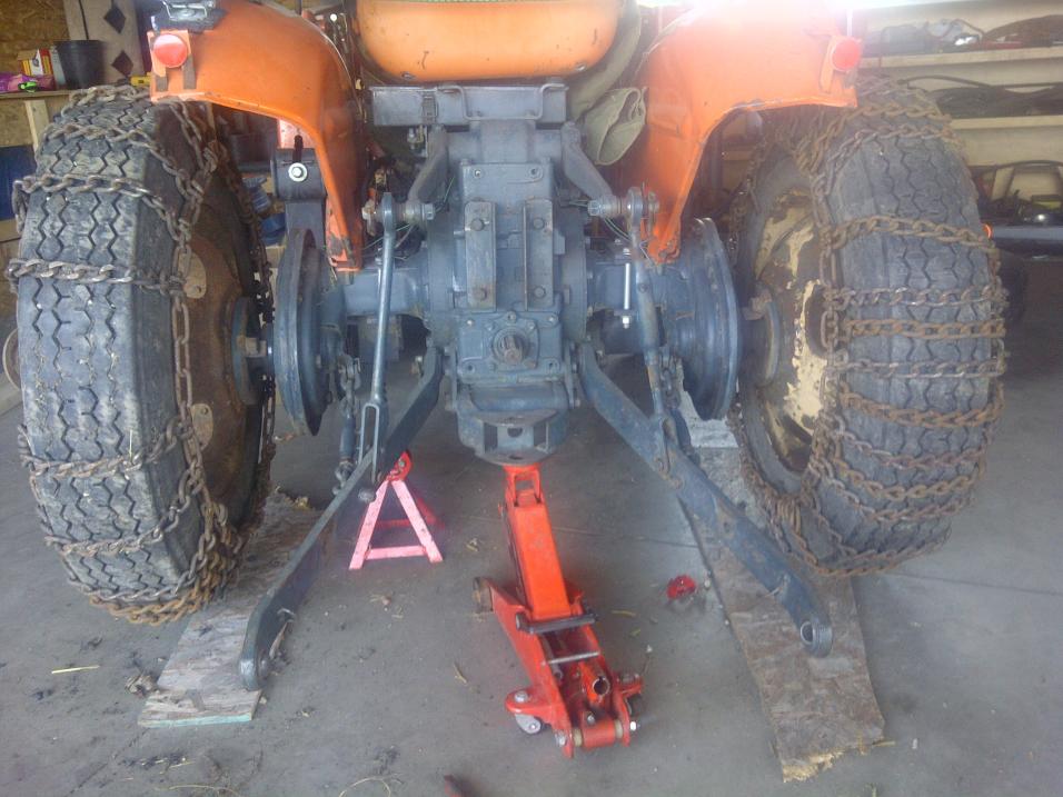

I wasn't getting the bite needed for blowing snow.
The rice tires were less than adequate at providing traction.
I found a set of dual ladder chains on Kijiji. $50
One set would cover 2 tires. They came off a semi truck.
I moved the "rungs" over to 1 set, gives me twice as many rungs per set now.
I put them on the rice tires and was greatly disappointed. The chains simply rode between the tire lugs rendering them useless.
New plan.
I bought a pair of milk truck tires from a scrap yard, $50.
Had a pair of plates fabricated with the proper bolt pattern and a 4.25 inch center hole. This is where the axel rides.
My Dad sourced the plates for me. He was quoted $125. Yeah well that was $125 PER plate....$258 later.
Welded the plates to the rims, drilled holes thru the rim, added tires chains.
AWESOME
All said and done it was $358 in material and a few hours of time.
Much better than the $800 as quoted for turf tires.

I had some tire chain left over from my tire chain project.
I was able to add an additional 12 rungs to each tire, went from 18 to 30.
Awesome!
I'm going to have enough traction to pull the world of its axis.
Tire on the right has the extra rungs.
34,343
9,581
I'm considering doing the same thing with a set of 8ply studded snow tires that I have lying around. I already have a set of doubled up chains for it.
Does it give you all the traction that you wanted?
