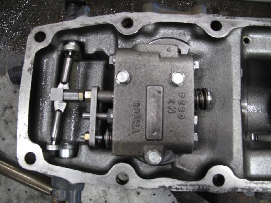

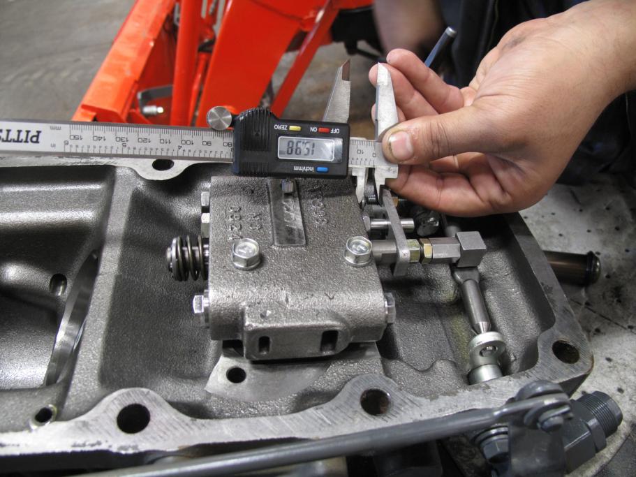

MEASURE your current installed adjustments before removal. Save measurements to restore new valve installation, if adjustment doesn't help. I'd focus on the relief valve adjustment but I suspect you'll have to replace the valve as that seems to be the universal solution. Something inside seems to start bypassing under load.
Here is the valve on the underside of the rear end cover...
Here is one measurement...
Here is another...
