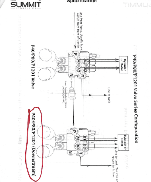

Now the next one. Installed the new Summit control valve. Got it to work, but the float function isn't working. I read the instructions and it said they set it before shipment. Guess they didn't do it.

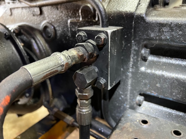

Second problem is now the 3 point doesn't work. I'm guessing I need to install a power beyond fitting and attach the second of 2 hoses that come from the block shown in the pic below.

I assume one hard pipe (at the bottom of your picture) is from the pump into that block. Then the other hard line in the block goes to the tractor and feeds the 3PH. Original cover was basically just a connection from one side to the other.
I further assume that the cover you show is the correct cover that now is basically allowing the pump outlet flow to be piped to the valve (Pin) you installed. That valve should then have a Power Beyond port that is piped back to the block on the side going to the tractor 3PH. That seems to be the top port on your block picture.
The block and cover are shown in this thread for reference
The valve should also have a tank return port that will need a hose run into the tractor case.
I don’t see that you identified the valve by name and number so please do that so the smarter people will be able to identify the ports of your valve correctly.

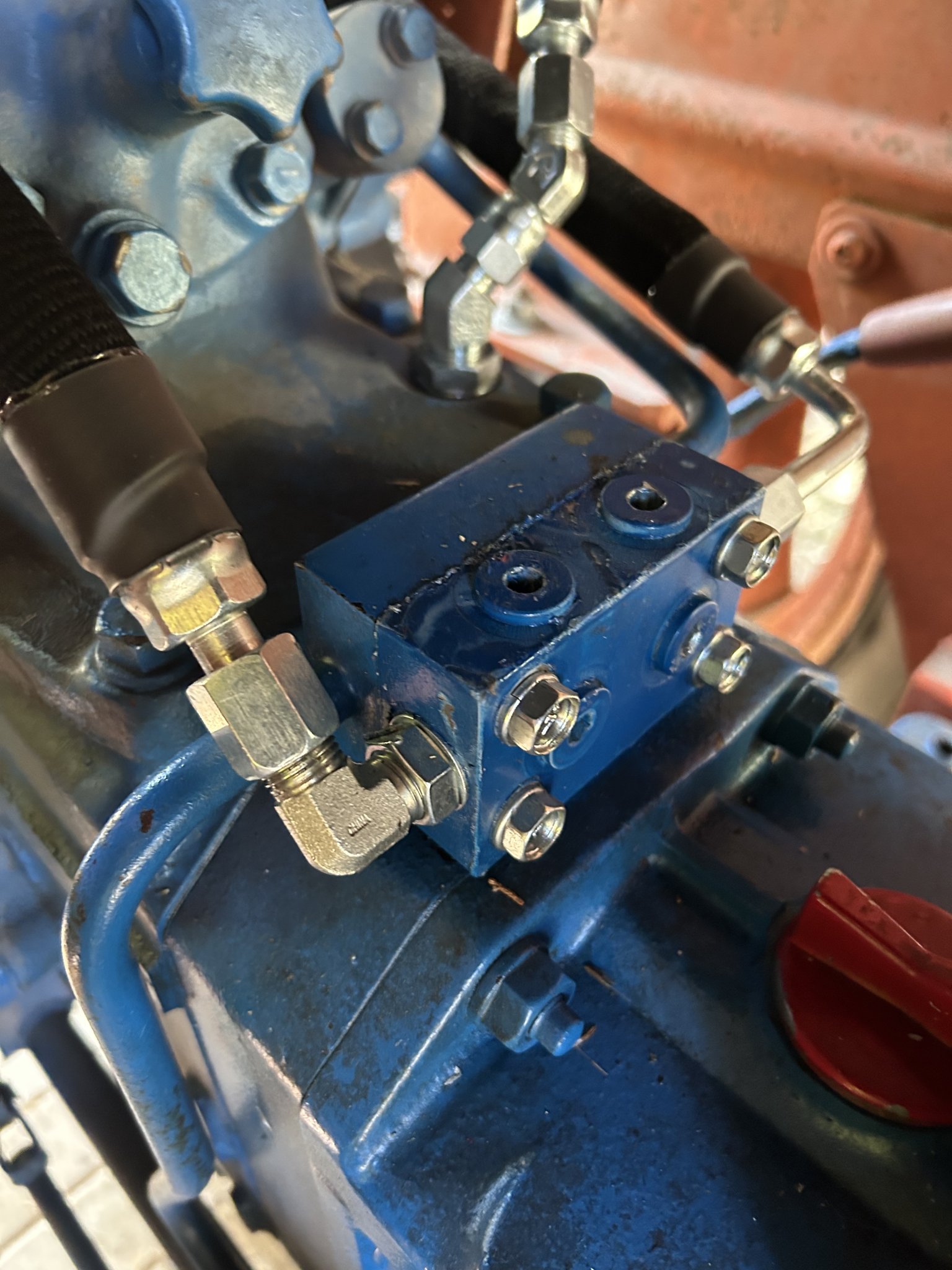

Here is a picture from my L185 showing the block and the piping. On the left is the hard line from pump. Then the left side fitting and hose goes to the rear valve Power In port. The Power Beyond from the valve is the right side hose (has the 90 degree hose end). Just underneath the hose is the hard pipe that feeds the 3PH from the power beyond hose ending with the round block with two bolts.
The 45 degree fittings just above the block are connecting the tank return from the valve back to the tractor transmission sump. I believe that your tractor has the same connection point near the 3PH speed control knob. I can find out what size that port was but it was G3/8 BSPP from memory.

Trying to keep this simple. The two lines coming from the block are hoses. I first hooked up the bottom one to the new control valve. FEL didn't respond so hooked up the other one that's on top and it worked. My assumption is I need to install a power beyond, hook up the bottom hose (now capped off) and that should restore the 3 pt. function.
Pic shows the valve I installed as per diagram including the return to line to trans case.

That outlet block came out of my shop so I know it well.
You need to hook OUT on the the outlet block to P on the Summit valve. I am not sure which of the two ports is OUT on your tractor but the WSM for the tractor will tell you.
Which brings us to the second hose and the valve. Did you purchase and install the power beyond sleeve? Post a picture of the new valve.
