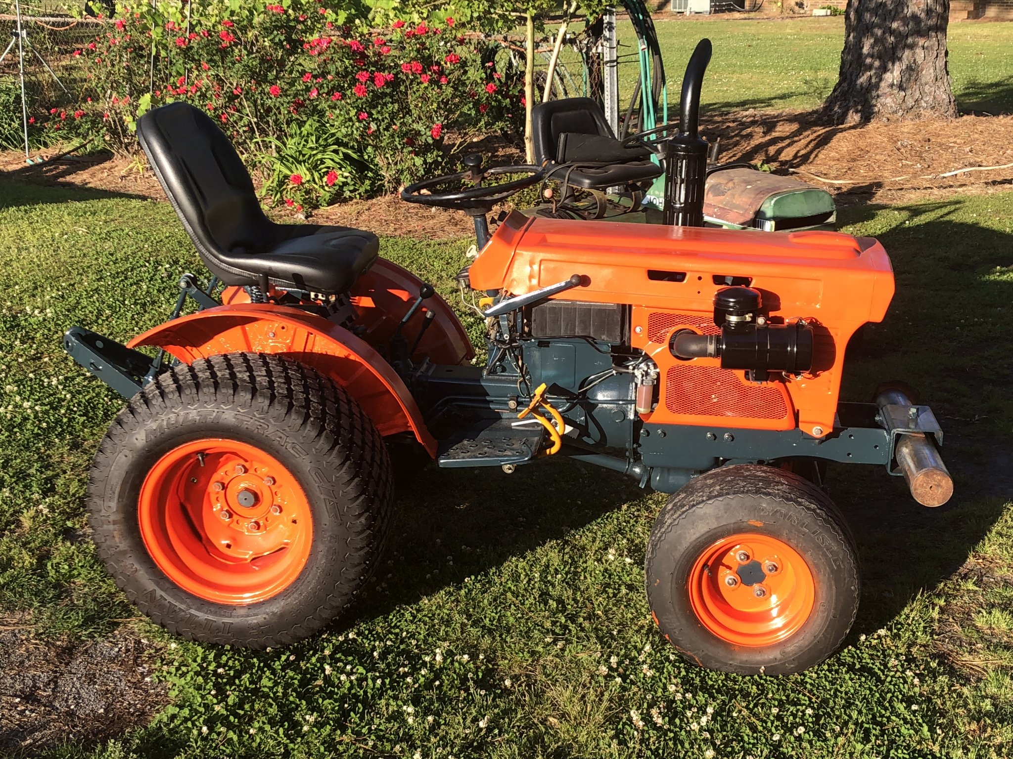

Repainted my B7100d 2 years ago with the rustoleum Kubota orange paint and then bought the blue for the engine frame and transmission from the kubota dealer. This tractor has mainly been parked under a shelter when not in use. One side is noticeably faded compared to the other side. I had some of the orange from the dealer as well and used it on the dash area. The orange colors matched then but now it still looks better than the side of the tractor that hasn’t faced the outside of the shelter. I’m going to repaint it this winter with the orange from the dealer.
