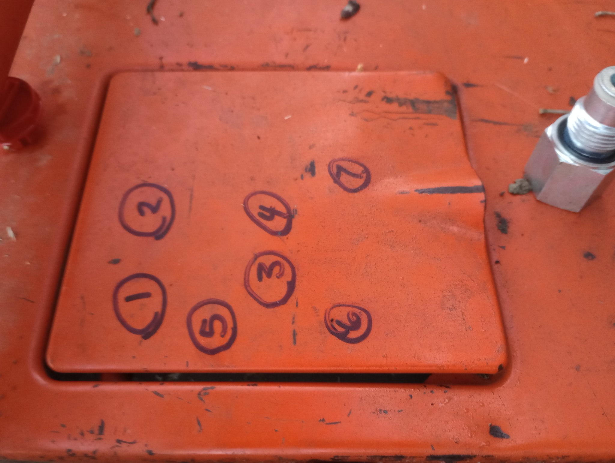

Stop making notes on the loader and label your hoses.
You are making this way too complicated. Here is a picture of the hydraulic outlet block on the side of your tractor. I have labeled three ports. Starting at that block follow each hose up to the other end and LABEL THE HOSES on the valve end exactly as I have labeled the ports in the picture. Once you have that done take one picture showing the labled hoses and come back for how to connect them to the new valve.
