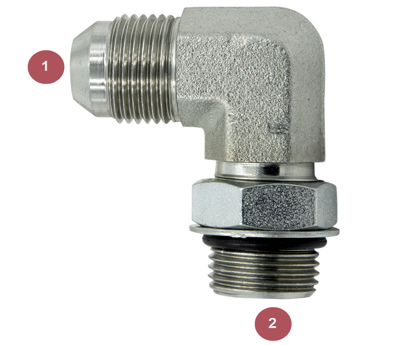

I wanted a time because they will not upload. Here is the picture of the actual part that is leaking on the end
Please - stop guessing and start listening. Your guessing is risking damage to your new valve. You need this fitting:
6801-10-08
There is still no sign of a power beyond connection on that valve.

I am listening Believe it or not. I tried hard to upload pictures so you would know what I'm talking about but they keep getting denied. I think this picture actually got uploaded. I'm going to order this right now and thank you

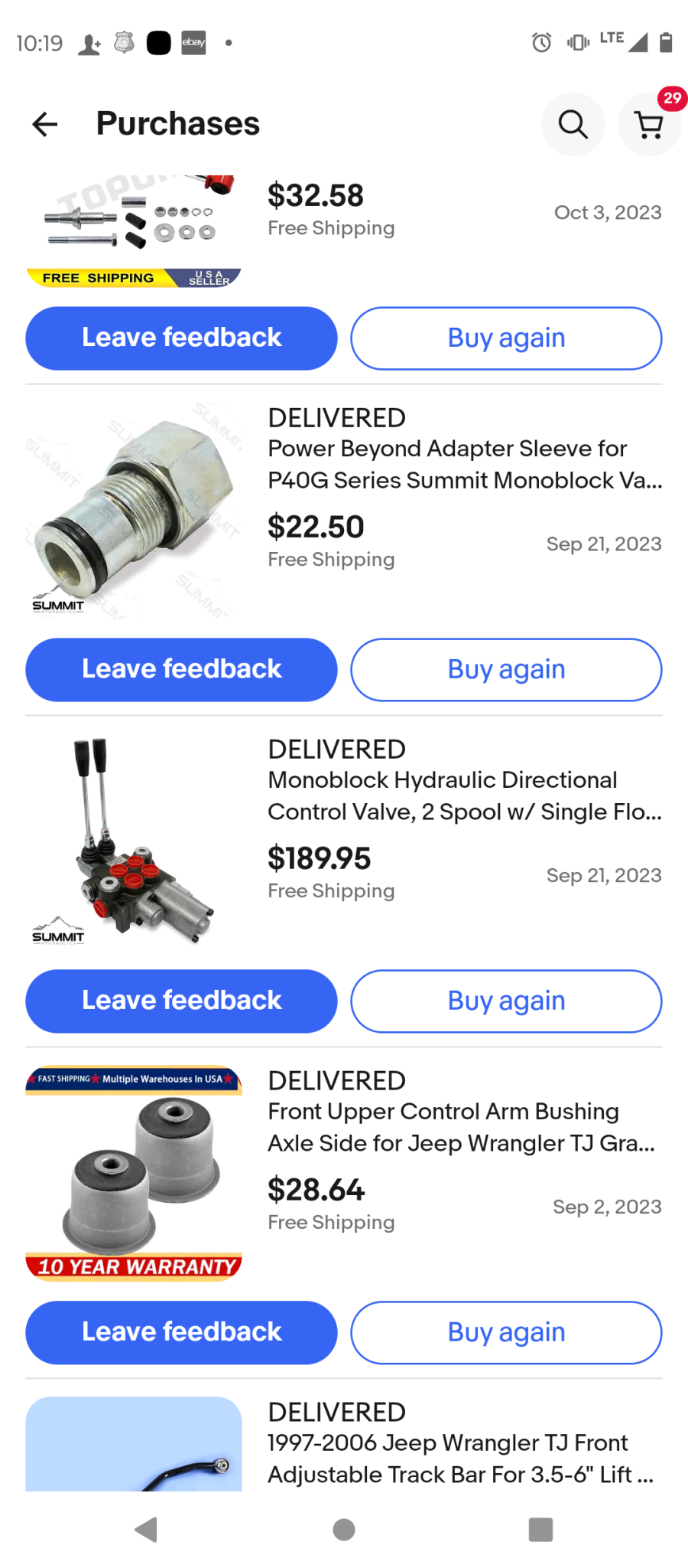

I purchased the exact adapter sleeve that you told me to purchase only I got it off eBay from summit hydraulics because I had to order the part on eBay because I talked to summit on the phone and they directed me to order the control valve on ebay. Directions on the control valve that I purchased the $249 item or however much it was said that the adapter sleeve went on the other side on the paperwork and that's where we put it. I purchased everything that you told me to purchase.

Here's a picture of my purchase history from eBay and it should be exactly what you told me to get. If it's not right, I'm going to have to fire you as my mechanic because you're the one I'm listening to. 😁 The only reason I got The control valve thing with two joysticks is because they were on back order for the thing with one joystick but you told me it was okay to do.

The PB sleeve goes in the N port. Look at your valve - thst is on the right. The port on the left is pump inlet.
