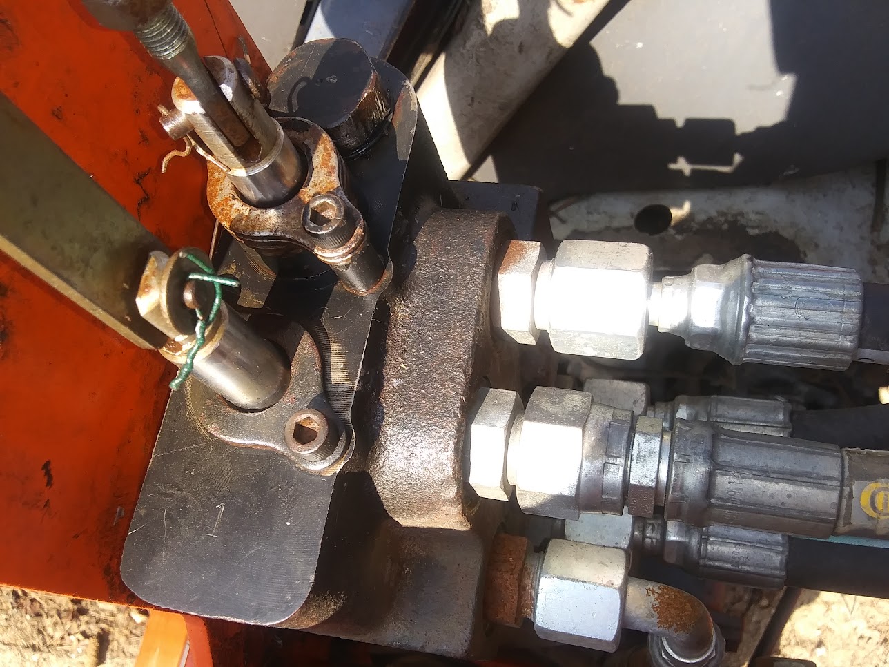

A picture of the leak might be helpful. The valve looks bone dry in the pictures. Based on what we have heard somebody has taken it apart at least once.

These are all the pictures that I can upload...there is a joystick and it goes down into three valves. The one in the middle (that you have to open with an allen wrench) is the one leaking.

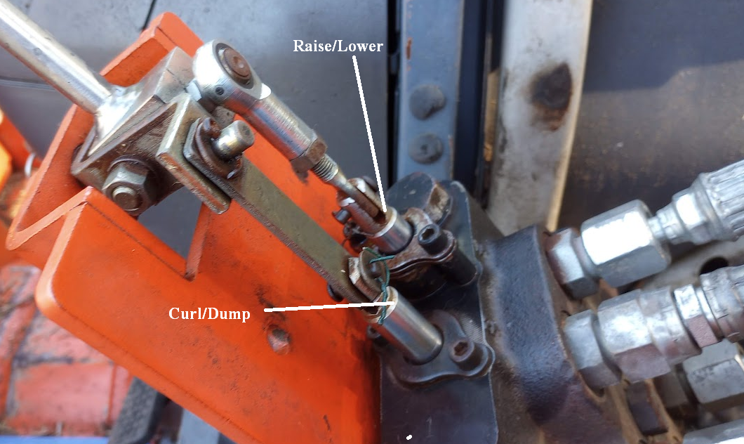

There are only two valves - I have labeled them in your picture.
I am beginning to think you have the plumbing messed up. Bucket won't curl makes me thing the cylinder hoses are reversed. Oil gushing past seals on the spools sounds like the tank port is being pressurized - like possibly connected to the pump!!!
I think you need to backup and verify the connection of the three hoses going to the tractor are correct.

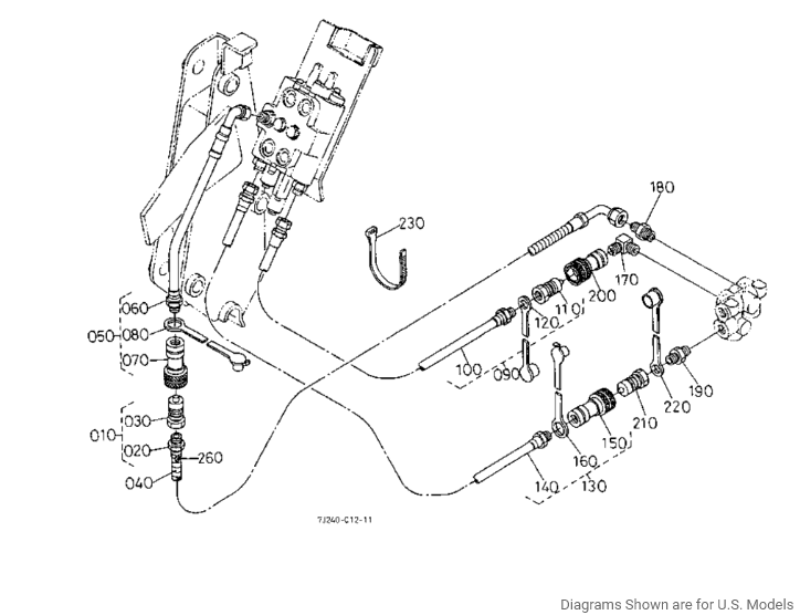

Here is the parts breaksown of the hoses going to the tractor. Make sure they are properly connected. If you have something reversed its going to play havoc with teh valve.

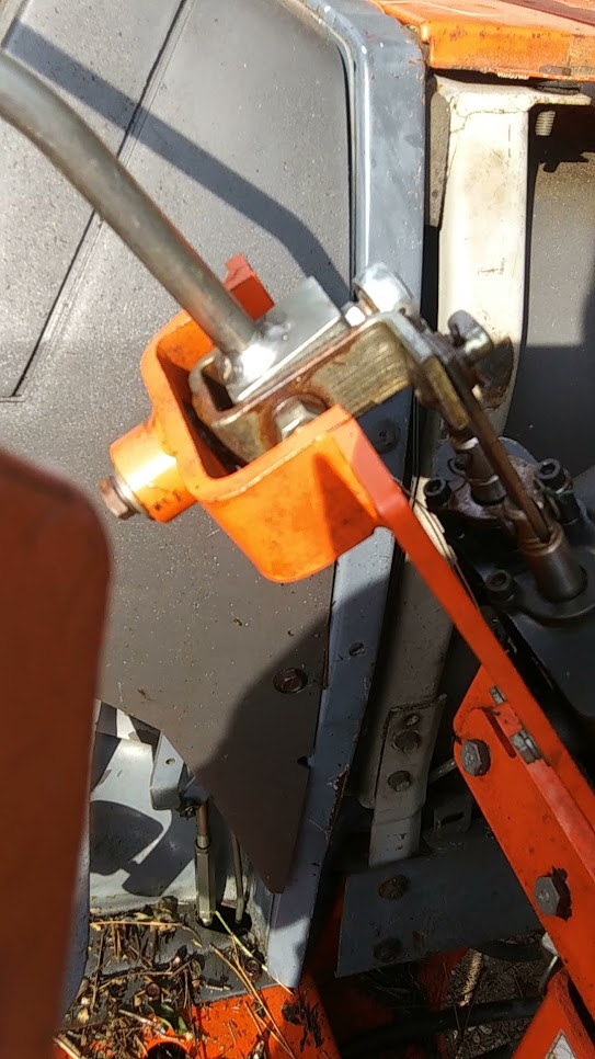

TheOldHokie is more than likely on the right path, but I see one small detail, I think. The end of the linkage with the adjustment should be perpendicular to the slot of the one with the fixed end. I have tried to show this with the blue line. As it is now, some side force is applied to that spool when the joystick moves it, which could cause some leakage. But this is probably not the problem if it leaks even when the joystick is not used.
