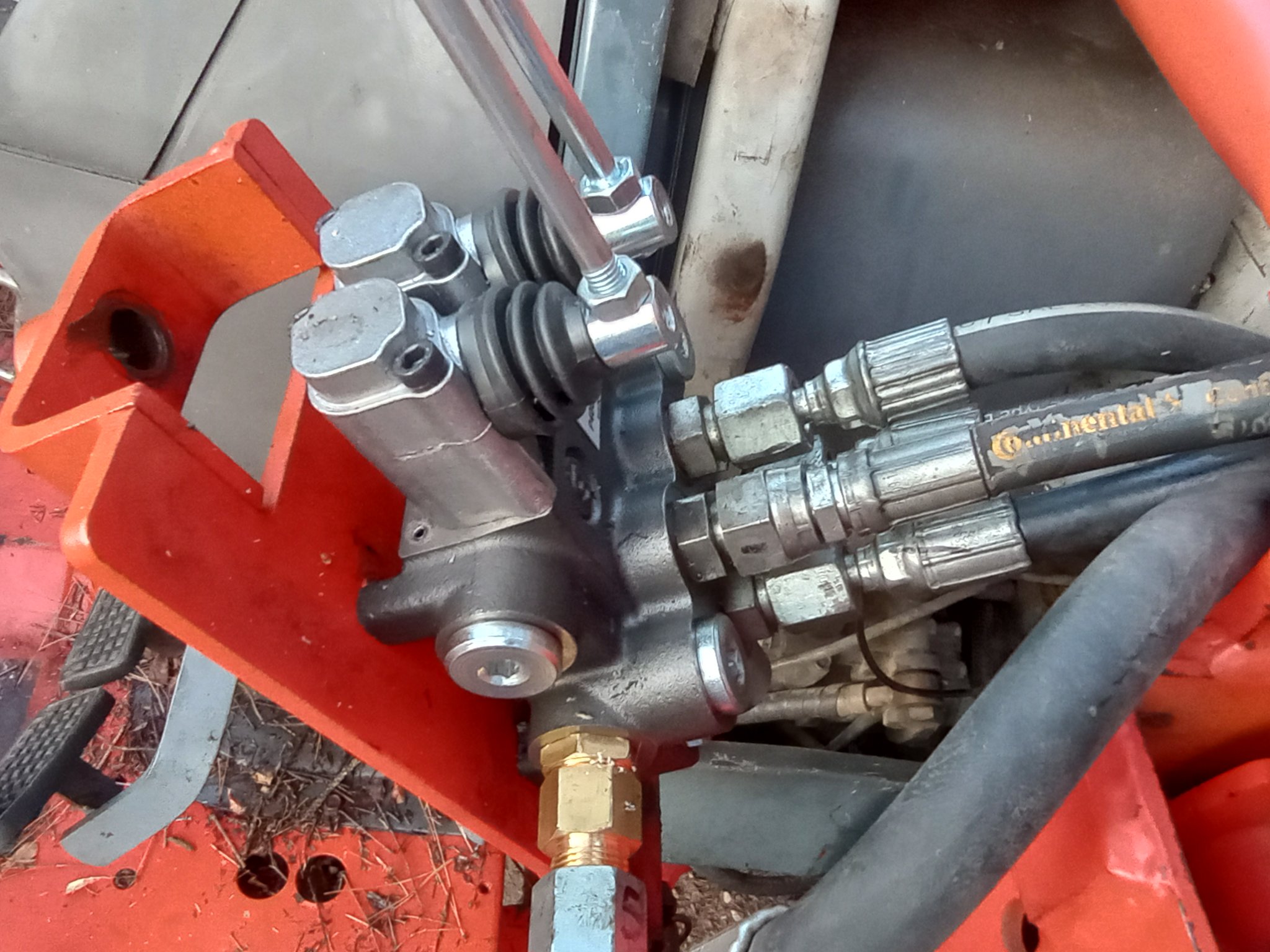

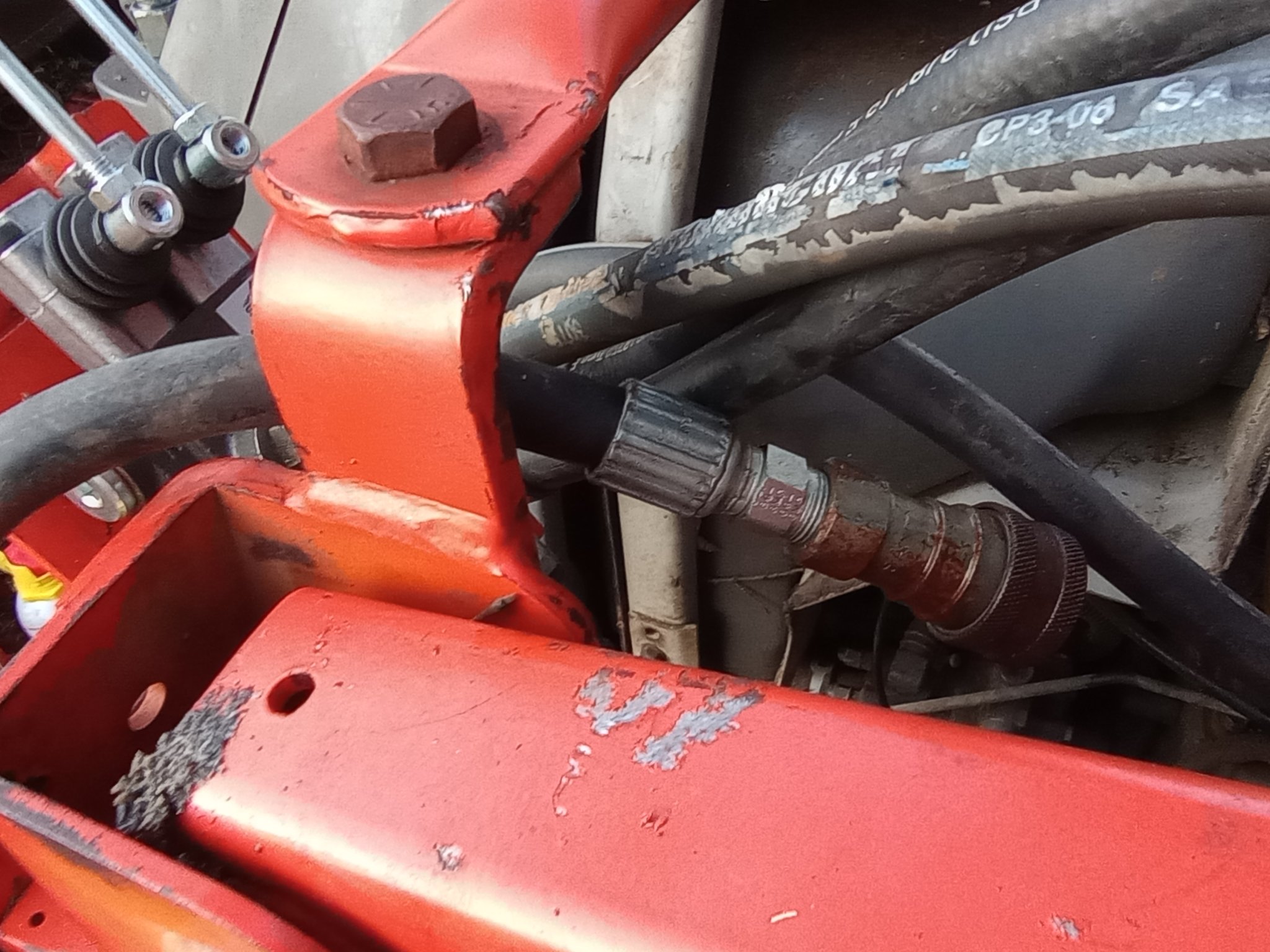

Instead of new hoses could you just get some pipe to extend the hoses? Trying to figure out why they don't reach.....Pictures please....
10,912
6,000
Here ya go
Did you try coming up from underneath rather than over top?
I believe that is also the power beyond hose and you have it connected to the tank port.
YOU NEED TO TRACE AND LABEL THE HOSES BEFORE CONNECTING THEM

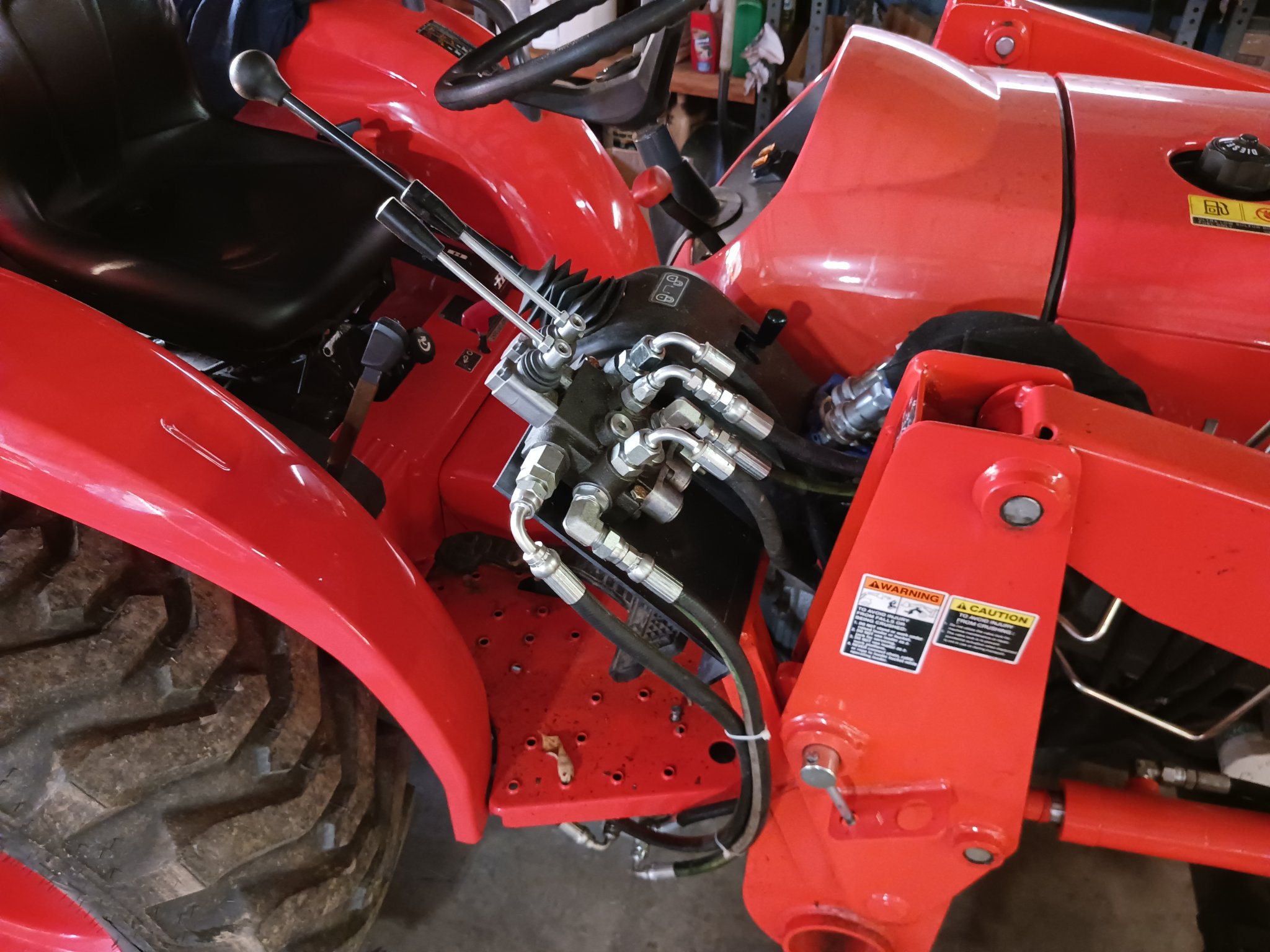

Here is that same valve installed on my LA525.

If you need longer hoses get longer hoses - they are cheap. If its over your head by all means get a mechanic.
But this is not hard. Pull all three hoses down and out from under the loader. Using their positions on the outlet block label them as PUMP, PB, and TANK as I showed. You still have not done that.
Then one by one pull them back up to their respective ports on the new valve, If they are short figure out how much longer they need to be and get longer ones.
I mean we are talking about a foot or less in length and half an hour at most to sort it out.

If you just follow a few very simple directions you are not going to screw it up. And even if you did you are not going to do any damage.
You don't need custom hoses. Your local tractor supply should have what you need on the shelf.
Now pull those three hoses out and label them . Take a couple pictures and I will double check your labels. We. Can have this done and a list of new hoses ready before lunch.

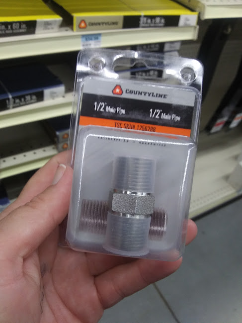

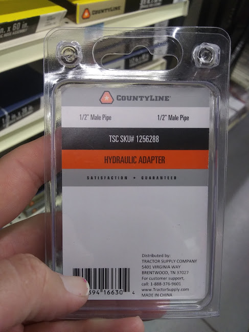

It was in the fitting that we purchased at Lowe's--a GAS fitting--because we could not find the correct hydraulic fitting that day. So, we go to Tractor and buy a new one by comparing it to the old one. The new one is 1/2 x 3/8 (I think). One side fit. One side did not fit. We get it home and it does not work. We go to two separate TSC stores and none have the correct fitting. I am about to order it online. He thinks it is called 1/2 inch male pipe to 5/8 inch male pipe OR 5/8 inch male JIC. It is definitely called a HYDRAULIC ADAPTER (like I stated above, the gas version didn't work cause it leaks). He said that both ends appear to be the male versions.
I posted some pictures of what Tractor Supply Company had below...they don't have the right one so we are headed to Amazon online...can anyone tell me if I am ordering the right thing by ordering 1/2 x 5/8 male to male hydraulic adapter? In my next post, I am going to post the link of what I am about to order so that I get this right.
