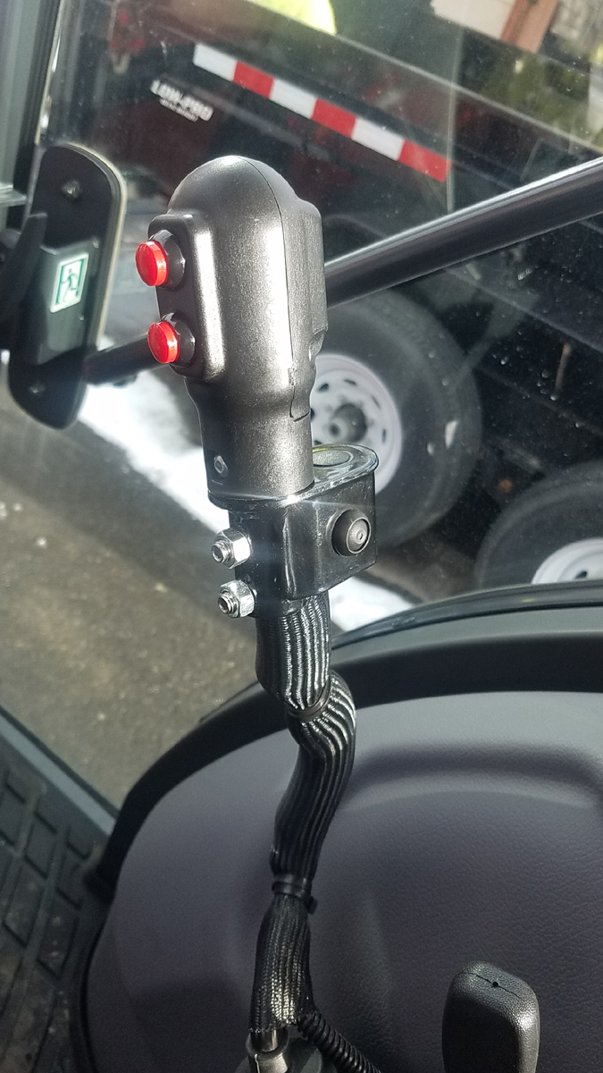

Njtool
Lx2610 HSDC. BH77 backhoe
Jan 1, 2021
216
281
New jersey
I love it. The OP had an LX2610 and asked about a third function kit for that tractor.
Land pride is different than Kubota. The sticks are different. The buttons are different. The valves are different. Kubota parts say kubota, LP stuff says LP.
Compare the style of the stick and the placement of the buttons between my pics and LP stuff. The top of the stick is ergonomic, the buttons are placed in a comfortable position. The power button is on the easy access.

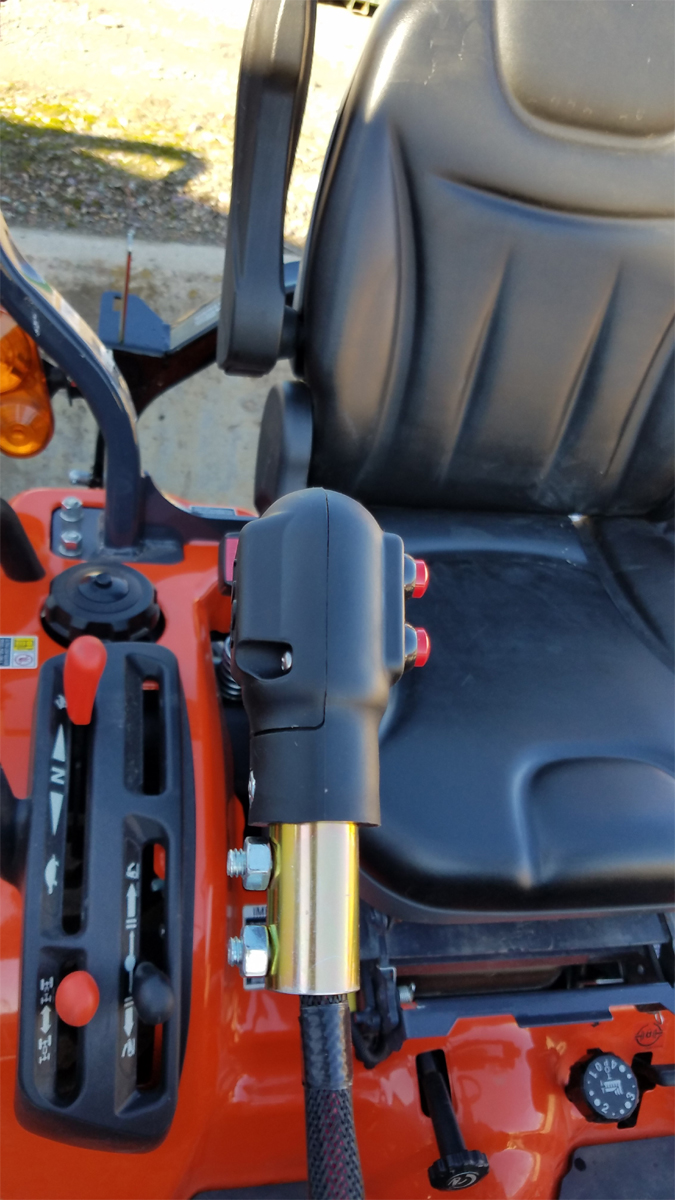

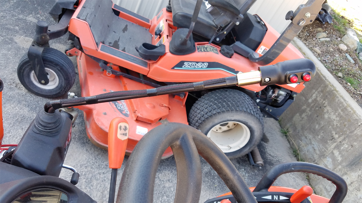

mcmxi
4,745
5,533
NW Montana
Here are the Land Pride controls on both MX tractors. I was also able to find some photos of the Land Pride kit that I had on the BX25D. I don't find the Land Pride kits to be unergonomic and they look good to me. I actually don't like the aesthetics of the Kubota controls but maybe that's because I'm used to looking at and putting my hands on three sets of Land Pride controls.
