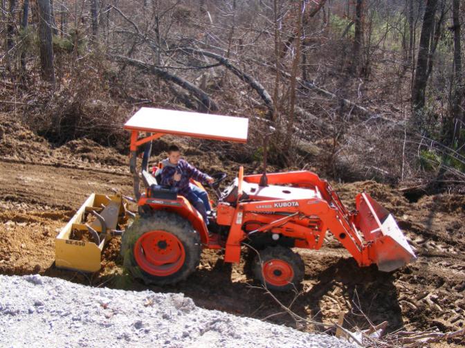

Bulldog, great pictures you posted.
This one is what it's all about and I'm sure you are very proud!
Bulldog
M 9000 DTC, L 3000 DT
Mar 30, 2010
5,434
76
Rocky Face, Georgia
You hit that one on the head. Proud poppa for sure. That little fellow was ready for bed at the end of that day. He took a few breaks and got my wife to take over for him. She spread dirt for me as well but we put 130 loads down that day.
traildust
B7610HST 4WD, LA352 FEL, Gearmore 2 Spool Top & Tilt Box Scraper
Jan 27, 2010
1,490
Phelan, California
And a proud poppa you should be :D
I'm sure he was beat after doing enough tractor work to help move 130 loads. What a trooper!
Bulldog
Mar 30, 2010
5,434
76
Rocky Face, Georgia
He's a big help around here for sure. He is a little shy on anything new that he lacks confidence in so he don't want people around watching. He had been on everything from a B 7100 to a 120,000 lb Komatsu loader and everything in between. He should be a good operator when he gets older. I've done my best to teach him the right way.
