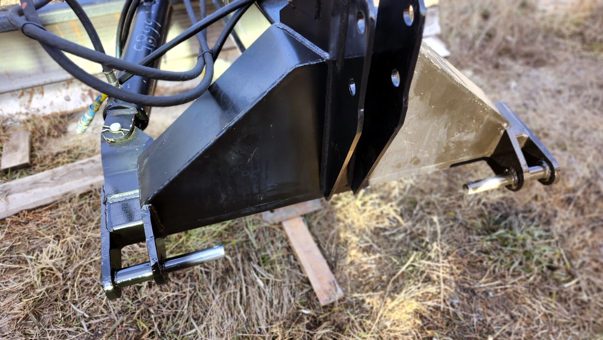

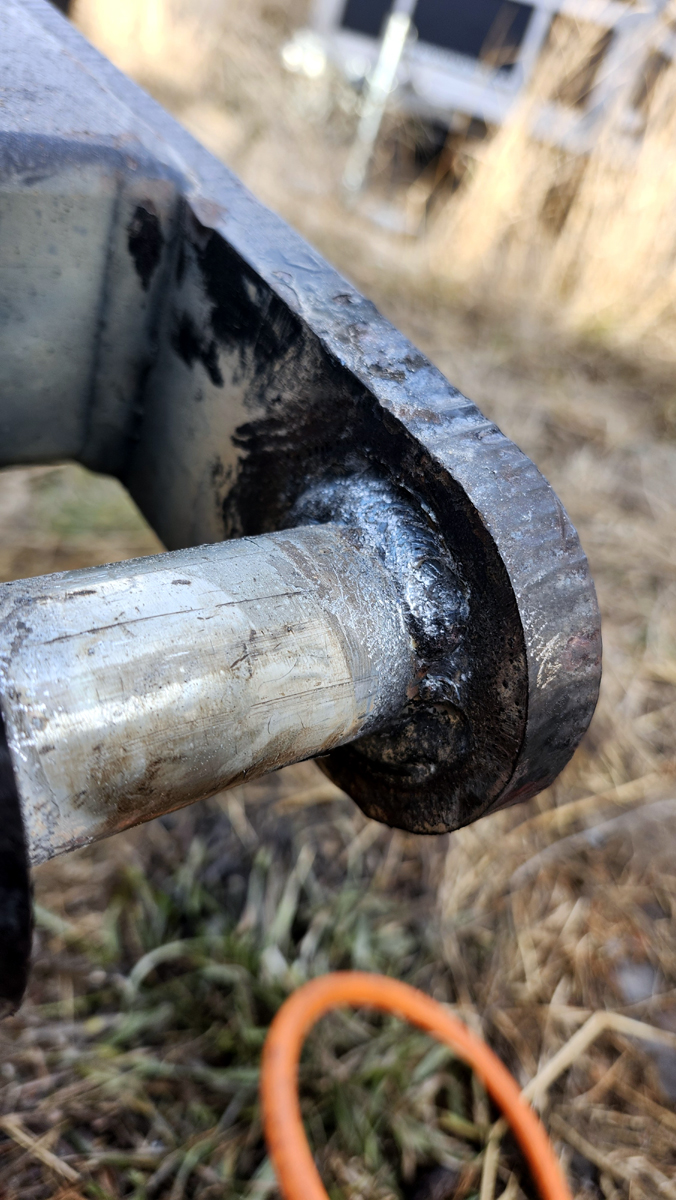

If the pictured holes are (as you purchased) the rear blade, they look to be made for hardened bushings to be pressed in similar to what Land Pride does.
Good luck with your Remedy. ;)
Thanks! And thanks also for getting me to go in a different direction, one that I'm pleased with. Yes, the earlier photo with the CAT 2 to CAT 1 pin shows the holes as the implement was purchased. So you think that bushings for a CAT 2 pin might have been in those holes originally? That's an interesting thought.

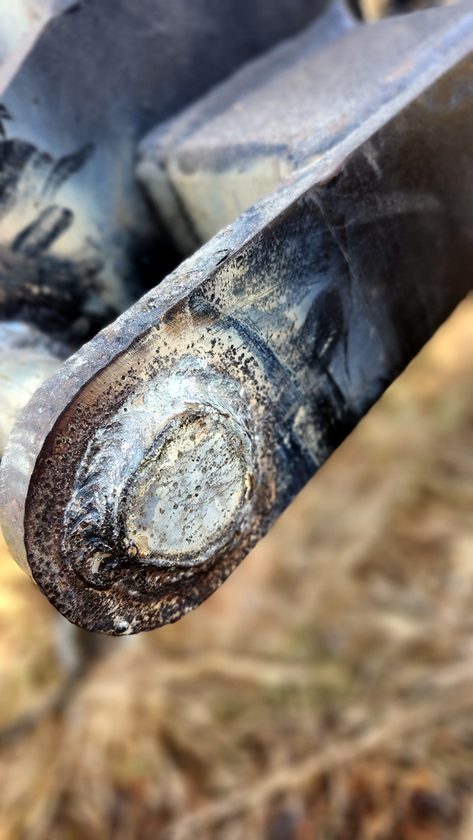

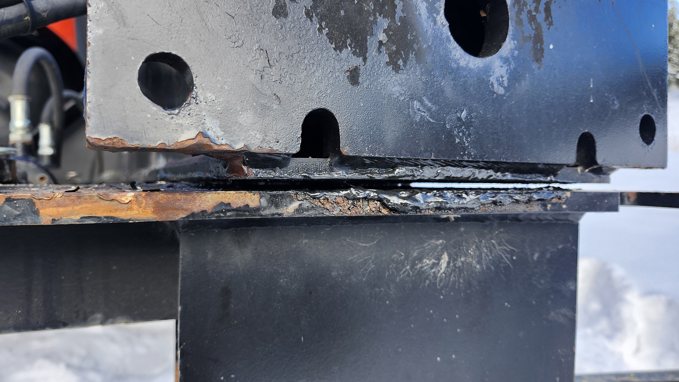

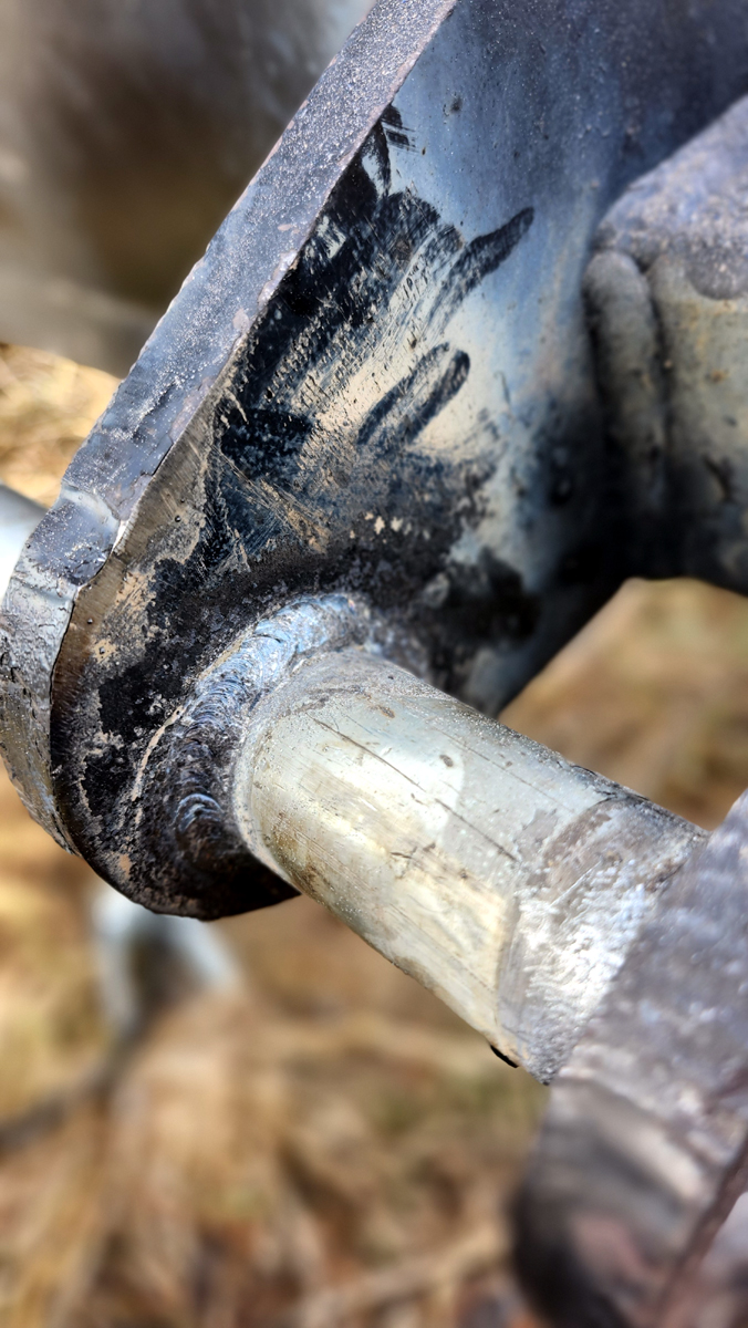

Today was a much better day. I used plasma to open up the holes for the pins and also to do some weld prep in the form of cutting a bevel around six of the eight faces to be welded. I then used 7018 rod to completely weld up the pins. I'm happy with how this has turned out and it's certainly a lot stronger than it would be with pins that are free to rotate and slide. The welded pins obviously tie the two plates together which makes it much stronger (not necessarily needed of course). Those plates that hold the pins are over 1/2" thick, more like 9/16" so pretty stout as it is.
I did a bit of clean up grinding too, for example the two plates where the top link connects via a pin. Some ACE Hardware gloss black paint made everything look decent. It was easy to get the implement on the M6060 after I swapped out the top-n-tilt for the original top link and lifting rod. I connected the hydraulic hoses and cycled all three cylinders and they work great. I have them set up the way I want and will check and most likely add hydraulic oil tomorrow since the blade probably took 1-1/2 gallons.

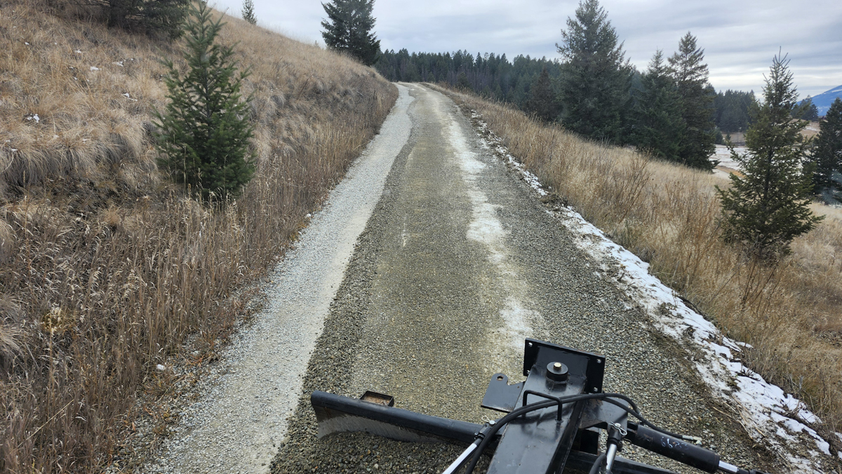

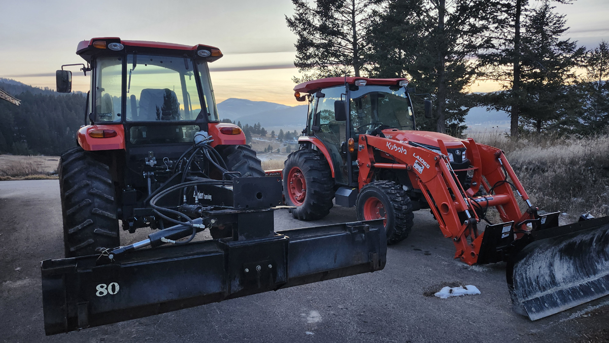

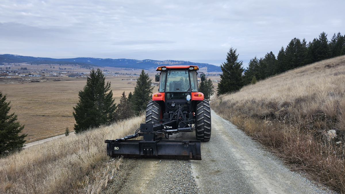

I was able to test out the Buhler/Farm King blade yesterday and it's pretty awesome, but unfortunately my road grading skills are not. The conditions were near perfect when I started, but a couple of hours later (was supposed to be a 30 minute test), the gravel was soft and I got myself into all kinds of issues.
Regardless, the blade is excellent and will see a lot of use I'm sure. The second photo shows how much overhang the blade has when swung all the way over to one side, and with the wheels on solid ground I should have no problem pushing snow over the edge and rolling downhill.
The M6060 is running like a top and is enough of a beast to pull a loaded blade uphill in 2WD which is impressive, and that's not in creep range, just low range and first gear at 1,500 rpm. I'm going to remove the snow blower and hook up the EA land leveler to the MX later today and try to improve on the finish.

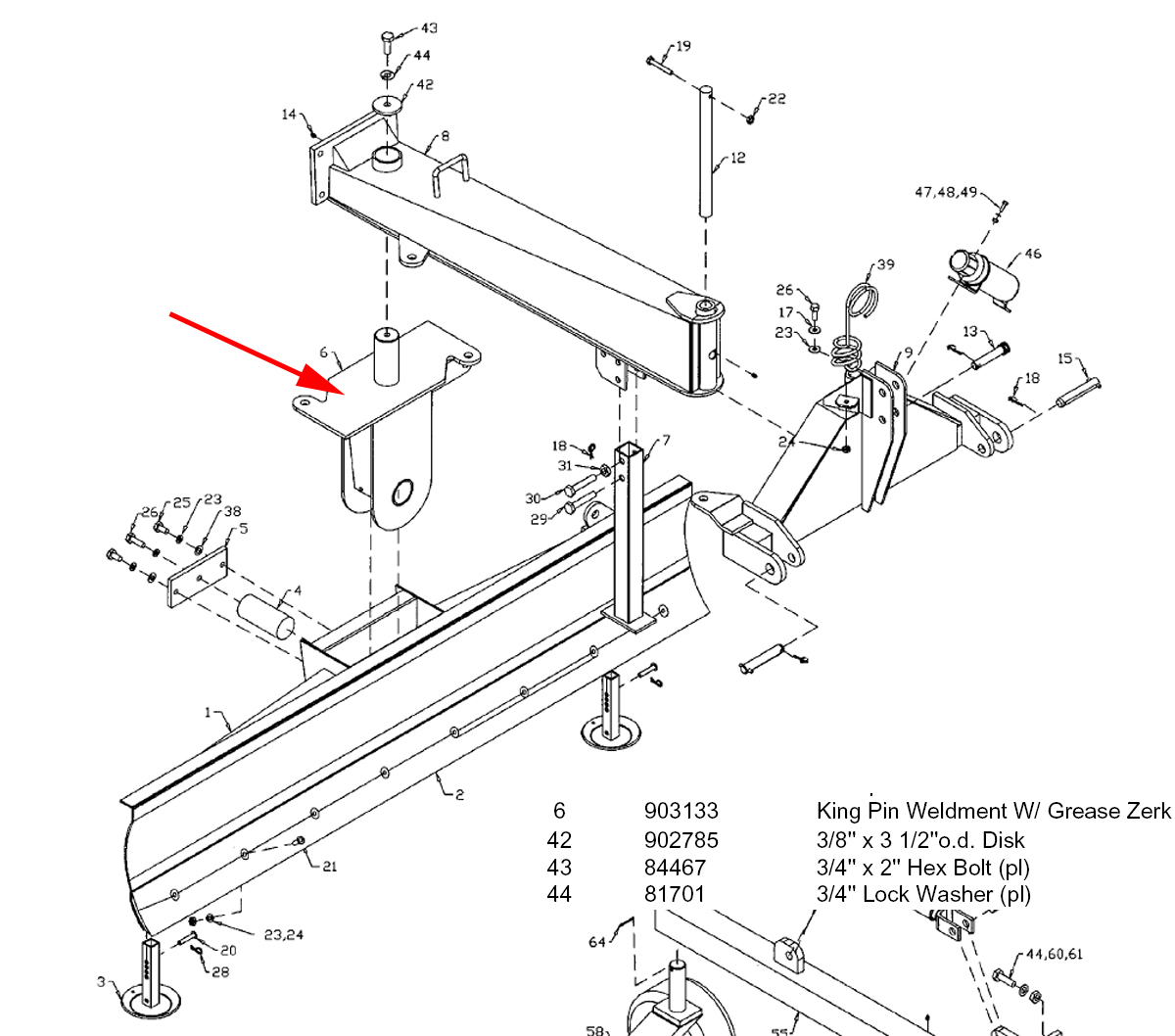

How much play or slop do you have with your Bison blade at the location shown by the arrow in the schematic below? I think there's some excessive spacing so will try to tighten bolt #43 and see if it closes the gap a bit. It's not a big deal but I imagine that the bolt can back off over time as the blade angles back and forth.
My blade has very little slop. In fact before I got the hydraulic cylinders, it was a bit stiff to move by hand.

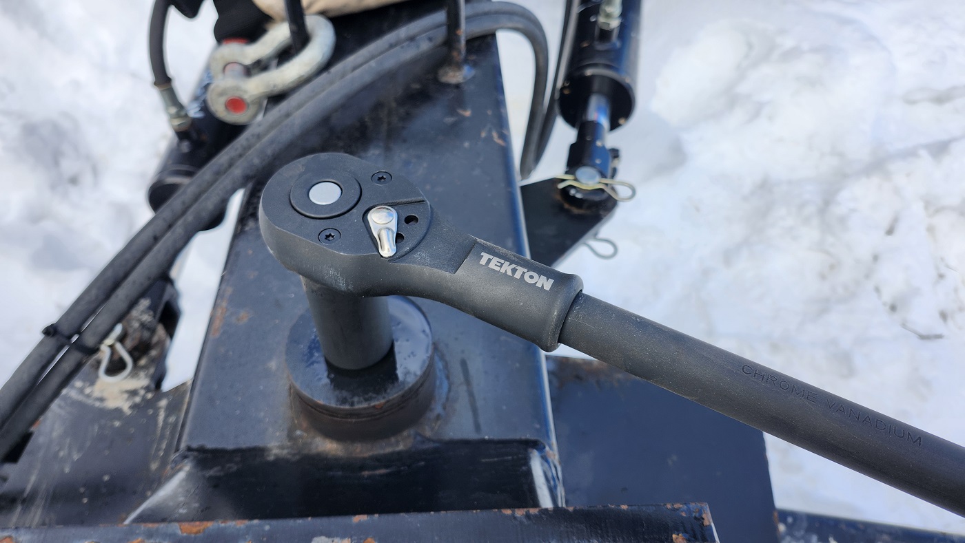

This afternoon I removed bolt #43 that threads into the king pin, and the top of the king pin is flush with the top of the boss that the 3-1/2" O.D. disk sits on. So without removing material from the top of the king pin there's no way to close up the gap between the king pin weldment and the boom. I had to get the 3/4" drive Tekton ratchet on the bolt since I couldn't get it to budge with a 2ft 1/2" drive breaker bar or the M18 1/2" impact.
I see no way for the gap to get wider through use unless the king pin has somehow stretched. I'll leave it for now but will take another look when the weather improves. It's not really affecting performance of the blade, but there does seem to be excessive play between the blade and boom.
Perhaps install a bushing or large flat washers to take up the slop?
I was going to say, my take is, remove a little length (but not too much) off the kingpin to tighten it up.
