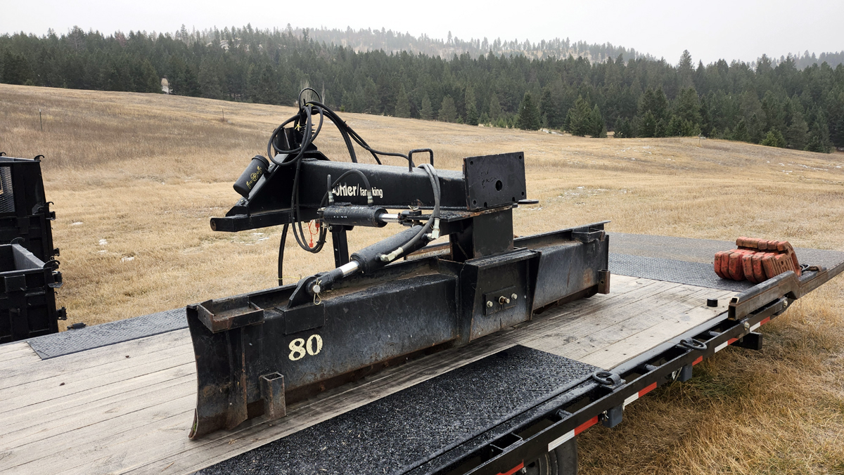

I could really use this Buhler/Farm King 8ft hydraulic angle rear blade.

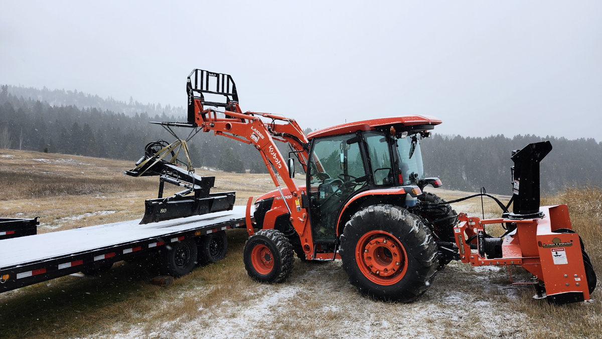

The last picture is a triple diverter set on a Kubota M7040.

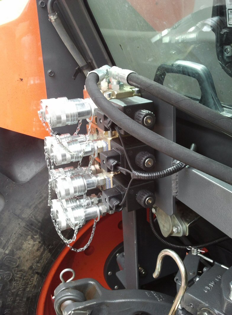

There are other options, but they make Summit look reasonable. But then, you get what you pay for.
Summit offers a 5% discount for members, use code OTT, every little bit helps.

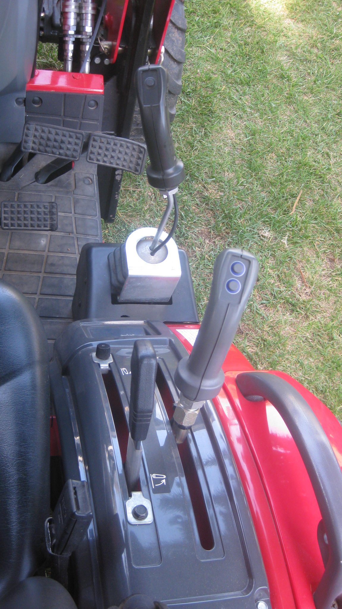

Add a diverter to your tractor. Look at the previous posts, they pretty much show what can be done.

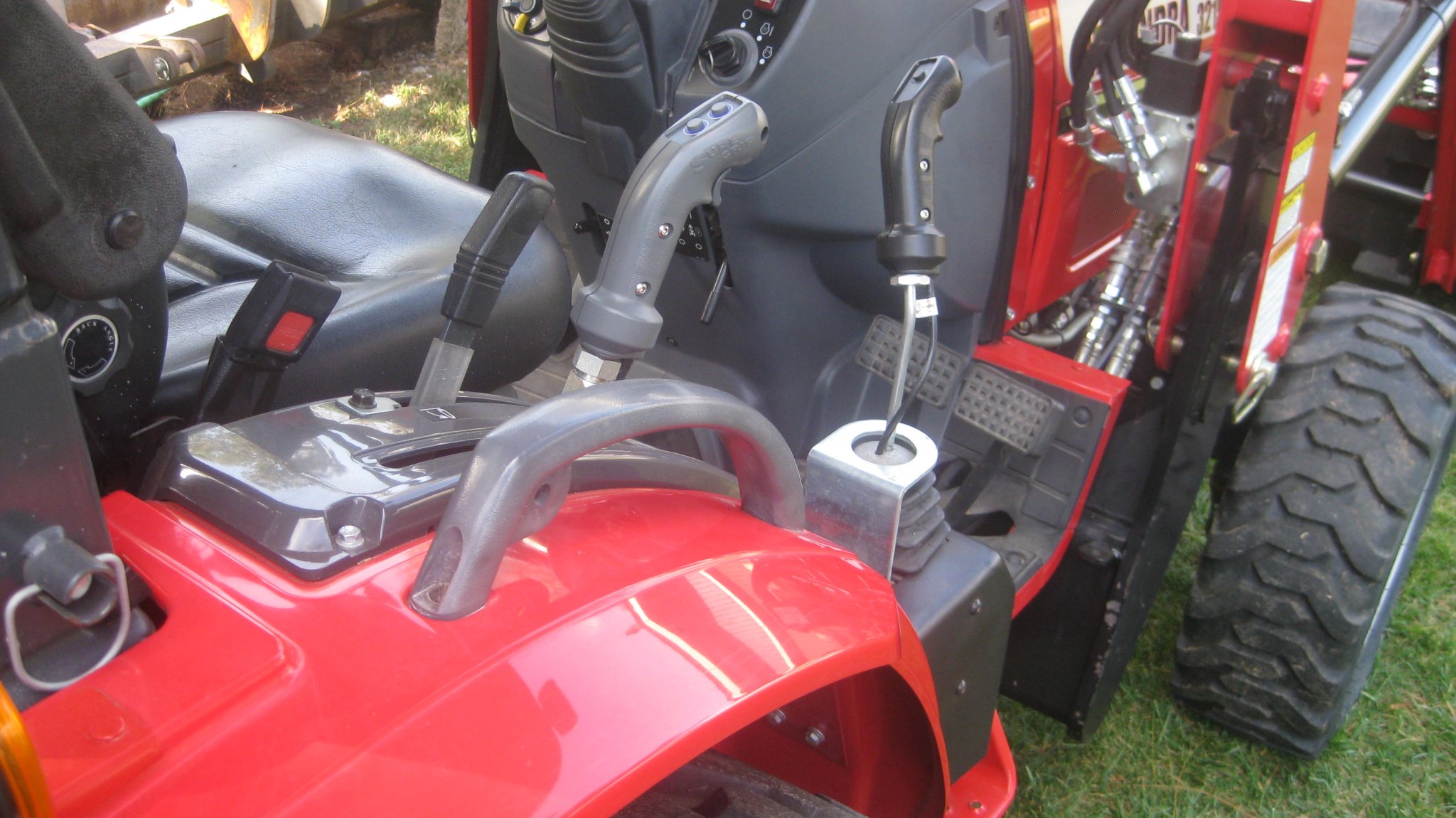

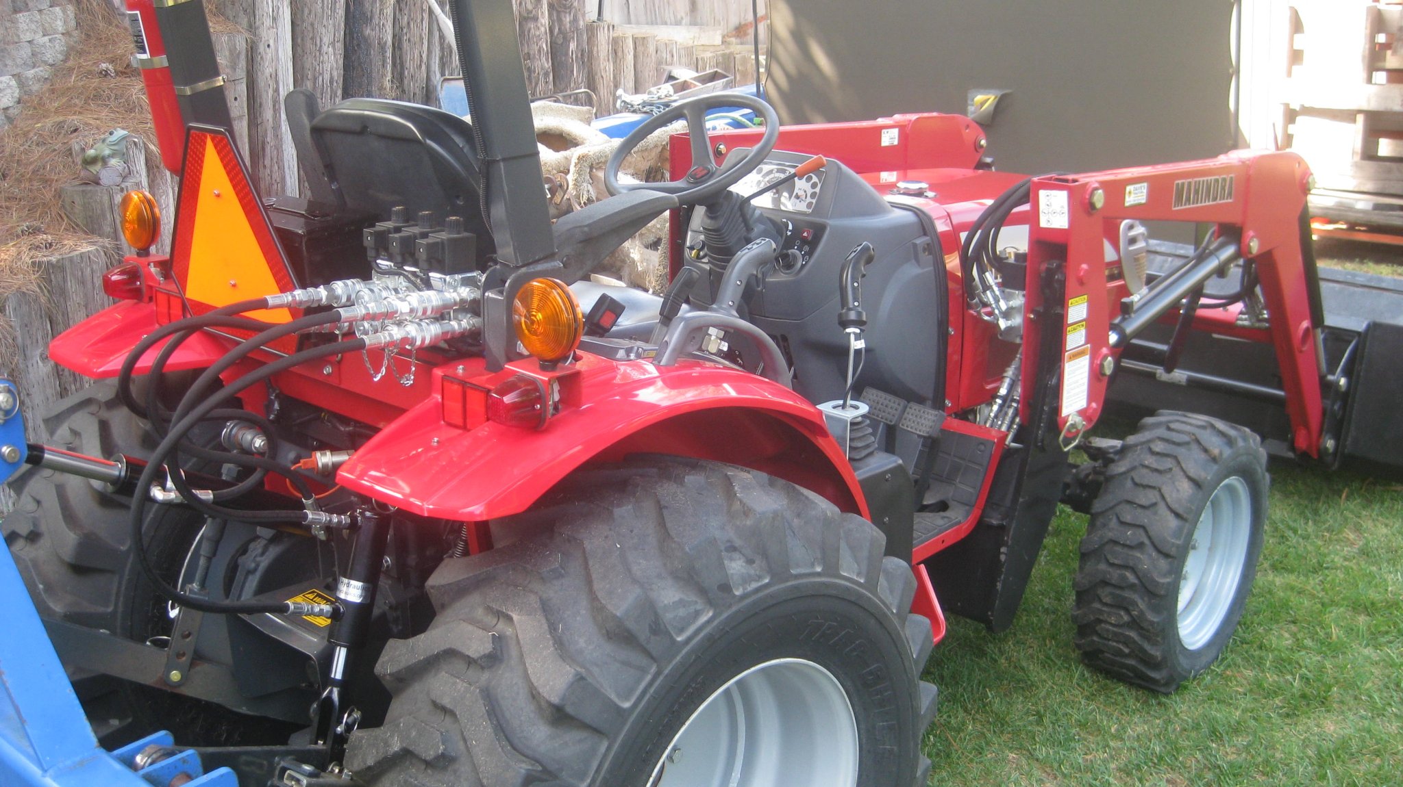

I have 4 sets of couplers on the little red tractor. It only has a single factory rear remote.
All controlled with a control grip mounted on the factory control lever for that rear remote.
The gray pistol grip control grip has 3 seperate switches to control the desired function for the implement.
The last picture shows an L6060 that had a single rear remote, added a double diverter set and now has 3 sets of couplers available for him to use.
You can either add a double Summit set or a single Bosch Rexroth cast iron diverter set to get the 4 sets of couplers that you want-need. The Summit set is less money, but it is an aluminum housing and of lesser quality IMO. ;)

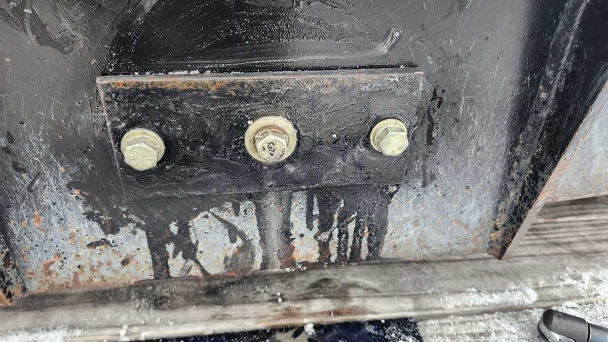

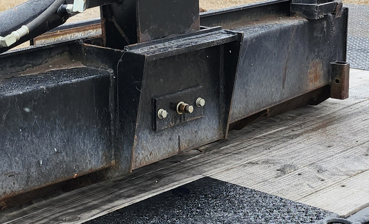

So to get back on track, I started to look more closely at the rear blade this morning as the snow was falling. One of the first things that jumped out was the large 80 painted on the rear of the blade! :giggle: Not sure how the seller and I both missed that.
Nothing is particularly concerning thus far. I pulled the six weights off and realized that I don't like the home-made weight brackets (first photo) so will remove them at some point. I was only able to get grease into one of the three grease fittings, the one for the king pin. The grease fittings for the tilt and offset boom will need to be removed and possibly replaced. The center bolt that threads into the tilt pin was messed up as you can see in the second photo below. There was an oversized nut on the bolt just flapping around and doing nothing. I removed it along with the plate, ran a tap in to clean out the threads and reinstalled using a new/used bolt.
The other thing I figured out is that it requires a CAT 2 top link pin (1") but CAT 3 lift arm pin, so I need to buy/make some CAT 3 to CAT 2 pins. I got the Buhler off the trailer and near to the M6060.

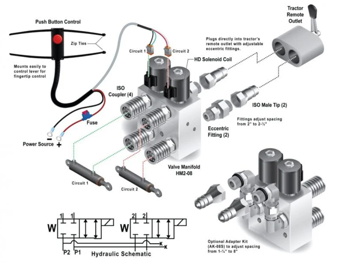

As for hydraulics, this is probably the simplest option for me to add hydraulic control of the gauge wheels on the rear blade. I would just have to figure out whether to share that function (via the switch) with angle, tilt or offset. Also, I think I'd prefer a rocker switch to a momentary switch but that's an easy change to make.
I would most likely add the same system to the MX as well since I could use a fourth remote when running the Del Morino flail on that tractor.

If I decide to go with this system I would run hoses between the rear remote and valve manifold and locate it in a suitable spot (see highlighted text below). Like I said, it's early days and I won't be doing this until next year so there's plenty of time to get it all figured out.

Unless your Kubotas are different than every other Kubota, I think that you should probably reconsider taking off the hyd top link at least. When you have the rear blade on, the actual blade itself is is not going to be very far off the ground. Typically around 12". :unsure:
You can make use of the top link by retracting it and gaining at least another 12" if not more in blade height which sure helps for transporting as well as loading on a trailer.
Get a 4 function multiplier and one of these control grips and you can control all 4 functions from your 3rd rear remote valve without ever taking your hand from the control lever. :cool:
I think it could be helpful to go through a comparison of how the option you list above differs from the one I mention since there are some significant differences, as you know. Going through this list helps me to get a better understanding of what's going on and it might help others too. For the record, I appreciate the recommendation and see that it's a good solution for both tractors.
In the system that you recommend:
  1. The control grip would install onto a rear remote lever in the cab (you mention #3 so let's stick with that)
  2. The multiplier would connect to the 3rd rear remote via hoses
  3. The four hydraulic cylinders on the rear blade would be connected to the multiplier
  4. The 3rd rear remote lever in the cab would be used for all four cylinders on the rear blade
  5. The buttons on the control grip would be used to select which cylinder on the rear blade is to be operated
  6. The position of all four cylinders on the blade can be "feathered" since control is via the 3rd remote valve/lever
  7. The control grip would replace the rocker switch box that comes in the kit
  8. Top-n-tilt funtion could be retained
  9. The first and second rear remotes and levers would be unaffected and could be used to operate top-n-tilt
  10. More expensive than the system below
In the system I reference above: (which I'm not liking as much)
  1. The multiplier would connect to the 3rd rear remote via hoses
  2. Two hydraulic cylinders on the rear blade would connect to the multiplier
  3. The 1st rear remote would be connected to a cylinder on the rear blade
  4. The 2nd rear remote would be connected to a cylinder on the rear blade
  5. The 3rd rear remote lever would operate either of the two cylinders connected to the multiplier
  6. A momentary or rocker switch would select which cylinder is active
  7. A control grip could be used on the 3rd rear remote lever which would replace the momentary or rocker switch
  8. The position of all four cylinders on the rear blade can be "feathered" since control is via the 3rd remote valve/lever
  9. No top-n-tilt retained
  10. Cheaper than the system above

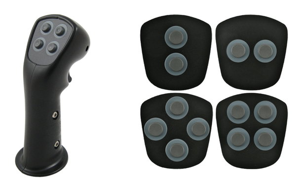

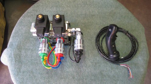

For those interested in this stuff, I called the Seattle based distributor for the Scorpion control grips that @MtnViewRanch mentioned. An X Series four button grip would work and they're available in a diamond or square arrangement for $270 with the adapter being extra. The buttons are momentary and so it'd be a simple case of holding down one of the buttons and then moving the control lever to operate the cylinder on that circuit.
I'm going to order the diamond 4-button layout X Series for the M6060 in grey and without the optional trigger. For the MX I will most likely have to use the four-button toggle box that Summit sells since the rear remote control levers aren't located in a way that would make a control grip usable.

I understand that you are just shopping and figuring out what you will do. All I can say is that it is best to not cut corners. Going with the single multiplier is cutting several corners IMO. Like, why would you even consider it? :unsure: But that's just me.
One of the things that I dislike with the Summit systems is that you always have to have a solenoid energized to use any of the functions.
Plus I want to re-emphasize. Learn how to use the draft control before you invest in gauge wheels.
If it does not work well for you, nothing is lost. But if it does, then a hassle is saved as well as over $1000.
Have you looked at all of the different style grips? Get the actual sizes before you order.
What fits on the M may not fit on the MX. :unsure:
There are options that do work on the MX, although maybe not 4 switches?
