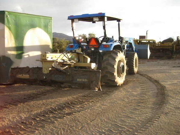

I may very well be wrong, But It sure looks to me that the offset cylinder is not fully extended when the boom is parallel to the tractor. Meaning that it does adjust to the left and right.
If not simply make a new mount for the onside so that the one hydraulic adjusts to the left and right sides without doing anything than moving the control lever for that cylinder.
Easy enough to do. All the RBT Land Pride models are that way.
I think you're absolutely right. I thought I'd read somewhere that the offset was only to one side but the Buhler/Farm King manual states 30 degrees to the left or the right (but Allied states 20 degrees online) and the cylinder does look like it could extend a bunch more. Will you look at that, I just completed a project from the comfort of a warm house! 😂

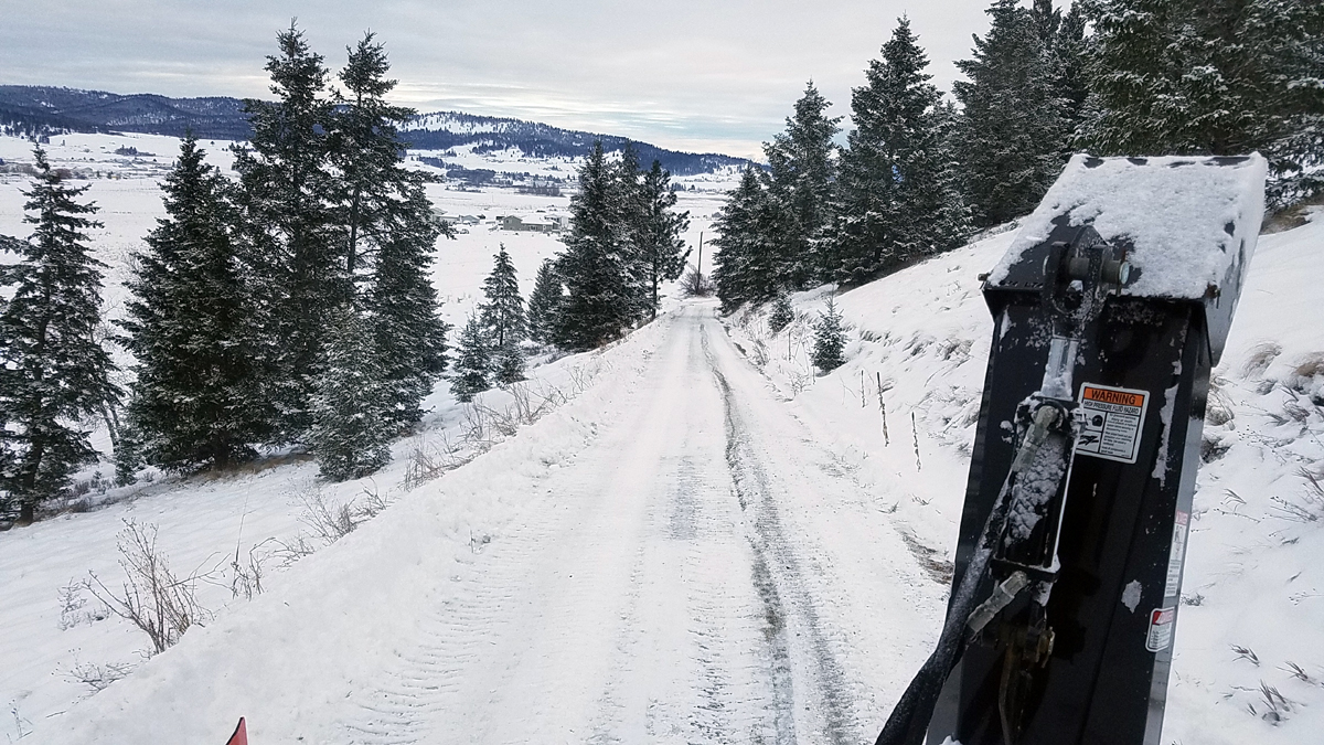

I guess there are some people with those needs; for the 2300’ of road I maintain, going down one side, then up the other is most efficient.

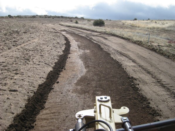

I don't have as much of a driveway to maintain as you, but my driveway is steep so it's easier to move dirt, gravel or snow working with gravity rather than against it. I don't run the blower on the gravel section shown below. I mostly push snow with the MX heading downhill starting on the right side then making another pass to try to move the snow all the way to the left. You can see in the second photo how the snow builds up on the left and I need/want to push it over the edge without rolling a tractor. So ideally I can swing the blade over to the left and keep the M6060 safely away from the edge. The bottom photo does a better job of showing what sort of drop off I'm facing, and how rolling a tractor would most likely prove to be fatal. The lower driveway is the dark line in the bottom photos that meets up with the asphalt section of driveway.
If I want to clean out or maintain the small ditch on the right side of the driveway I'd need to swing the blade over to the right a bit if I want to grade heading downhill.
If you were to add the swing/boom cylinder to your blade, would it swing in both directions without swapping the cylinder to the other side?

My offset cylinder is on the left side and shifts the blade to the right. I have a similar situation as you with a drop off on the left side but not quite as steep. What I do is offset to push snow to the right hand ditch going downhill and push into the left hand ditch (with drop off) going uphill. Yes that means I’m pushing snow uphill for a short distance (it slides into the ditch so not much is being pushed uphill). I have done this with up to 22” of snow. If we receive more, I would probably take a narrower path with overlap when I push uphill to reduce the snow build up on the blade before it slides into the ditch. I would need to make an additional pass.
