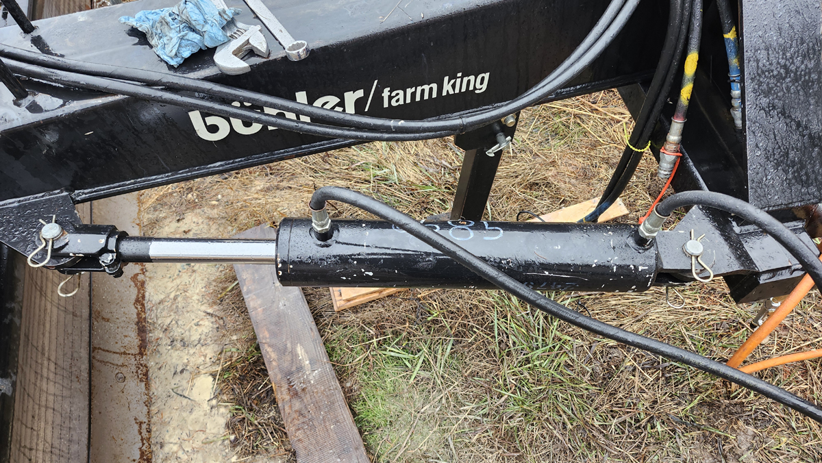

It's a grim day but I started to get as much oil out of the three cylinders as possible. I got all six fittings off the end of the hoses without any trouble and all appear to be in good shape. I used a little compressed air to get the swing cylinder to cycle. The cylinders are all stout buggers.
Tilt cylinder: 3x8 with 1.5" rod
Angle cylinder: 3x12 with 1.5" rod
Swing cylinder: 3-1/2x16 with 1.5" rod
I don't know what machine the previous owner used to pull this blade around or if he had UDT2 in it. He asked me what tractor I was going to use with the blade and I told him the M6060. He mentioned that he used a Kubota 5660 or something like that, and stated that the M6060 would be a good fit. Given the color of the almost 1/2 gallon of oil out of that one cylinder I feel that it's well worth the time and effort to drain all three cylinders and hoses.
The CAT 3 to CAT 2 pins won't be here until mid next week so I won't be able to try the rear blade out until then.

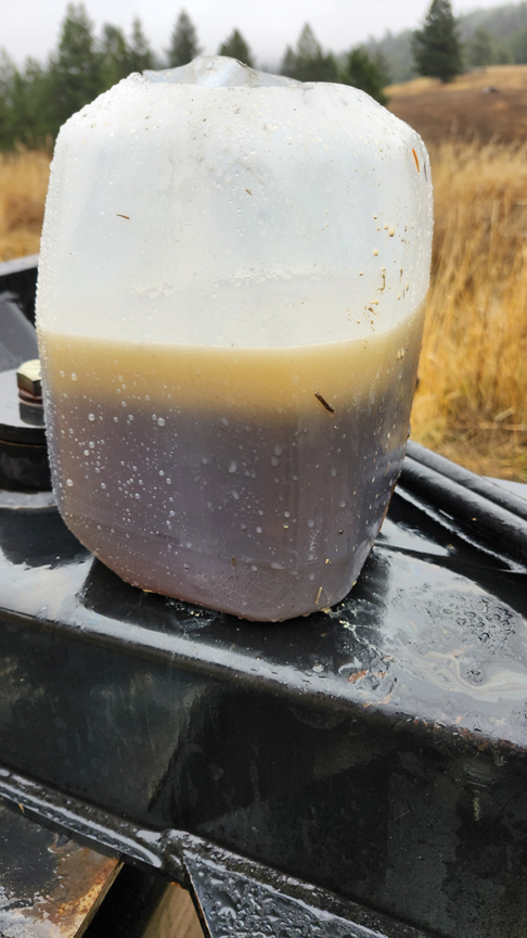

Pretty ugly looking fluid.
7,265
10,028
Yep. How many hook up to an hydraulic implement that isn't their's without a second thought re the type or quality of the fluid in it. Do rental companies really drain out the fluid every time an hydraulic implement is returned? Doubtful.
The "beer head" is just foaming from my using compressed air. The fluid is fairly dark in color but feels and smells ok. By the time the oil settled I had 2/3 gallon from the one cylinder. Once I drain all three cylinders and hook up the rear blade to the M6060, I'll add UDT2 to the tractor equivalent to the volume of the old oil.

Oh my…looks like the bartender not quite sure of the ratio making their first black and tan.
GrumpyFarmer
3,252
4,528
I think you are wise to drain it and start fresh. It’s an ounce of prevention. 🥃

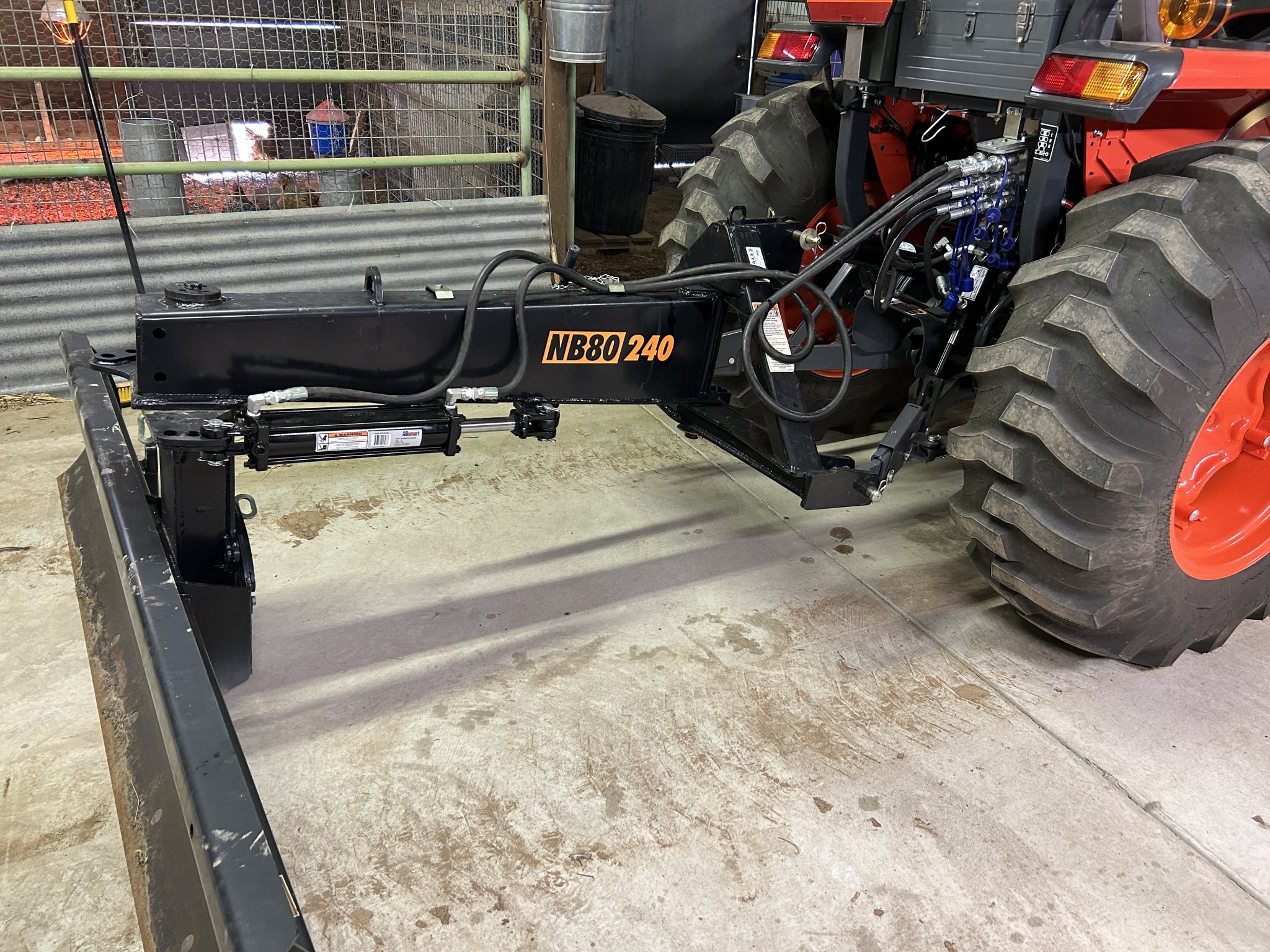

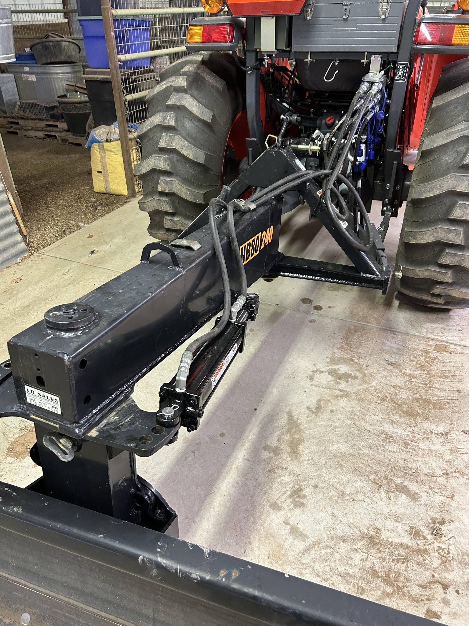

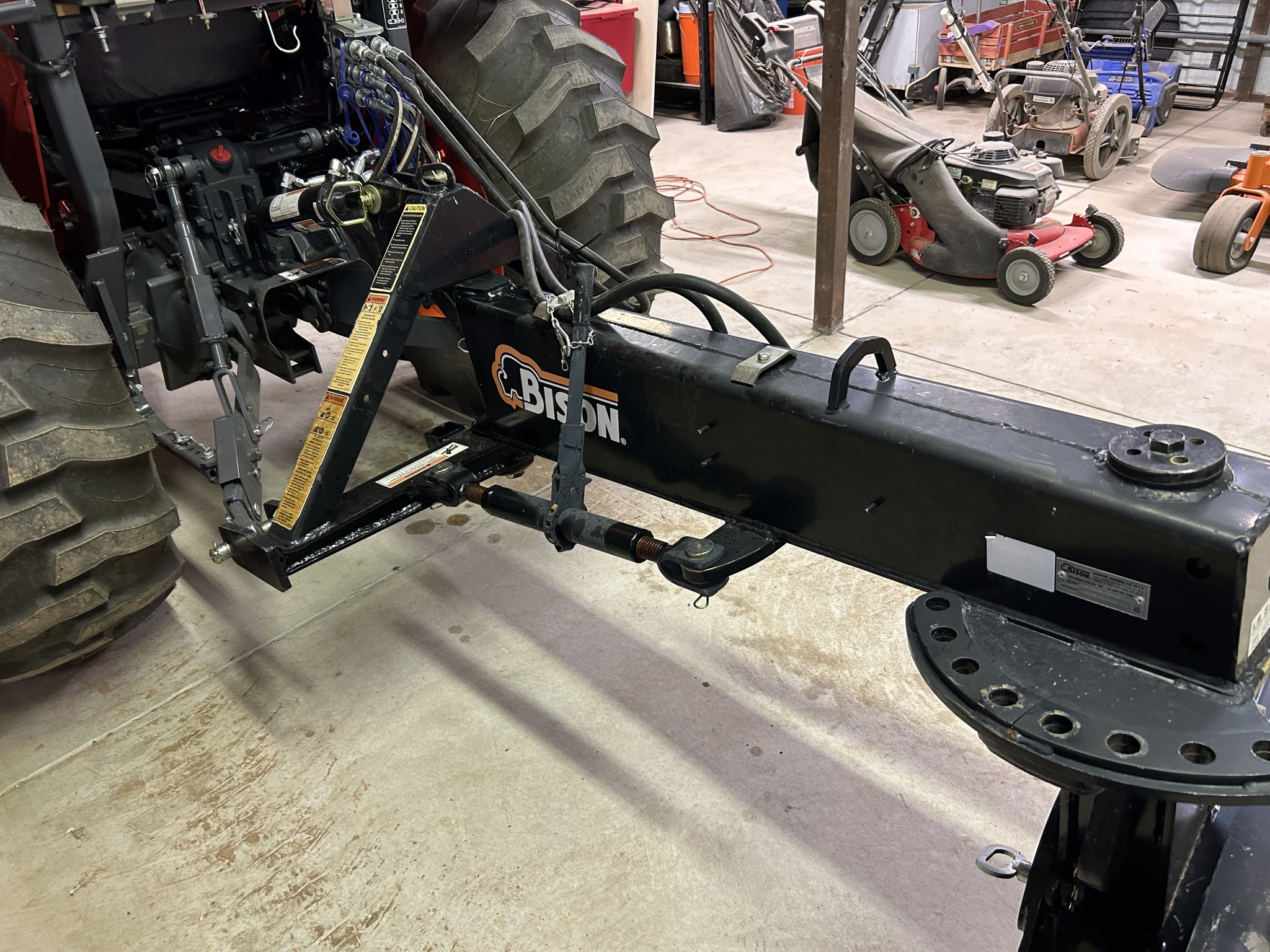

I finished up my hydraulic blade installation today. I have the top link and tilt link
with hydraulic cylinders on the tractor and the angle function on the blade with a cylinder. I had to stay with the manual jack cylinder on the blade offset because I only have 3 remotes.

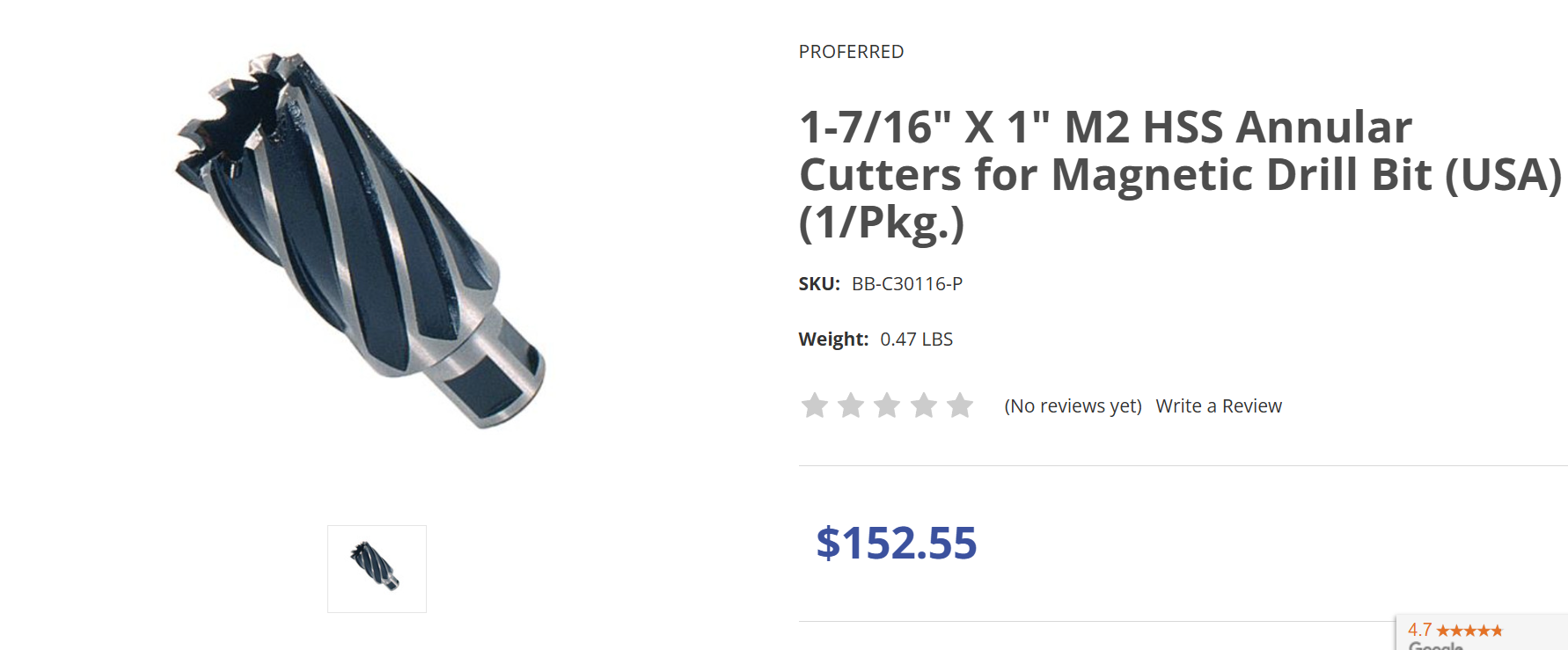

Yeah, it's been a frustrating and disappointing day with very slow progress :cautious:. I might buy a used reamer from eBay or go in a different direction altogether. Allied/Farm King specs show CAT 2 on the Series 80 rear blade and CAT 2 and CAT 3 on the Series 100 and up. The holes were over-sized for CAT 2 for sure, and that excessive movement will cause more damage to the hole so I figured this would be a good solution.
34,535
9,776
couple options:
I bought the driver for this style of bit, The are Insane for cutting steel!
Cheaper version of above.
7,265
10,028
couple options:
Thanks for all those recommendations. I have a Hougen mag drill and use their cutting tools which as you say are incredible on steel. Maybe the best solution is to weld in some plugs to fill the holes and use the Mag drill to cut new holes with one of those tools. The problem or challenge would be the depth of cut. The two brackets (plates) are 4" or so apart so I'd need to be able to plunge through both plates from the outside since there's no way to mount the mag drill on the inside of the plates. I hope that makes sense.
I'll call a local steel supply business on Monday and see if they're able to make up some new plates with appropriate holes. They can cut the plates but not sure if they can make holes that are 1-7/16" in diameter. I could even add a third plate like Land Pride does with their CAT 2/CAT 1 option.
Either way, I've put in way too much time and effort and not making good progress. Time to try something else. No regrets on the rear blade though. It's been used on a farm for years and who knows what that blade has been through. I'll get it sorted out eventually.
