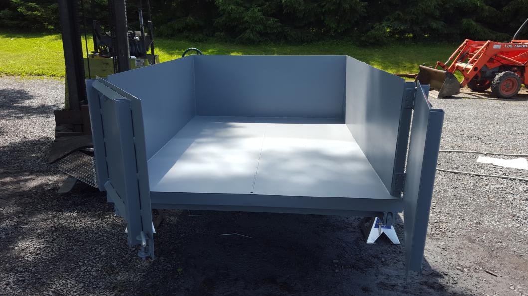

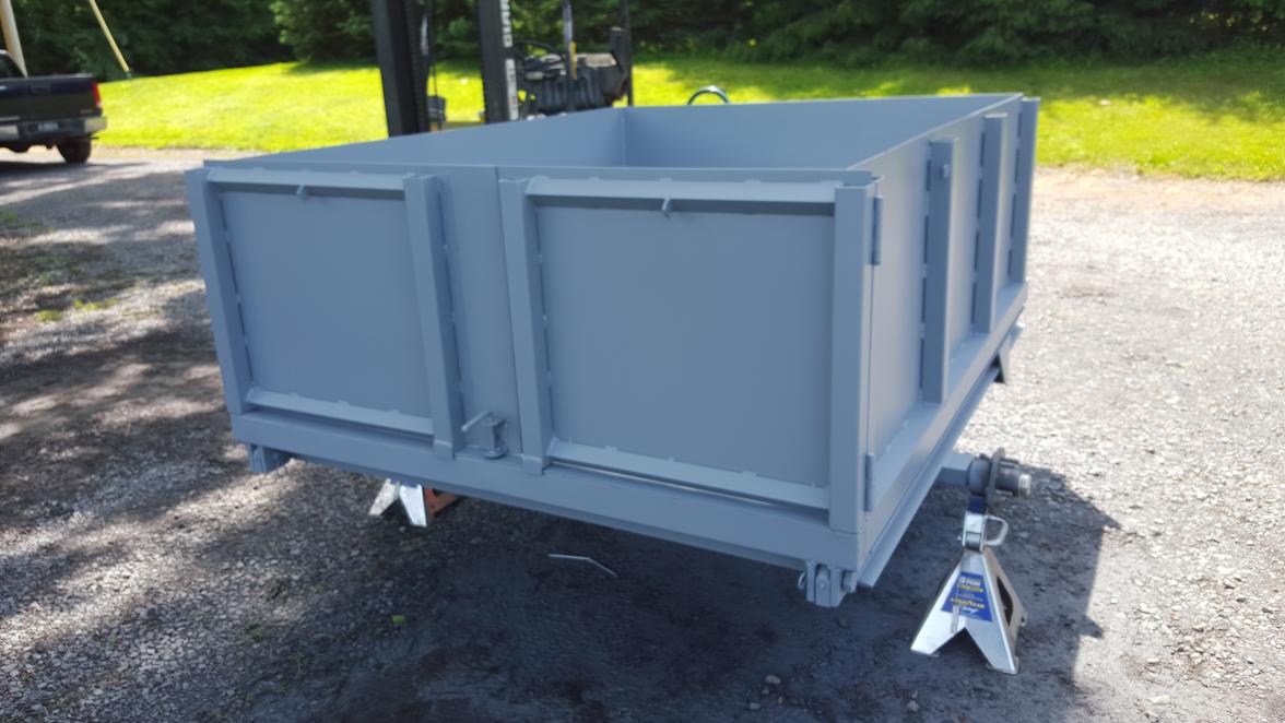

You might want to reconsider your door latch setup! ;)
If you load it with dirt and anything that's pushing on it, it will bind and you'll won't be able to get it open, or worse yet it will open and push the doors open with so much force they will swing violently open.
Another point on that is you need to also pin the top of the door together as they will just get bent.

Wolfman has a point,dump before opening gate and it can be a nuisance. Things happen.

Like suggested, might not want to go uphill loaded heavy.

2grit, sometimes it's the a-hole operator at the gravel pit loading something funky and causing you grief. Like over loading the trailer. A flip latch with a large handle in the center of the gate would be handy to have if someone puts too much in the trailer. Or a roller latch similer to what they put on a dump truck :D

So true. I traded a guy a 60mile move of his 5th wheel trailer for some large rocks for my driveway project. (to be covered at a later date) He used a large Mahindra tractor to load about 20 rocks from 400-1000lbs each into his dump trailer, which I used for moving the rocks. He insisted on dropping the rocks in from about 4-6ft, instead of placing them on the deck with the tailgate open- no amount of discussion could dissuade him. When I attempted to dump the first load, the trailer was so bent that the tailgate would not open. Took two of us about 20 mins using 6ft J-bars to open them. When I returned for the second load, he used the tractor to straighten the doors, and then repeated his loading procedure, which caused the doors to jam again. Sometimes you just can't fix stupid.

I really don't see how wolfmans comment was negative or egotistical :confused: He stated that was his opinion and for you to reconsider the latch. I completely agree that it would be a son of a gun, if something ends up on the tailgate to get it open. Then your stuck with a shovel which defeats the purpose of the trailer :rolleyes:

once again the door swings wide @ss open , yes pun intended...........
The build of the trailer is fine, I am sure - using common sense and balance and the the rules of physics being used....such as tongue length, axle placement, type of axle, frame material etc......
but as NIW said in a very polite way.......let me paraphrase .....the rear gate .....whats the word, ............sucks! No he DIDNT say that, I am saying that ..........
IS it built heavy enough?.....I am sure, but anything that pushes on that ONE lonely latch pin is going to be a cluster$%@# to open.......
so as he said, "just his two cents" .........
any load on the rear gate will apply pressure on the ONE 1/2" pin ? really? .....and pressure created on the top WILL bend the doors........so......... ok - sure I get it - make sure some dumb@ss doesnt load the material towards the back,
ok, sure I always remember that when I have a 8 foot trailer NOT to be able to use the last 2 feet because of a design flaw.

That simple latch could be reworked so it would pop open with a flick of the wrist, no matter whats against it.
