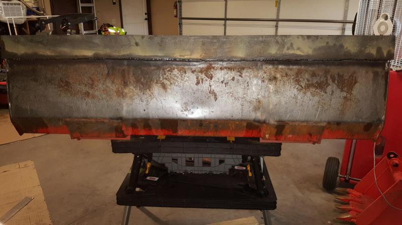

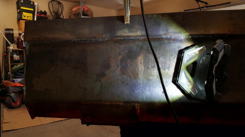

Here are some pics of the back side. The top pic is one while it was still in progress and the other is the overall view after I was finished. I'd still like to run one more weld along the back side but I had to wrap things up and move on to the next project. I have big box blade weld job coming up assuming this new cutting edge survives today.

I think I'd maybe make another pass(or two) over the whole length. You've spent a lot of time and effort for it to come loose, or deflect, when you're out on a job counting on it.
Turn the heat up, and burn it in!

Without being right there looking at it,i would do as MR Cat says. Another hot pass. Make your fillet a little wider.

"A" is a weld on the cutting edge. "B" is a weld on the bucket side of the cutting edge. "C" grabs both of them.
So would you suggest something like A and B? A or B? Or just maybe like C?
With all this talk of academics, I went all 'multiple choice' on your guys. :)

And for the weld, C hot and slow
