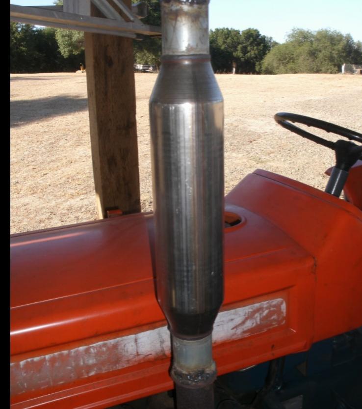

Man this thing is loud! It's got a short stack on it. Anything I can do to quiet her a little? Haha

*** louding problem solved***
Bought a 2" straight Glass Pack Muffler from Ebay
welded to existing pipe. 100% reduced the noise.
http://www.ebay.com/itm/2-straight-...ash=item2a56f6ba05:g:BCMAAOSwHoFXvaM5&vxp=mtr

Thanks jkk! Muffler looks good! It's on the list!
