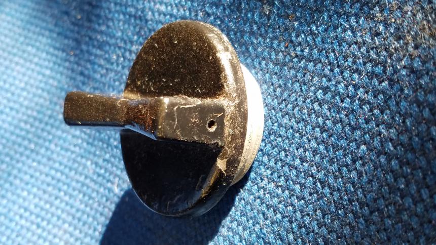

Somehow both my shifters are leaking a not insignificant amount of trans fluid after running for about 15 minutes. Seems like both of them but i replaced one boot under the shifter and the other was fine when I was in the transmission recently! Yargh. For today just took a rag with me and kept soaking it up! Going to fix that one asap!

For the leak around the shifters, there is a vent that is probably plugged up. I believe it is a small tube that looks like a question mark shape laying on its side. Look on the left (sitting in seat) side under the seat at top of the transmission. If it is like my L185 you can unscrew it and clean it with some wire or a small brush.

The vent on a 1500 is in the cap. make sure the small pin hole is clear.

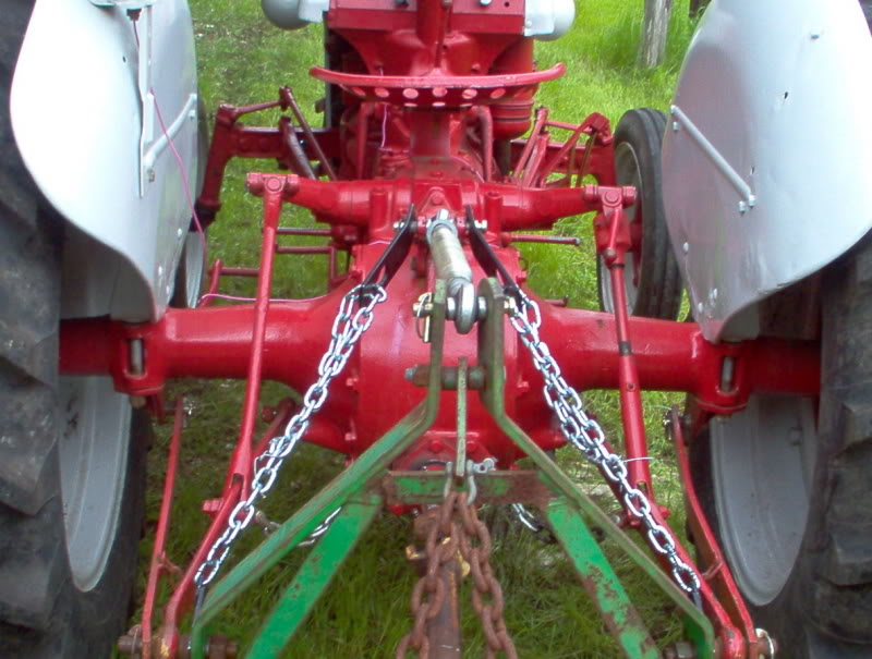

If yours is like mine and that knob will not actually stop the three-point from lowering due to wear, and you don't want to rebuild the whole thing then you need to.......
Use adjustable limiter chains, I need to make a set, see the link for a drawing
http://www.ntractorclub.com/howtos/pdfs/Limiter-Chains.pdf
Or buy a set.......
https://www.stevenstractor.com/farm-equipment-parts/chain-limiter-kit.html
Or buy a set.......
Thanks I'll go check the cap. So the physics are? Gears are turning and splashing fluid up on shifter boots. As oil heats up air expands and pressure rises. Since I think the vent is probably plugged pressure builds and pushes the fluid that is splashed on the boots up and out?

Also, clearing the vent in the cap on trans fixed the oil leak. No sopping it up while I was brush hogging today! Thanks for the pointer on that!

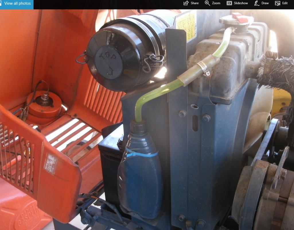

It's getting close to winter and need to get back on getting antifreeze in the cooling system.
If jkk is still around wondering how he added that overfill bottle. How is the overflow hose added if there is no place for one? Do you have to drill a hole in the radiator neck?

Great fixing the tech driver.
I just removed original over flow hose then replaced 3/8" clear hose to a bottle(attached the bracket for bottle with pop rivets).
The extra hose in the middle section was for protecting from rubbing.
Jkk
(I was so busy to cleaning the property before winter raining season
Yea. Thanks jkk! Must have been tired when I asked! Without a temp gauge worried about disabling the whistle. Think I'll implement this upgrade after I add a cluster of gauges like bill did.
