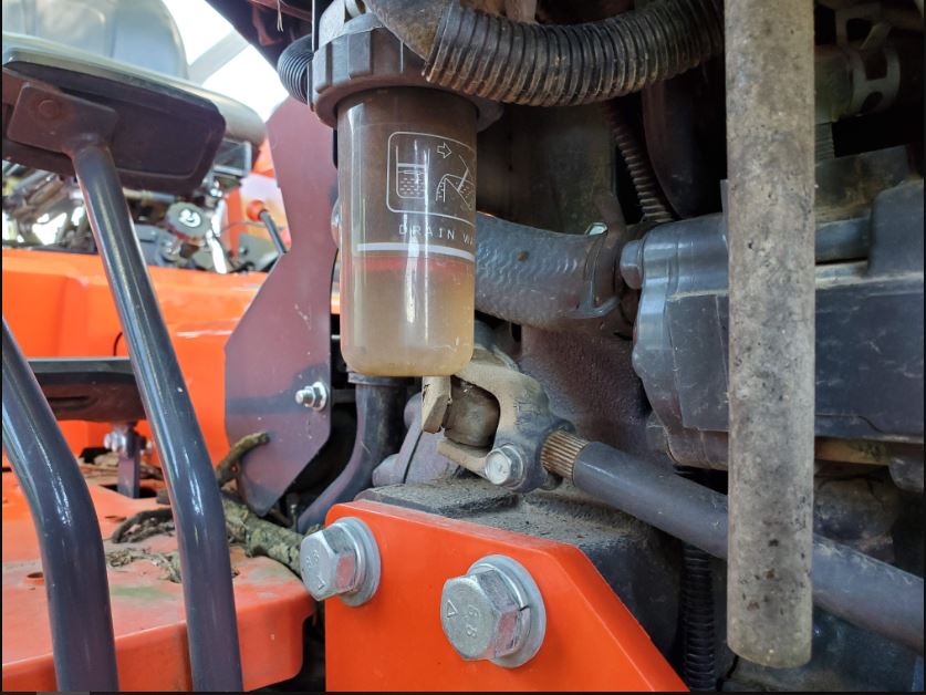

I stopped by and looked at tractor on my through today to check on a few things mentioned. Pic shows water definitely in system. Tank was still full of fuel so, siphoning going on.
I think I will drain fuel from tank and see how it goes and get the additive from Napa to help with moisture. I’ve got some gravel that needs weed killing so that’s we’re I think old fuel will go.
Thanks a million for all the input and suggestions. Big Orange comes through again!

Update: Drained tank, flushed lines to spin on filter, replaced filter. Partial filled tank with fuel and additive. Run a short time and separator full again, there must be some area that held water and slimy gunk. Drained separator again and had partial refill after running mower a few minutes. Decided to remove tank and power wash inside to clean well. Will rinse with alcohol and leave in sun to dry out well. Refill tank, clean separator, flush lines, and replace spin filter.
The stuff coming out of tank is slimy and chunky. No bueno.
You might want to power wash it inside with Purple Zep or Purple power and then rinse it with acetone, not alcohol.

The common rail engines are "extremely" intolerant of water, so make sure you get it all out. Well they'll tolerate a tiny bit (as in parts per million) but if/when the supply pump fails, you'll be out thousands. They-and the rail, injectors, and sensors that all come into contact with the fuel-are NOT cheap! They also don't like gasoline in the fuel.
