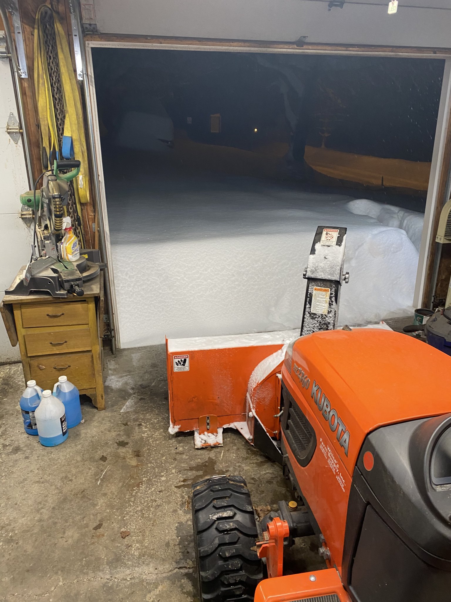

I was thinking about front chains for the new snowblower.
I've done a lot of snowblowing with a BX.
Is your snowblower front-mount or rear (3-point hitch) mount?
Many folks will say NO chains on the front tires. Period.
However, many guys/gals do the fronts. Some only the fronts, mostly for steering.
You ask left or right?!?! I've never known chains to be applied to one side, especially fronts. Doing so will be more likely to cause damage in my opinion.
The problem is when in 4WD, if you have good "bite" the chains can help tear the front drive system apart. The front wheels turn at a faster rate than the rears, and when turning the rotational difference between the two front tires causes more stresses.
If you only use 4WD when in "loose" traction, there should be no issue.
Are you planning on putting chains on the rears?
I cannot navigate with a BX2360 without rear chains. I have some grades to work. I do lose some steering without front chains.
I cannot navigate with a BX2360 without rear chains. I have some grades to work. I do lose some steering without front chains.I have chains for my fronts on my BX. Haven't put them on in a couple winters. It's close quarters to put rear chains on, but more so the fronts to clear the tie-rods etc.
