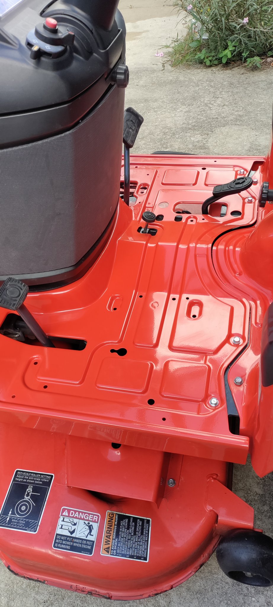

Well, this time I was impressed by my dealer. They picked up the tractor Monday in the morning and delivered it in the afternoon with the new floor and all new bolts at no cost to me. The only issue is how am I going to know where the parking brake pedal is, since there is no decal anymore! :ROFLMAO:

As fried1765 said, I also used Herculiner. I had no mat but the paint on the floor was pretty worn, to bare metal, in too many places. I was skeptical at first but its been almost a year's worth of tractor use and it has held up great.

I went wit a coat of fluid film on all the floor and another coat on the underside of the mat. Next time I take MMM off, in about 10hours, I will coat the underside of the floor too and the mower deck also.

Fluid Film is not a bad idea, but Herculiner (without reinstalling the mat) is a permanent fix, and not a gooey fix.
With Herculiner, there can be no trapped water.
Any accumulated water just evaporates when the sun hits it.
