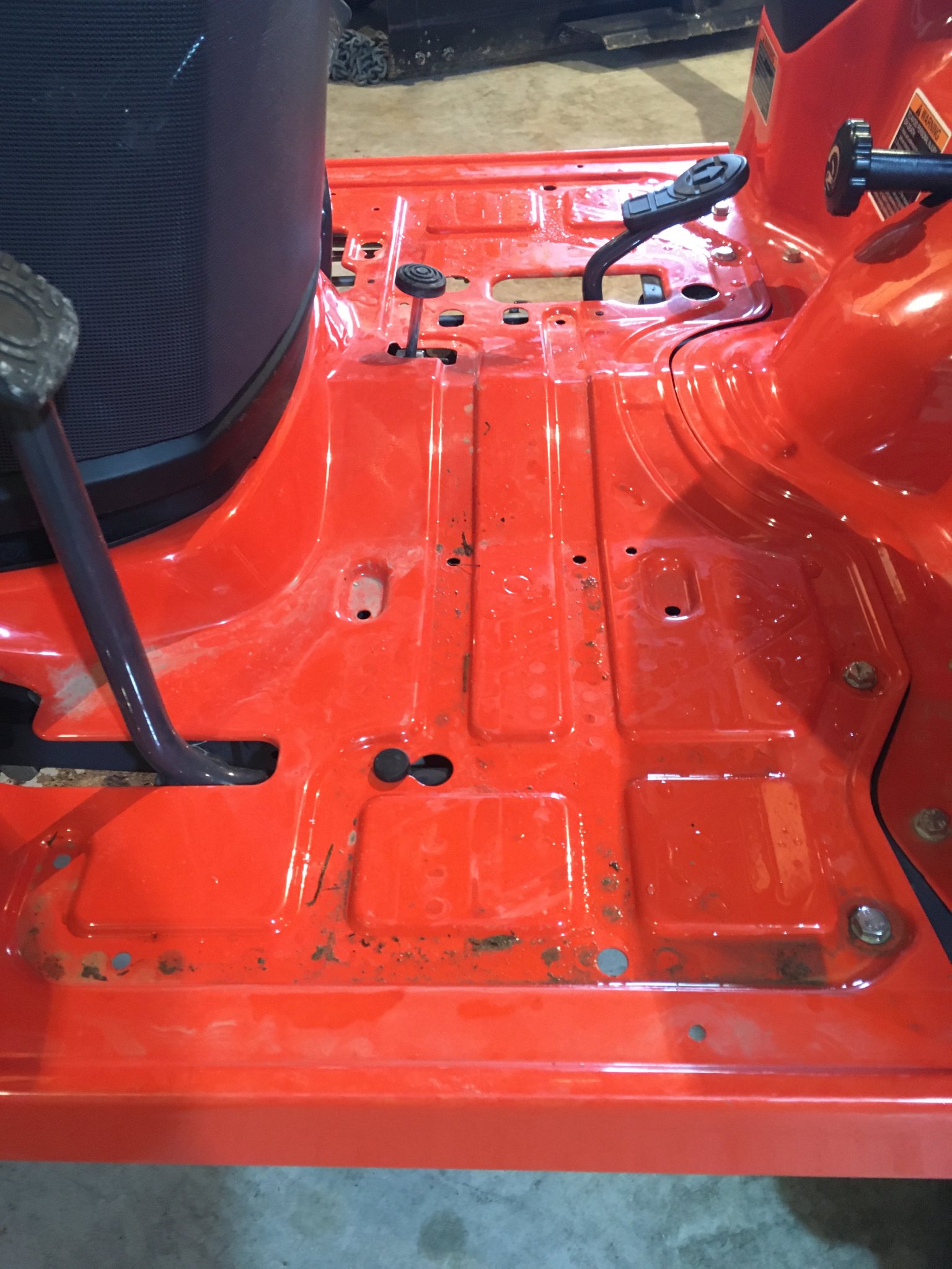

Last Saturday was a weird day with the tractor. It started with weird color and smell Diesel that is being checked by the State's Consumer Services (but that is another story) and then I found my floor pan had rust everywhere. I initially saw a rust spot by lifting the corner of the rubber mat and I decided to remove the mat to clean and inspect. What I found was that paint had bubble up around every one of the holes on the floor. I started scraping the left side and then I realized that it was all rust under the bubbles.

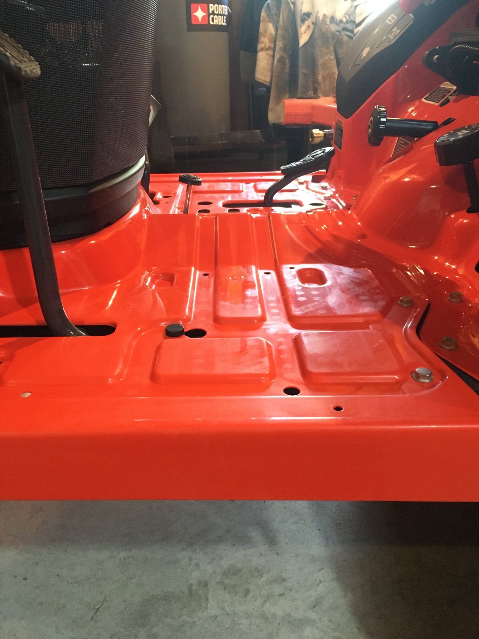

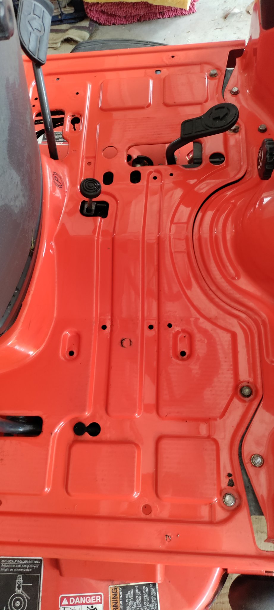

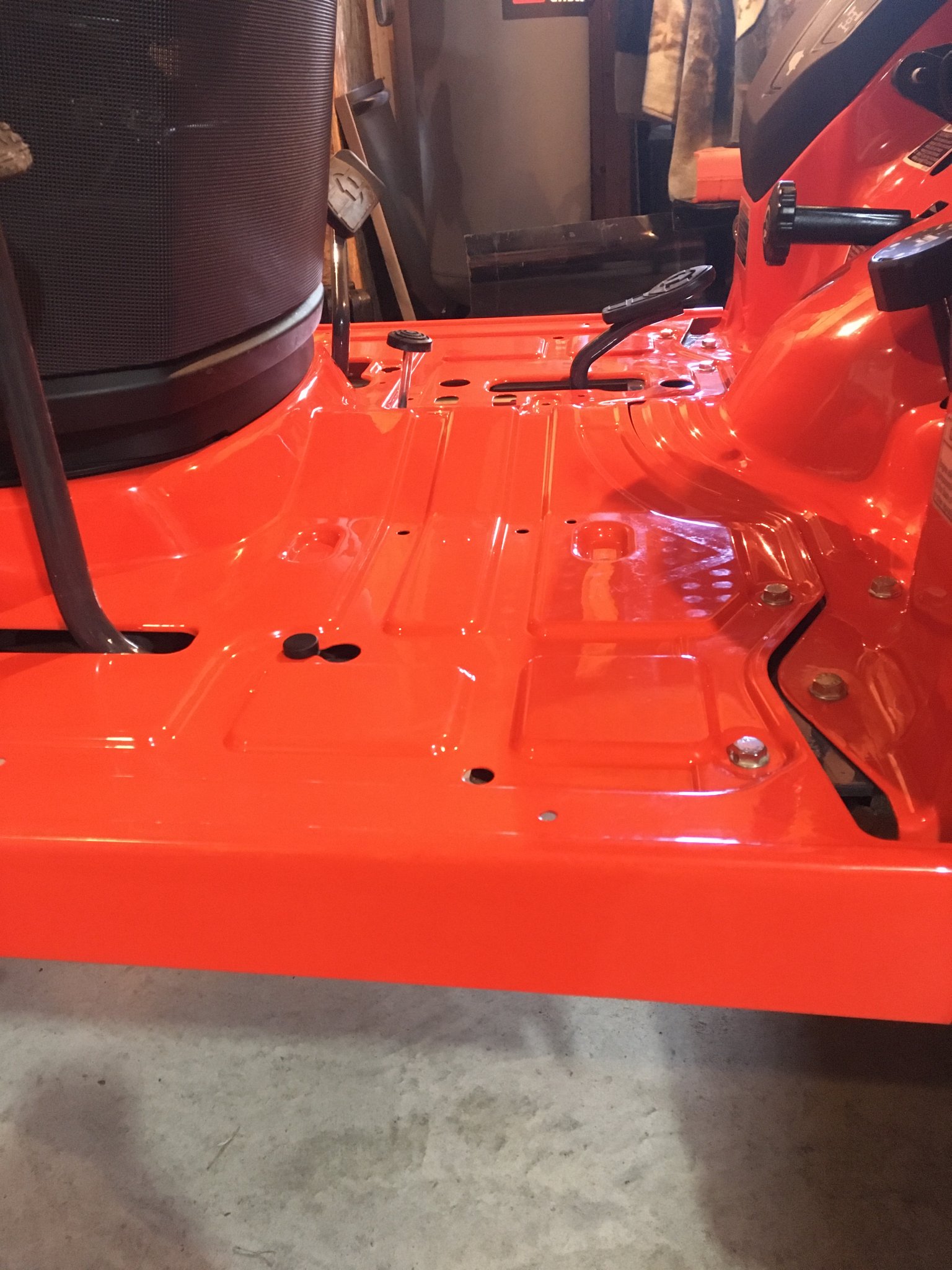

This is one thing I try to keep an eye on. I was thinking about doing it yesterday and didn't get to it. Thanks to you for this post.. I was able to get to it today. View attachment 66519 wax on View attachment 66520 wax off View attachment 66521 No rust but I can see how quickly it could happen.. can't handle rust!
