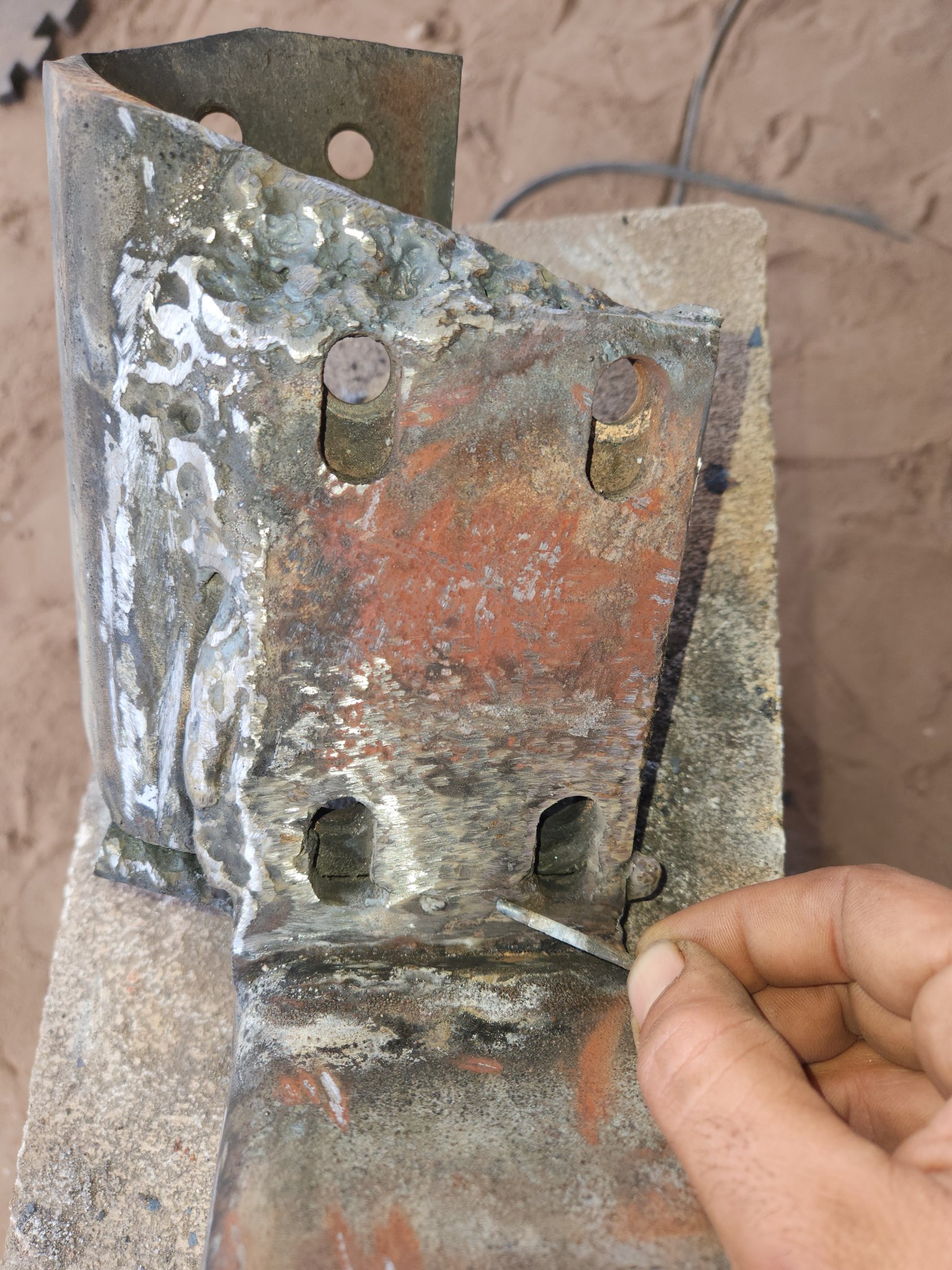

made a mistake, experiment with even bigger flame
articulate mistake: you didnt have to introduce those thin plates, that added height, messing with the bolts/placement/everything
no, take off those plates and just mate the 2 massive thick plates using crazy flame
a bit nervous: but turn up the acetylene even higher at the tank control, turn thick steel into molten with insane flame
current problem: to get it to molten would be an hour of holding still that flame, you get tired about 4 hours of holding still
slowly turn up acetylene and experimenting with making it work
make some effort to capture magic trick in video
i show you what you did: put the entire bracket complex back on the chassis, put you in the bolts, put you a clamp to hold it perfectly,
get you that entire steel complex onto the cinderblock,
calm you down and clear your mind, zero clenching of heart, make you some molten for a few hour
do each side using gravity, always where you want the puddle to form, do one side, twist 90 degrees, until the entire thing is all one entity

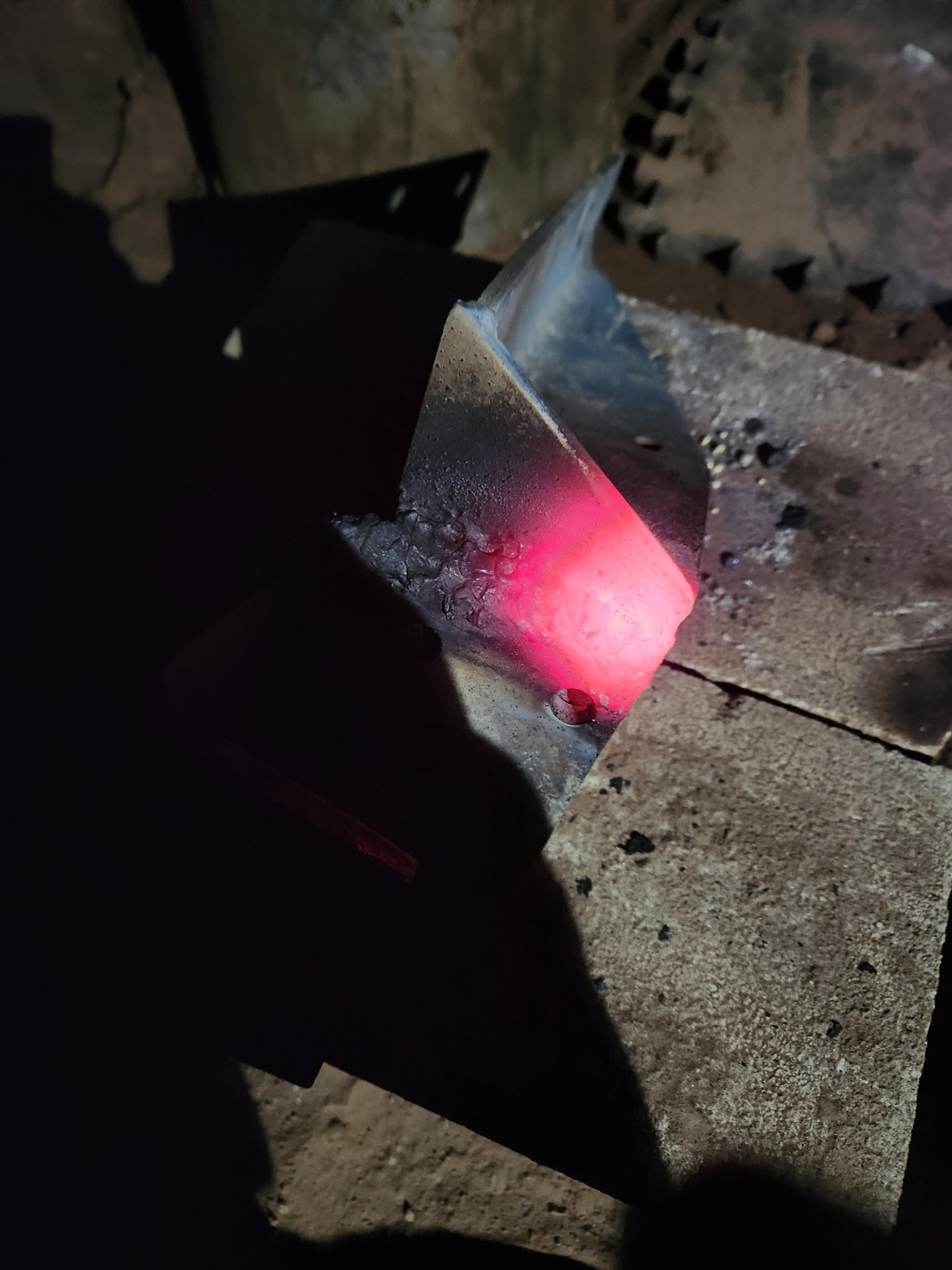

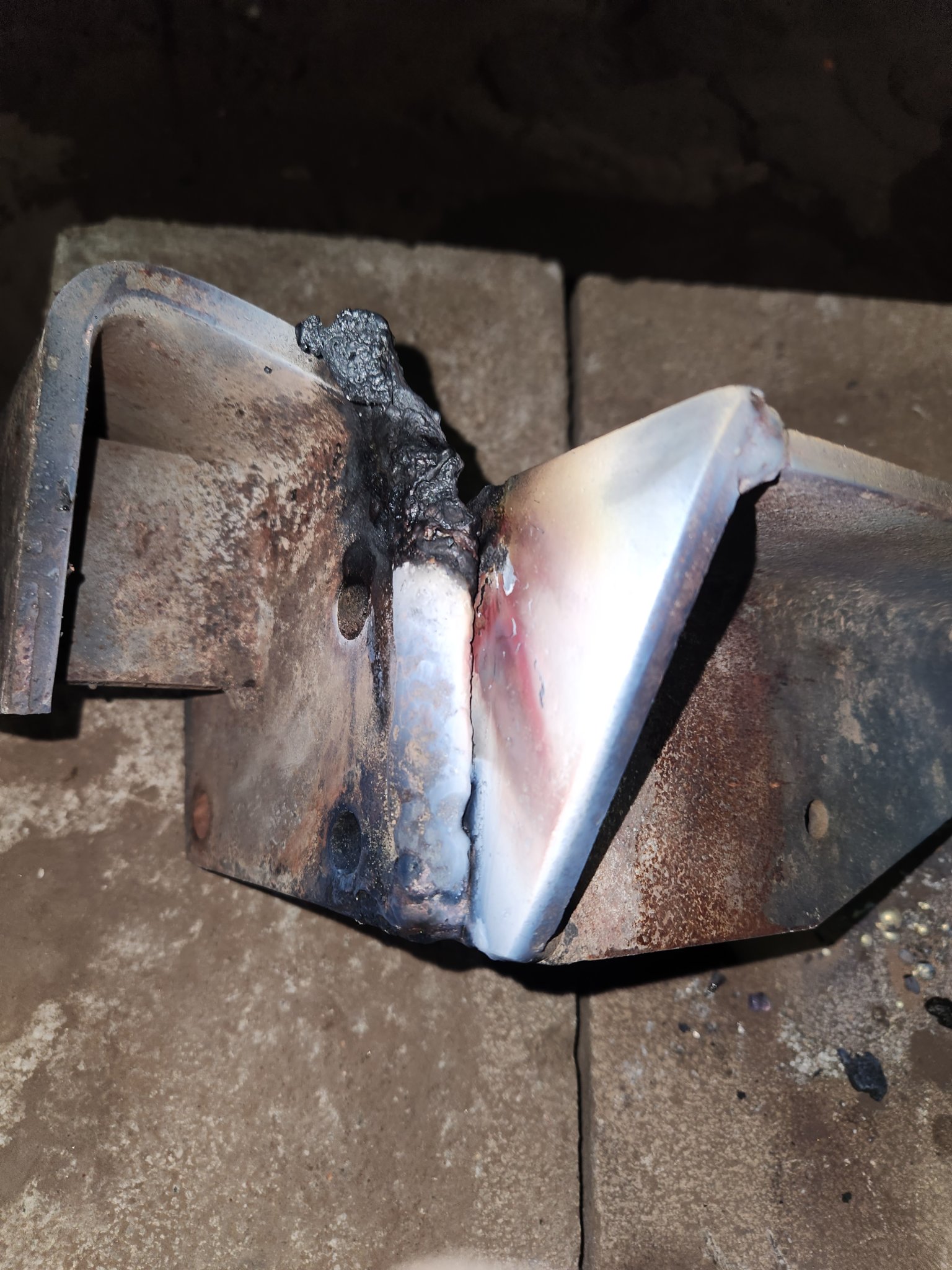

melt rebar where the tear was on your bracket
i show you what you fixing to do:
cut you a piece of rebar where your tear was on your bracket, clean it real good hit grinding wheel
flux the area you want it to sit and set the bracket using gravity to even out the puddle in the shape you want
give it INSANE direct flame for dedicated 30-40 minute
see if you can get your tear to strengthen using rebar
(I looked around the shop could not find any thick steel plates, in the background search you for tons of steel plate for good deal, scrap metal)
cut your rebar to size, grind your rebar with grinding wheel
setup where you want your puddle to go down with gravity, aiming where it goes
point you the most insane flame downward for long duration
melt half of your rebar onto the bracket with insane flame
bend down the rebar while it is molten with hammer to accomodate shape of your bracket
flame keeps shutting off, aceteylene valve open, something off with your adjustment at the cylinder
one side done, flip bracket 90 degree and do the other side,
sear the high point into molten and let it fall into the other crevice
there is nothing wrong with your adjustment, your just running out of acetylene
thats the best you got it with the low aceytelene pressure
your all out of aceteylene, thats the best you got it
arrange to get acetylene, give the bracket a shot the way it is, expecting it to break
when acetylene flowing, you have immense power turning thick steel into molten, you using magic to change your reality
when aceytelene not flowing, superman lose his superpower, you can't do the magic trick, you are deflated
fill you up that aceytelene tank asap
this new challenge is fatiguing you, your heart/mind turning to molten to accommodate the challenge, let your heart and mind turn to molten temporarily while it rearranges your skill,
just like the molten erupting, letting go of its strength when it is liquid so it can connect with the other entity

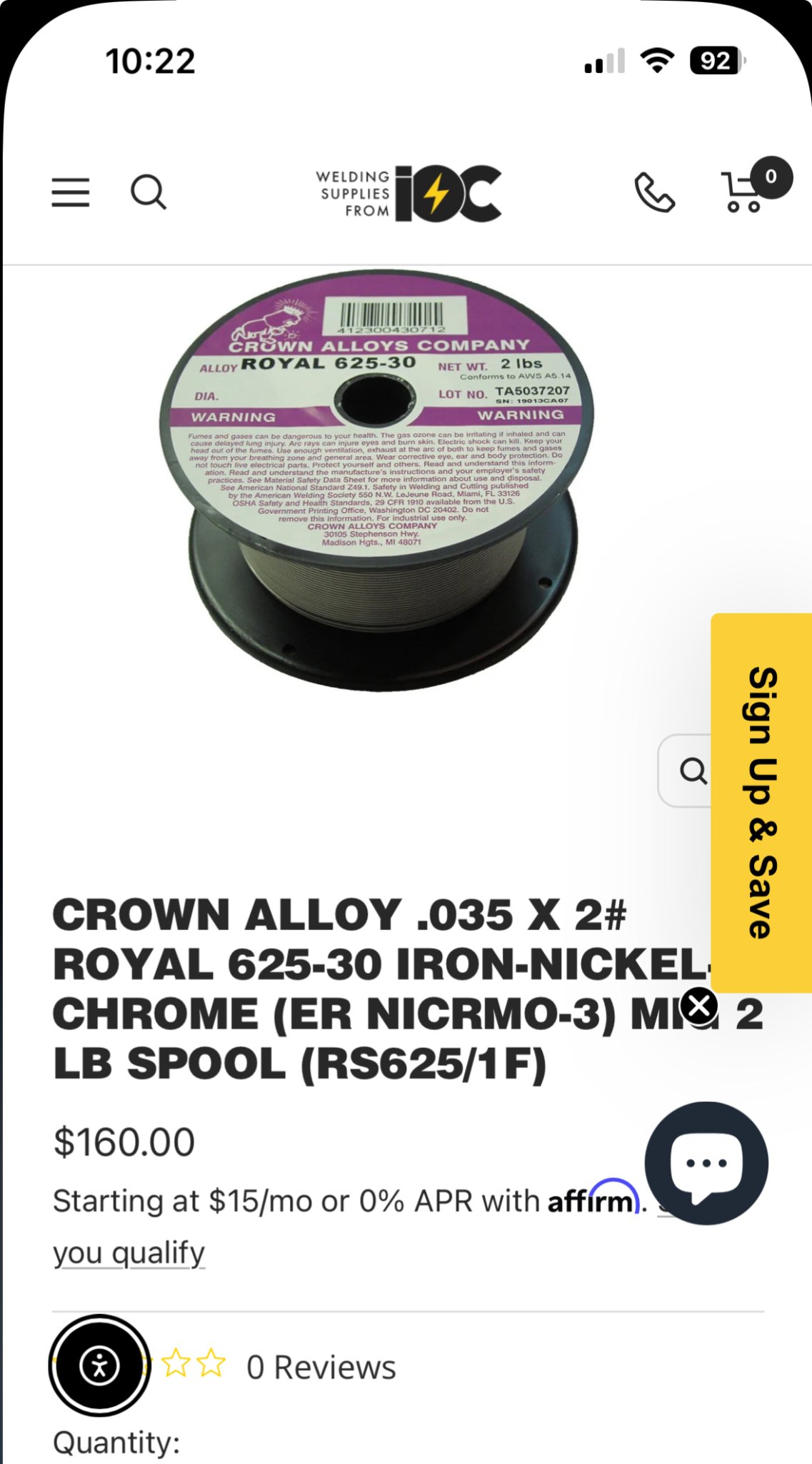

Forget Acetylene, use a mig welder with nickel wire.
Ridiculously expensive, but made for this job. I have not tried it but I’m sure I will someday. Maybe glue it in with JB and tack it with Crown Royal:

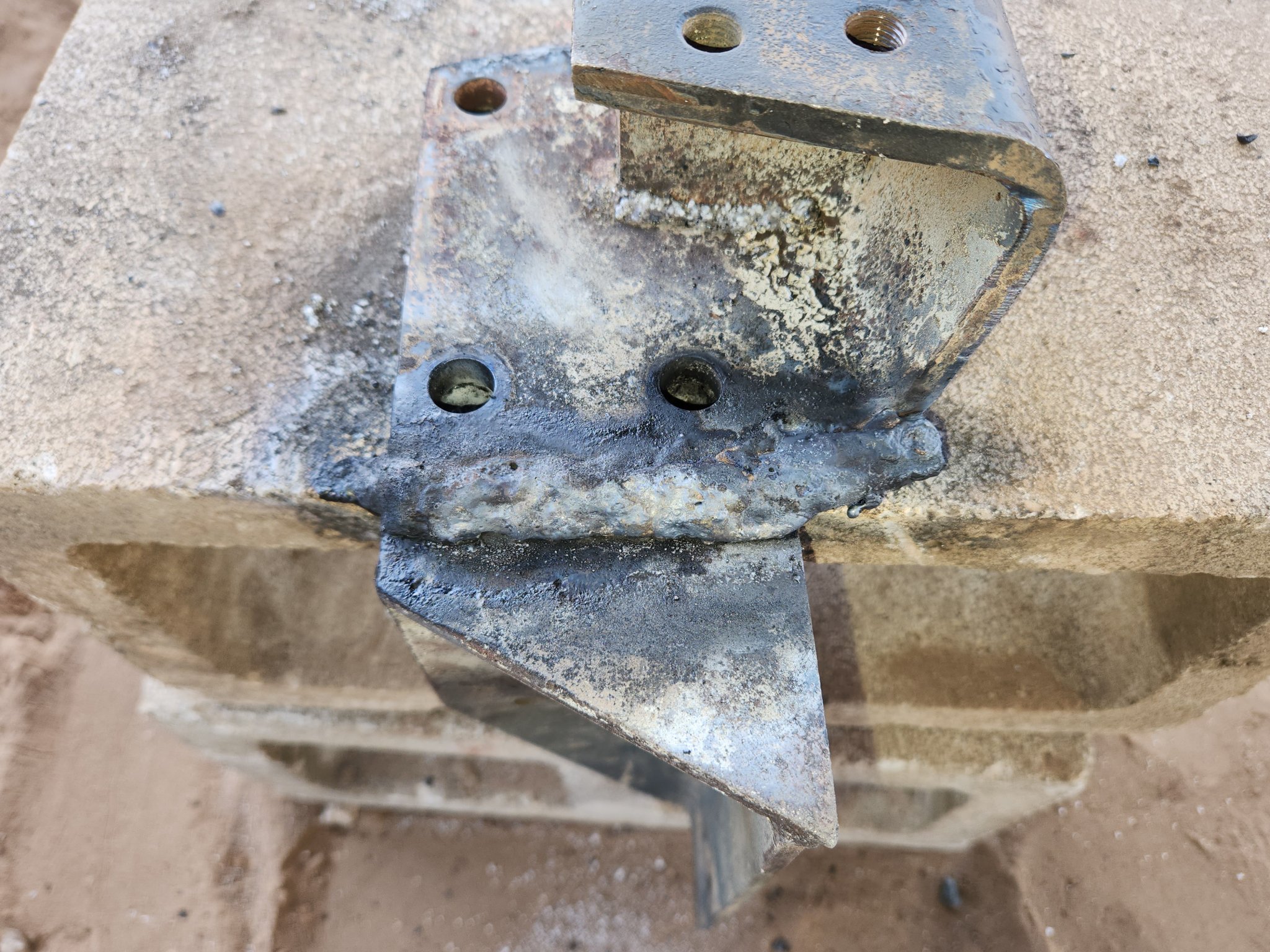

You need welding gases, try bracket as it is
your massive welding tanks are showing 0 on the main gauge but still putting out tiny gas
you see 0 on acetylene and oxygen
will your rebar welding massive bracket complex hold? definitely no
you point: the magic trick successfully binded them but the heating/cooling formed a crack in your magic trick
melted on rebar hit it with some grinding wheel
mock bracket back onto your tractor, and you can see:
you can melt a massive piece of steel along the path of the socket extension later once you get gas that would not interfere with the bolt holes
for now: put it back together and move you your realm a bit since you cant get gas for few days
put you on all the fender, big bolts onto your bracket contraption
you shape realm for 30 minute, woah, somehow your bracket molten contraption holding, unbelieveable
but another major tear forming now, this was welded 10-20 year ago and now it is kaputt
once one tear closes in your steel another tear open
40 minute of lugging around your realm, your molten bracket rebar contraption break

The weld that lasted about 40 minute of earth moving:
notice on this side the rebar did not melt into the other half of bracket
on other side: you can see rebar successfully melted into bracket

heat you up both entities with more aceteylene and less oxygen for 5-10 minute
once everything hot,
turn you up that aceteylene slowly and test out how you feel about it, get comfortable with it without any hurry or pressure
then melt you serious molten along the path of the tears, have you maybe some nails close by to use as filler
test out the theories where you stay on one area, errupting it into moulton,

setup bracket properly, melt it back together where it tear, then later do the other side with the rebar

flip bracket other side, get you ready bind rebar and bracket
yes, turn you that steel into moulton, bind your two entity
the angle you point that big flame matter
sign that your two entity binding:
When you are pushing molten successfully into your other entity,
It will have a resistance since it is binding two different temperature metals, and
sparks will start to fly of a differen color, giving you the knod that you
are successfully binding the two entity
wow
low spot and you want the lava to puddle there:
point the flame at the high point at an angle pushing lava into your lower area where you wanted the lava to go

Ditch the gas welding, it's not going to do it!
You need arc or Mig, either will do it.
You can get a 110/120 Volt mig welder that will weld that.
A 220/240 volt welder would be better if you have the service for it.
