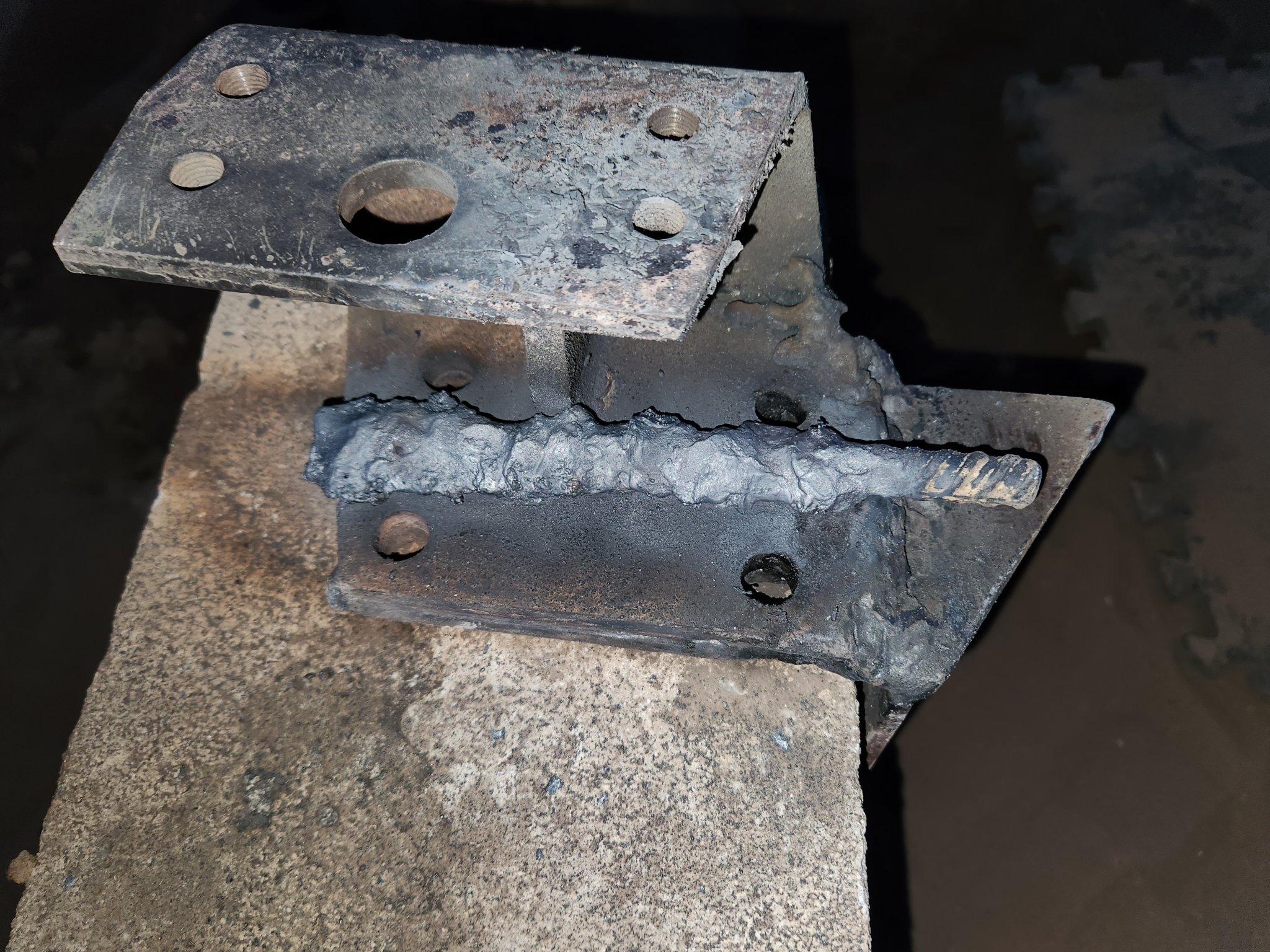

make you some moulton
assess your harden lava, still a crack where it broke, but sides hold hopefully
show you what you fixing to do:
melt you a piece of rebar in the line of your nail, encompassing both entity for more structure support
your mind filled with nonsense and have too many task on your life?
say to them: yall hold up while I go play with lava and forget about english language for couple hour
grab random piece of rebar and it fit perfectly, melt it right there, gravity will be your team
grind down your rebar and it seat
first you melt the larger side onto the bracket, then get you small side hanging hot, smack with sledgehammer, then continue doing magic trick to make one entity
go you now get you lost deep in that moulton
your flame keep hissing, take you out your tip, run through part cleaner, hit with compress air
melted the rebar but didnt stick to the bracket, more heat
the bad flame disrupted your progress and your magic conduction,
need way more heat on the area for longer period so it bind to your bracket
have you bunch of task and too over burden? get you lost in that moulton, forget you about english language
yes, with the big flame, melt you thick steel until it is one entity

Observation on welds.
I understand that this is about experimentation, but consider this.
Nails are purposely made ductile. They are also coated with zinc for outdoor use. Ductile means that strength is sacrificed. Zinc will make for poor welds, as it interferes with the bonding.
Rebar comes in different strengths. The lower grade is less than what would make a good quality repair weld.
Lots of heat for extended time can cause loss of strength. Tempering may be used to correct that.
Instead of gas, an arc welder will minimize the amount of heat and time. The use of sticks will provide the proper strength filler material without guessing, and allow more material to be in contact which allows more strength per linear bond.

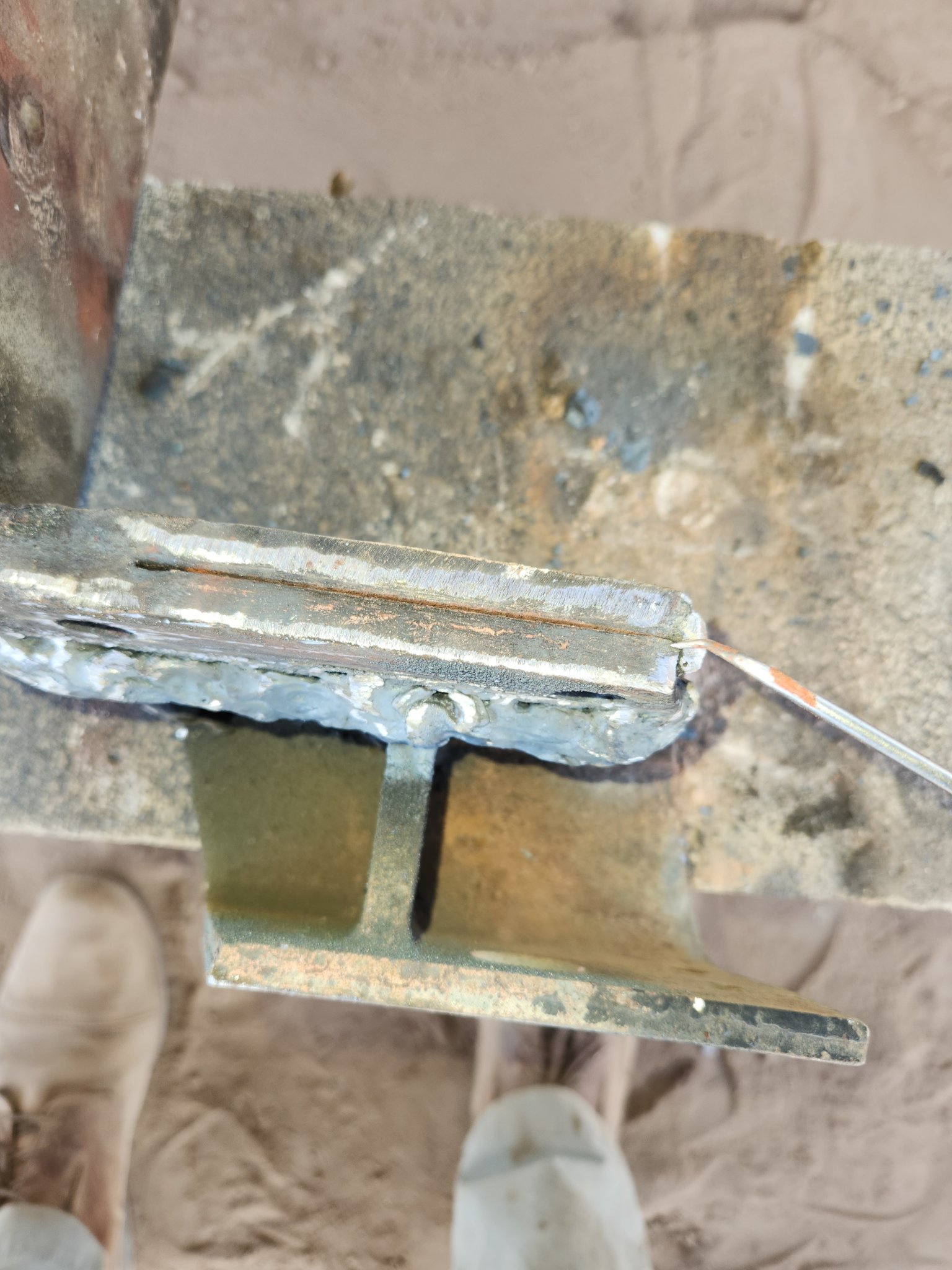

Assess your harden molten
assess your moulton, see if your two entity become friend
you might melt this part together but maybe not
show you the crack that from along the main break, maybe hit it one more time hard
this part directly above the crack that form, you might:
put it upright high spot up, aim the flame directly down, and make massive moulton puddle that could connect it all,
and give you more assurance
let you the narrative marinate, work also on the other magic trick
summary: keep you trying to become magician

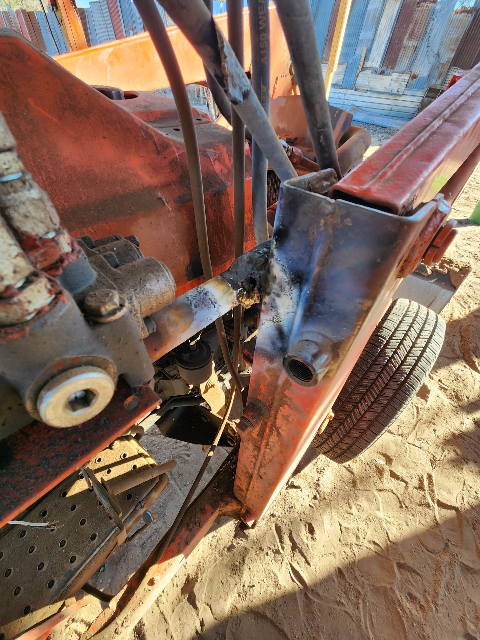

your busted fel valve:
prop it tight using lumber, successfully do you a smaller magic trick
your torch always hiss, clean
hopefully your busted fel hold
your busted from fel support, what you fixing to do:
melt you the thickest piece of steel you got laying around along the path display in photo
exact setup of how you fix to conduct magic
find the biggest bolt layin roun, cut off head, melt them all into 1 entity
woah, play you with that moulton with zero clench or pain
state you most importan narrative:
there are day when you have 2 dimensional thinking and action, your action will be flaw
other day, you have 3 dimensional narrative: your action and understanding sharp, your action less flaw
go you back to playing with the lava, take off your clamp and finish magic trick
You are way to practical. This whole thread is ridiculous and I just contributed again. Dang.

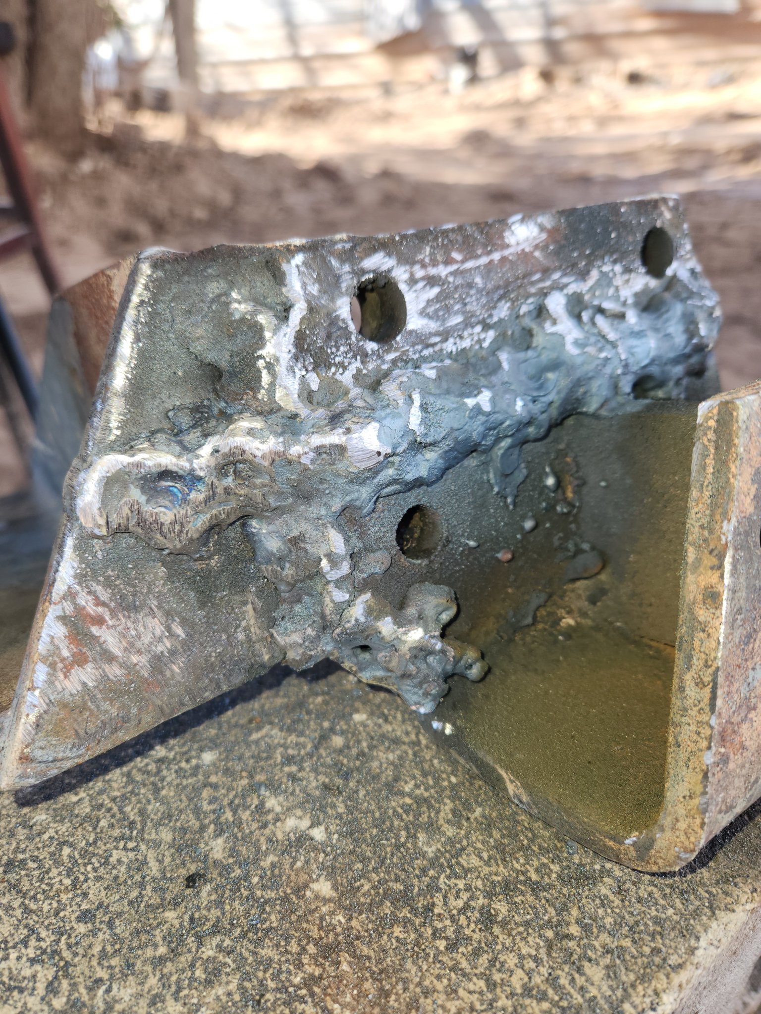

lost in moulton
you light your flame while it is daylight,
get you so lost in the moulton, play a game with lava, manipulate into the low point,
swing big big flame around adjust angle of flame playing game with lava
then you finish and turn off the flame, take off your dark shade, and it is pitch black outside
you were so lost in the moulton, that you forgot that time exist
wow
get both cross section, you would not be surprise if this weld hold, but not fully certain
hit you your bracket one last time where the crack form
when you make that moulton bring 2 entity into one,
your brain also reconnecting with a part of itself that it has long ago not felt
get you lost deep in that moulton, forget you about all their artificial everything,
make you moulton for hour upon hour, your brain, heart and physical body start to become one entity, just like the steel
woah

Some of that molten splatter is disgusting!!!!! That would get a high school kid kicked out of shop class permanently.

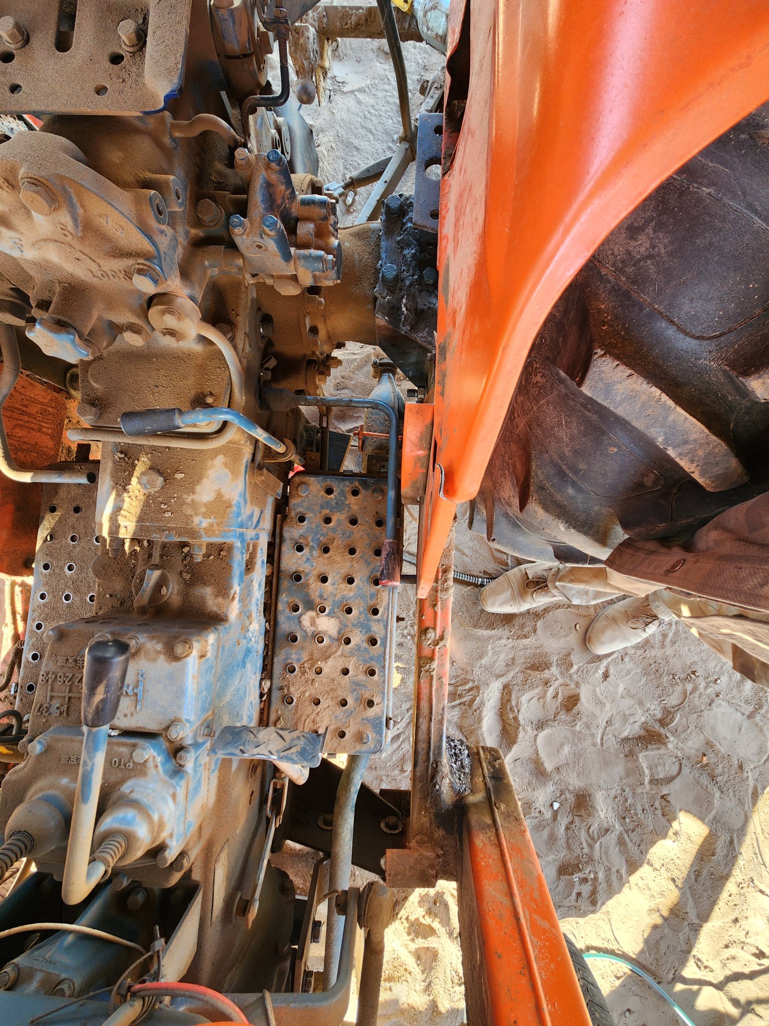

one more big magic trick, see if your robot will hold as you carve earth
put you in a bet, will your bracket hold?
you say it hold for 5-7 hour, whats your guess?
do you a big ol magic trick, try it capture with camera and show the world
hold together big steel tight with big clamp
loosen your slack on your overall,
enjoy you a dance with the moulton, caught on camera
your moulton puddle block the entrance of your bolt, spend you time with drill bit boring the hole, thinking,
"woah, how does that big flame manipulate steel and it take me real effort just to remove tiny of it?"
power of that big flame smack you right in the face
will your rebar moulton nail bracket complex melt contraption hold as you shape realm?
use clamp to get your massive bolt to connect together your robot
put together your robot, put the clamp back on exhaust, put gorilla glue so bolt dont come out,
bolt came out, exhaust was hanging, busted the hole again into your exhaust manifold
