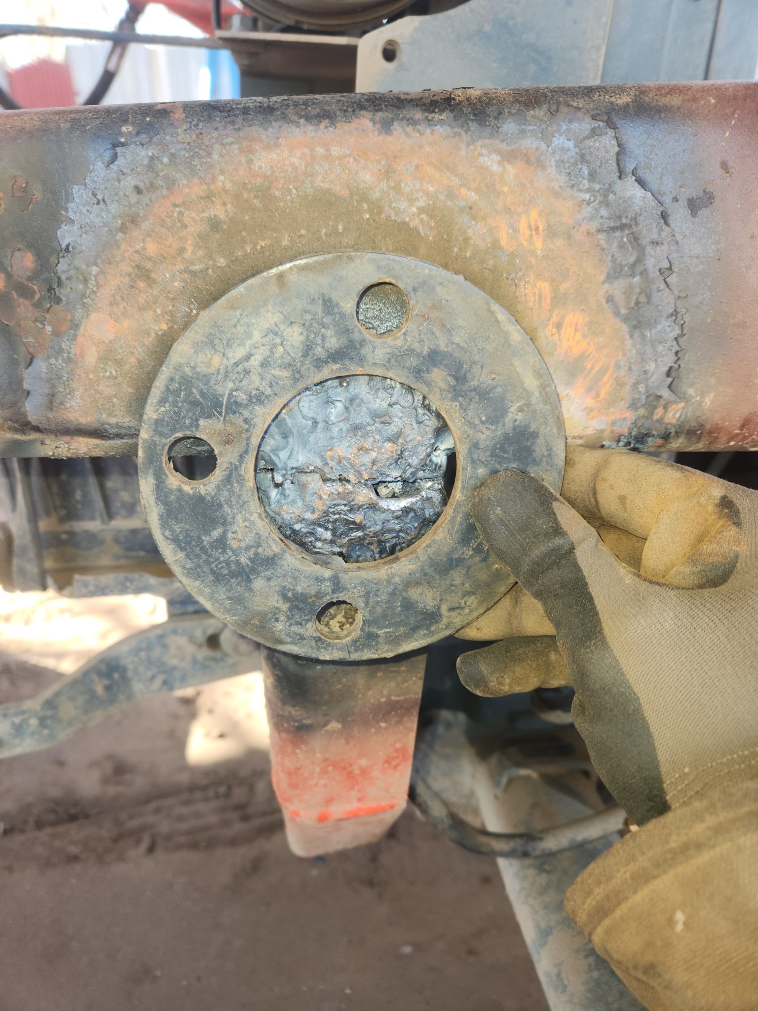

wheel spacer hold together your robot
your robot keep busting through your magic trick
get you a thick wheel spacer, first melt onto the top steel rail, then
heat up the center part of spacer, smack with sledgehammer while it is hot,
bending it the shape you want, then
melt you the entire spacer onto both rails,
in hope your robot stay put together
hit everything with grinding wheel, wipe with part cleaner everything
melt half of your wheel spacer onto the top rail
heat up wheel spacer evenly with big flame, smack it with hammer, weld broke
clamp it back up, go insane with flame connecting your wheel spacer to the steel rail
this time: dont smack it with sledgehammer until all area melted together
big ol flame in left hand, sledgehammer in right hand,
heat up your wheel spacer, smack it with sledgehammer shaping it to connect properly to your 2nd entity
did narrative not tell you already, that
you are your ancestor, in a dreary shop, playing with molten, in 1680 something?
pump you insane amount of gas committed to holding together your robot
thousand plus post into your thread, become you magician to make your robot 1 entity
pump you dollar and dollar of magic gas, make you strides going from bottom to the top
fuse together your robot
hour and hour go by, melt you wheel spacer on your busted support, say you:
if that weld come apart, your fixing to shut thread down and give up completely

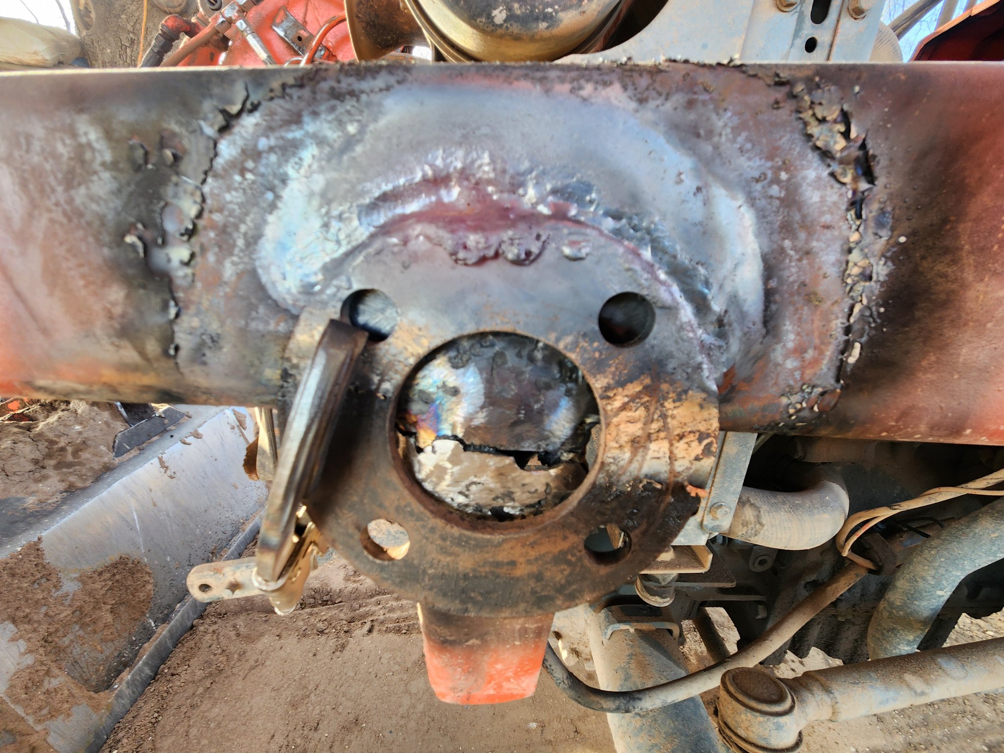

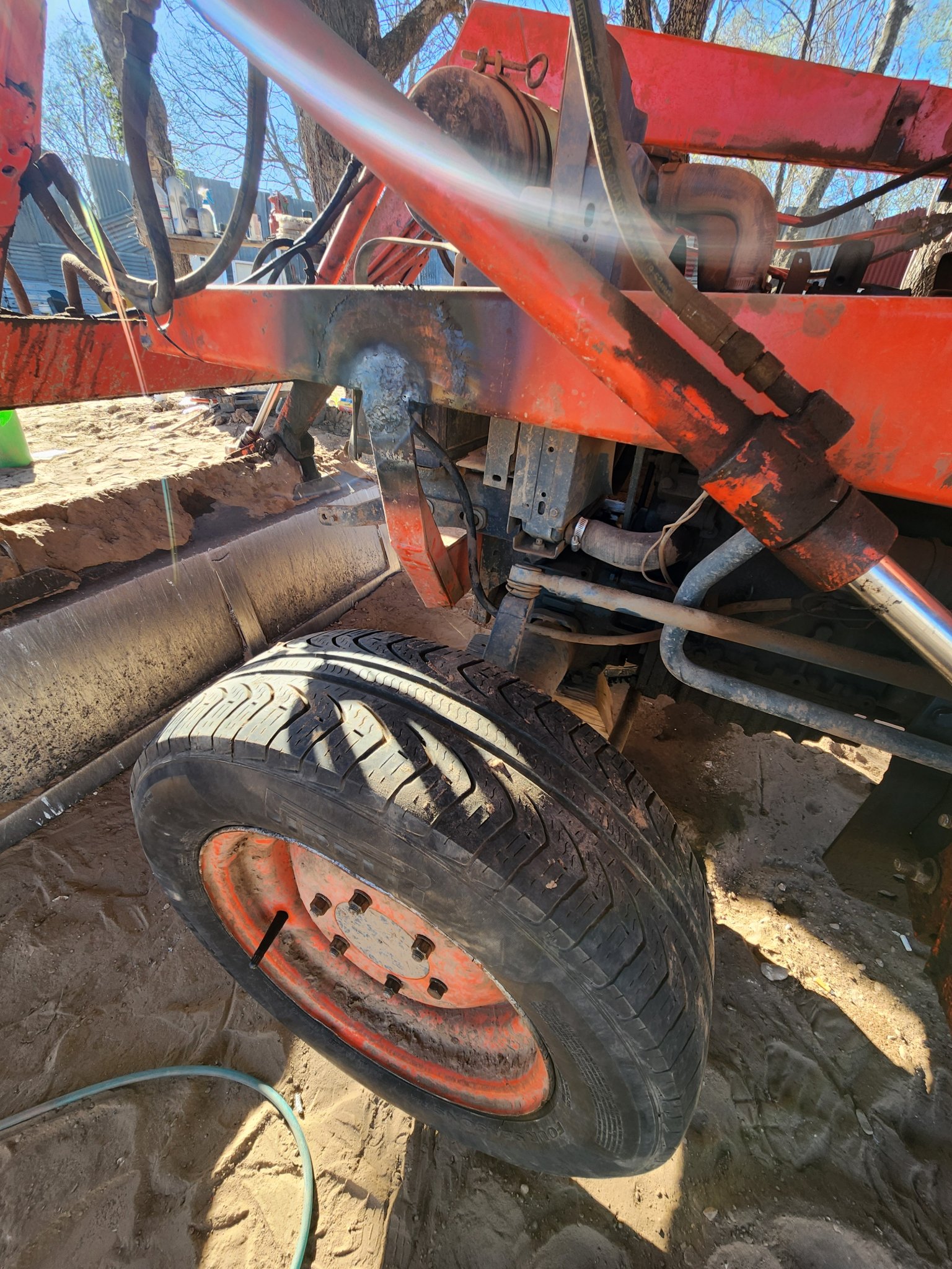

will your robot hold, proof that your an idiot (the OP)
woah, shape your realm for 30 minute, and
your wheel spacer molten nail steel rail complex holding
you spent 50 dollar just in magic gas to do the magic trick
joesmith an idiot:
reflection: you broke your entire robot because you ran your robot with brackets not attached, meaning
if you would have just stopped your machine and fixed the broken entities, you would not have this big steel mess
you even made a crack in a MAJOR support that was not there because your an idiot
if your robot stay put together, surprised you will be
unbelieveable how big an idiot joesmith is

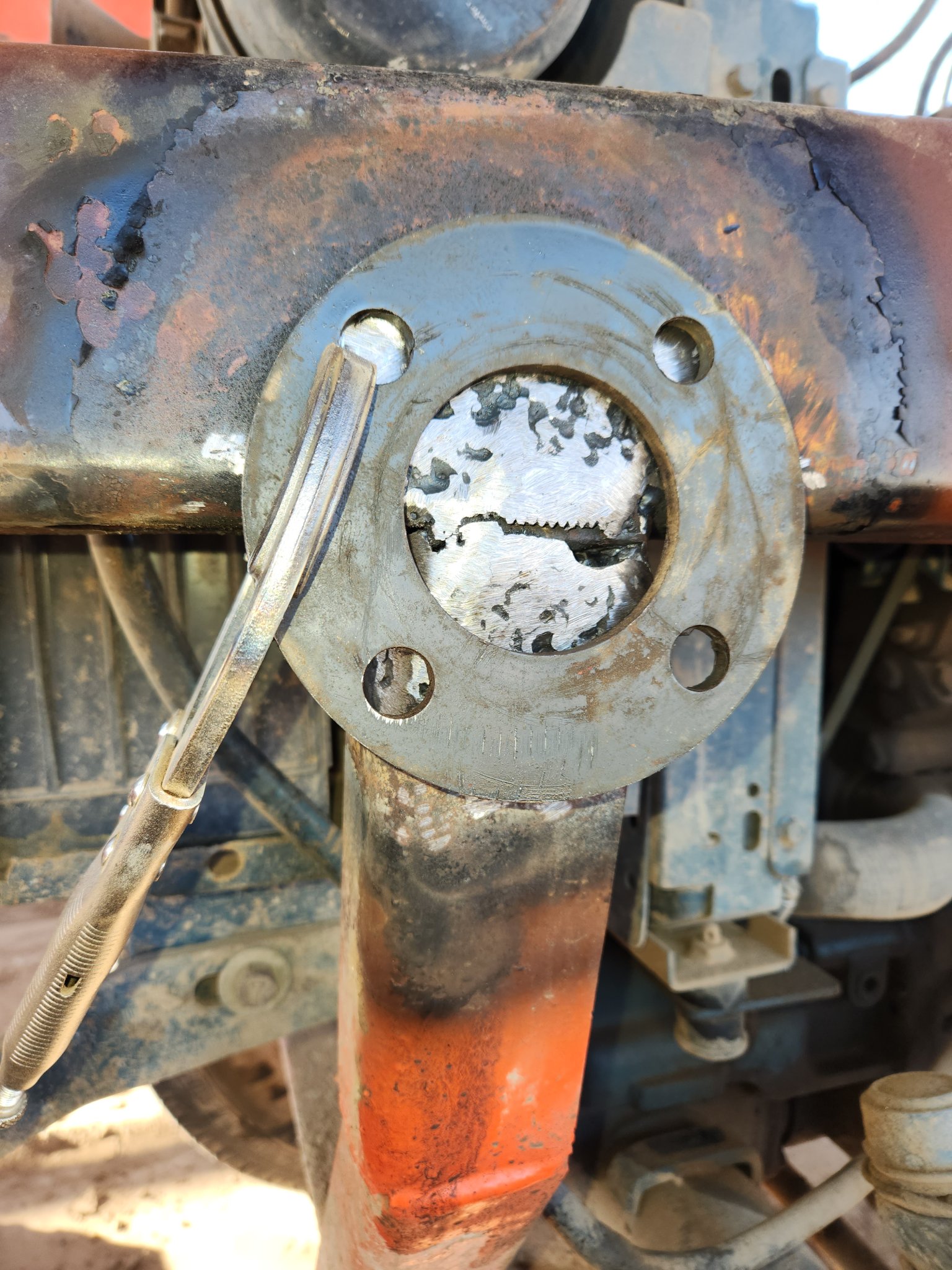

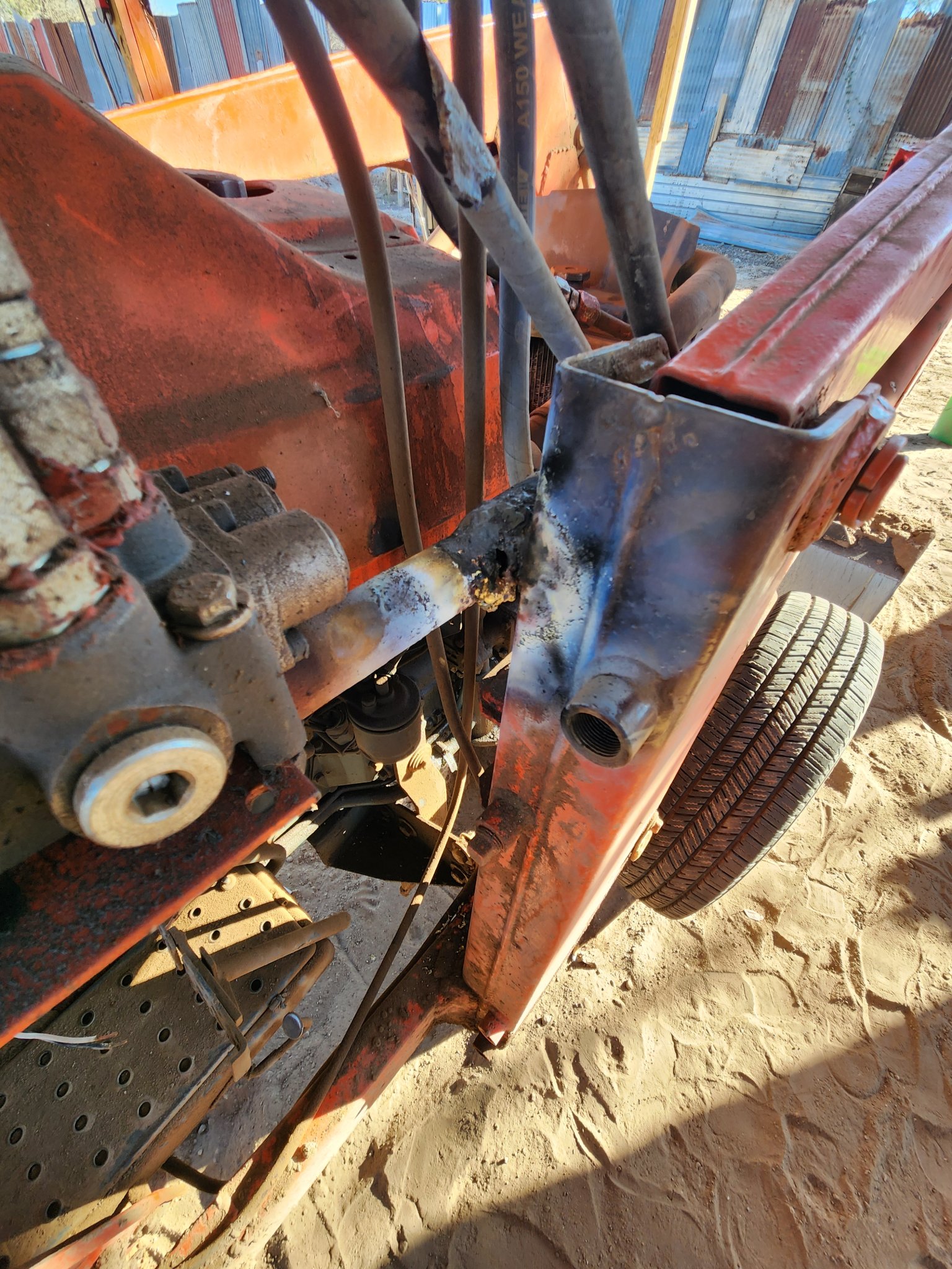

This is that crack in a major support
Say to yourself you're an idiot

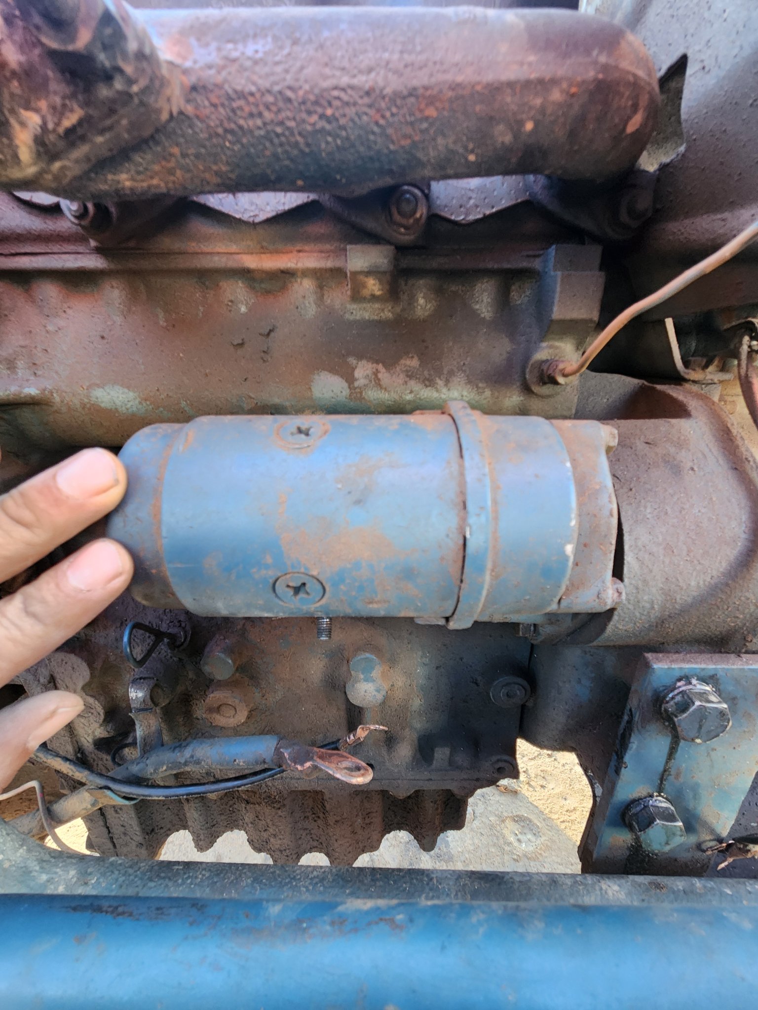

you mighta broke your starter
i show what happen:
your voltage reading 14 ish near the start solenoid, when you crank, it go down to 12.5, meaning
battery is strong, but
your starter acting like it dont got power, and it cannot spin fast enough to turn on your big diesel
what you fixing to do:
first, try to get the starter from your 2nd d1301 and see if it crank better
you checked all wire, everything tight/strong, hit it with file
take you off your current starter, try to put the 2nd starter
reflection: what an idiot, you went through the entire trouble of building the entire tractor down to the crank,
and you cant get yourself to fix you those last 2 leaky bucket cylinder? what an idiot
fix you your starter, then seal off your leaky cylinder, the kit come in long time ago
leaking injectors: vibration exposing your flaw in your build, couple injector leak, rear one worst leak

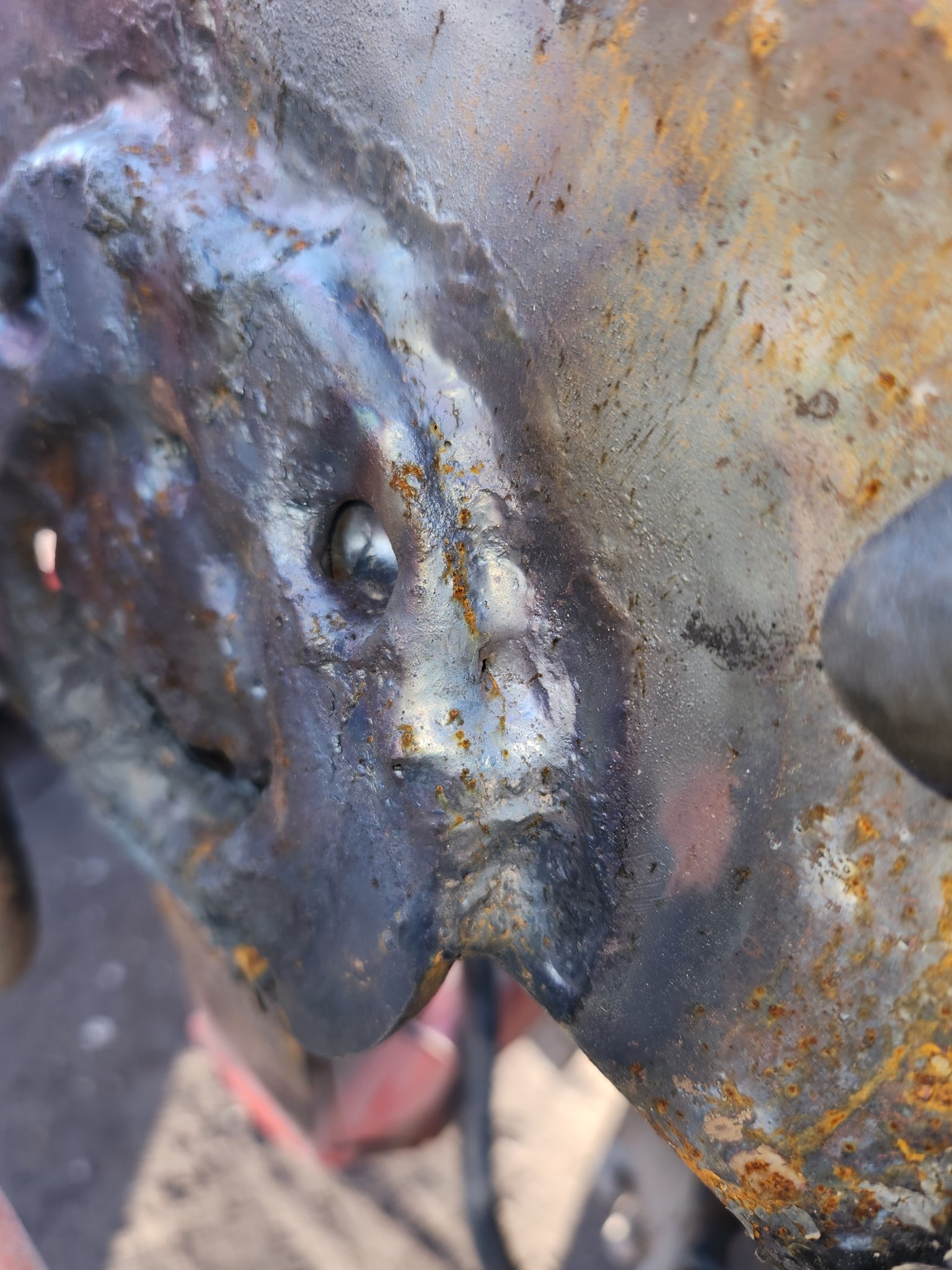

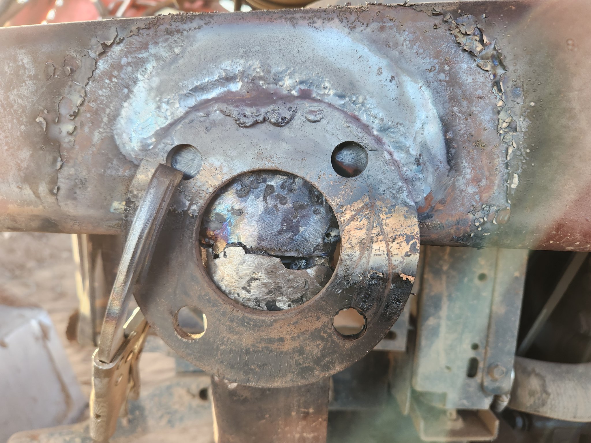

woah, up close of your molten wheel spacer connected to your loader rail, it held so far for 5-6 hour of earth carving
take off your exhaust manifold, try to tighten the top bolt on your starter to your engine block, loose and wont fasten, thread strip
take off your starter, hit everything with file, then clean with solvent, put ton on plumbing tape on your busted thread, trying to ground the starter better to block
this could be the culprit, bottom bolt is tight
i show you a leak that is causing you to stress out your 45 year old starter
this leak in your diesel line is causing you to lose prime, then you over work your starter and now have to take fix it
hit both mating surface with hard wire wheel on drill
clean with solvent
wire wheel all paint off your starter
rig up all your hillbilly wiring, try to start it, nope
even put another jumper vehicle to give more power, nope
it still seem to be ground issue, there is a ground wire smoking on the starter, that wire seem weak
try to rig up a good wire where that smoking wire is, see if you can get it to ground better
get your spare starter from your other L295 engine, boom, she start right up
