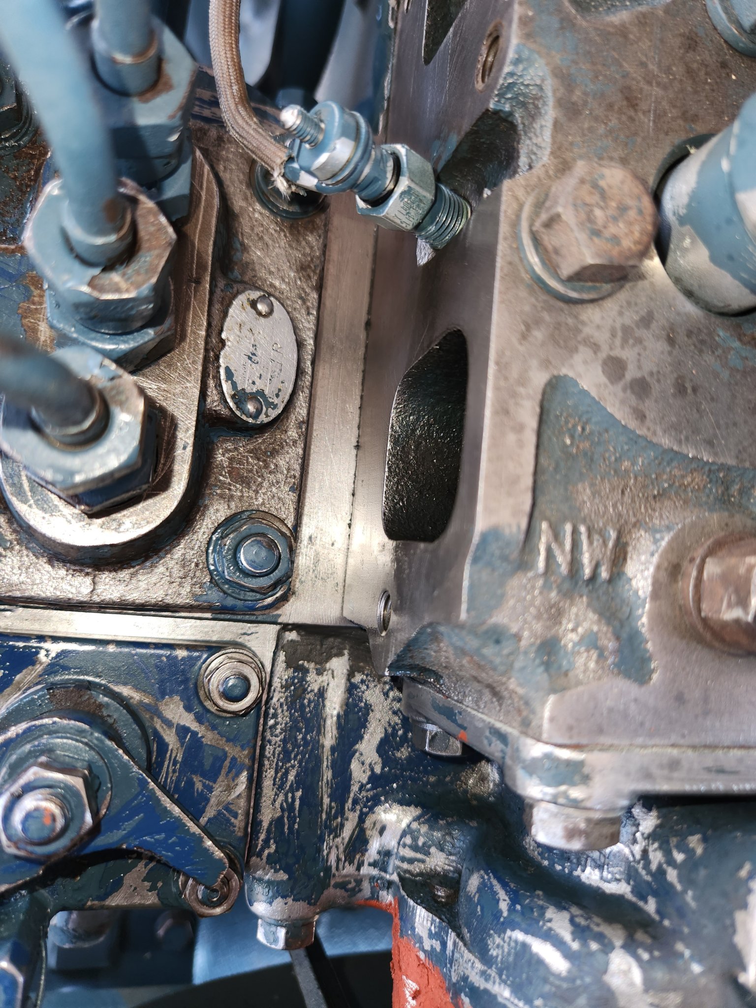

take off intake manifold, picture is after running 5 hours yesterday, i did not clean or hit with air
plan: clean area perfectly, get engine running, shine light, find the culprit, maybe spray soapy water
use small brush to apply part cleaner
hit with compressed air
leak found
exact step to find leak: hit with compressed, brush area with solvent, hit again with compressed air, shine light and use pointy object
It is an oil like like wolf stated
observation for today cold start and idle: she started even easier, seesaw idle going away, sitting at 38 psi oil pressure
I guess break in is a real thing, engine went through one big hot cold cycle, and bearings etc are shaping their way,
kinda like we get comfortable to sit down for long time to watch movie
ok, clip 20 minute after last clip, show you that leak is tiny on injection pump seat,
am i only one that notice, she has less resistence than yesterday? She move through her motion less interrupted...
empty water, remove radiator, remove injection pump
took out injection pump, leak along top left of shim, making its way downward toward gearcase
area on injection that couple with leaking area on engine, notice it is more oil than other area
seal leak surgically, repaint engine, reassemble one last time

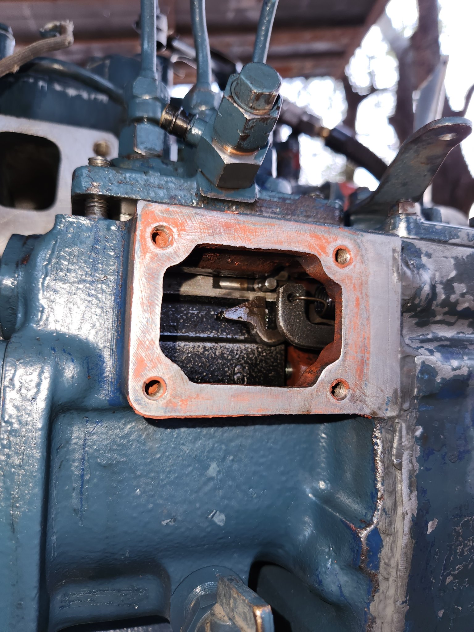

original shims from this build, clean them in solvent, sand them with 1000 grit, clean their seat on block with 1000 grit, dab a little gasket maker on edges, make sure you place injection pump latch into its position properly...
filed all surfaces using abrasives of all kind, clean everything with solvent
had to take out cubby hole again to make sure:
when injection pump fall into place, you must ensure the latch is in the fork properly, or it will cause runaway like it did on first start up
I try to show you how you seal the engine, without any doubt, all surface primed for sealer properly, finger spread gasket maker across all surface, bulletproof way to build engine (where you could have leak)
after taking this picture, i notice the shims were on backward, slot to accomodate latch should be on bottom right
surgical seal complete, tiny bit gasket maker on all surface, finger applying it on perfect clean surface
imagine that it come back to life without any leak, and that the 4 shim make it idle even better
Now: install intake manifold, reinstall injector line, spray with part cleaner everything getting painted, hit with compressed air, hit with kubota blue

They change the injection timing.
Yes, North Idaho Wolfman has said many times that they are critical to the injection timing, so much so that even a light layer of ANYTHING between the shim(s), even some dirt on the surface is detrimental.
That is why I asked the question...
14,599
7,067
Whatever shims you remove from an injection pump you install the same back or your timing will be off.
34,257
9,472
You really need to have the same number and size (yes they come in different thicknesses) then what was in it originally as that sets the injection timing of the motor.
The shims are sized to the block and not the pump.
If you do not know exactly which shims came off of that block (real downside to tearing into mutiple motors and not keeping parts separated) you will need to follow the WSM on how to do a spill test and set the shim count and the timing.
You DO NOT use RTV or any sealant on those shims.
Doing so changes the thickness of the shims thus ruining what you are trying to do.
You could use a very light coat of copper sealer if you so desire.
But really they have a sealing surface built in.
Also If you getting a diesel leak its not those shims causing it, there is no diesel under there.
It's just a very light splash of oil.
A diesel leak will be at the Delivery valves or lines, I will not even go into why you shouldn't open those as you will anyways so good luck.
