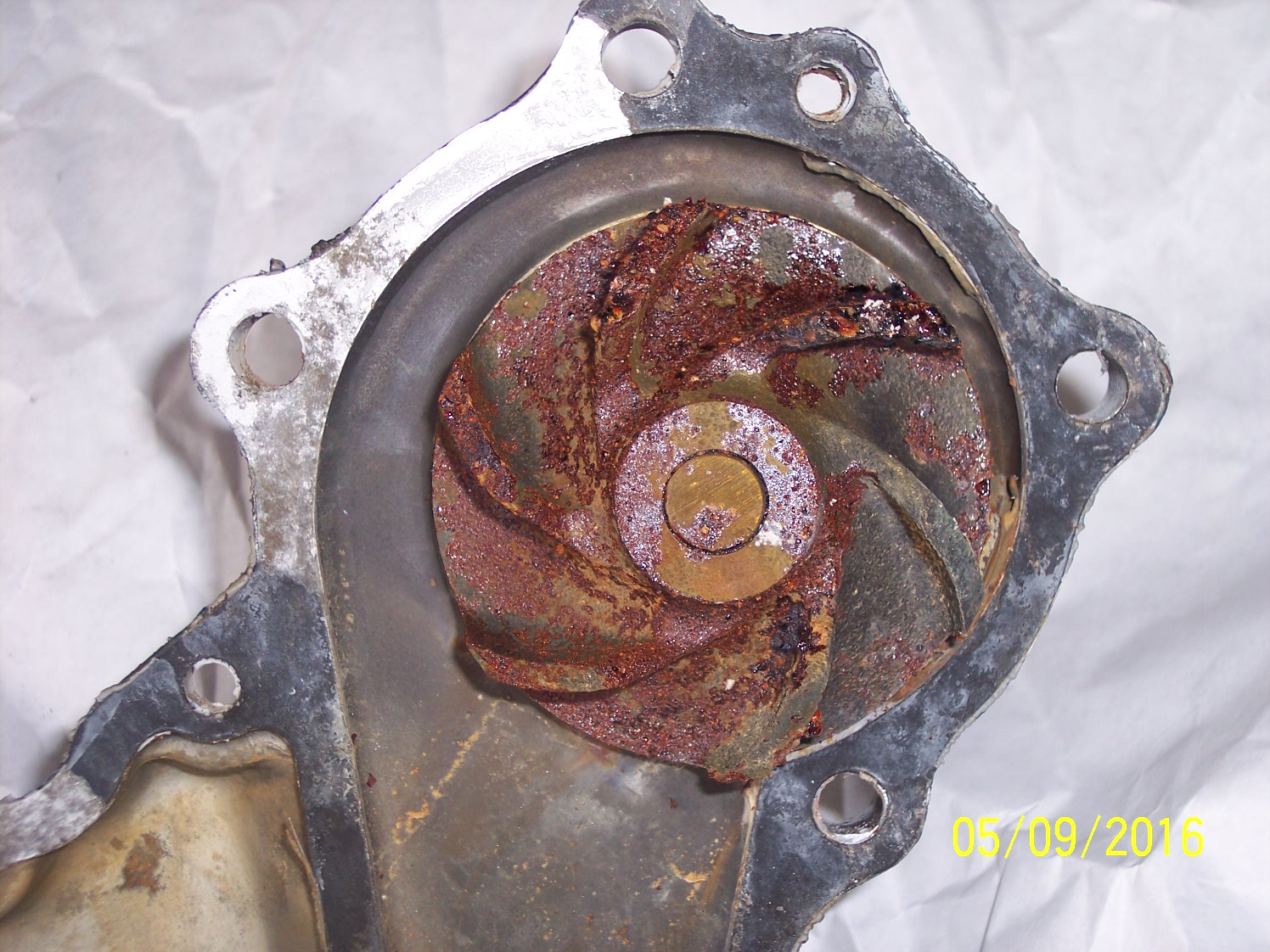

I had an L2050 that the previous owner let freeze. This is what the oil pan looked like.
This raises a couple of questions. Were you able to repair it or was it bought for parts? Other question calls for opinion or best guess. Do you think engine froze TWICE, once when something cracked allowing water to enter pan after it thawed then a second time when water in pan froze cracking pan?
I bought it not know what would happen with it, just a bargain I couldn't pass up. I did some fixen and put it all back together. New oil pan, new clutch (you've probably seen picture on here of the rusted out clutch), a freeze plug or two, water pump. I don't really remember it all. North Idaho Wolfman found the oil pan for me on the internet for like $85. Had it for a while and eventually sold it.

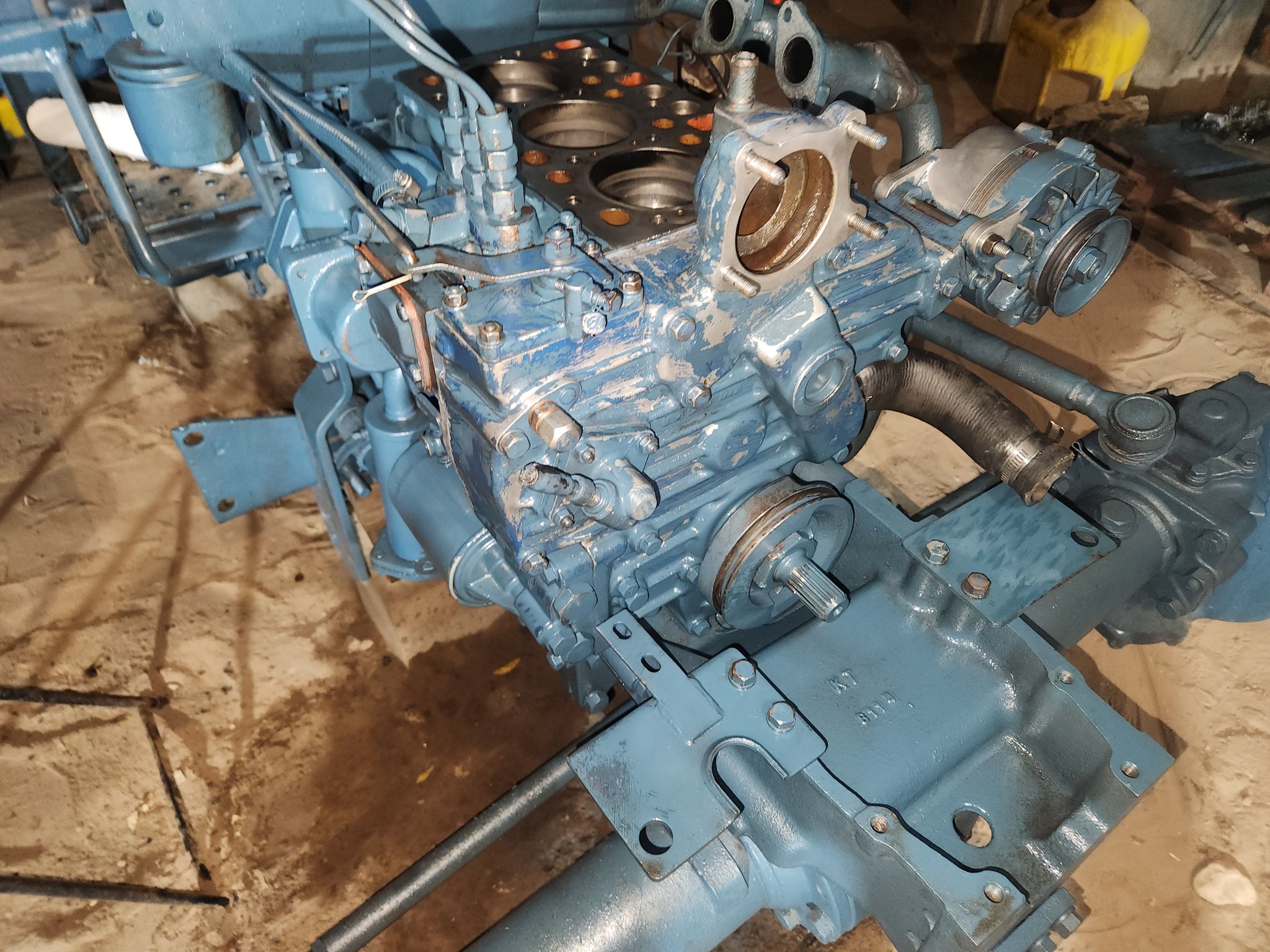

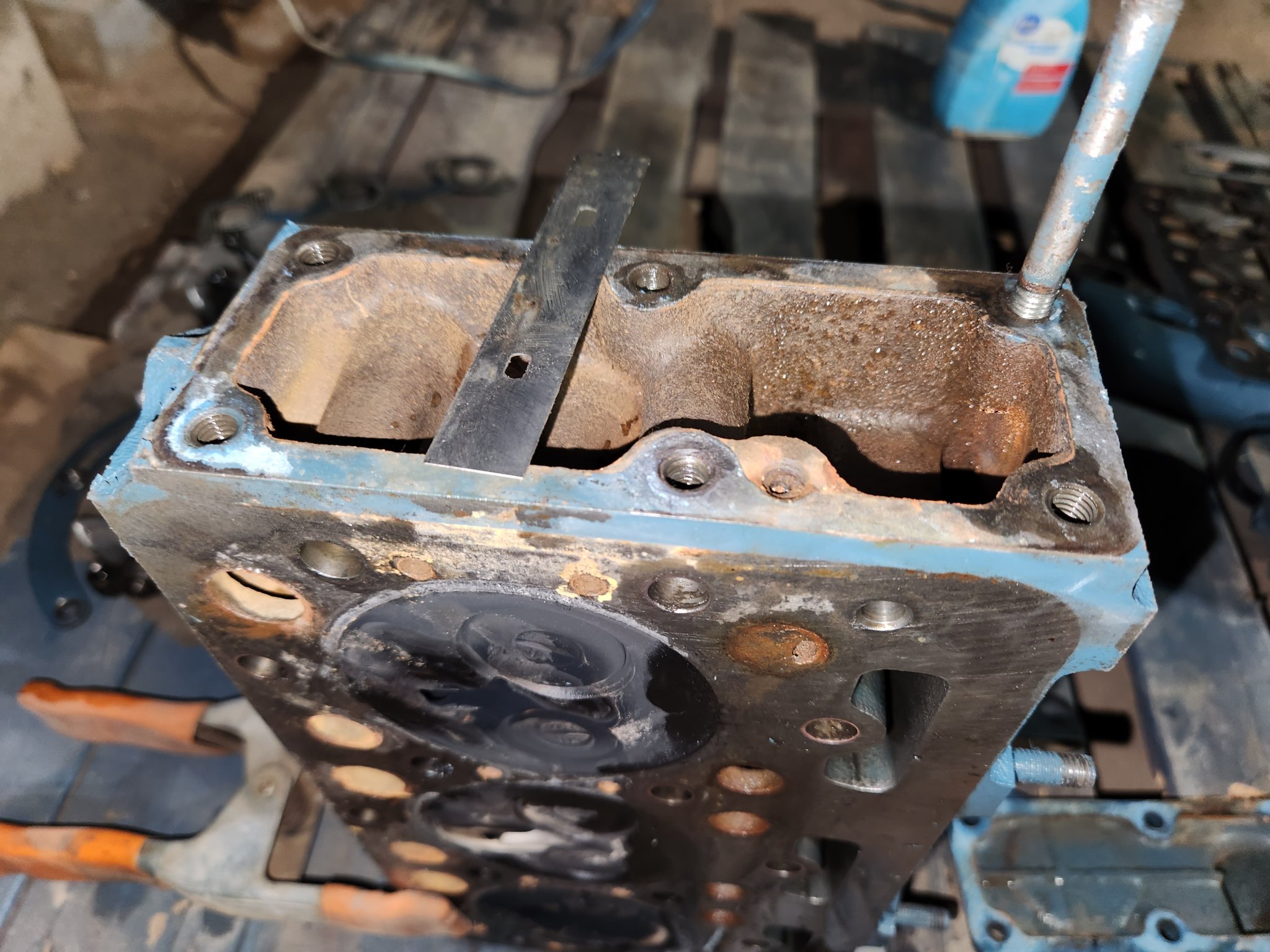

Found the culprit, surgically seal engine
I point to the area of visible leak when assembled, but
study the travel of water across different parts of gasket
looking at head, pointing with blade where the leak was
plane both surfaces, clean them perfectly, use tiny bit of red rtv along with same gasket, seal it perfectly with intent
not in hurry to put it back together, clean all bad paint, install new springs, etc
Hit flange with file, then cutting disc, then hand sand with 600 grit, dip in diesel
Soak entire head in diesel with big brush, hit leaking area with stripping disc on angle grinder, file the area, put clamps on head, hitting it with 6 inch wire wheel on polisher, stripping away paint, hitting it hard with compressed air
Now: finish hitting both part with wire wheel, clean them with part cleaner, then
using gasket maker and the recycled gasket, surgically seal them and let them cure,
put some plumbing tape on the bolts, tighten them to about 25 foot pound, maybe 30
let it cure over night

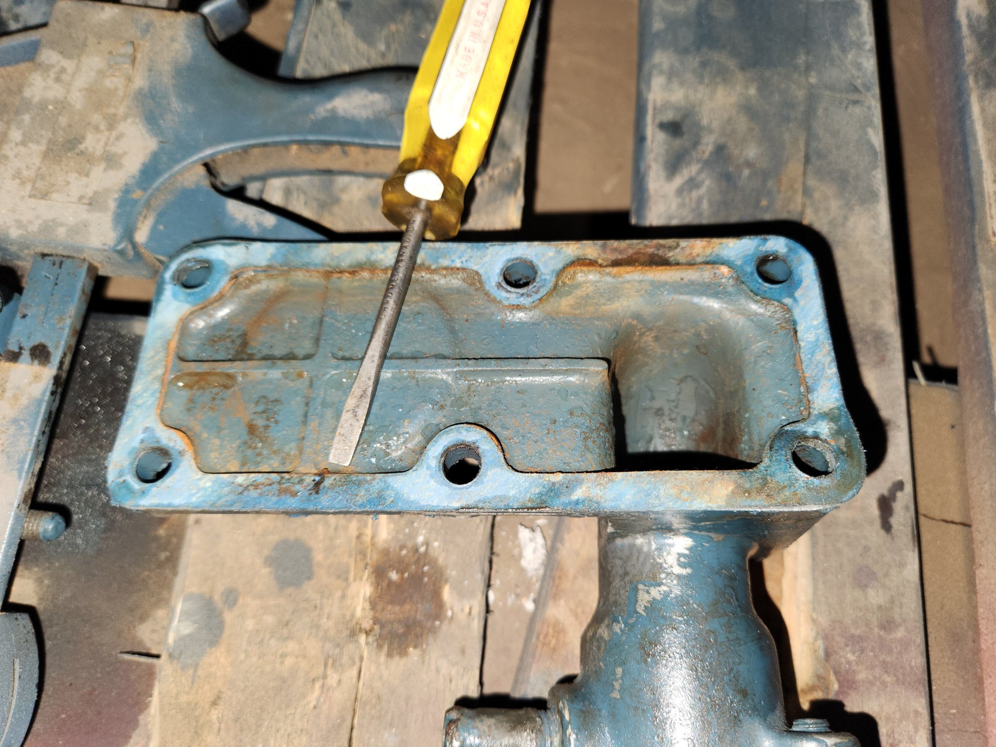

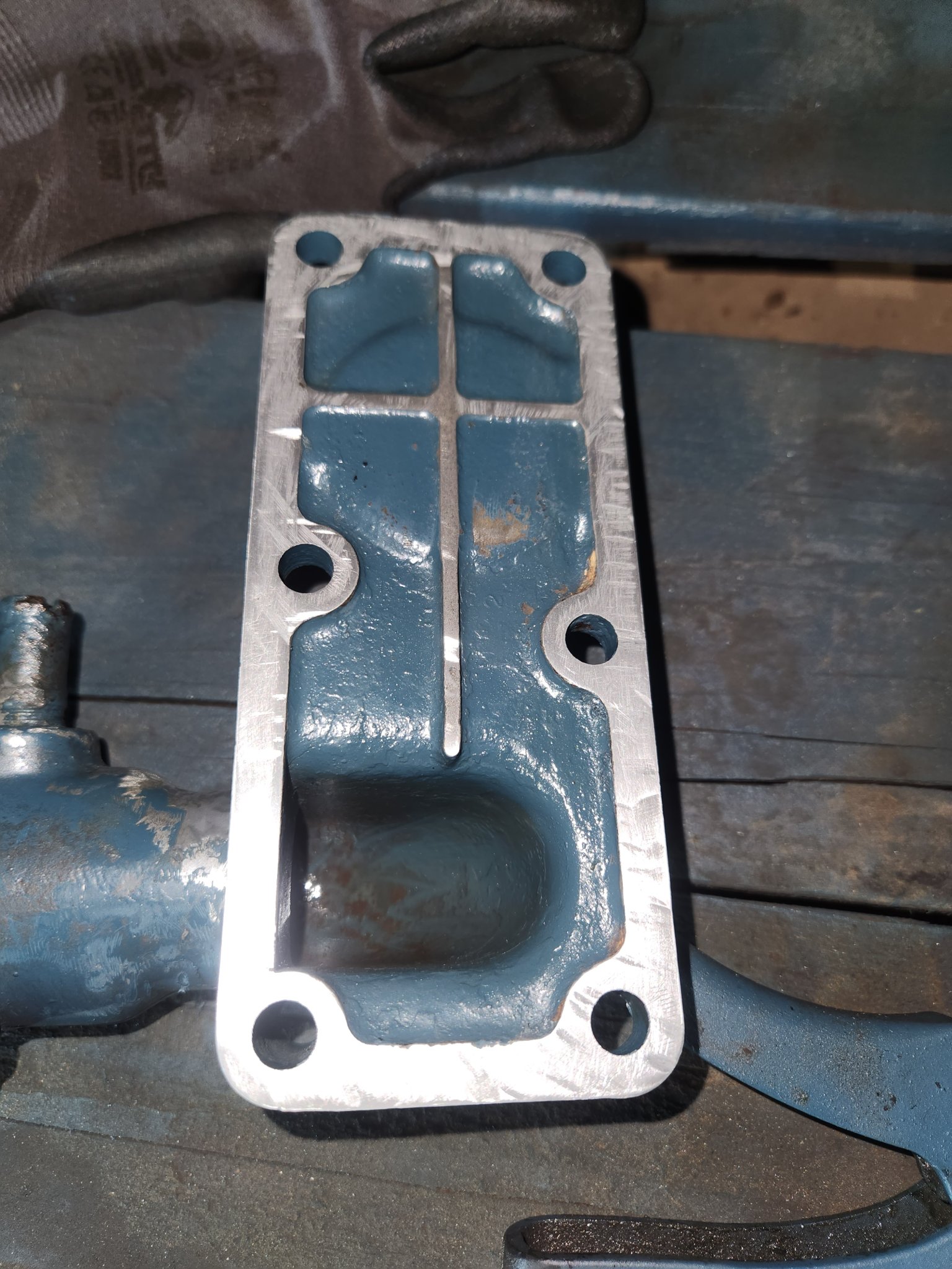

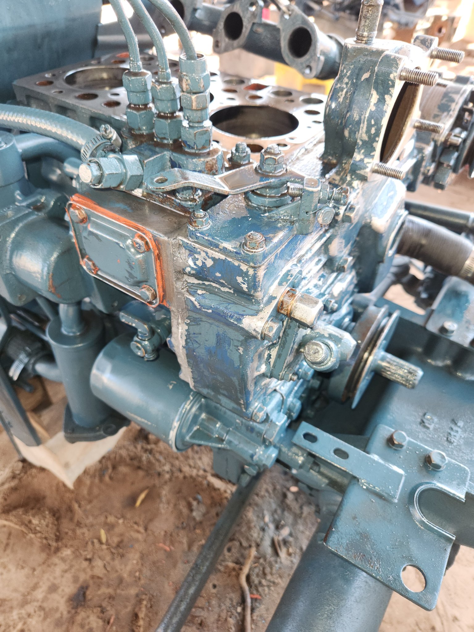

Pictures: these are all the mating surfaces where leak present, fully clean, ready to seal
I point to area that had some gear case damage during removal
put nice bead of jb weld now
Hit whole area with 6 inch wire wheel doused in diesel, 1000 rpm
Now: slice rest of hour meter, clean area, put bead of jb weld on gearcase damage and sliced hour meter

Put bead jb weld using flat chisel, wipe excess
Slice hour meter, dab in jb weld

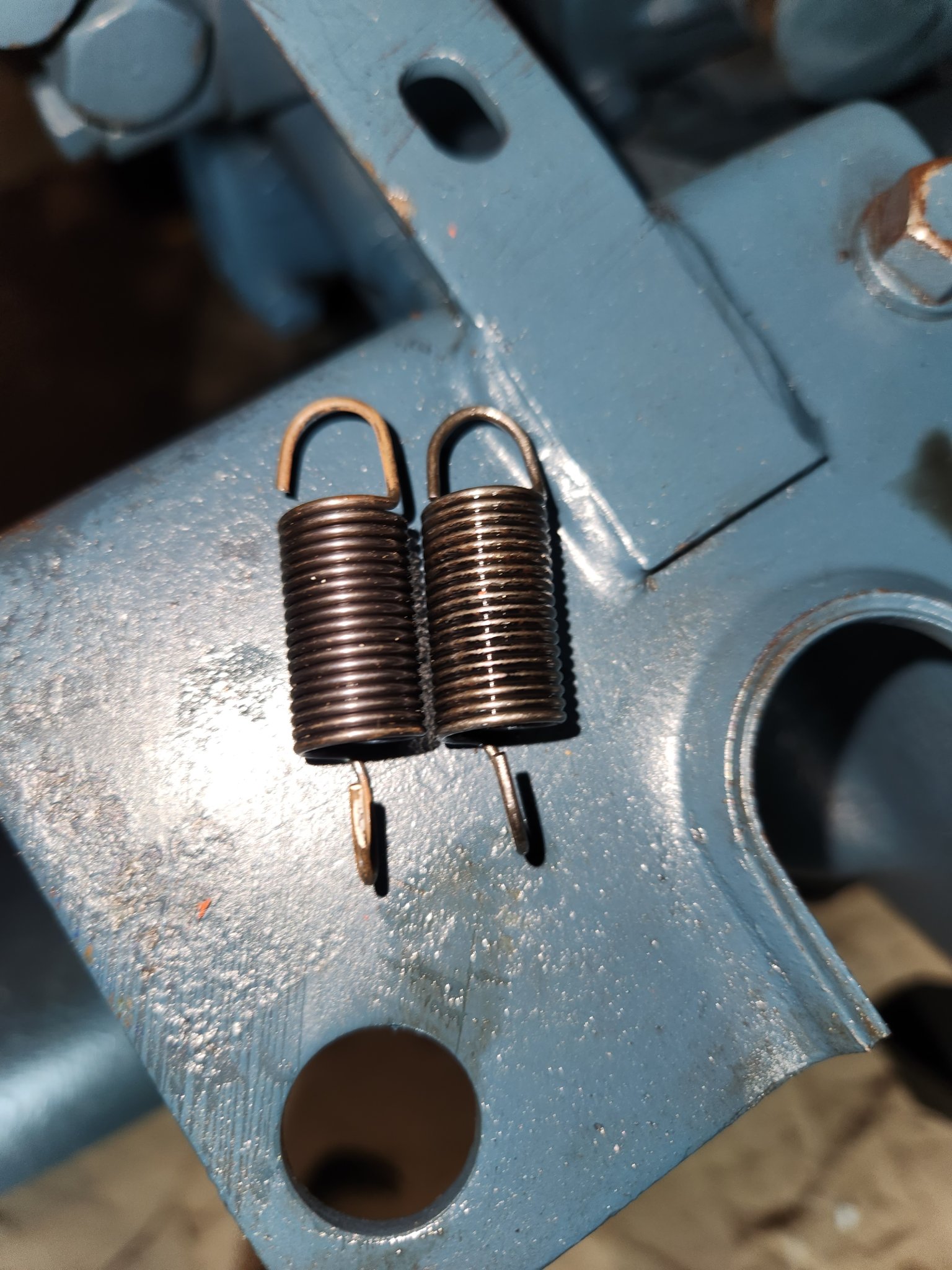

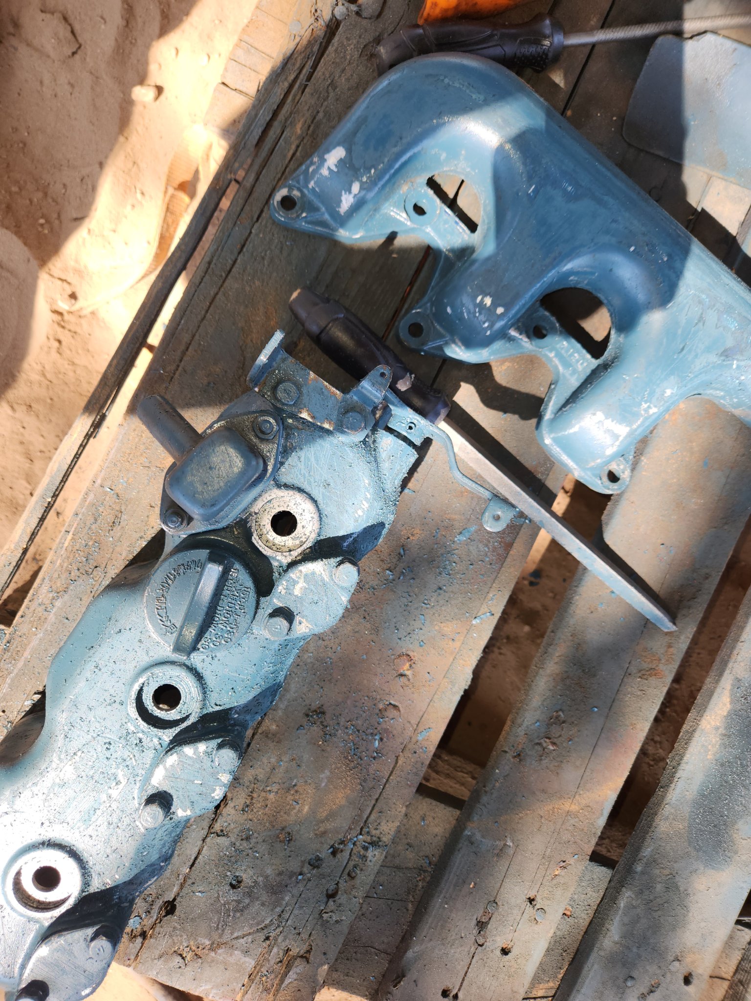

Now: take out governor, remove spring, install new springs,
Imagining that the new springs make a difference and give that perfect idle and control

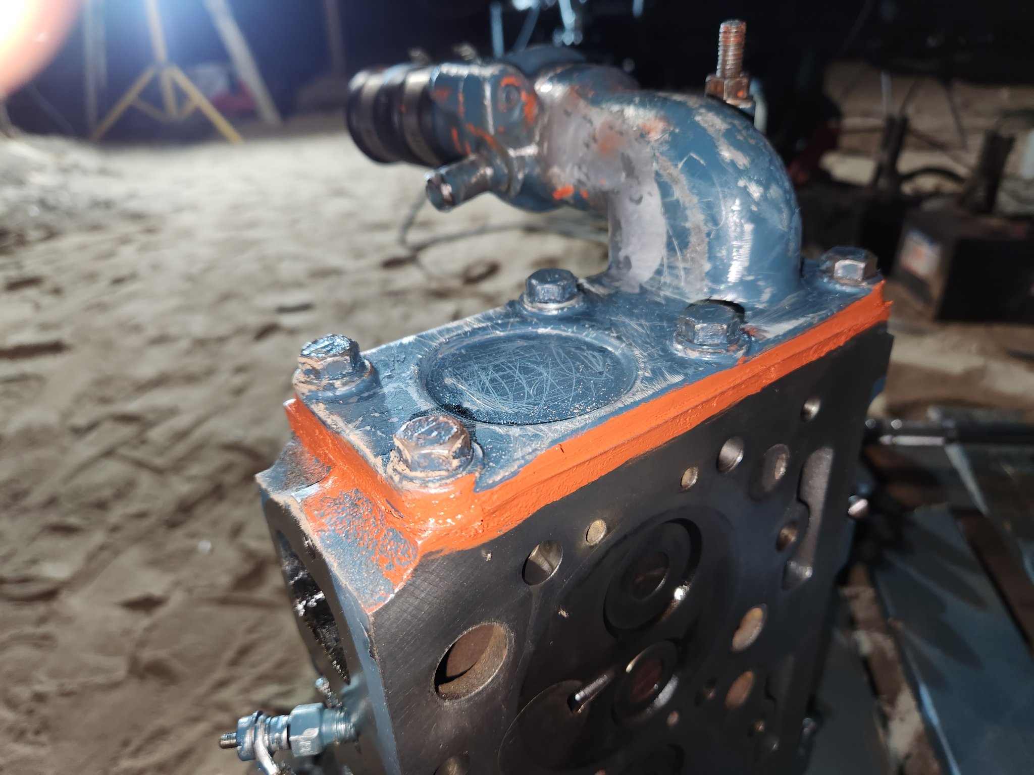

Surgically seal water port attachment to head, use red RTV gasket maker and gasket
Start spring, new and old
Carefully install without dropping into gear area
Installed start spring
New governor spring left, install it now
installed springs perfectly, without stretching at all, resealed area
I point to more gear case damage, might as well jb weld that area, wasnt leaking but might as well
Perfect bead on all surface using finger, surgically sealing engine

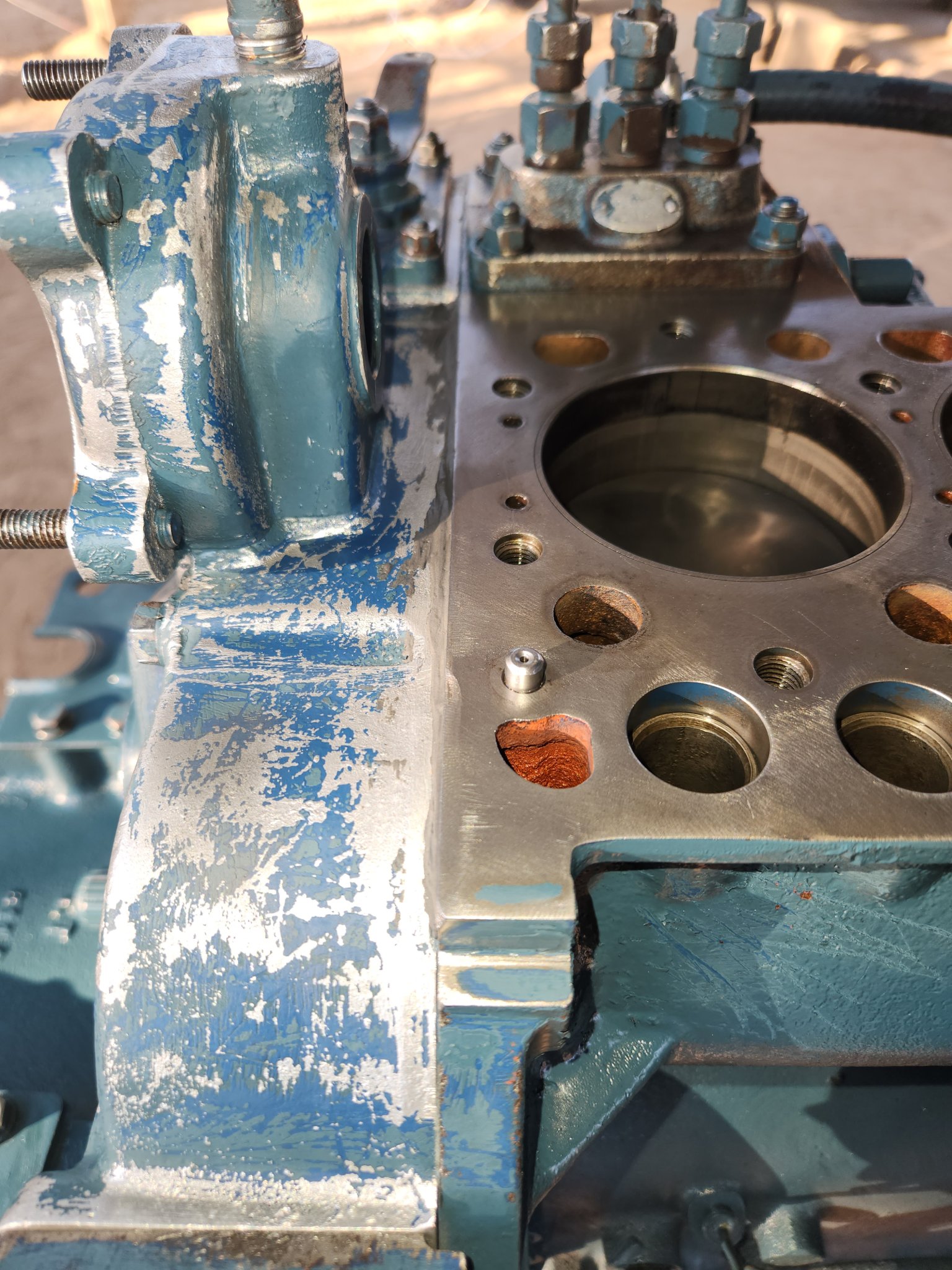

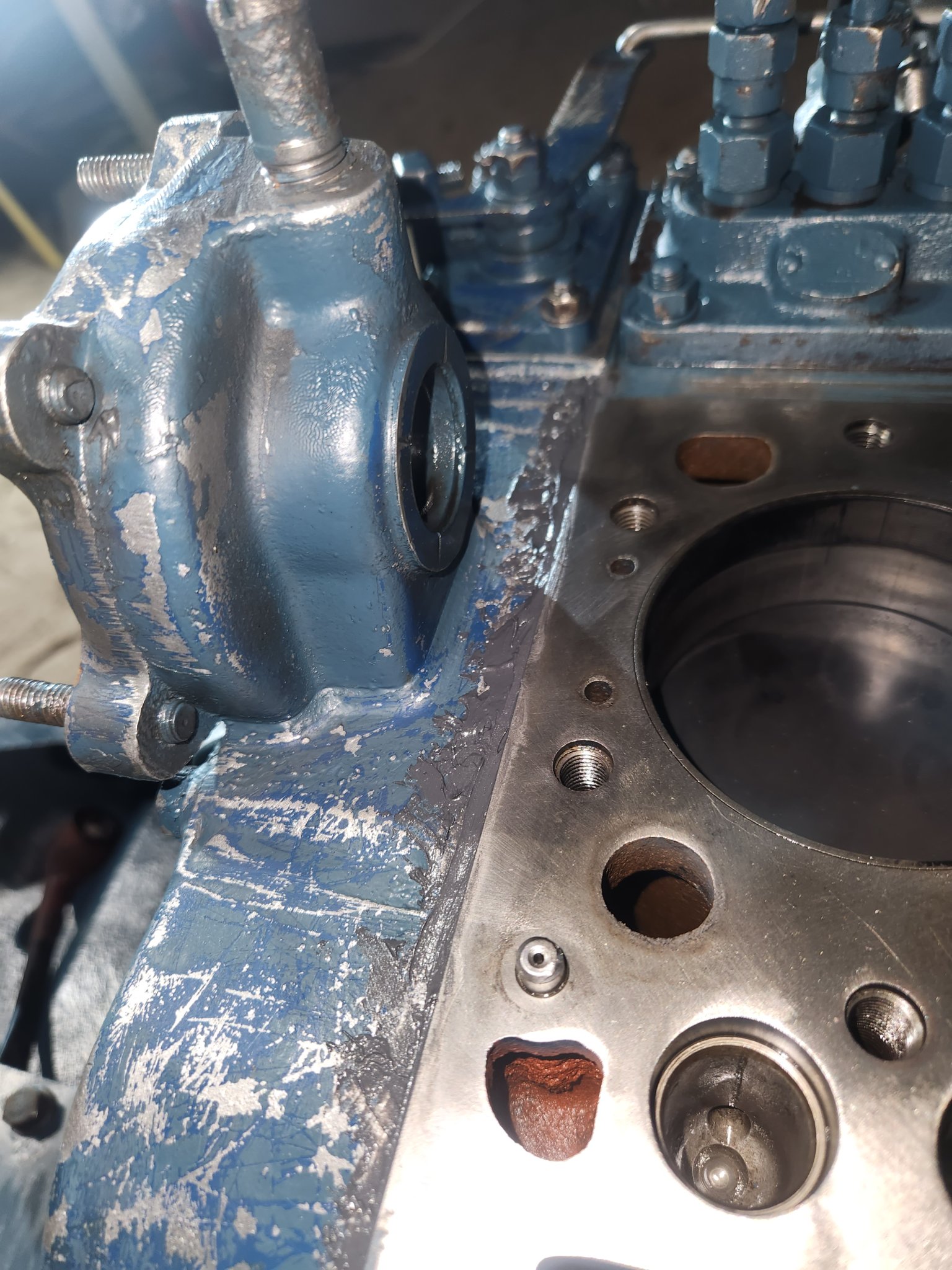

Looks to me like it's leaked between the two holes that are the closest together.
Do you mean on the block? It looked to me on the block like the cleaning methods have rounded the normal sharp edges of the holes , The picture with the pliers looks like that cover isn't even touching at the top and you can see 2 heavy chisel ? marks which have probably made a bump on the sealing surface area.
Hard to tell from pictures but those seem to be jumping out at me.

When I had take out cubby hole to put in new springs, it was HARD to get off the cubby hole, bolts were hand tight, and there was no leak
The cubby hole had that red gasket maker
The surgical cleaning and solvents and wire wheeling, plus the gasket maker and the jb weld, its possible to stop all leak, and I mean permamently
Soon: file away all the glues and jb weld on all the surfaces that mated, clean and hit everything with air and other cleaners, then
I guess rig it up and see if water leak still present

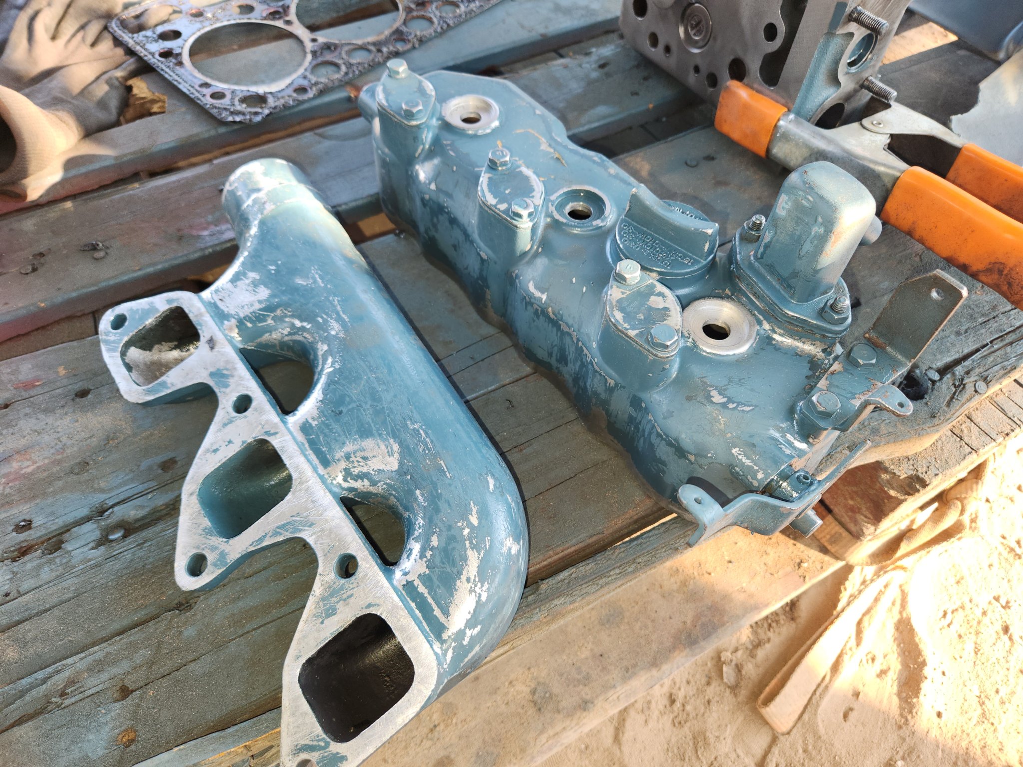

Soak it all in diesel, keep fixing paint mistake, wire wheel everything, cleaning gasket material, file down jb weld
40 pages into this thread, and the closing tool in the arsenal is:
Cheapest file set at walmart, unbelievable
up close gearcase jb weld seal job and removal of paint in that area, made sure top of engine block planed
Up close of water leak after major surgery, filing off excess gasket maker, hit hard with wire wheel
