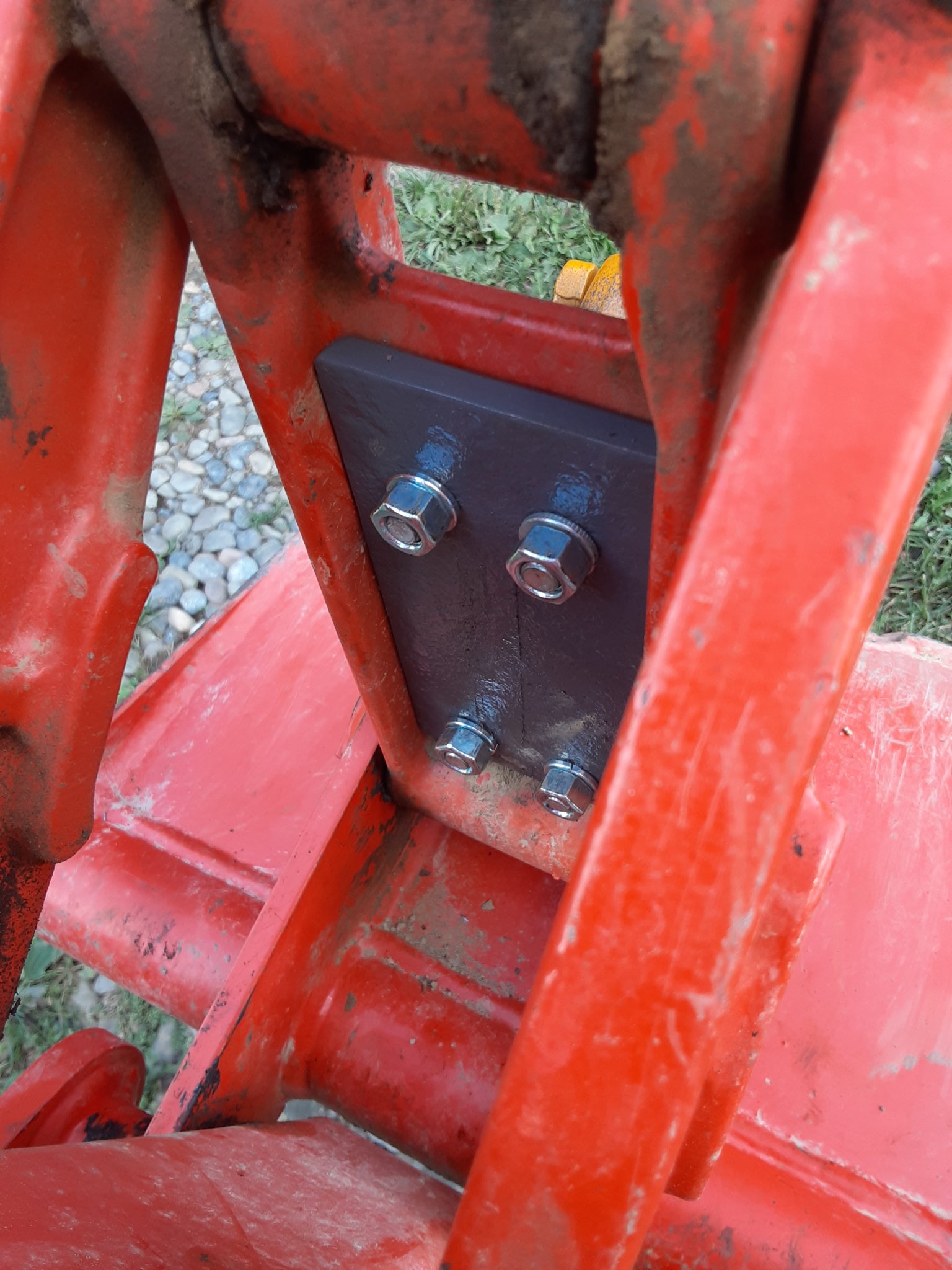

could you please post some pictures of the hooks you welded onto the thumb and the drooping bucket? thanks
Off topic for this thread but,
I first made this hook mount for the linkage because I wanted to be able to lift with or without a bucket on. It is 2 pcs of 3/8 plate 2-7/8 wide with the hook welded on one then sandwiched w 4 bolts to the linkage pc. The 2 hooks welded to the thumb bracket and then an appropriate length chain looped thru. I added the orange strips so hopefully I will see it before trying to unroll the bucket.
Works really nice.
