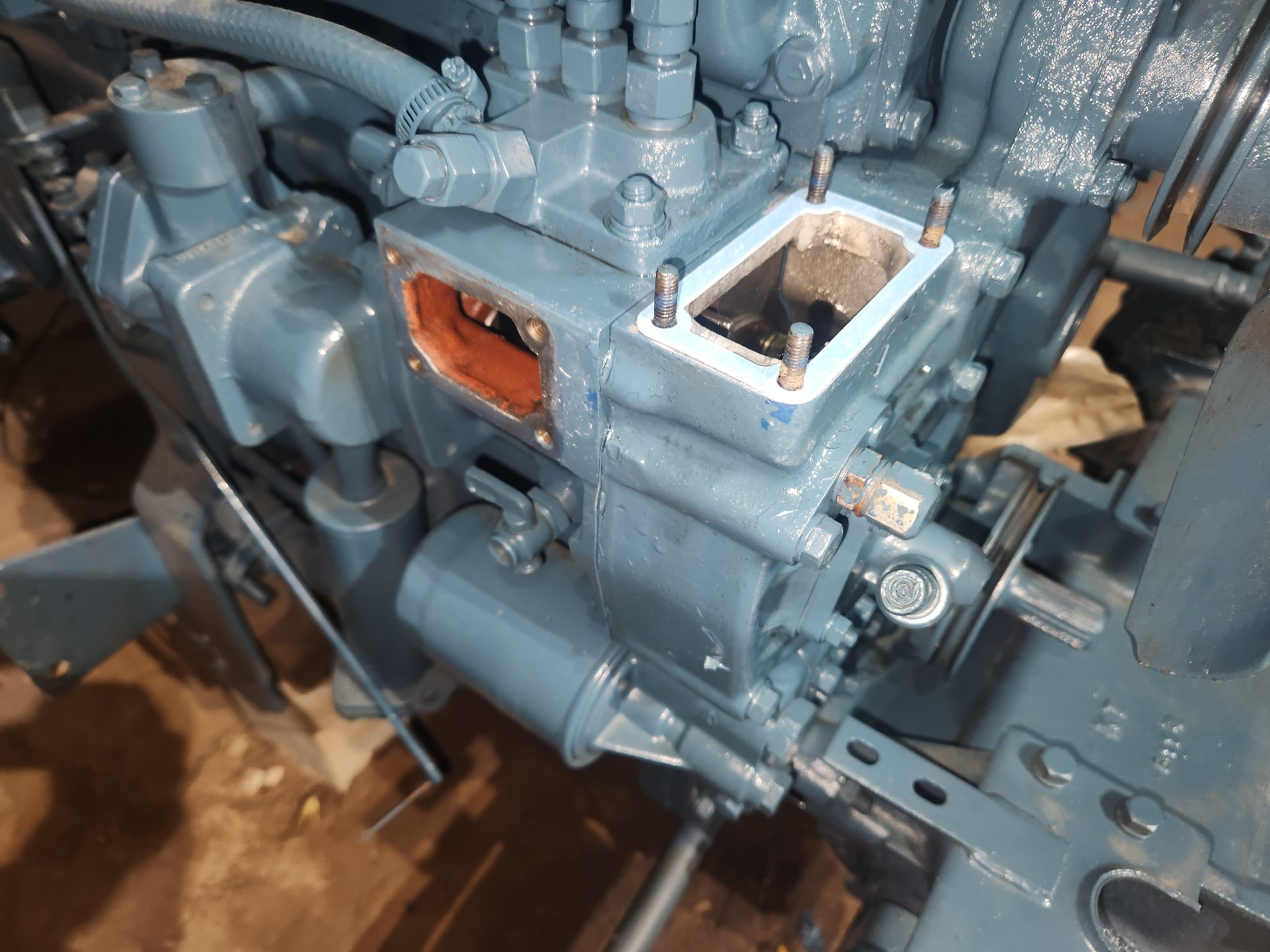

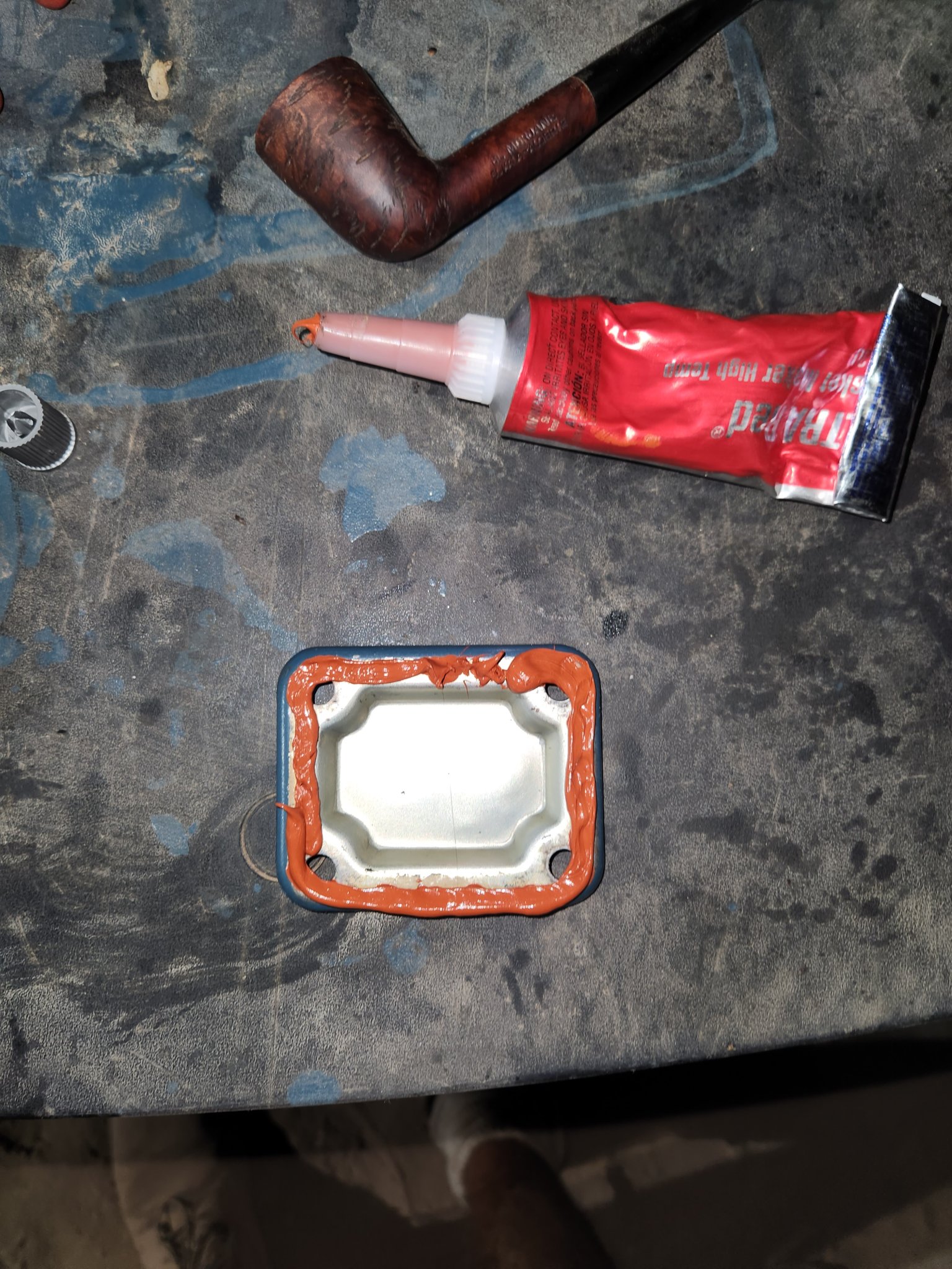

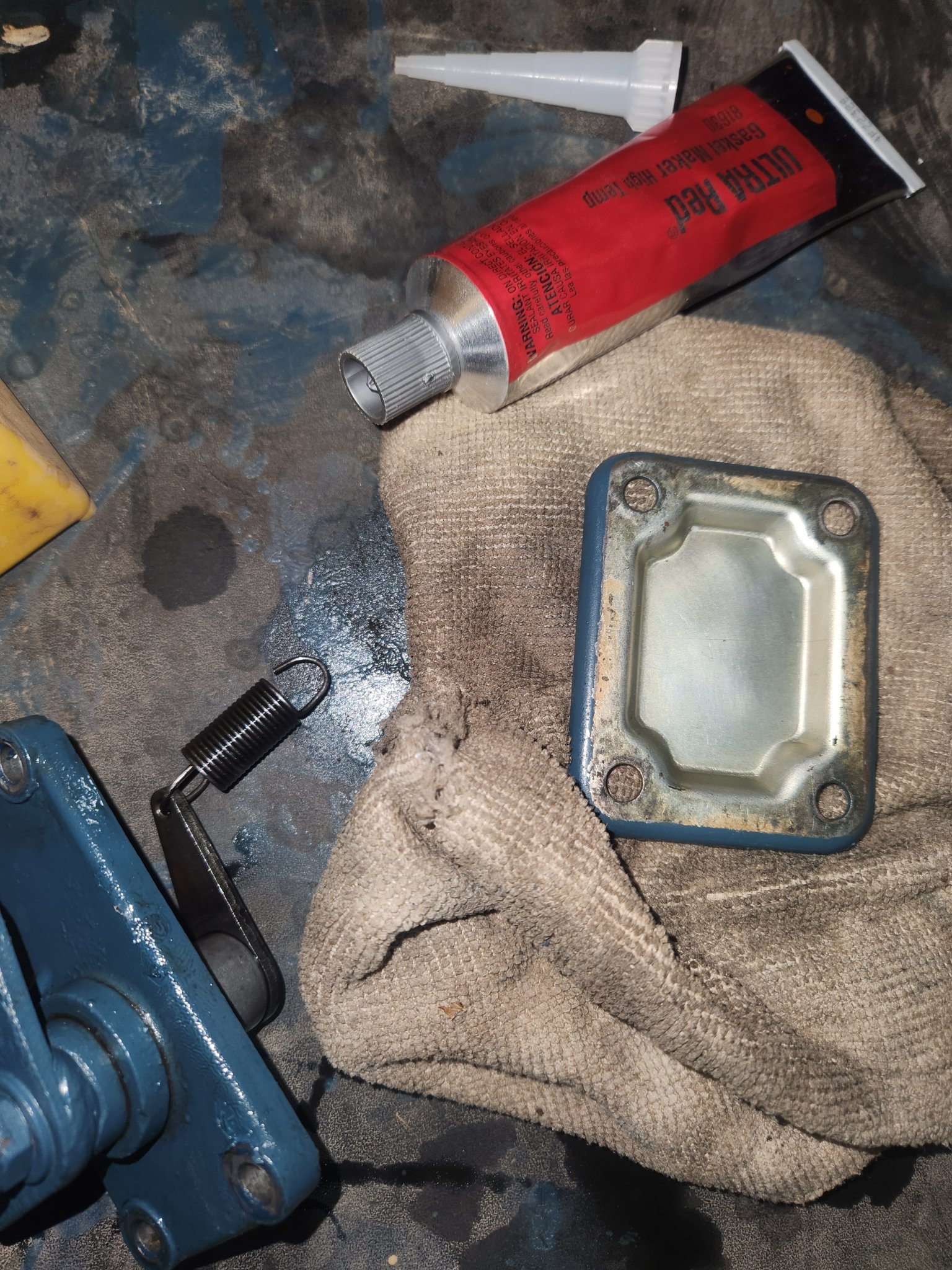

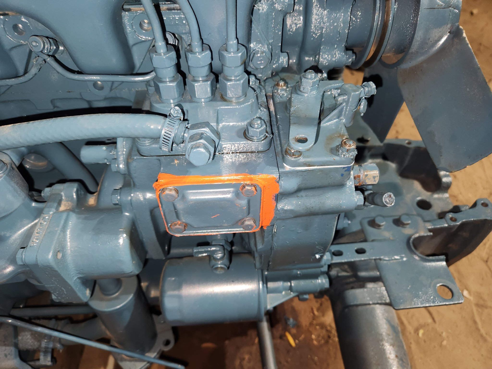

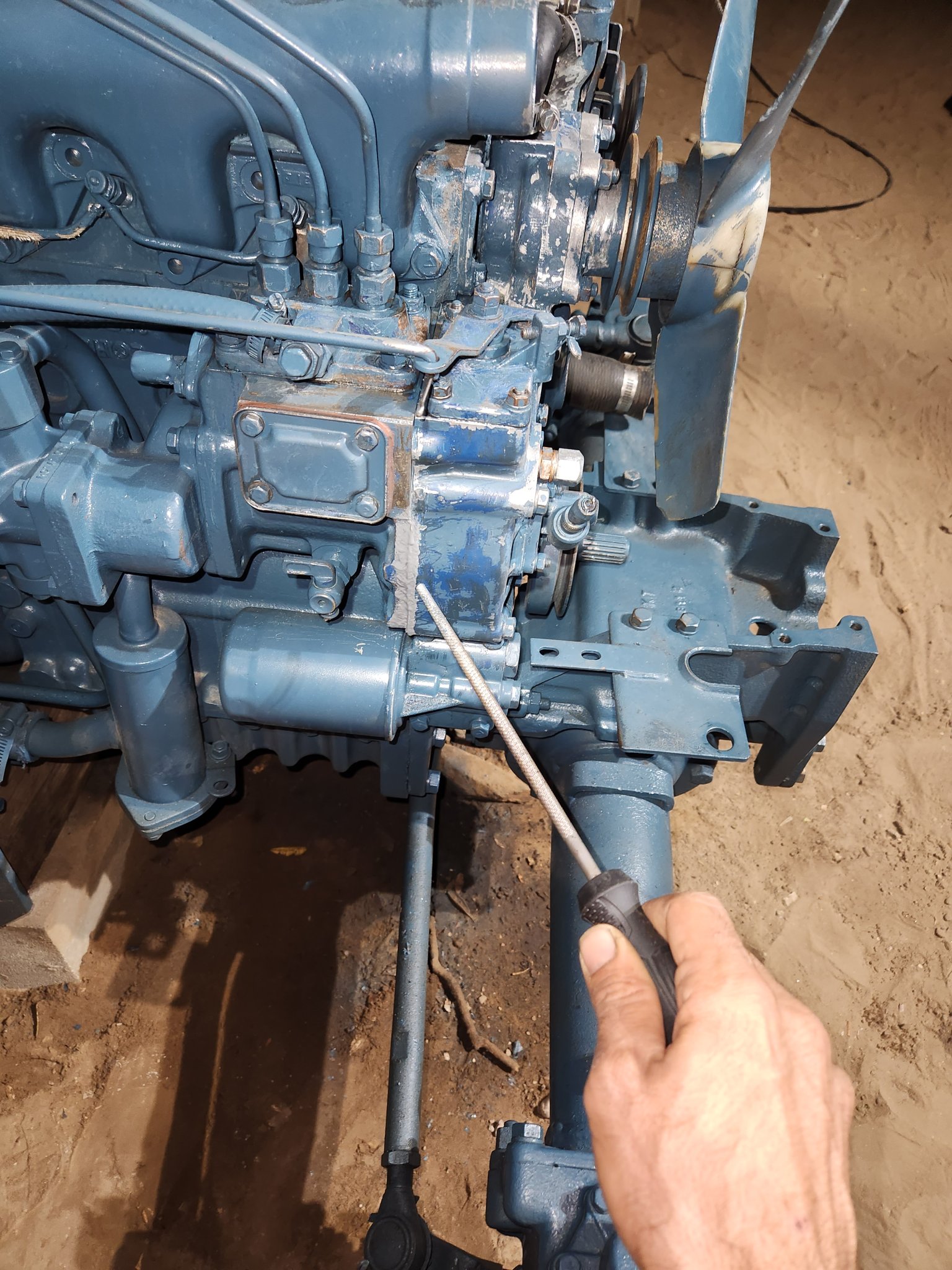

Fixing all leak, experimenting with jb weld capabilities
Brand new gasket governor
Cubby hole: I don't see a gasket, make gasket with the red tube
Also, I try bending back governor spring, see it bent in picture
Red gasket maker on cubby hole
Put cubby hole and governor cover, spread gasket maker with finger
Possibly solved seesaw idle:
The spring was upside down, I flipped spring and it is in the natural state, seem hopeful

When using that silicone material for a gasket you should apply it all around each bolt hole. If you look at a pre-made gasket you will see what I mean. Otherwise there is a possible path for oil to get to the bolt hole and then out around the bolt.

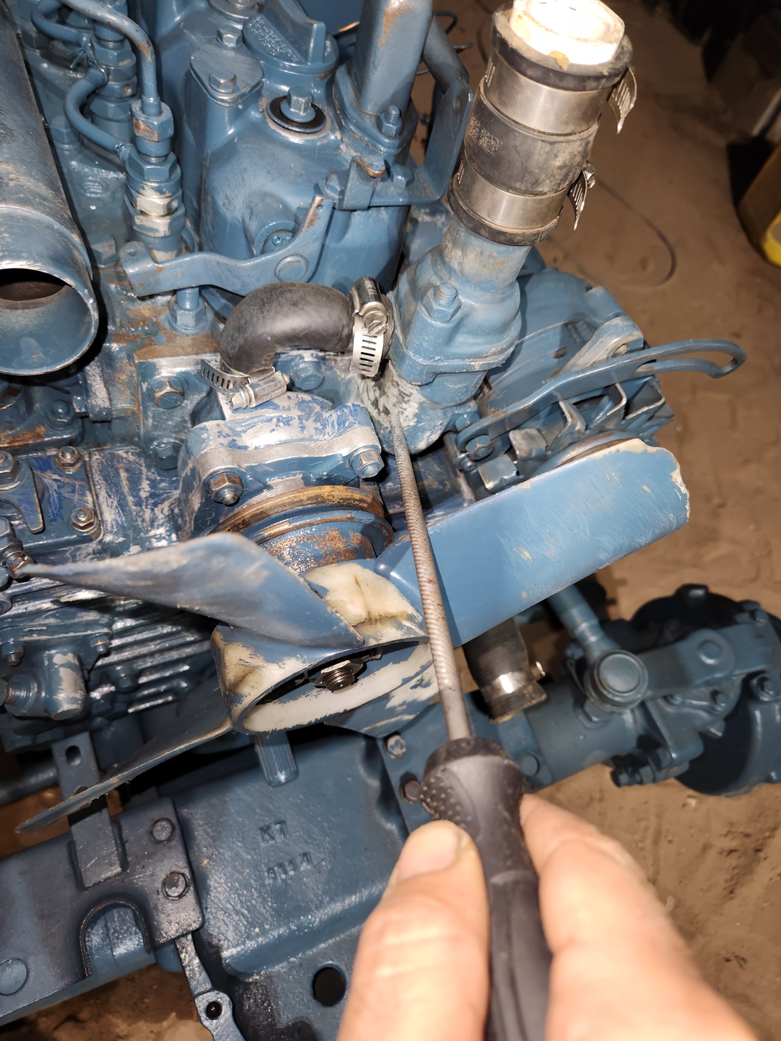

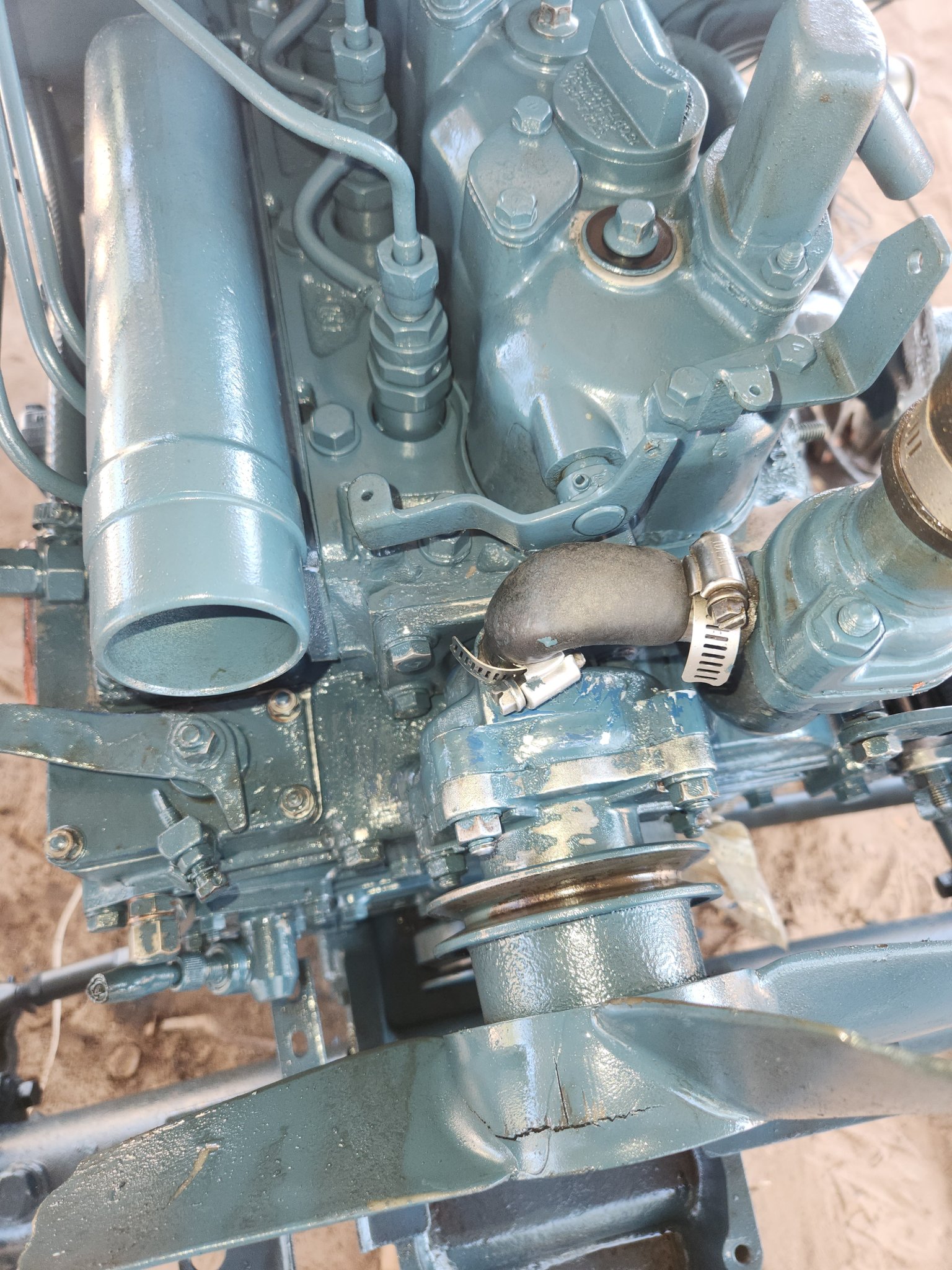

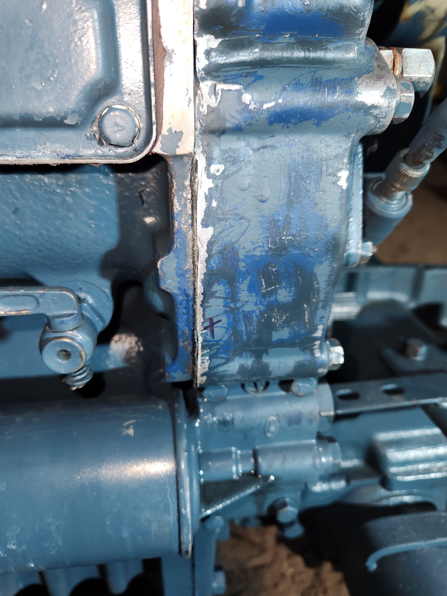

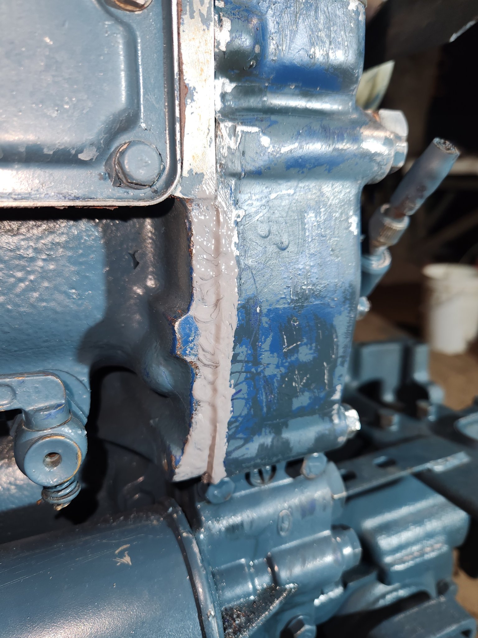

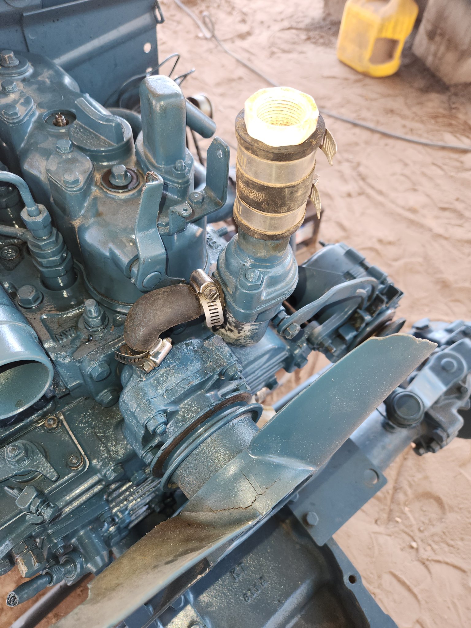

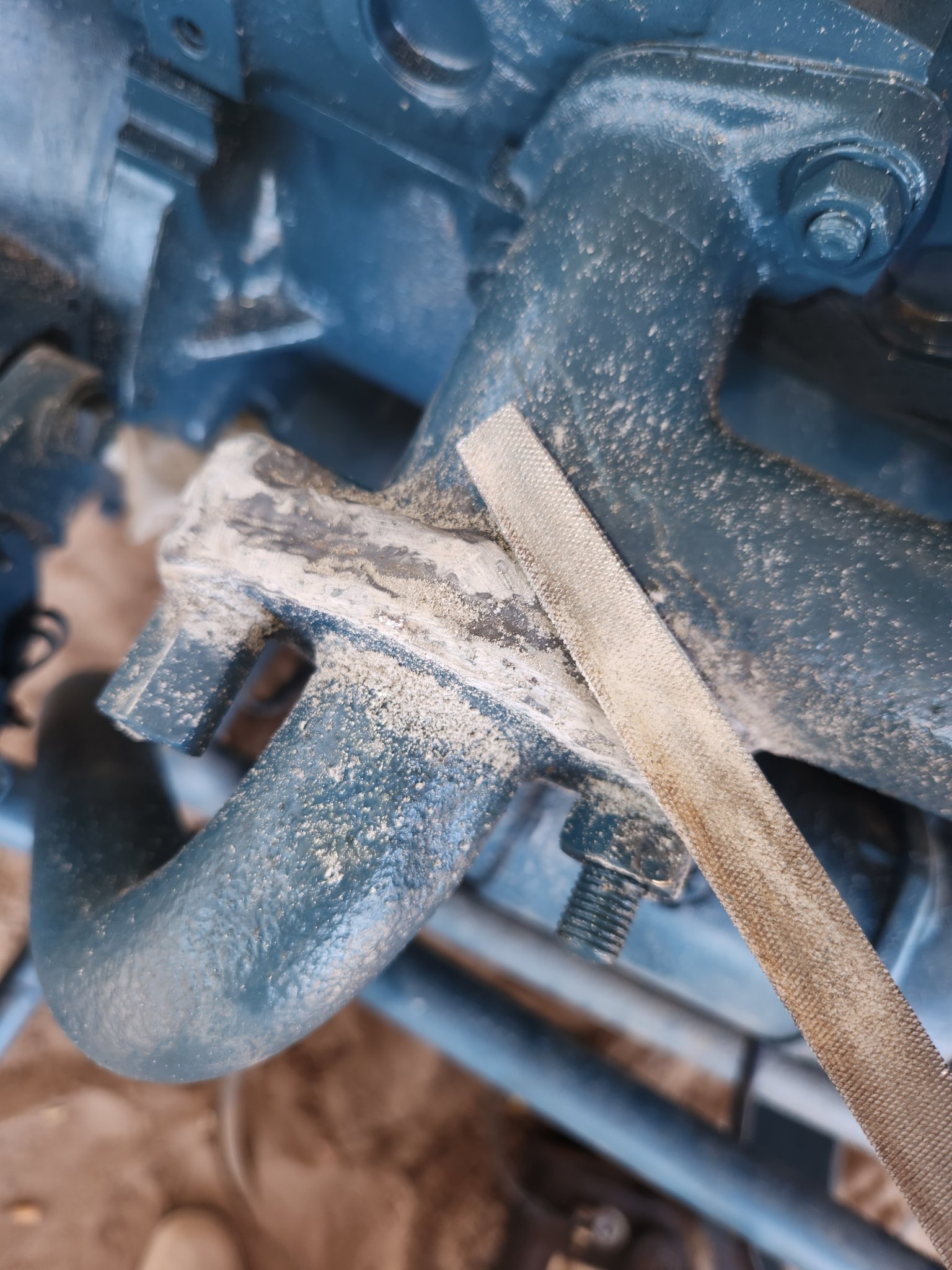

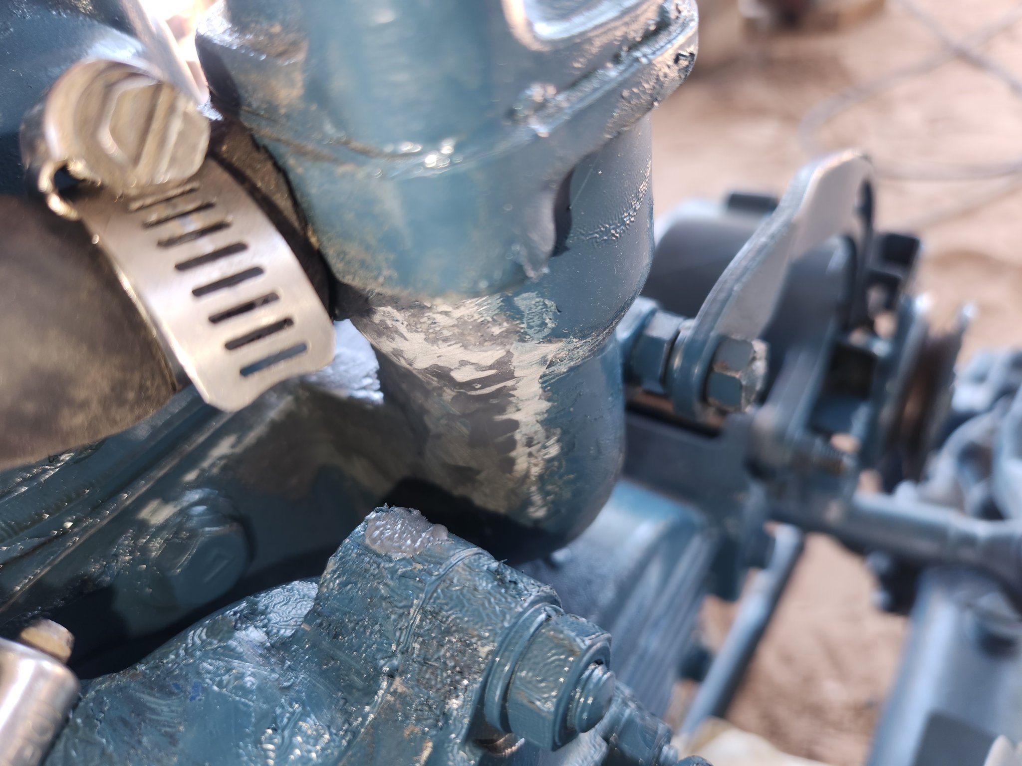

File down jb weld, keep knocking out leak one at a time
File flange crack
Theory on why this crack occur: must of had water, not coolant, and a deep freeze unexpectedly froze up all cooling system expanding water
File exhaust manifold
Now: put water in it somehow and seal it up moderately, start it up

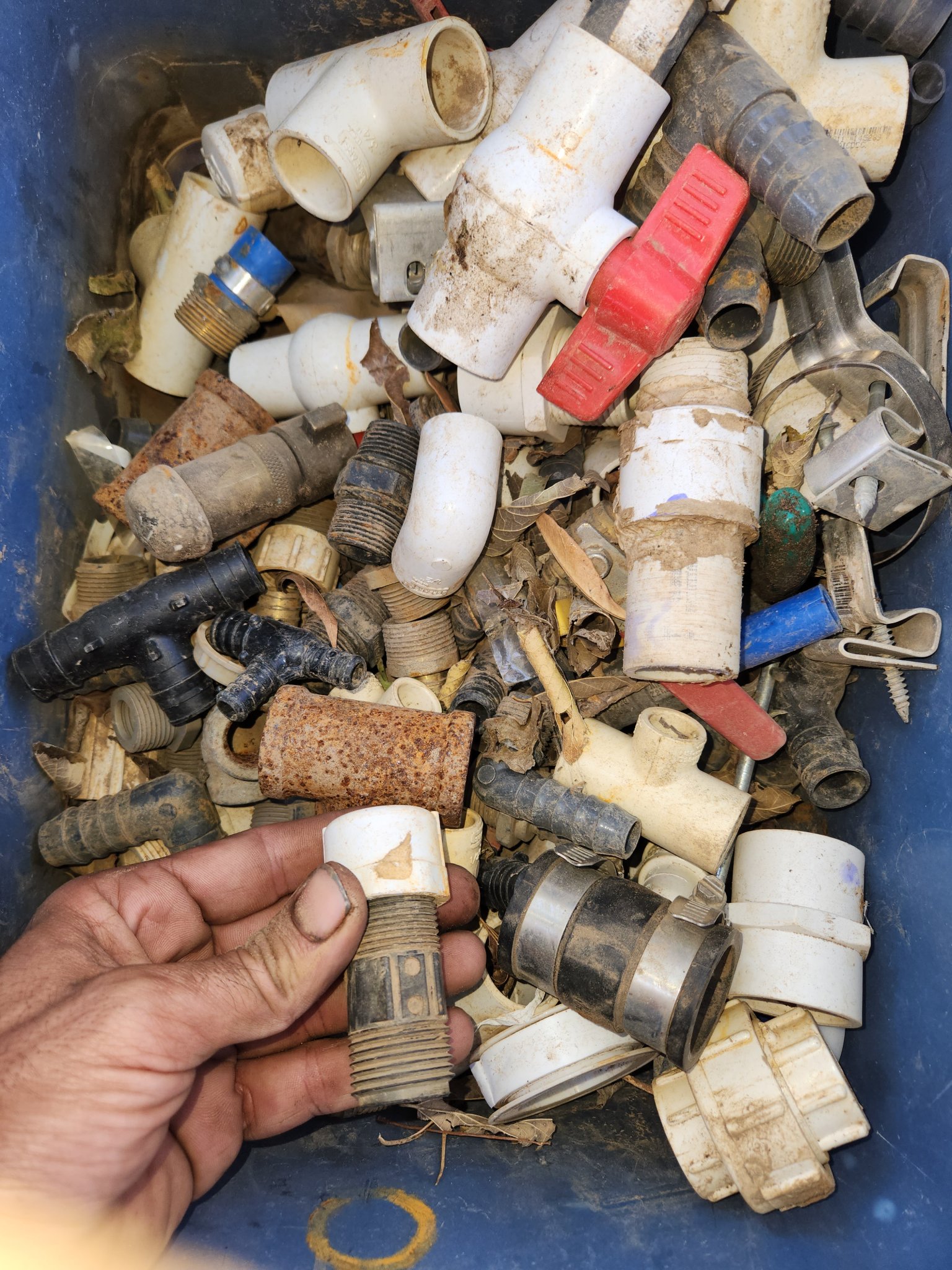

I'll use hose clamp and look for junk to seal the line that fit hole
Go through junk, rig up seal
Put water inside engine, rig up plumbing, turn on engine look for leaks, spray soapy water
Hit with part cleaner then air
Now you can see any leak, soap bottle ready
Before I start it: imagine that the spring was on backward, and when she fire she purr with no more seesaw
Big water crack, did not push out any vapor, jb weld holding water leak, unbelievable
And it was true: that leak was the big culprit, only tiny water leak left on water pump
My exhaust leak fix worked, but paint bubbling signaling more exhaust leak somewhere else
Could the narrative be true that: one can seal engine with just jb weld and a brush, permanently...
Video: solved the seesaw idle with flipping spring, water leak pretty much all gone, tiny leak on gearcase i try to show you
woah: jb weld, a brush, and a file could solve tons of our issues, i cant believe it myself
bigger narrative: that next part that show up in the mail aint your problem, the problem was solveable the whole time and took zero dollar cost, I just had blindspot not letting me see true narrative
Douse in diesel, hit with abrasives of all kind, fixing mistake of too much paint
douse whole area with big brush diesel, go through with every abrasive get rid of all paint, files are mvp, hit hard with compressed air, hit with part cleaner, take break, do it again
later: start it up again, spray soap water, document leak, clean area, use sealing techniques just discovered to completely seal engine, paint engine (small coat)

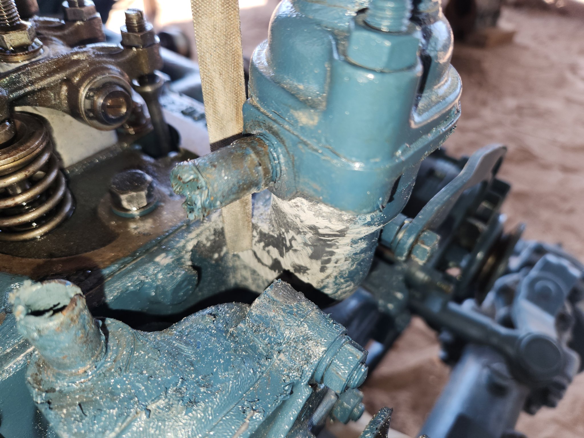

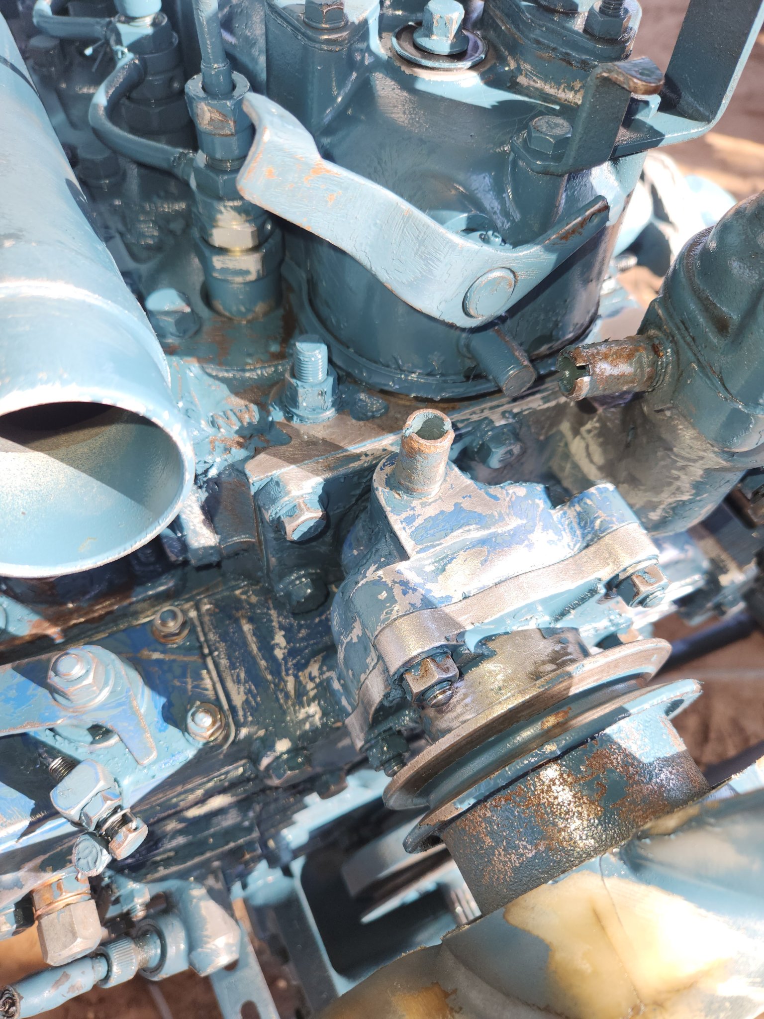

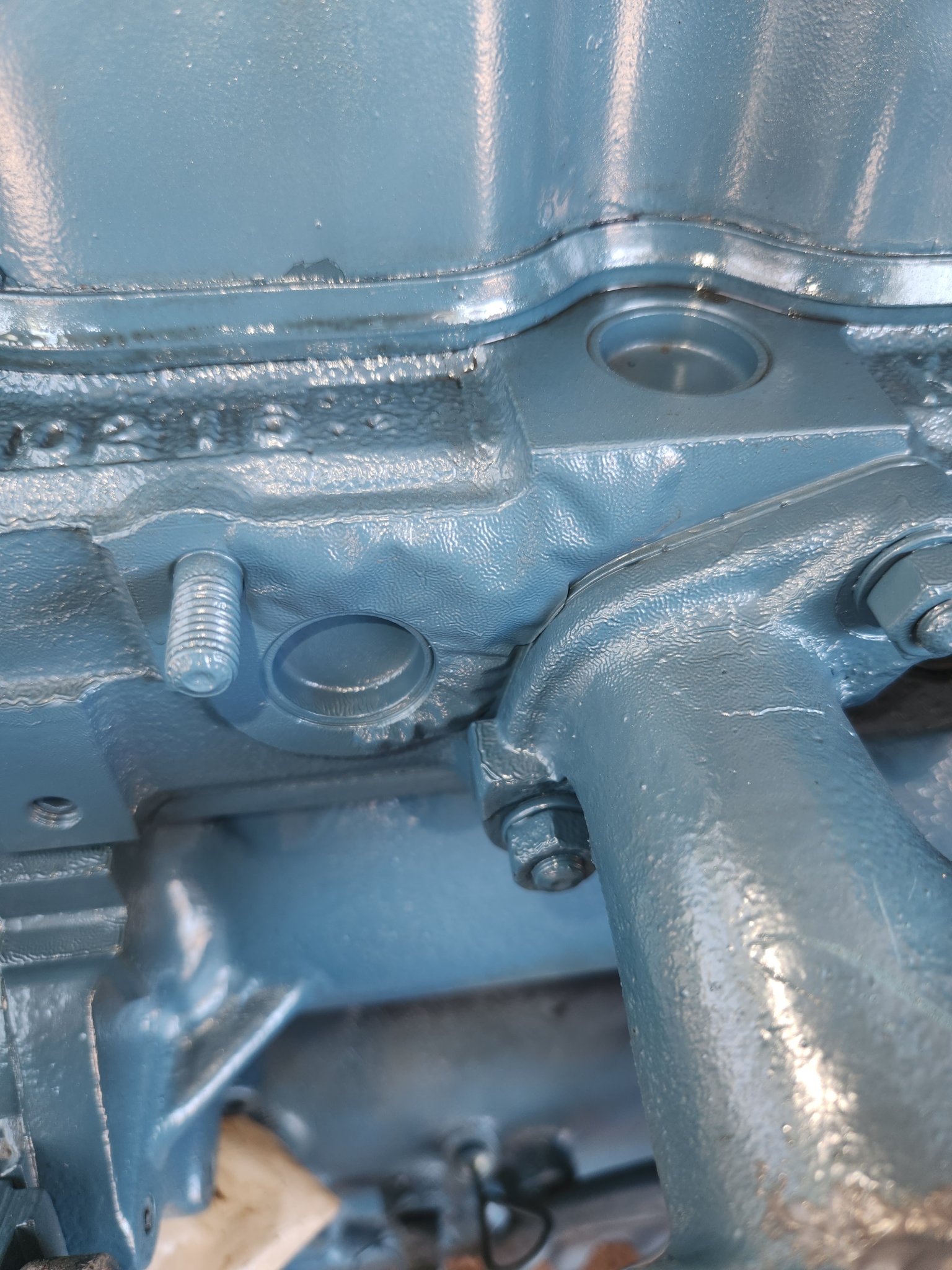

Thick paint job turned out to be mistake
washing with solvent, hitting with compressed air hard, wire wheeling, using every shape file imagineable,
That paint turning out to be more stubborn to get off than 44 year old crud/gasket/whatever
Its got a rubbery attachment to the metal, keeps dodging swipes with files
in this video, put water in engine, plugged water not too tight up top to let steam out, running engine and spraying soapy water looking for the leaks
Only leak I see is head connection to flange, behind gearcase
Oil leaks do not create bubble, i noticed that later
regardless, clean it comprehensively, run it one more time and also note the oil leaks if any, document all leaks
Then take off head and seal water route, surgery like fashion
plan: run it one more time with bright light up close, no spraying soapy water, looking for the oil leaks, document them
Then go again and spray soapy water on the water leak areas, ensuring you have all leaks documented, at least in your head
gearcase leaks: side leak is oil leak from air chiseling out the gearcase, there was damage to it, seal it up jb weld now
front leaks: bolts bubbling out, not oil, they must connect into the water system
only oil leak is that gearcase leak, no leaks on exhaust manifold
all leaks: gearcase oil leak, water leak head connection to flange, water leak water pump connection to gearcase
File gear case oil leak, wipe with solvent, brush jb weld

summary: take head off, fix both water leaks, install the new governor springs, put everything back together and have no leak
While parts are again dissassmbled, hit them with wire wheel etc, fixing the paint mistake
Governor spring come in old style logo

I point to water flange that had crack in it and was leaking water, this is where I experiment if jb weld can fix water leak on engine
It could fail from heat, we see soon

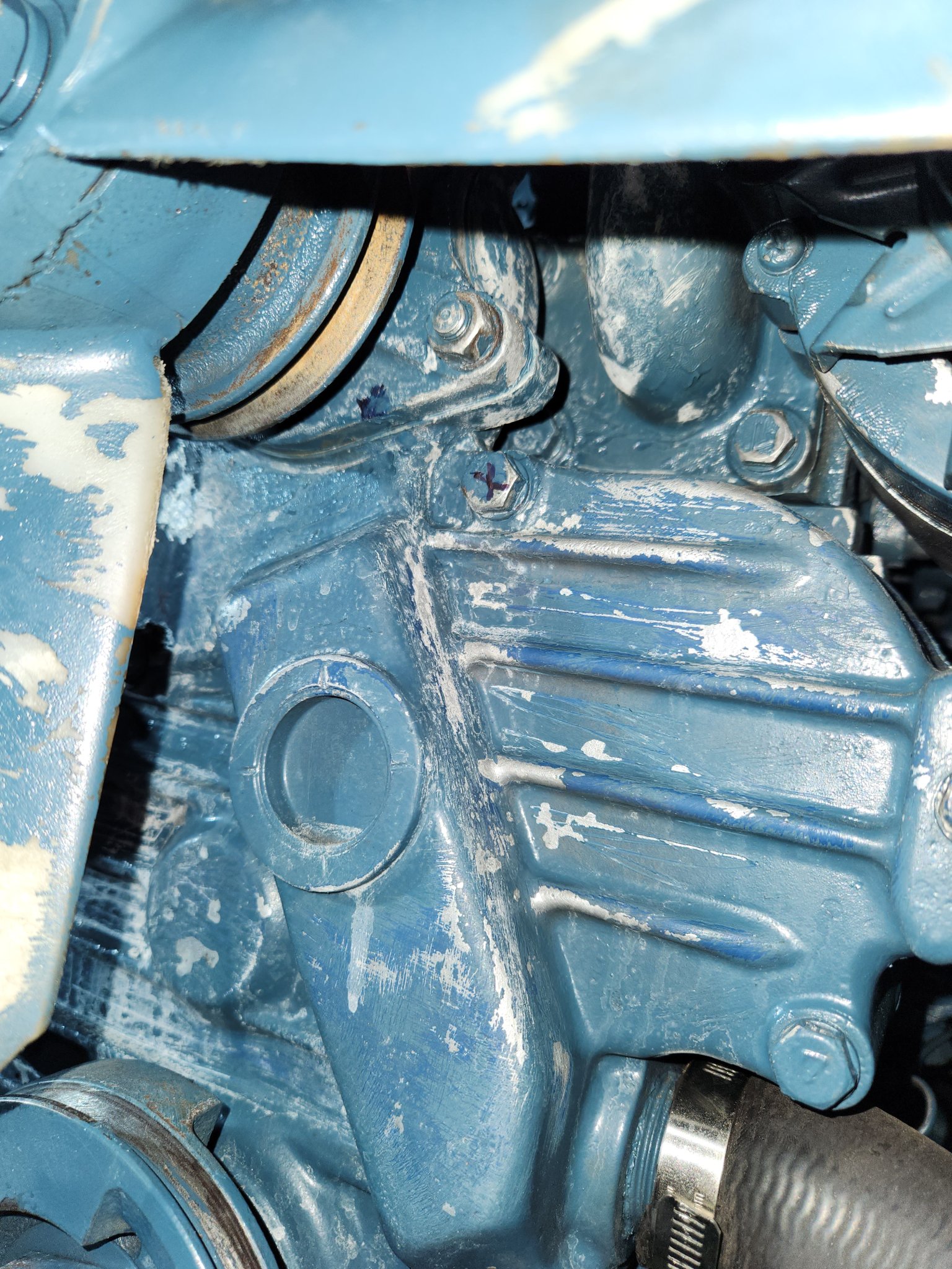

This is tiny oil leak, right side of gear case, under injection pump
directly behind are the gears in oil, it was where when guessing how to remove gear case, I air chiseled and did small damage to area
it should hold if not, it is accessible

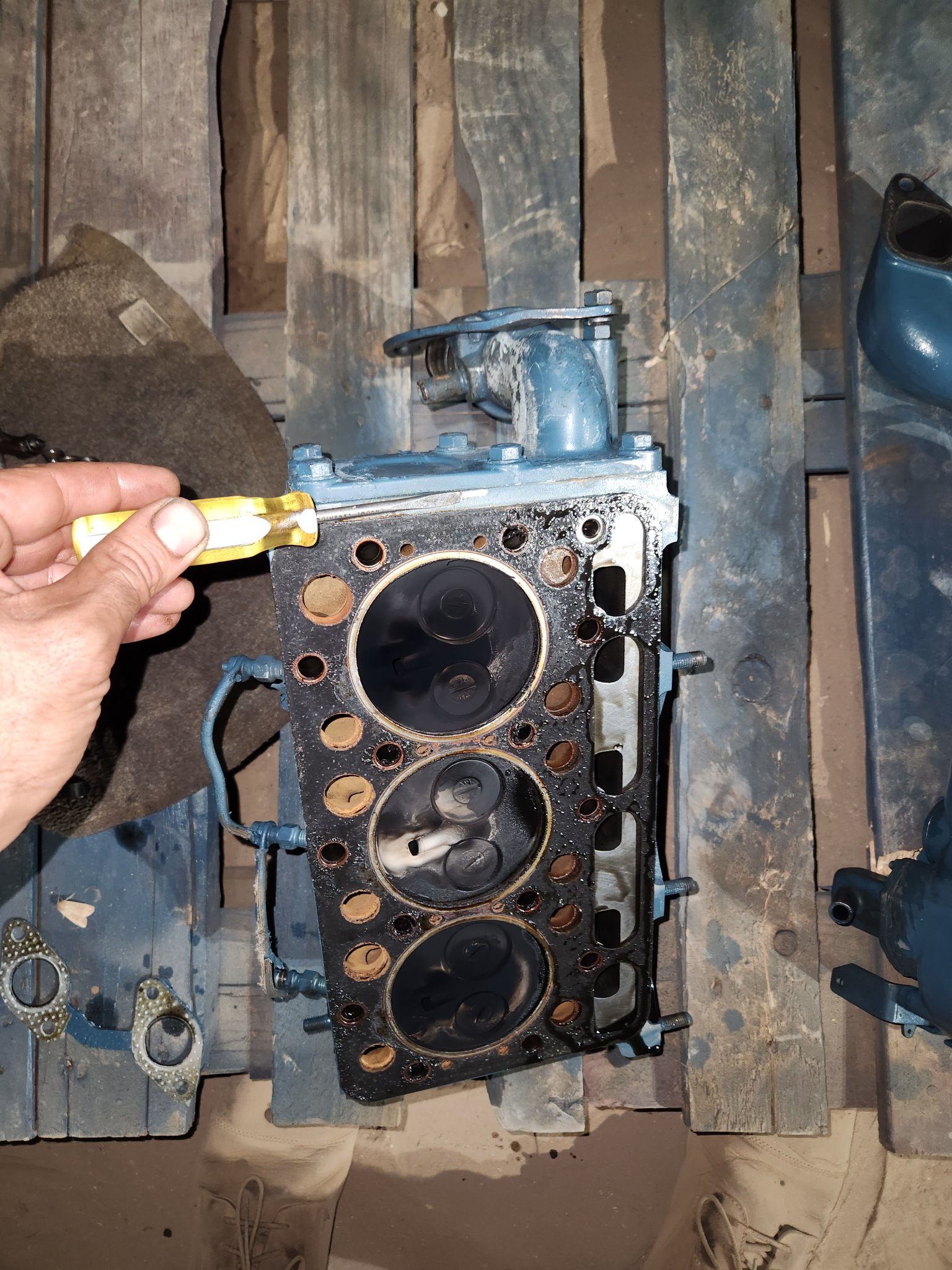

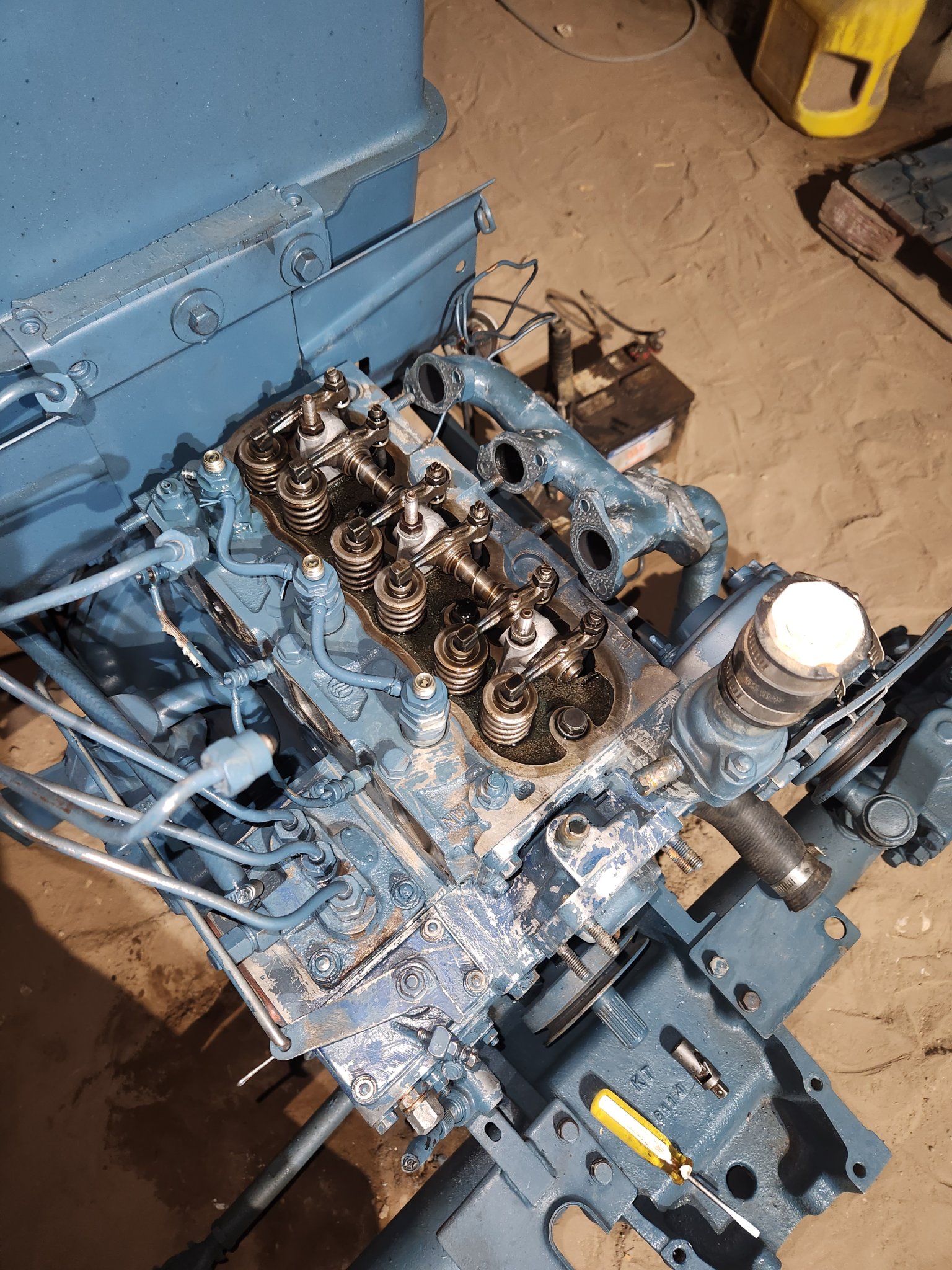

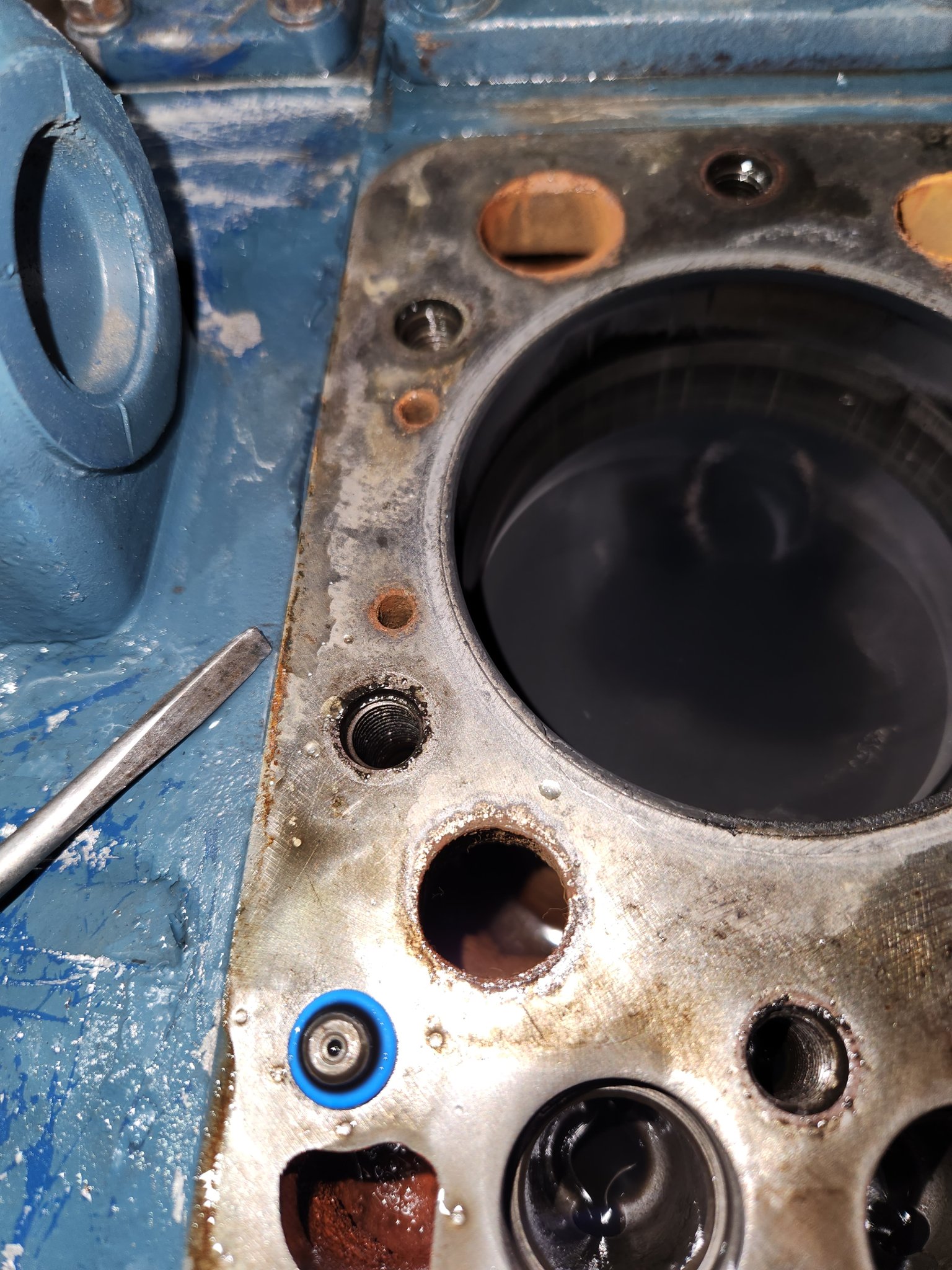

The leak now that I need to fix where I need to take off engine head:
I have zero access to leaking area without either taking head or gearcase off
I did install that flange onto head in improper order but did get gasket on it, but something there did not seal properly
solution to all these problems: as you build engine, you stop and pressure test,
get smart and get gadgets that test pressure like you showed, and come up with your own ways to seal engine, and test for these things
These are talents I dont have
Taking parts off, take off head bolts
I point: exact area where there was leak, i did not disturb the water
I point to the culprit, separate those two components, surgically seal them, might use some of that red RTV
