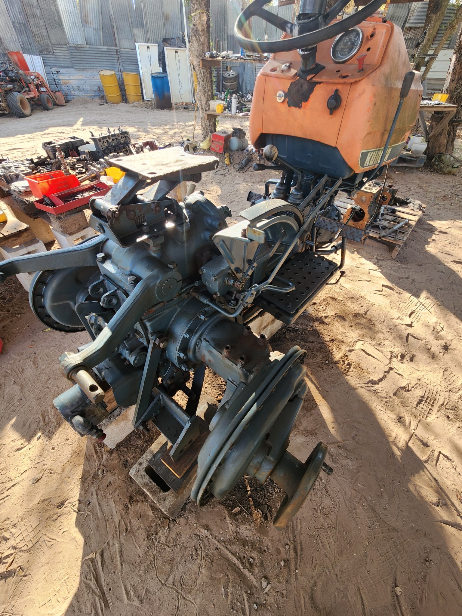

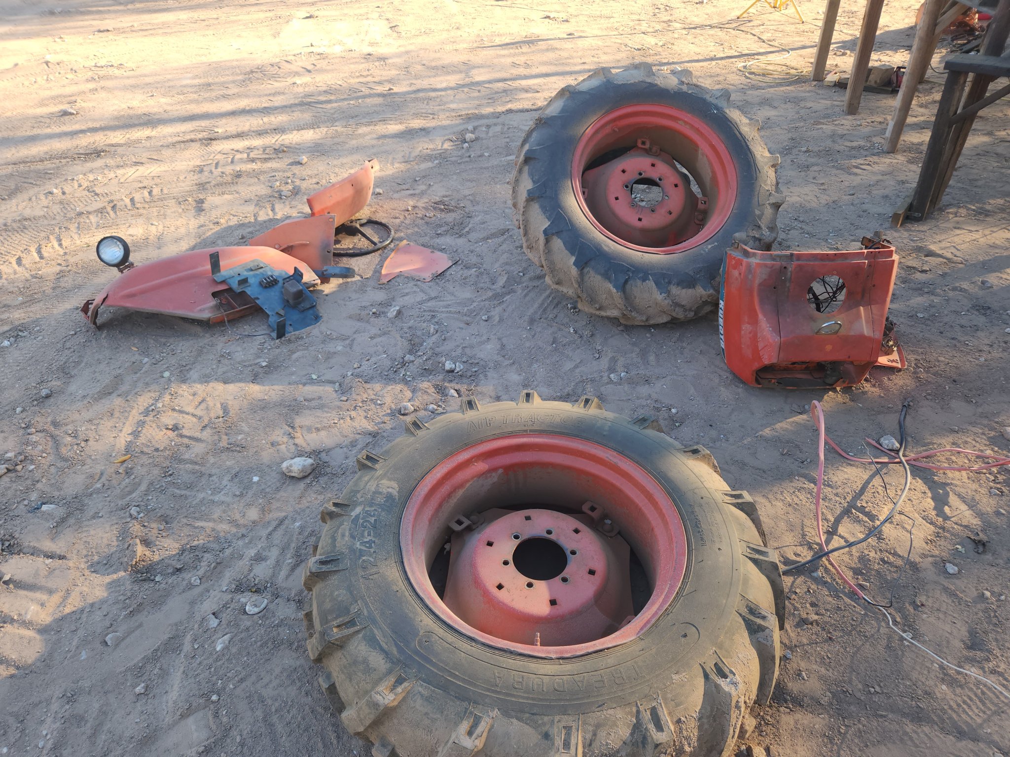

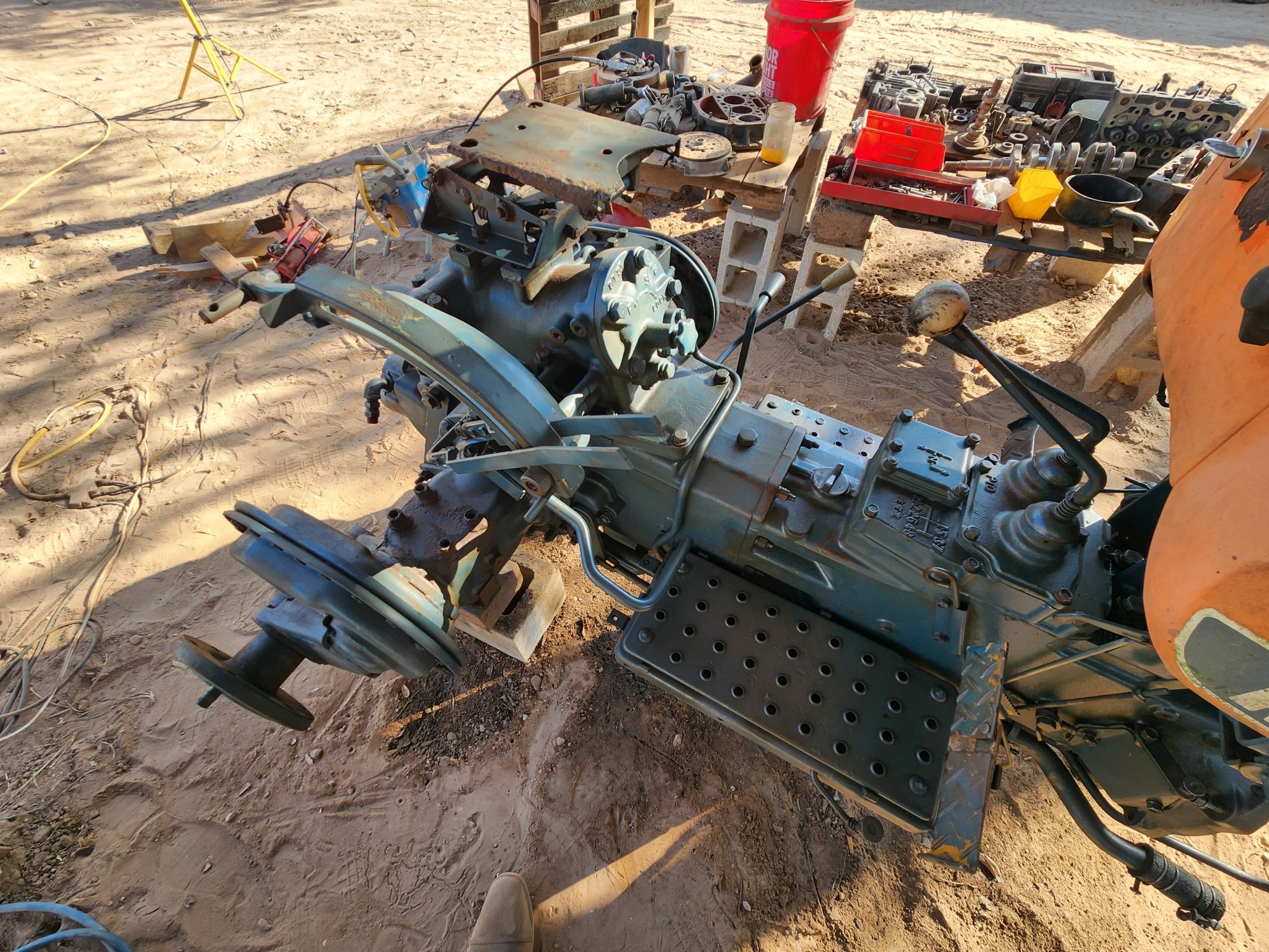

Might need to get 2 L305 tractors for 1000, stripping body get ready for paint
Steering wheel fully seized to shaft, hit hard with air diesel torch air chisel, nothing works, broke round part trying to unseize it
Picture: let it sit in solvent while I put tractor on blocks thinking of what to do about steering wheel seized
@D2Cat
Yes, she is in amazing shape
Hit it hard with torch, air chisel, won't budge, burned melted top and bottom
Let it sit for a day, clean body
Pointed metal and compressed air, now, poke diesel brush into crevices, soak body in diesel
This video show you science of how solvent clean metal

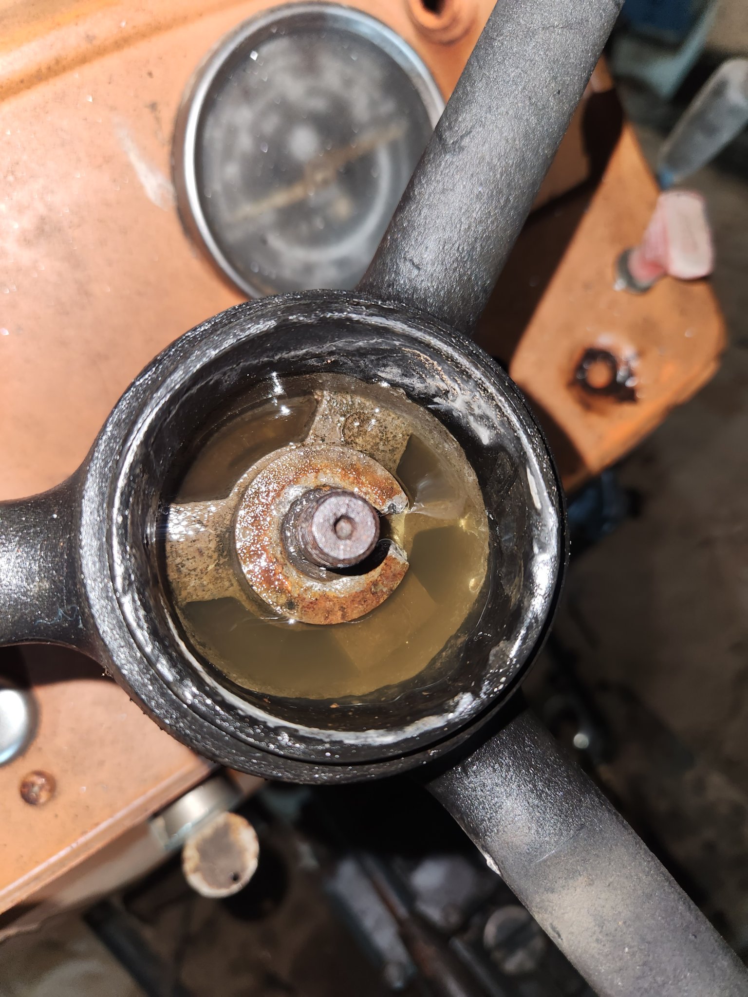

Seized steering wheel sat in transmission fluid and acetone over night, clean body get ready for blue paint

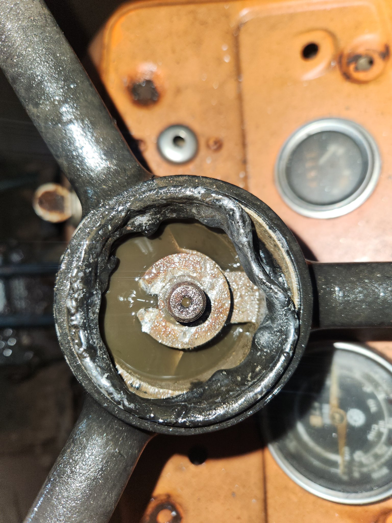

Goal: Try again to unseize steering wheel, finish wire wheeling body, and give one last wash, then use up rest of blue paint
Why cleaning is important: notice separation from loosened bolts, ton of crud was here, crud make panels separate from hot and cold cycles
Old steel coming back to life

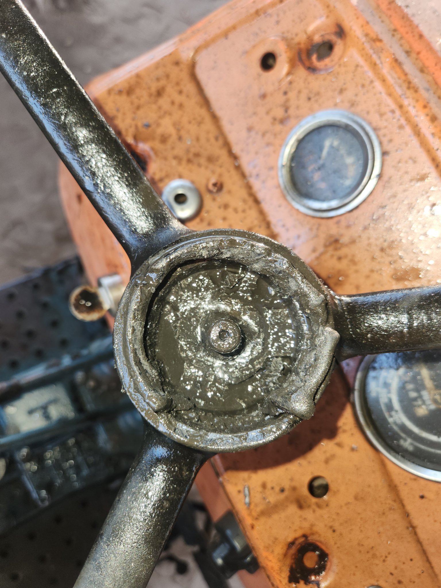

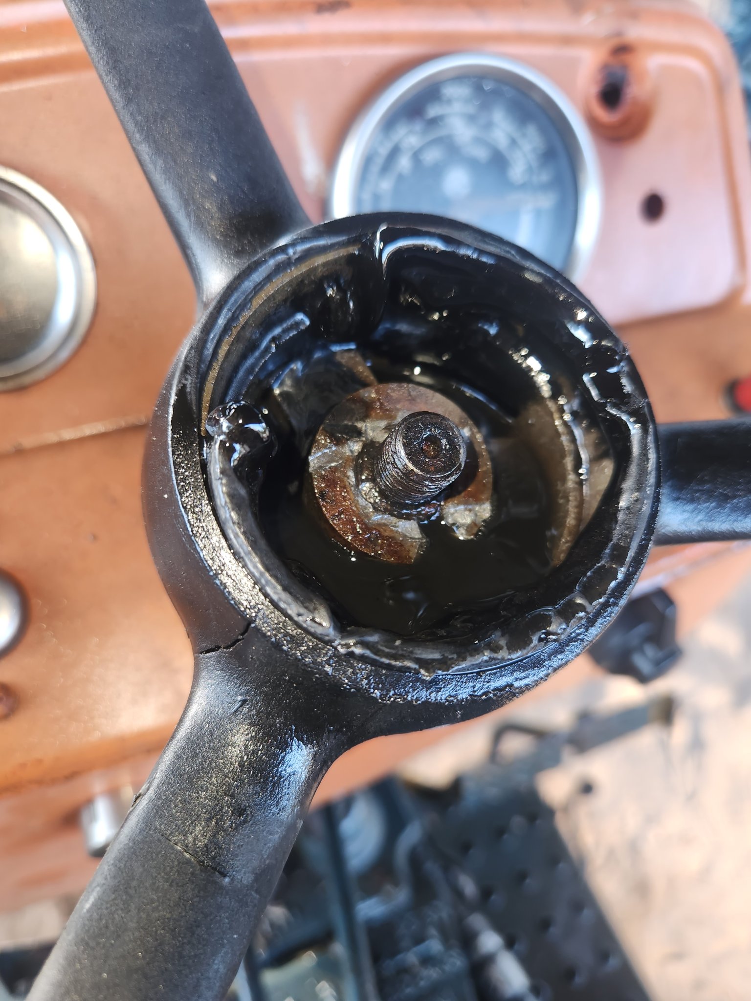

Hitting steering wheel torch, get ready to hit with air chisel
Cooking steering shaft, melting plastic, at this point I consider destroying it to get it off
I am 2-3 hours into trying everything to unseize steering wheel
Sharpened air chisel destroying steering wheel, it is fully seized
@D2Cat
Paint hardener: yes I agree, if I would have put hardener in that engine paint, it would have dried hard and not have lizard look
@fried1765
Why sand don't get in the paint:
When I hit it with solvent, it charges the metal to be repellent to holding dirt,
watch video from last post

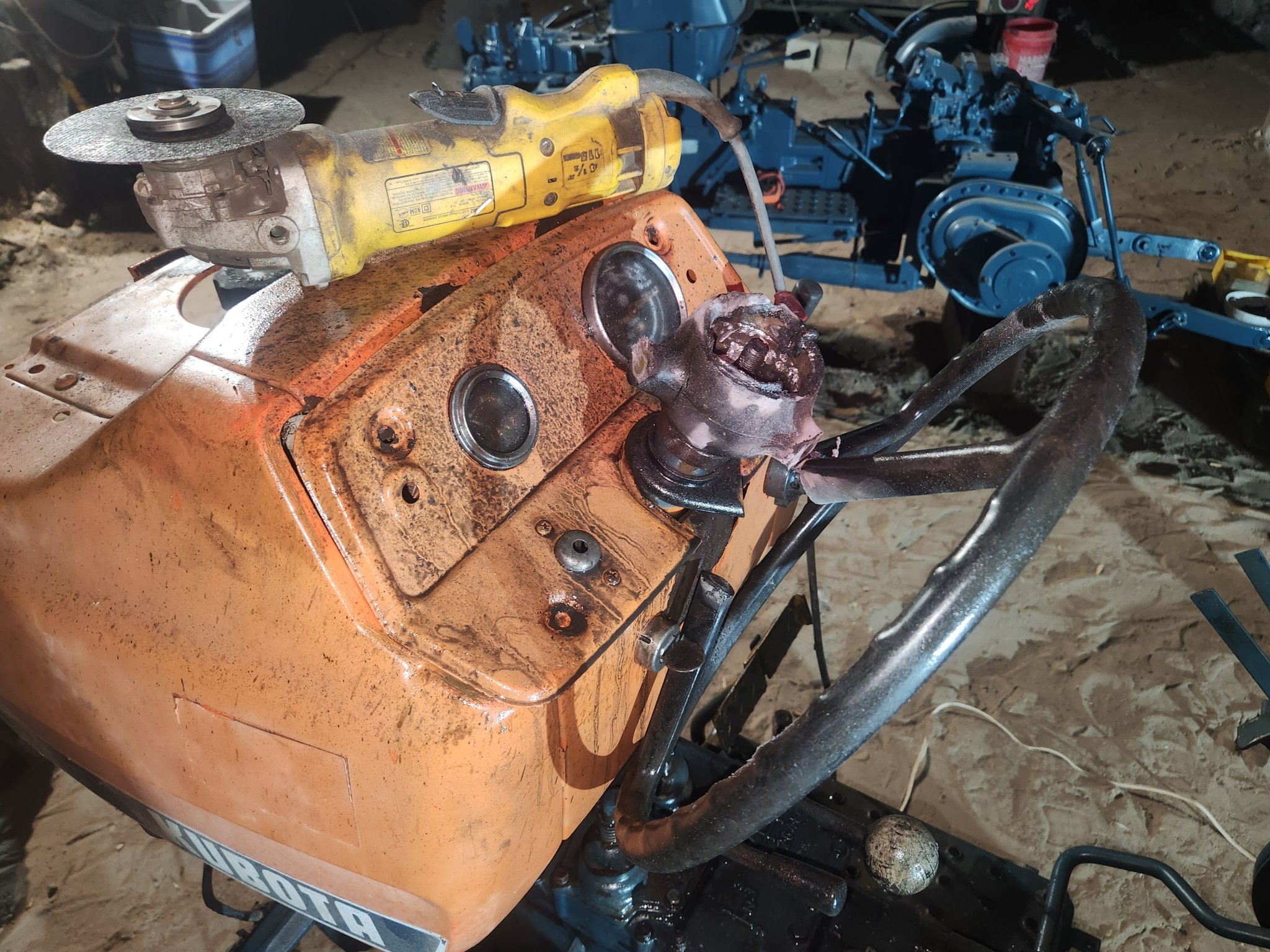

I give up, sharpened chisel few times, fully seized
Start cutting steering wheel
After hours of air chisel, slice steering wheel with cutting disc

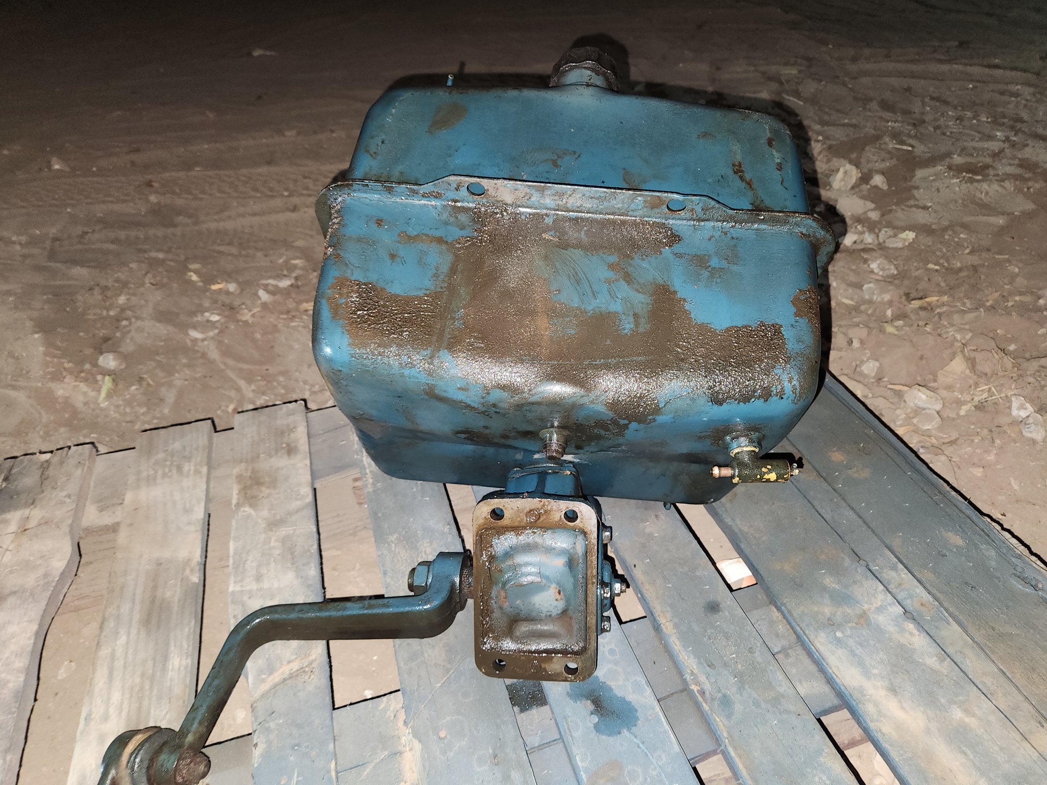

Raise fuel tank to access loose gear box
Empty diesel tank, take bolts off, raise it to reach gearbox problem
Took out fuel tank and steering in one shot
Mistake: did not have to destroy steering wheel, it would've come out and
I would have been able to seal up and fasten the gearbox properly

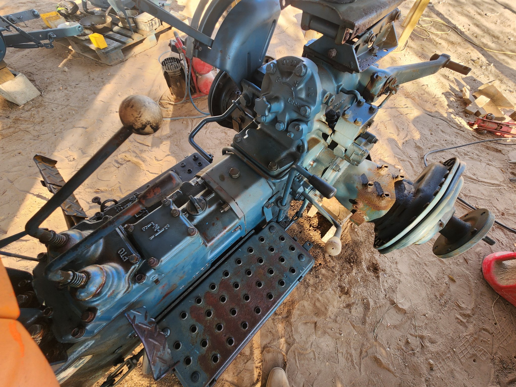

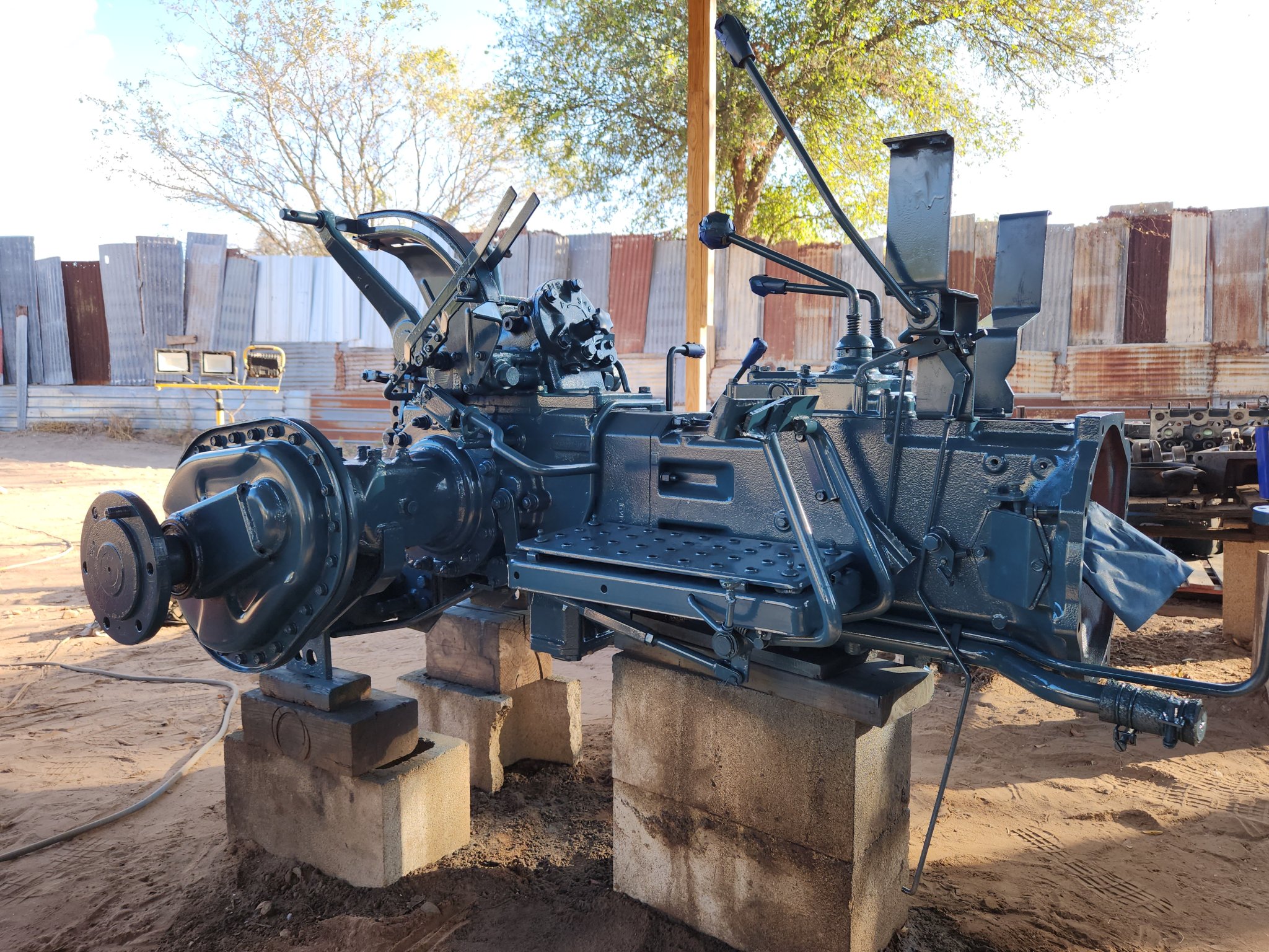

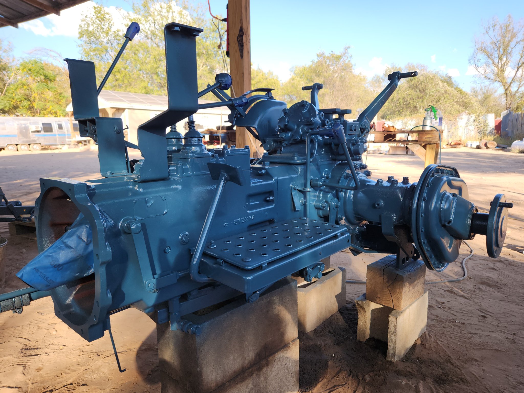

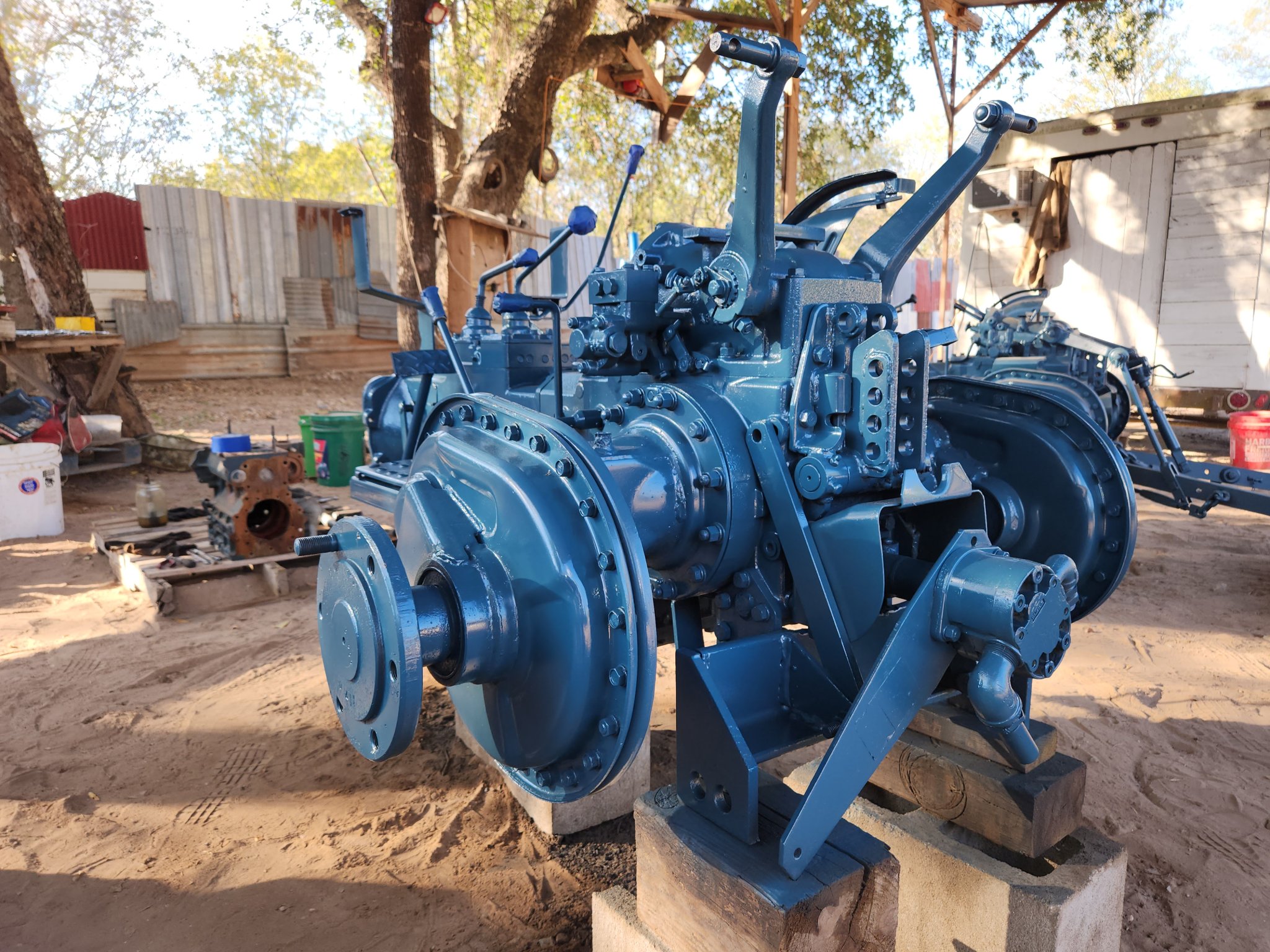

keep cleaning, get to painting chassis
Hit entire body with wire wheel, hit with compressed air, hit with cleaner
Now: hit with air, tape off handles, hit with paint
First coat paint

curious..... Would it have been possible to remove the steering wheel AND the shaft as one piece ?
If so, it could have been held in a good sturdy vice and then a 'pickle fork' used to push the steering wheel off.
