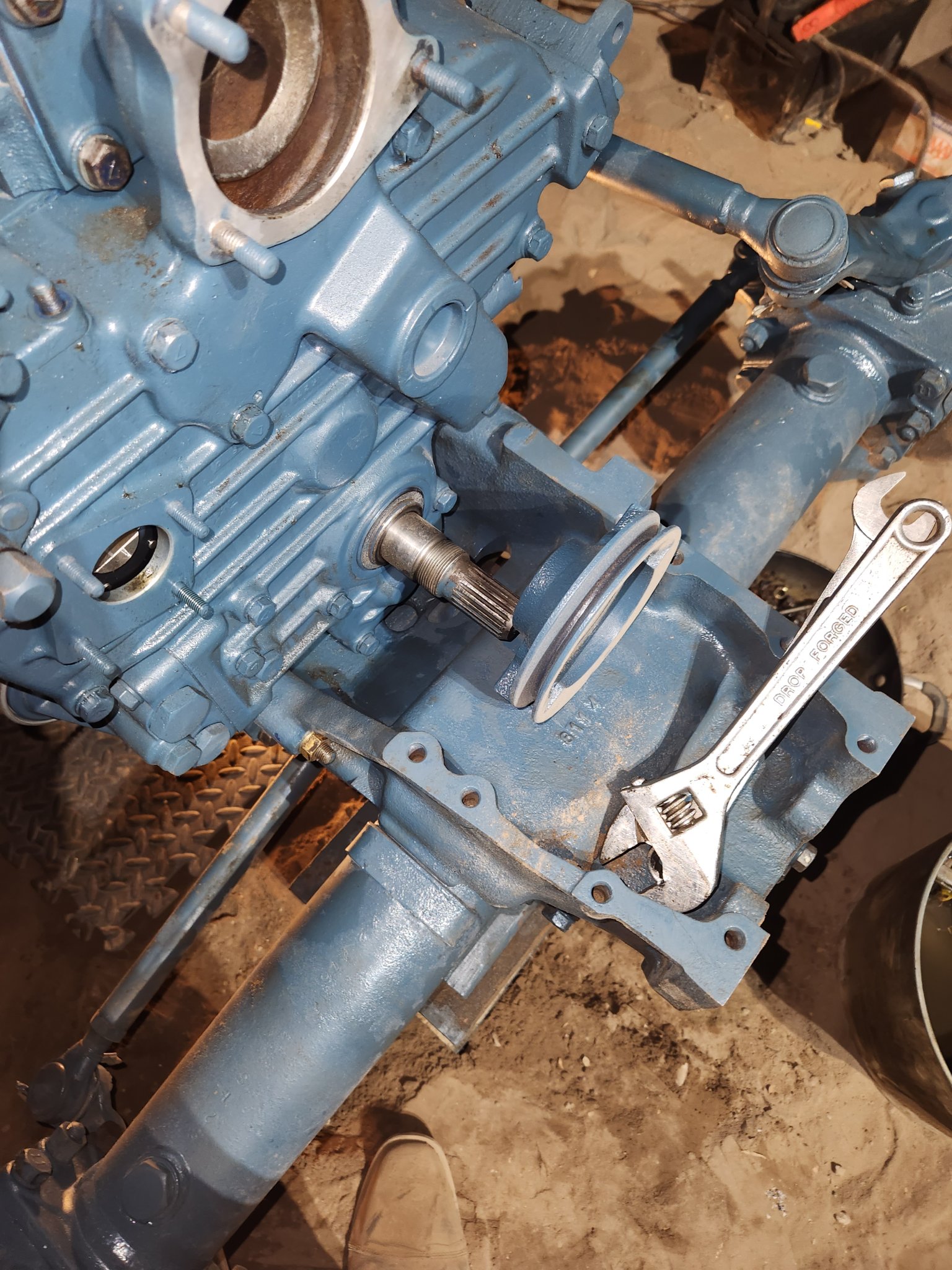

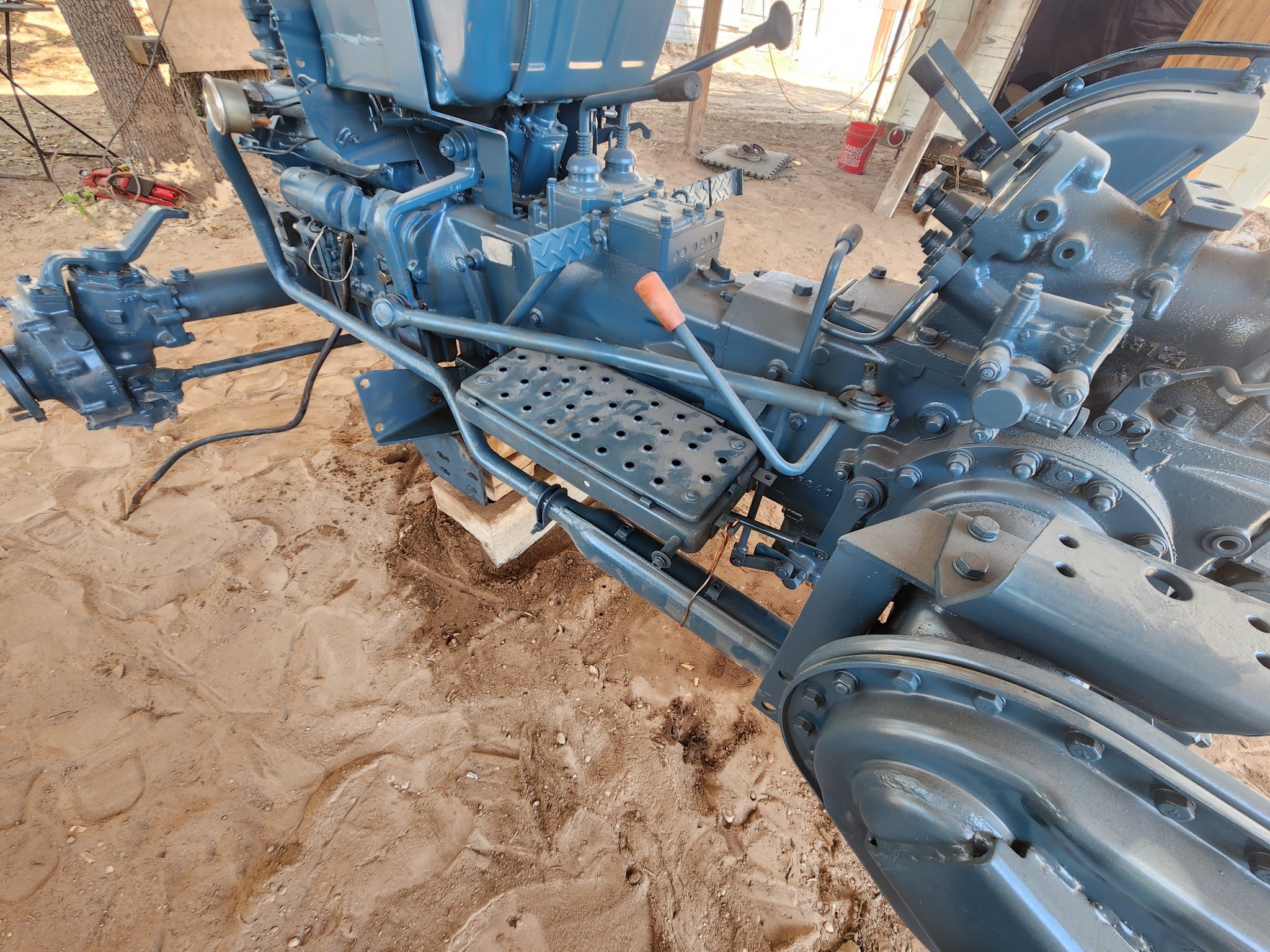

Had to take front support back off, try to install axle and bottom painted pieces
Mistake: I needed to put support onto axle first, then lift them together into the two studs on block
Setup of how I fix to put axle onto tractor
Zero chance I would gotten this far without 3 point lift on bx1500, the value it give is tremendous
Lift axle straight up, then push with body weight into the two studs, zero heavy lifting
Maybe I made mistake: put axle on, but it won't articulate, stuck in position
Forgot to put grease on where it swivel, maybe that small opening in picture is for putting grease on front axle swivel

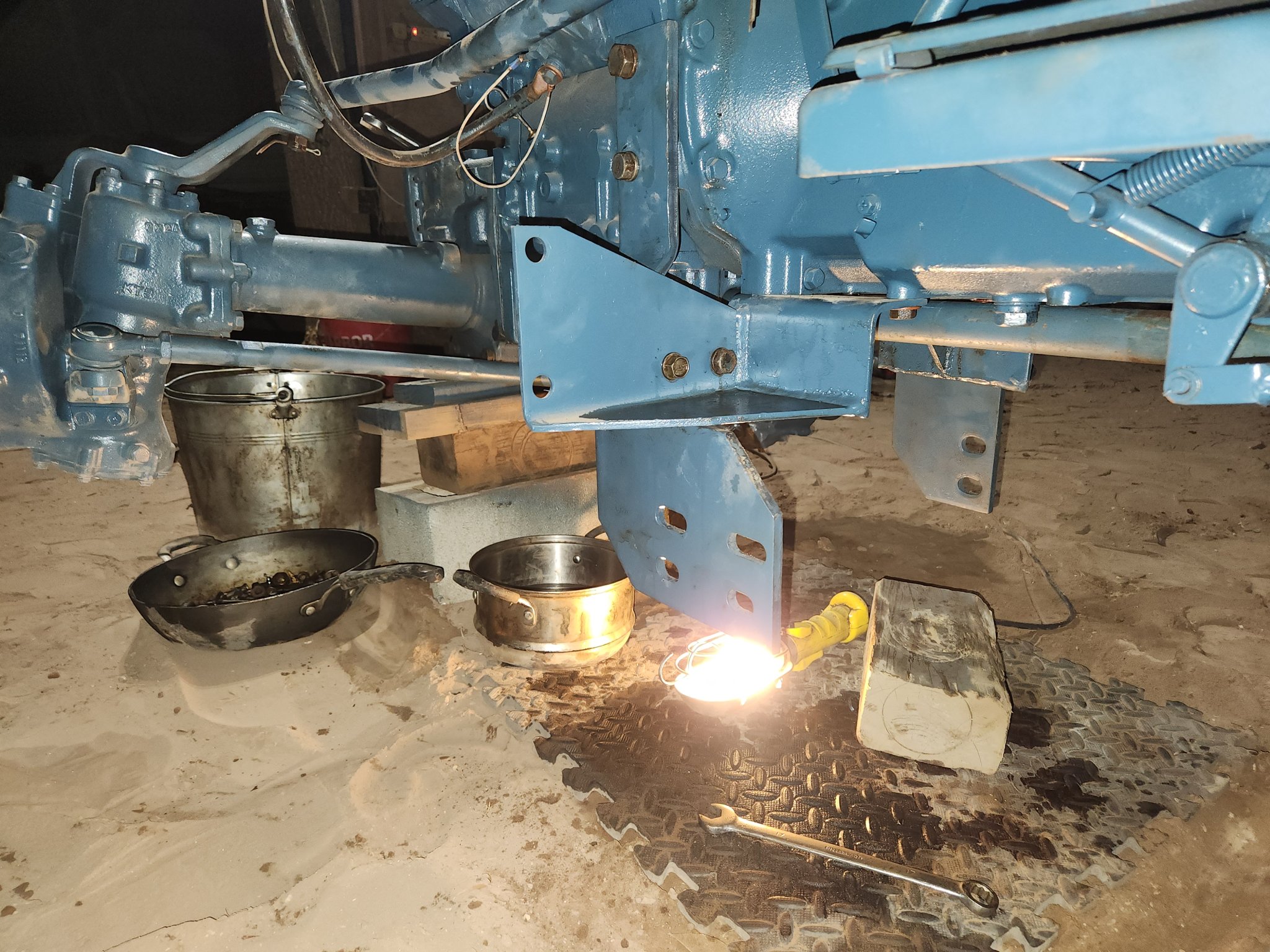

Hit it with torch/diesel, try to open it and pump grease inside
If I can't get small bolt loosened, put blocks under axle, remove that whole square, put grease inside, then put back on
Could not open grease port, support axle, take out bolts, remove it with air chisel
Sand everything, grease everything, put back together
Hand sand clean everything, put grease, reinstall

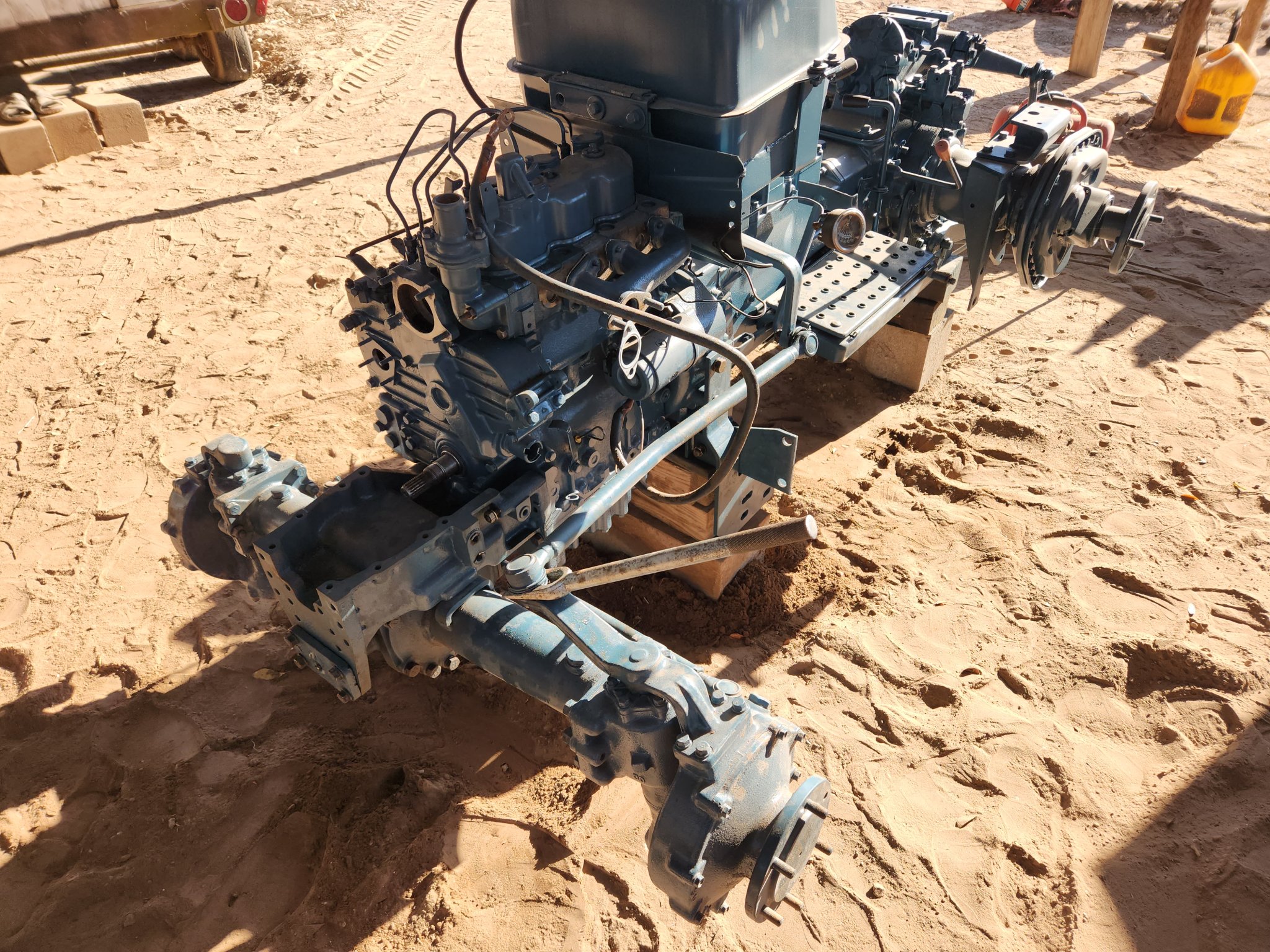

Installed axle, lifted tractor, moved support structure underneath axle to clear the way for putting in propeller shaft
Put in shaft with cover, put locking rings on it, cant seem to see where covers bolts to chassis, maybe another bracket
I could work on exhaust and the attachment brackets and their big bolts, I'll look at diagram about the shaft cover bolt

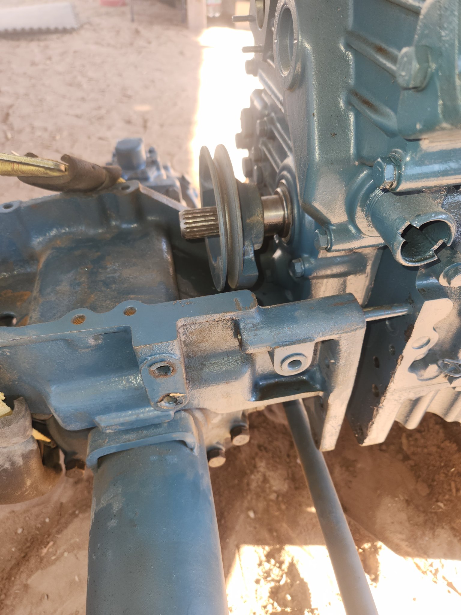

I hope I am wrong but I think you need to install the crankshaft pulley before you put the axle on. I don’t think it will go onto the shaft now.

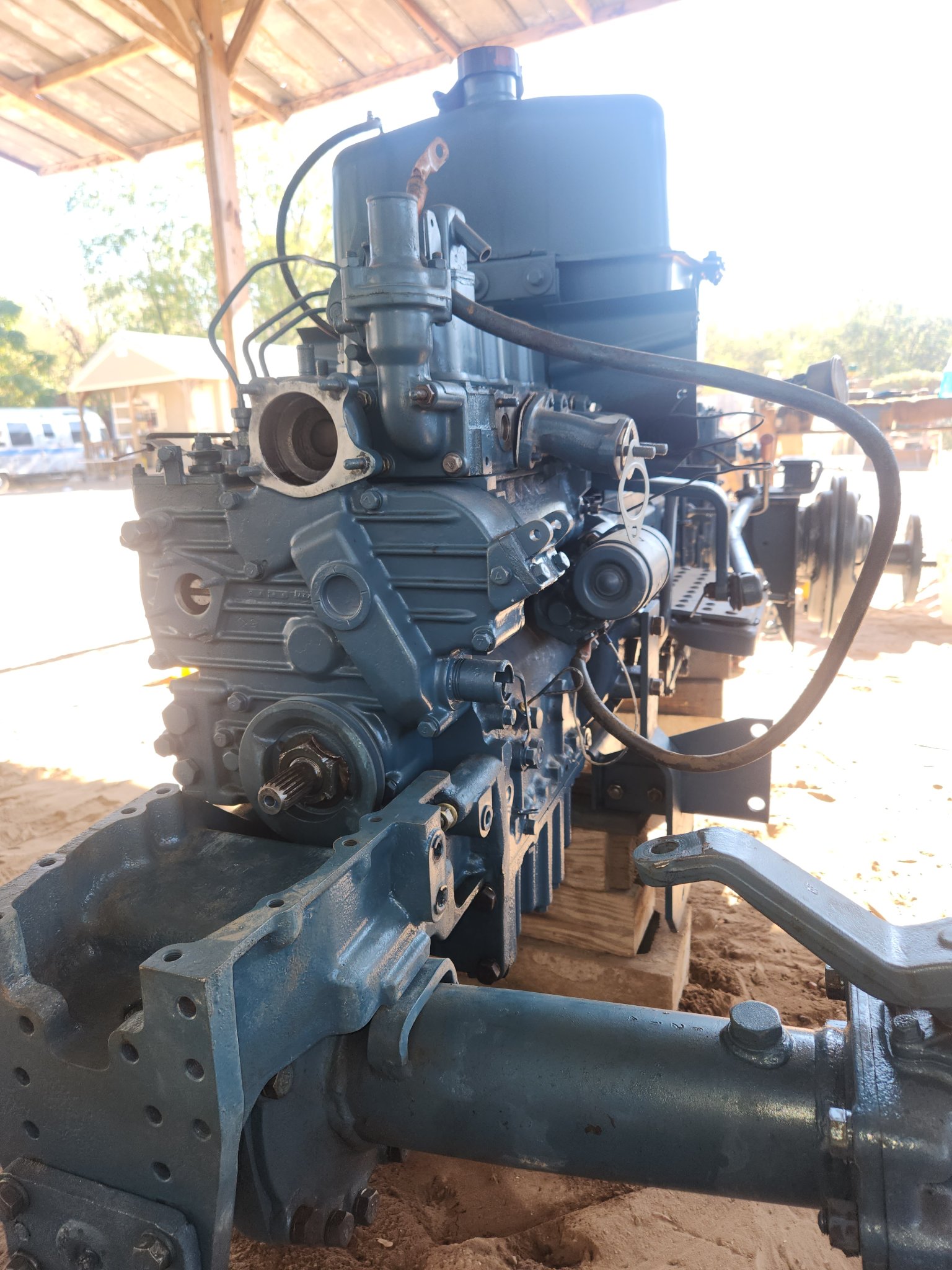

Forgot to install crank pulley, take axle off again
@Russell King is correct, crank pulley was first before axle
Mistake, should have looked at diagram
Chinese exhaust gasket: main one fit, smaller one did not, recycle 44 year old one

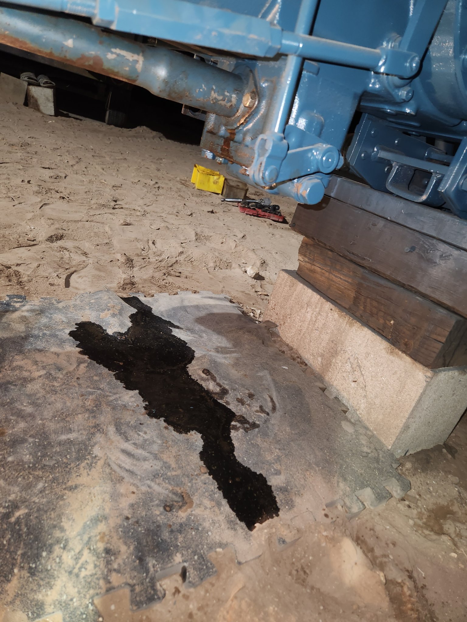

This leak got worse when I put propeller cover bolt in, maybe I put wrong bolt too hard and it pushed into the seal
Crank pulley: try first to loosen axle, and finangle the crank pulley into position
Fatigue making me sloppy, skipping steps not thinking correctly, not looking at the diagram

Take out axle, install crank pulley, continue reassembly
Moved support structure, loosened all bolts holding axle, remove steering link, bring 3 point lift and finangle pulley into place
Try not to take out axle completely
Took out all axle bolts, slid out axle enough to get pulley in, push axle back in, hopefully splines on shaft line up with axle
Axle, pulley, washer, pulley nut all fastened

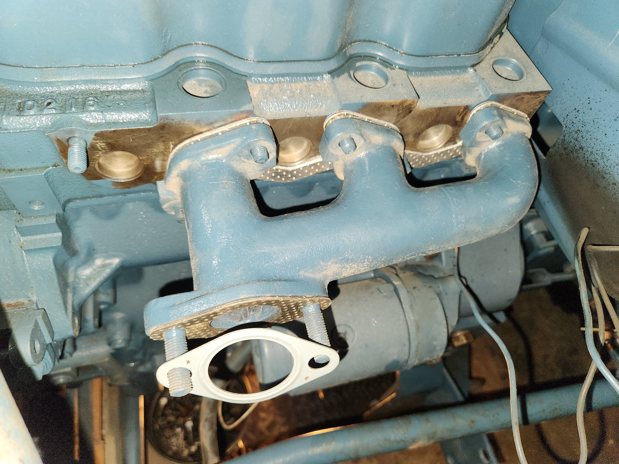

Install exhaust, then make progress on radiator long as it don't block access to governor
Installed muffler, couldn't find hanger, made hanger out of ground wire

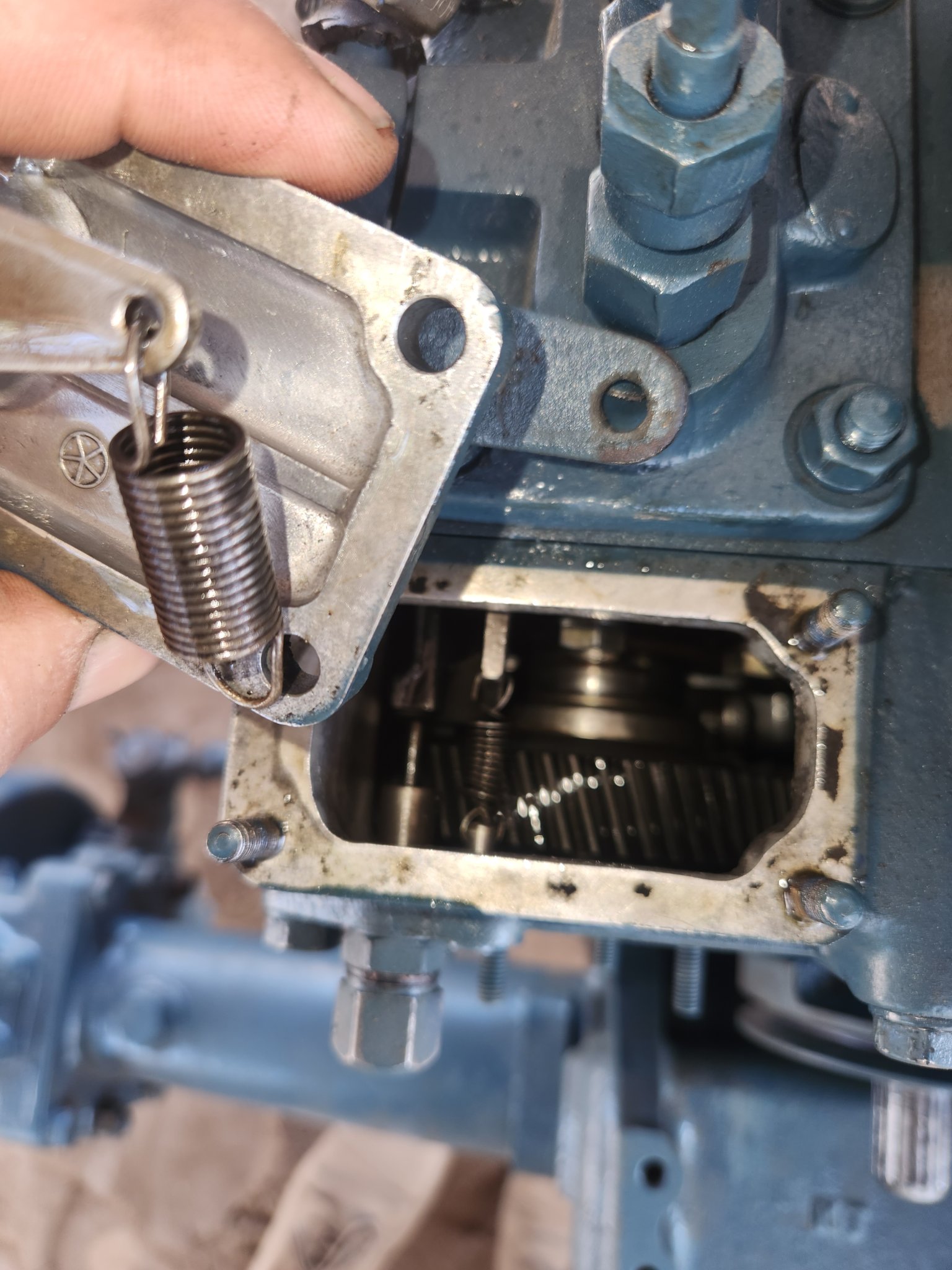

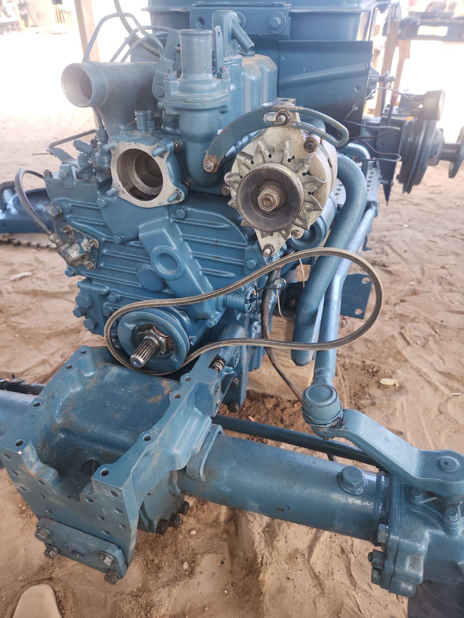

Tightening governor springs hoping to make it run better before installing: belt, alternator, radiator and plumbing, battery holder

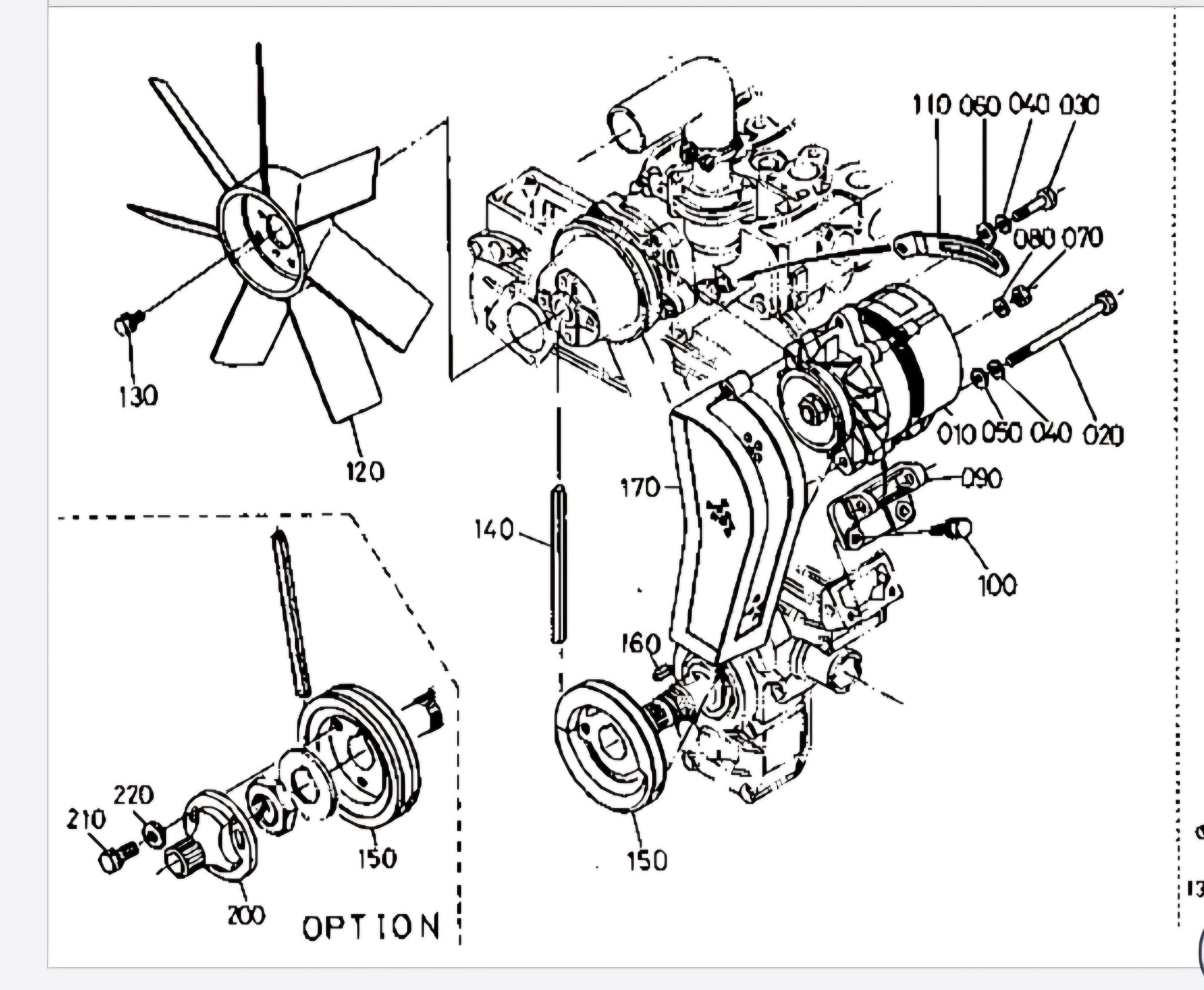

Study this diagram figure out assembly
Put on hour meter, alternator, water pump and plumbing, then radiator - battery box
Then i guess fill it with coolant and get it running
Fetch new gasket for water pump
Put new belt on tight using flathead to leverage alternator
Only parts left, looking at diagram trying to assemble them properly, forgot how radiator mounts

I'd feel better if you had the air intake covered. One little . . . (and the water pump and governor openings)
PoTreeBoy
L35 Ford 3930
Mar 24, 2020
3,492
2,074
WestTn/NoMs
I was thinking about dropping one little screw or washer into the combustion chamber could ruin all that work. Then I thought, dropping anything in the cooling jacket or crankcase could be bad, too.
