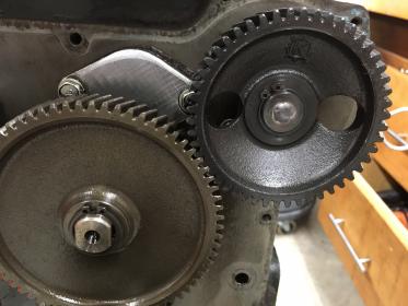

Got the plug tig welded in the end of the cam. That should take care of the low oil pressure.

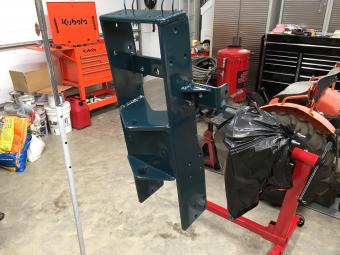

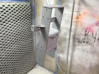

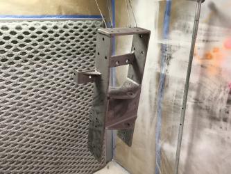

I picked up my parts from the dealer. I havent gotten the head back back yet from being cleaned. I got the front axel and frame all cleaned. I steam washed the parts first. The axel cleaned nicely. The frame I ended up sandblasting it. I was going to just use some rust oleum paint but none of the stores had any that would match. When I was getting my parts the guy told me that they carry Kubota paint in stock so I got some. Painted the the frame an axel. Probably wont get much done over the next several days with the holidays but I will try.

Please tell me the open engine block wasn't anywhere near the sandblasting operation... :eek:
FishLife
Nov 28, 2018
177
Destin, Fl
No. My shop is slit in two rooms. Blaster is in the other. Plus the engine is on a stand now covered with a trash bag. It’s in the background of the painted frame pic. Clean, clean, clean :)
