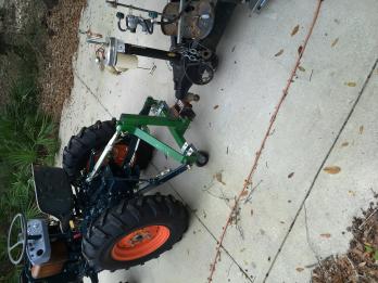

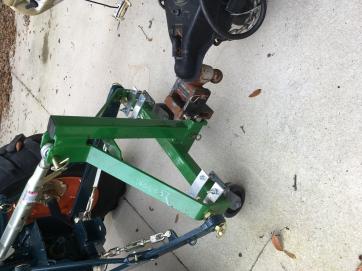

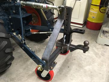

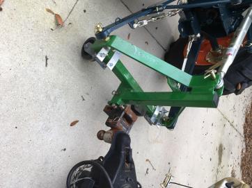

Now that we are back up and running I needed to find a way to move my travel trailer around in the drive. The tractors TPH can lift the boat and dump trailers fine but the camper has to much tongue weight. After kicking some ideas around in my head I came up with this. I didnt want to go out and buy any materials yet till I saw that it would work. I could not be happier (besides having a bigger tractor) with how it works. All the tongue rests on the casters and the tractor just push and pulls the load. I borrowed the hitch amd used some casters that I had to try it out. I plan on building The hitch to fit around my needs. I am going to use larger semi-pneumatic casters mounted on telescopic square tubing for adjustablity and removal. Getting ready to go on a trip and will tackle that project when I get back. I will post it In the fabrication section of the forum.
Sorry for the sideways pictures.:mad:

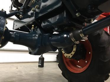

***8220;Stage one***8221; completed. Time to add fluids and wanted to see what the consensus is on what transmission fluid to use. Should I use Kubota UDT, universal H/T fluid, or just and 80-90 gear oil?
Might be a little late... Kubota UDT or any UDT compliant fluid would be a great choice. ;)
motorhead
2009 B3200, 2007 Dodge/Cummins powered Ram 2500 395hp
May 17, 2012
441
42
Atascadero
Fish, Again I say that you have done a beautiful job refurbishing your tractor. :D What I looked up is if you have a straight gear type transmission and not a hydrostatic, it calls for 80wt gear oil. I wouldn't be afraid to use a 75-90 wt full synthetic.

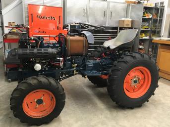

I know a lot of yall have been following along as I go through my restoration and I didnt want to leave yall hanging. I have not done anything since the hitch build. The warmer weather showed up and priorities have changed for the moment. The tractor is running and looking good so far. All that is really left is a little sheet metal work and paint the tins. I hope to work on it over the next month or so and get it finished up. As soon as I get some stuff done I will post it up. I do want to take a minute to say thank you to all for the help, suggestions, and encouragement on this project. This forum has a wealth of information and great members eager to help others out. So with that I say, Thank you.
