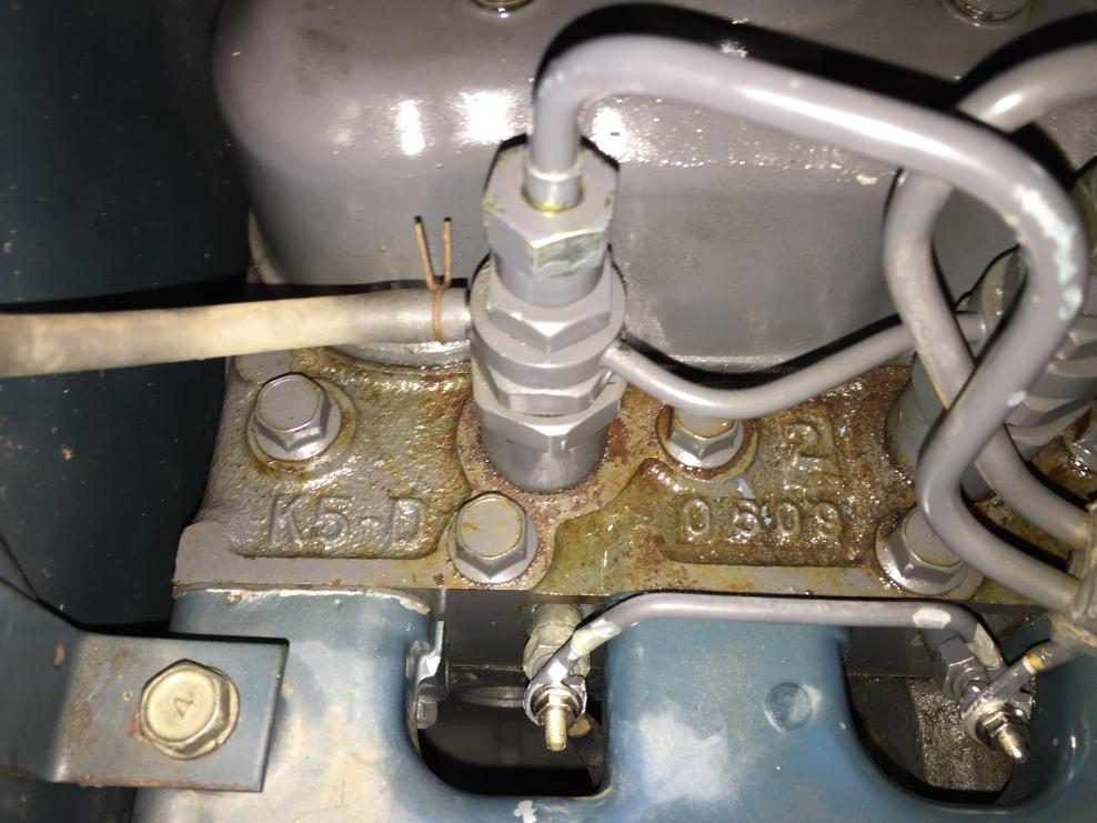

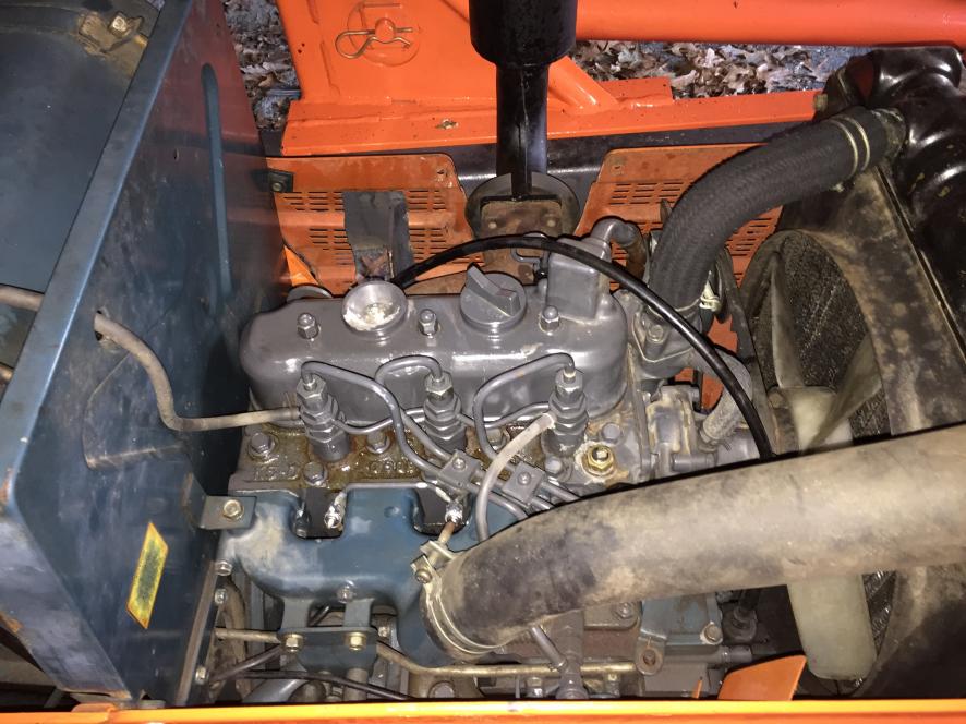

Weird thing happened when I changed the oil, read the manual and anticipated using 4 quarts. It only took 2 to get it full which leads me to believe its not the stock motor that came from the factory. I attached a few pictures, could someone help confirm my suspicions? Don't mind the oil spill on the top, the funnel slipped when i was pouring.

No, it's not the original motor, or at least it's been rebuilt. Color difference between head and intake, oil pan to bellhousing are indicative that it's been pulled and painted the wrong color for the year of the tractor.
Regardless, it's the proper oil pan for the engine. And it looks like the standard 3-4 quart pan the Kubota has used on the D750-D850-D950 engines.

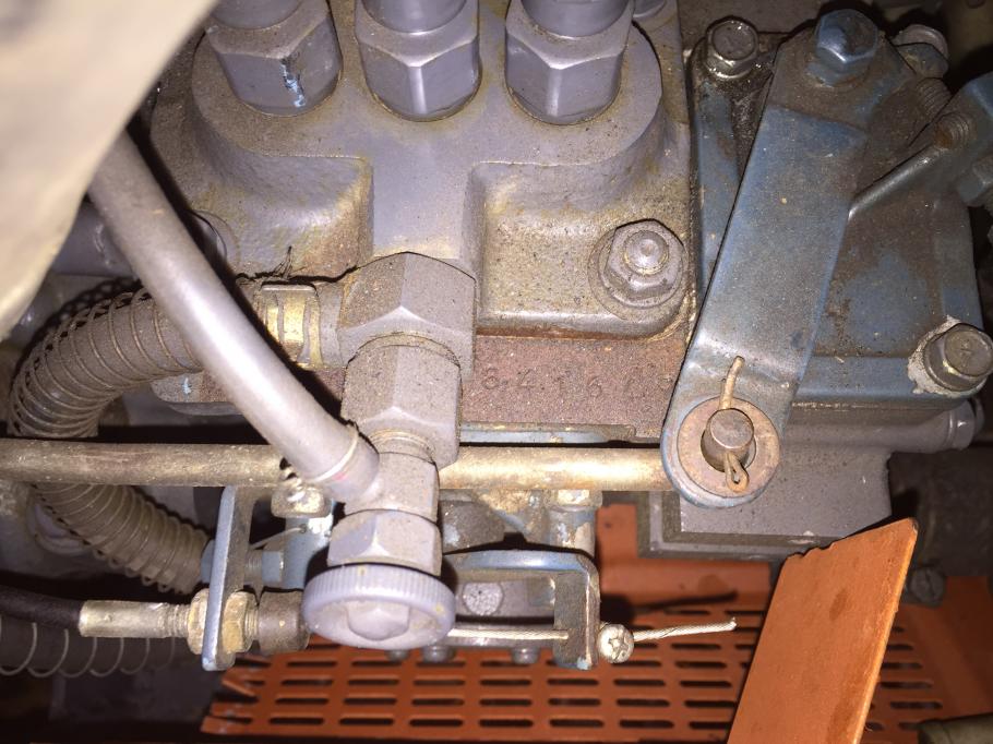

Yep what he said, not stock or rebuild, but same motor class (Stock would be a D950), you can find out exactly by looking for stamped numbers right front on the deck of the block next to the injection pump.
The size will also be cast into the side of the block on the right rear behind hydraulic pump.

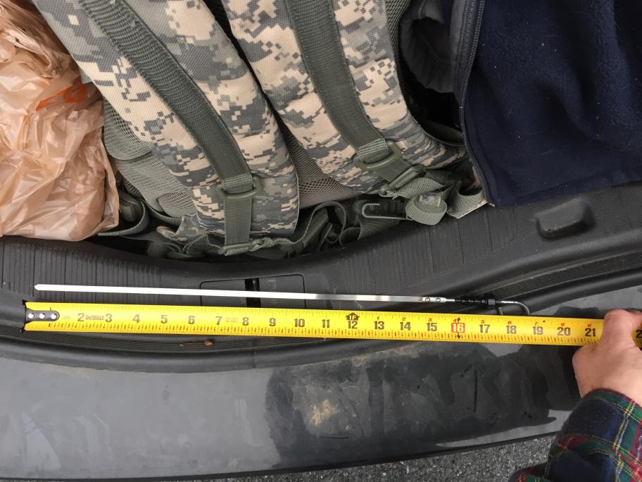

Post a picture of the dip stick and I should be able to tell you if it's right or not.
14,271
6,473
I think there is a number stamped on the dip stick. It's a part #. If the stopper is still attached securely, measure from the top of the rubber stopper to the bottom of the dip stick and post back. I will measure mine to compare.

Mine has dipstick #15973-36411. From bottom top to the stopper edge is 6 5/8".
The oil level in all Kubotas that I've seen is around the oil pan gasket level. Slightly higher than gasket usually.

That has an odd dip stick, but it does look good.
What mark are you calling the full mark?

After looking at all the pictures, here is what I've concluded.
The motor is not stock or even a stock build, thus the pan and dip stick design is not exactly right for that tractor.
It's possible that it's a lower slump designed engine, like a stationary generator engine.
If it where mine, I would drain all fluids, add the 4 quarts and mark the dipstick.
