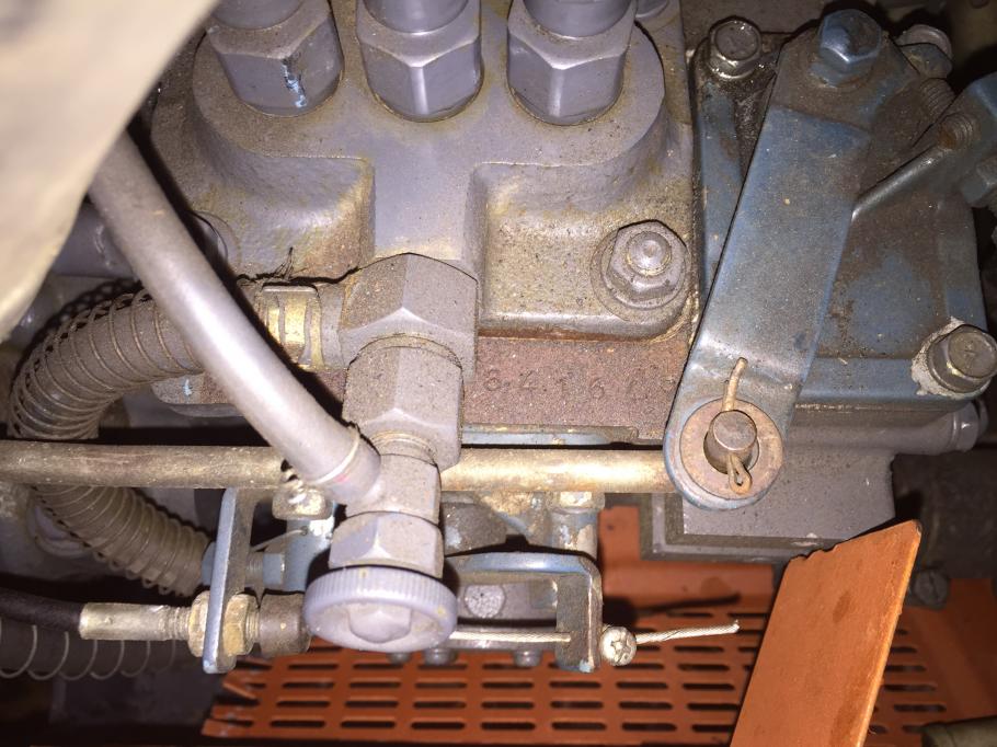

Man I don't know overfilling is almost as bad as underfilling. Can someone post up a picture of their id tag so I can try and find mine?
Any other better ways to figure out oil capacity without knowing engine number ? Ultimately I would like to know what motor it is so I know I'm using no the right parts going forward

Older engines didn't have ID tags like newer ones have.
You posted a picture of part of the model #... It just shows the serial portion of the number.
It's the number on the block, right front, next to the injection pump.
Here is your pic, the rest of the number will be to the left.
You might have to remove the bleeder valve and the fuel line to be able to read the whole number.
There is also a number cast into the side of the block, your other picture only shows the head cast numbers and they don't do any good.
