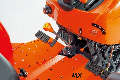

why is there a clutch? specifically when would you use it on an HST?
The placement of the brakes on this tractor really sucks, why is it right over the top of the HST pedal? weird, could get used to it, just really odd placement.
who the hell designed the normal HST pedal on these things, I really don't like them. the Grand Ls Aluminum pedal seems like a much better design and more comfortable to operate. can you just get a grand L pedal and attach, or are the mounts different for one reason or another?
