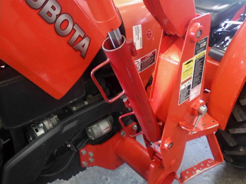

I went back out to the Kubota dealer and took a couple of photos of the FEL safety boot or cylinder lock as he called it. It is about 2 1/4 inches in diameter and about 18 inches long. It is hinged with the two halves held together with a pin. He said they had a local machine shop make them.

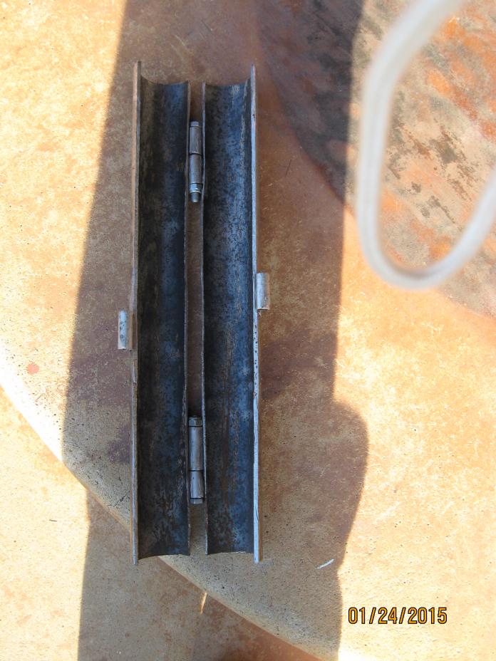

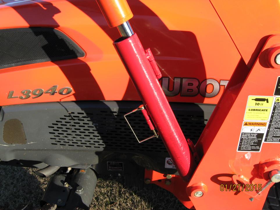

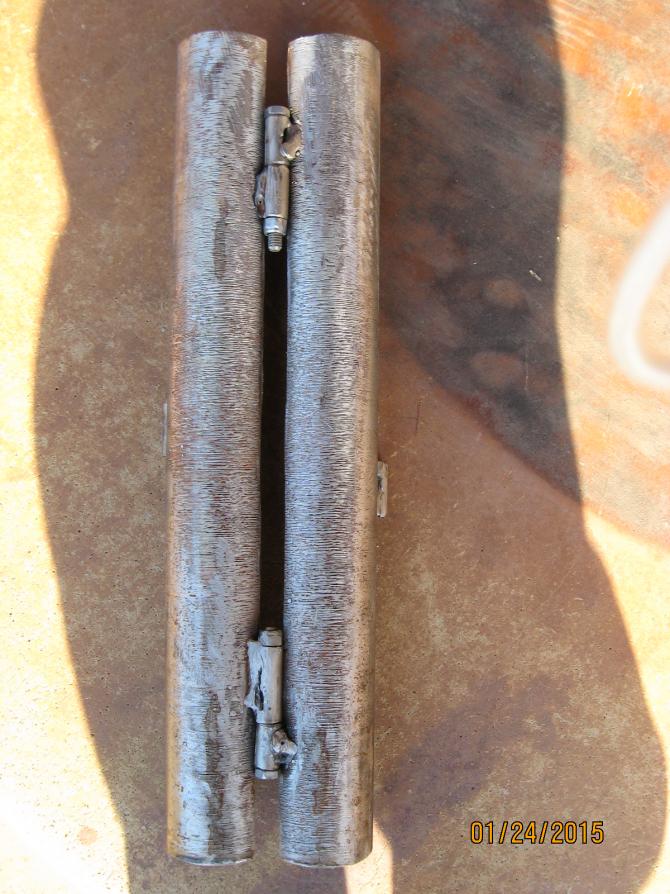

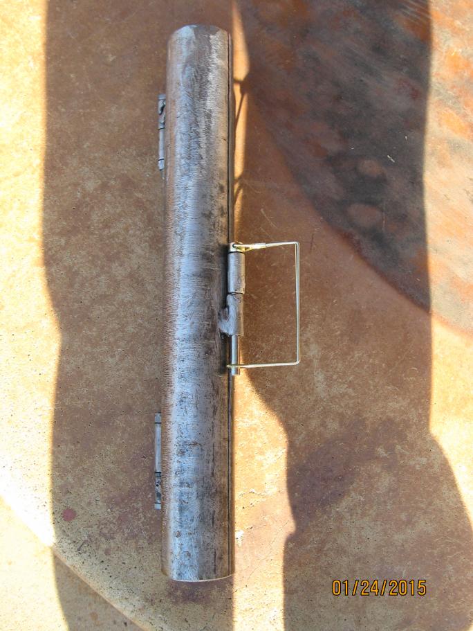

Since I originally posted this thread, I sketched a design for a safety boot (or cylinder lockout) and had a friend with a welding machine make it for me (you can see he is not a professional welder but it works). He uses some scrap pieces he had around so it didn't cost me anything. I agree with some previous posts that you should never work under a raised lift, but if you find yourself in situations that require you do, then it is better to be safe. I wanted to share these with you in case any are interested in making one. Have a good day.

Excellent work - and that would not cost an arm or leg either.
Dumb question - do you use ONLY one? and if so - if the cylinder leaks down over time (assuming it is up for hours) would it place a strain on the system as only one is supporting the load of the bucket? I hope you get my question.
Or to better answer my question - it IS ONLY used as a device to prevent it from potential falling and therefor saving a human under the bucket? If it ever moved quickly the last worry would be about the machine! :)

I originally saw one at the dealer and they only used just one cylinder lockout. The mechanic was working on something with the bucket raised and had the cylinder lockout in place. Should something cause the hydraulics to fail and the bucket to drop, it is designed to catch the cylinder and prevent the FEL from falling further and injuring the worker. It is primarily a safety device to prevent injury or worse.
However, in my neck of the woods, some folks use an FEL to lift a deer while skinning it. I can certainly see the need for something like this to be in place before getting under the bucket. It may save a life.
