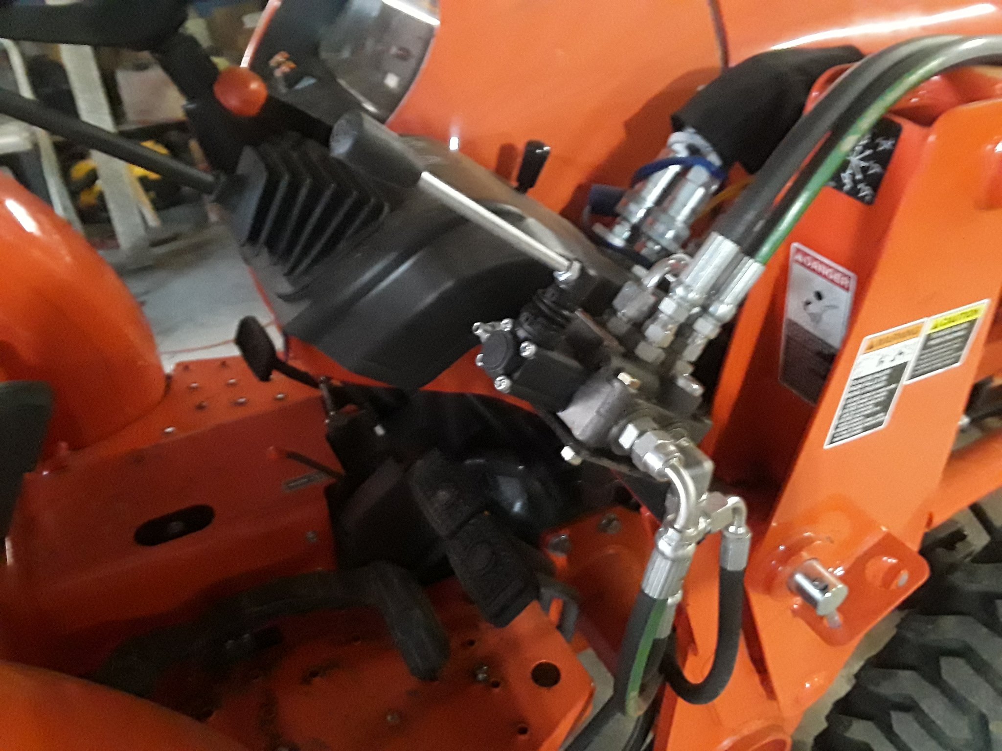

You could replace it with a 4 position valve that gives you regen and motor control. There are multiple aftermarket valves that would work but they arexa little pricey. I would simply add an inexpensive ($75) single spool valve next to your existing valve and use it for the motor control.
I'll probably do that. Do you know if the existing Kubota 3 way valve with regen on my BX2200 has an open or closed center valve? If I price a new valve I need to what kind of set up I currently have.
9,966
5,291
Your tractor is open center. and your auxiliary valve should be open center with power beyond. Here is one I mounted next to the LA525 loader valve. It's my quick and dirty third function for a grapple.
9,966
5,291
You'll want about the smallest GPM valve offered too.
The valve in my picture is an 8 GPM Prince Wolverine MB11B5C11. Compact, readily available, comes with the power beyond adapter, and costs $115. The ubiquitous 40 LPM P40 valves sold by Summit and a host of others are also good fits and a bit cheaper. The power beyond sleeve is usually not included and will add $20 to the price. The very low cost ones also often have BSPP not SAE ports. In the US the BSPP port adapters are less common than SAE adapters and a little more expensive so they also eat up your "savings".
