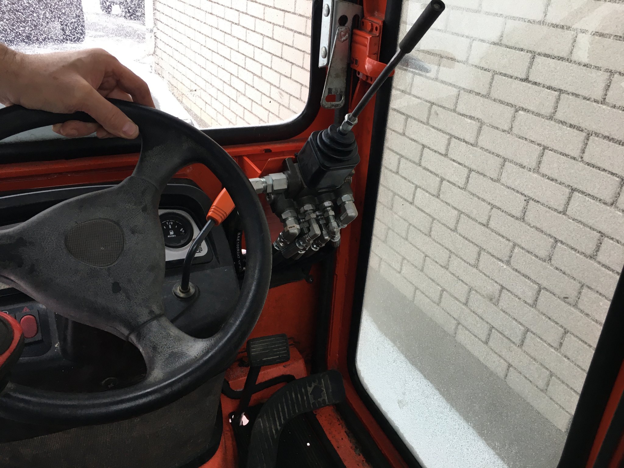

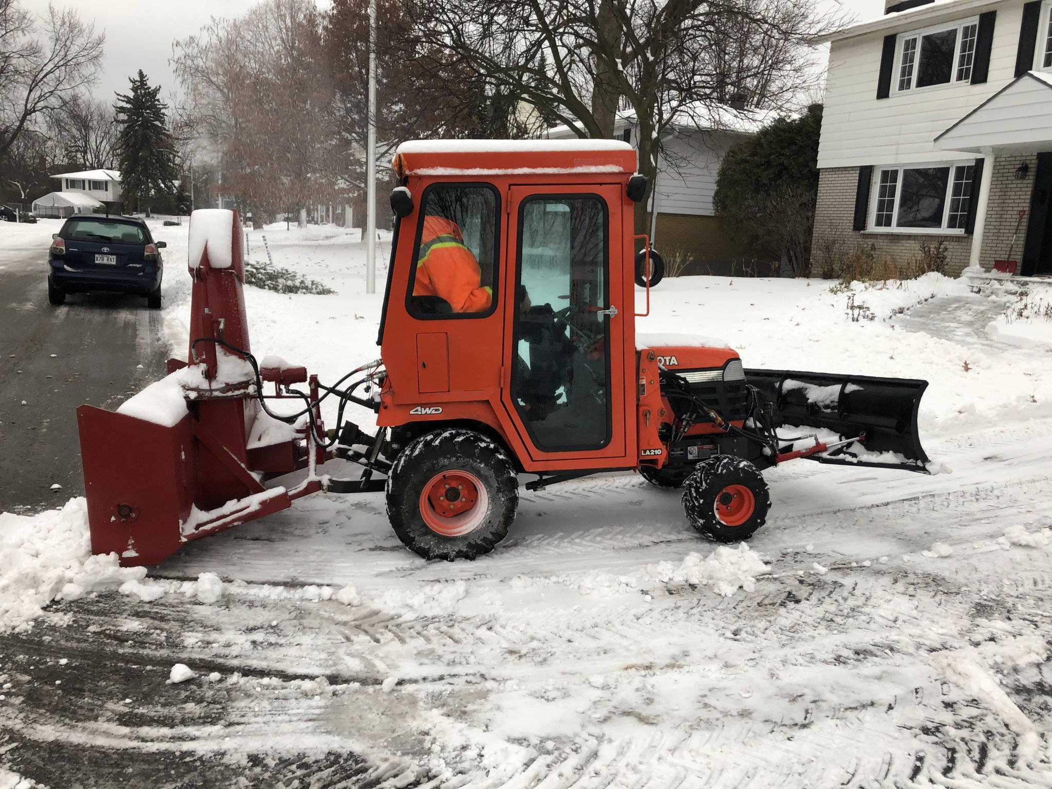

I finally got around to taking pictures of my winter set up. You will notice that the blower's impellar is the wrong rotation, but I got such a good deal that I built a reverser for the PTO that is attached to the blower.

I finally got around to taking pictures of my winter set up. You will notice that the blower's impellar is the wrong rotation, but I got such a good deal that I built a reverser for the PTO that is attached to the blower. View attachment 73070
Nice set up Boo. Due to the valve from my LA211 having a regenerative circuit I was thinking on putting the valve back on my LA211 front end loader and going out and buying a new valve. I had fun making the support for the hydraulic motor. Due you or anyone reading this know of a good double acting valve that can lift my front snow blower and allow it to float and also doesn't have a regenerative circuit so my chute will rotate in either direction?
I mounted my loader valve permanently on the tractor and then bought a solenoid valve and plumbed it in after the loader valve on the pressure beyond port. Then added a switch on my joystick to control the solenoid valve. Mine was one of the 3-way valves with the regenerative circuit
You could replace it with a 4 position valve that gives you regen and motor control. There are multiple aftermarket valves that would work but they arexa little pricey. I would simply add an inexpensive ($75) single spool valve next to your existing valve and use it for the motor control.
