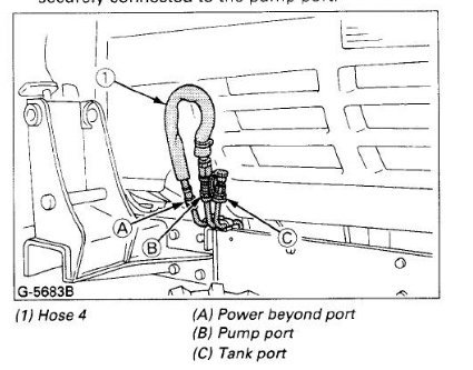

My BX2200 is one of the first ones made and the loader controls come off with the loader. With the loader off one is supposed to connect the power beyond port to the pump port as shown in the image. Is there a problem with moving the tractor without making this connection? Can one mow with it?

That is what I figured but was hoping that it was not so. Thanks

Why wouldn't you? It's just one quick coupling to hook up and you need to cap the other too. Takes 30 seconds to do it.

Im pretty sure if you dont hook up to the power beyond the tractor will not move!

I want add a 4 way spool valve once I remove my loader set up so I can operate a snow plow. The spool valve I have has the PB port. Does anyone know which port gets connected to which of the tractor hoses. My thoughts are Pump port (B) goes to the P port on the valve, The tank port (C) gets connected to the T port on the valve and the Power beyond port (A) gets connected to the PB port of the valve. Please correct me if I am wrong as I love my tractor and don't want to damage her in any way.
