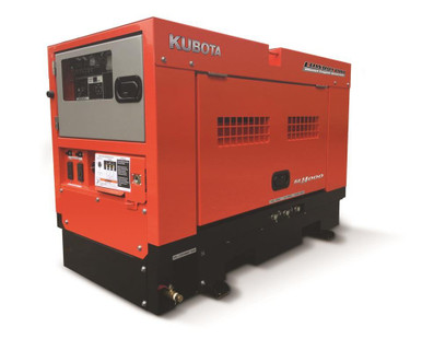

What are your opinions on propane vs diesel for home backup generators? We have a 500 gallon propane tank and could upgrade to 1000 gallons. Looking for ~14 kW. Seems that diesel engines use less (volume) of fuel and would be cheaper to operate. Not sure about the long term prospects for propane or diesel.
Kubota makes a generator in the power range I am looking for.
Thanks in advance for your advice.

Having a diesel truck and tractor I keep fuel around so I went with the Kubota GL11000 and it works great, maybe a little overkill because I will never use it enough to wear it out.
Kubota direct has some good deals on the generators.

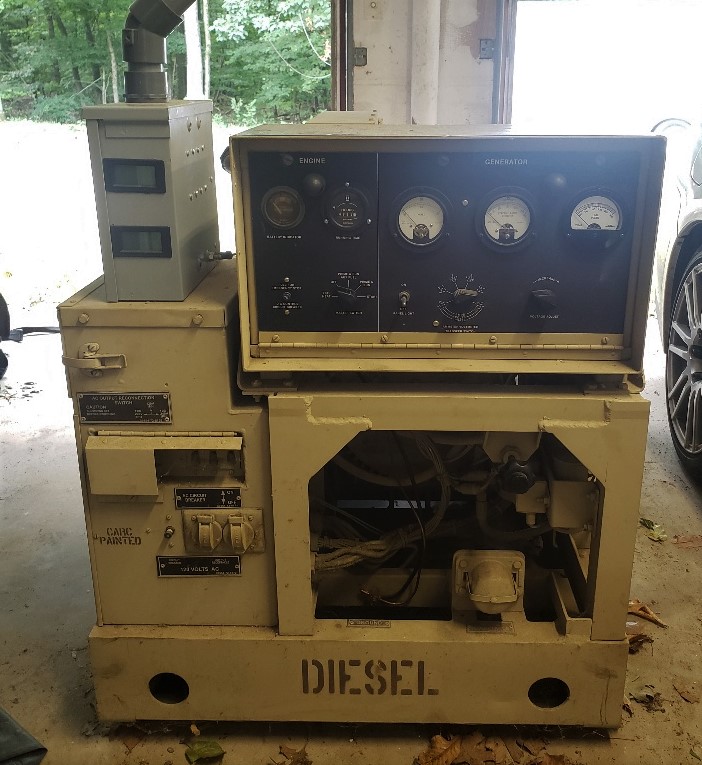

Several years ago my son in MD and I bought 2 10K diesels from an auction at FT Meade. The government had refurbished both of them and put them on brand new trailers - then put them up for auction. Mine had .75hrs on the clock. Only the government.
I installed mine in our garage and sold the trailer. My son still has his on the trailer.
It's wired for manual changeover. I found a brand new 400amp switch on ebay for $200 - shipped free.
I added digital current monitoring on each leg. Other than that it is just the way it came. I run it on #2 heating oil, just like I run my Kubota.
It's built like a tank - 4 cylinder Onan air cooled motor.
The company I work for sells Honeywell (rebadged Generac) gensets. A 10k unit weighs ~300lbs. This one weighs 1300. I couldn't get it off the trailer with my former L3400 - had to call a tow truck to lift it off.
Runs our whole house easily.
