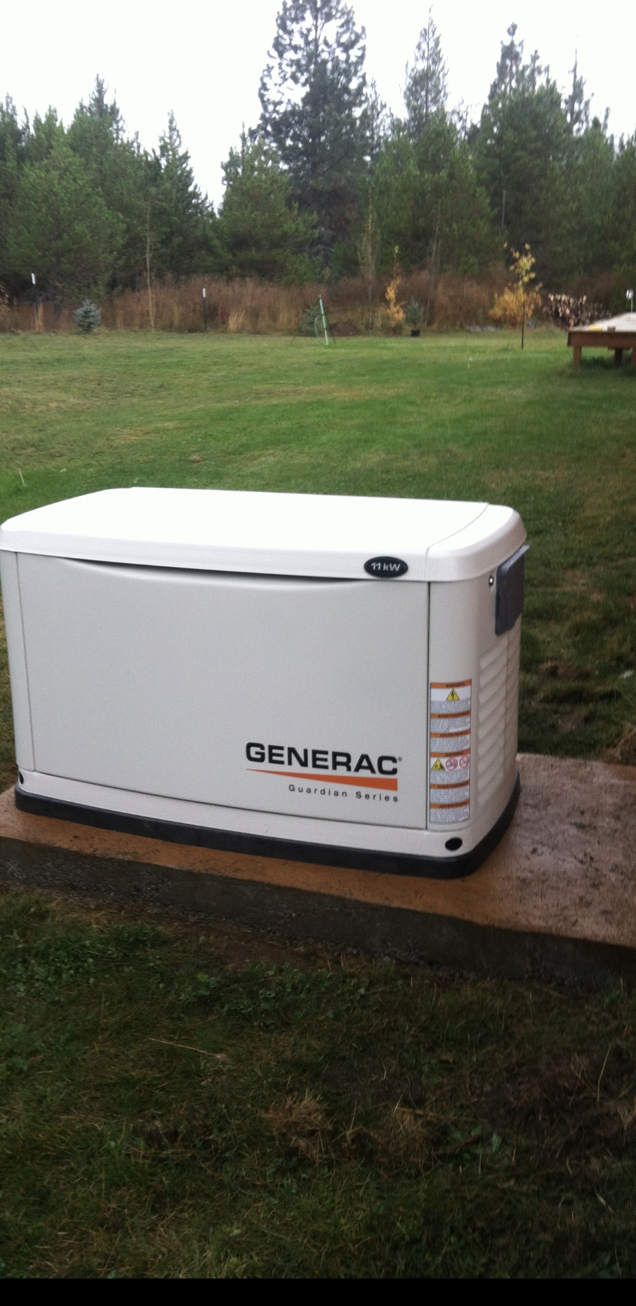

510FAFF4-0F8A-4B1A-BD05-09A8D5A32CDB.jpeg First thing installed when we moved to the Ranch perminantly. An 11KW on propane fits all our needs.
One thing about power outages, they don’t happen on a sunny afternoon, it’s usually at 3:30AM during an ice storm or wind storm. The Genny is seamless, auto on and off. Money well spent

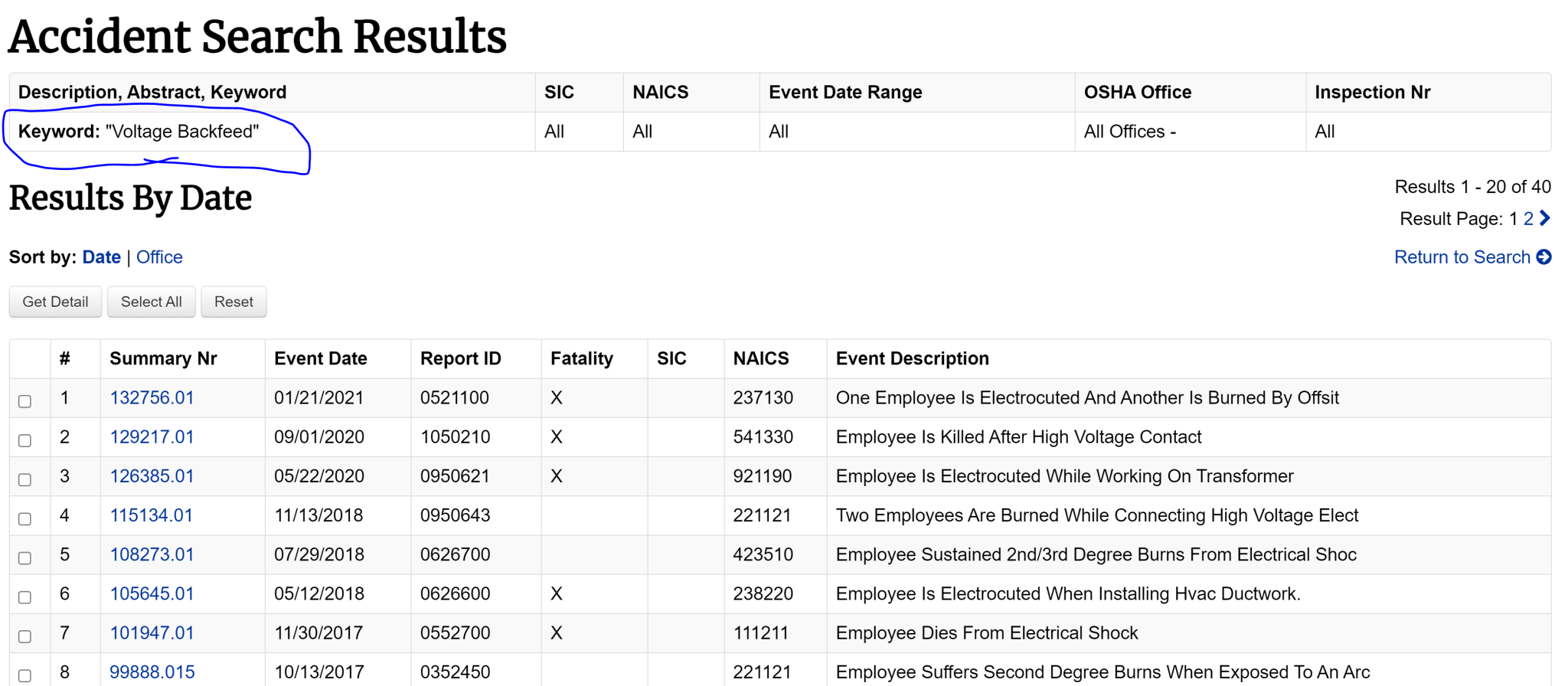

Yep, some people are cavalier with other people's lives
From an OSHA review:
... After Green left, Adams went up in an insulated lift to repair the damaged lines. Three of the lines (the neutral, the road phase, and the field phase) were broken. The fourth line (the central line) was sagging but intact (Tr. 61). Although Adams could have repaired the sagging central line without splicing it, he chose to cut the line. The line on which Adam was working was connected by a secondary line to a house at the end of Jackson Street (referred to at the hearing as “a doctor’s house”). The homeowner had connected a portable generator to the house’s circuitry which caused electrical energy to backfeed to the line Adams was splicing, energizing it. Adams was electrocuted when he cut the line (Tr. 40, 95, 222, 269). The company has no written work rule requiring employees working on de-energized lines to wear protective rubber gloves (Tr. 40, 44). Adams was wearing leather work gloves, but not rubber gloves that day.
Florida:
Polk County, Fl
Wednesday, September 2, 2009 10:12 AM EDT
A Bartow electric department employee escaped a brush with death Monday night when a downed line he was repairing became energized by a homeowner’s generator.
Eddie Watson, an apprentice lineman, was grasping a line while wearing leather gloves as he worked to repair a line that was brought down by a falling tree in Monday night’s fierce thunderstorm.
When a homeowner whose house was served by the line started up a generator, it sent a surge of power through the line, Interim Electric Dir. Eschol Radford said.
The electricity went through a transformer, stepping up the voltage from 110 volts generated by the generator to 7,200 volts, the transmission voltage. Usually, the transformer does just the opposite, stepping down voltage from 7,200 to 110 volts for service lines to homes.
“He was lucky,” Radford said of Watson.
“Fortunately, he had a young guy, Scott Harrison, a lineman helper, working with him. Scott knocked him off the line and probably saved his life.”
and if you would like to look more up:
