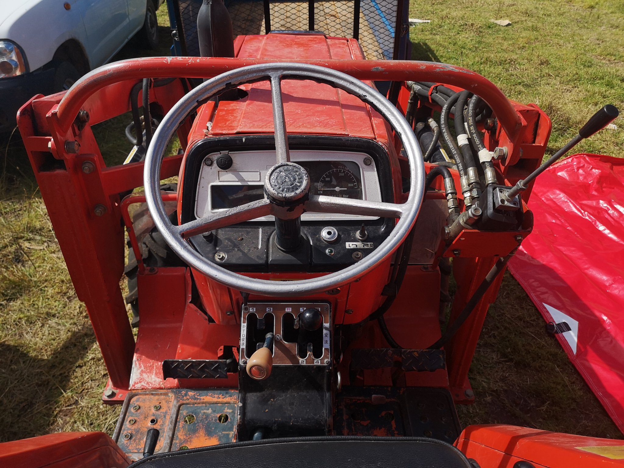

I think it is a L2002DT but not sure, or what year it could be. It is working fine and I am also trying to find an operator´s manual. The closest I have found is the L235-L275 but the controls are quite different. Here are some pix. Many thanks.

Thanks, I saw those pix too. Do you know how could I find out the year? (there is no plate on the tractor and couldn't find one on the engine either. And hopefully an operator´s manual in English? It's my first tractor with 4 wheels, I always used a BCS walk-behind.
What couldn't get a picture of the side of the hood?
As that is where it will say what it is.
It's of the sunshine variant, different controls and different lights.
Also if it is a L2002 it's probably a very early model or someone changed the muffler as that's a muffler off of a 01 series tractor.
You would need to know the engine size to know the HP of it and that will tell you the model number, or just look on the side of the hood.
You won't be able to tell the year specifically.
Kubota did
If it is a L2002 it was made between 1978-1985.
Tractors get their date when they are sold not made and there are no record of the grey units available.

I noticed from one of your pictures there does not seem to be a support going from the bottom of the loader towers to the rear frame. When you get ready to use the loader you might want to check it and be sure. Pushing into a pile of material without those brackets could cause damage.

Hey, many thanks for the tip. I did not know about them. How would I go about getting them?

Thank you for the info. I've been looking for numbers, any numbers, but could not find them (it has a K3-A on the engine, but that's it). I am doing maintenance before putting it to work (fluids, filters, etc.) and when I take down the sides I will explore the recesses. I am sure the engine is a D1302, so I assume it is the 20HP. As far as I know the muffler is the original, but can't be sure. I was kind of surprised with the 4 settings for the PTO, I had never seen that.

Thanks, they do look identical! Would you know how to get hold of an Operator's Manual?
The engine number is stamped on a flat on the Block facing up, just outside of the injection pump.
What does the hood say?
There more than likely will not be an OPS, (operator) or WSM (service manual) for that model specifically.
There weren't may done for the grey market tractors.
