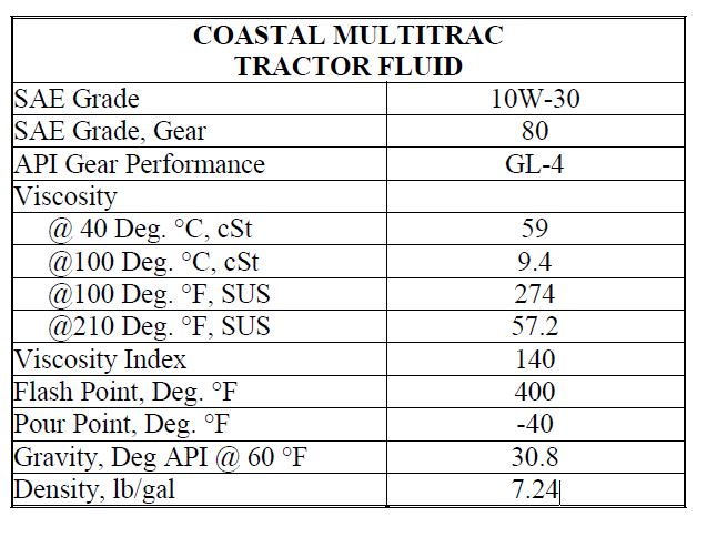

While costal is claiming ( and the tech support line, owned by them, backed up) that their fluid meets the same standards as Kubota UDT2 it's simply not true!
It's not even close.
It's your tractor, but don't be surprised if you have issues down the line.
Kubota Super UDT2 Synthetic Universal Trans-Hydraulic Fluid (1 Gallon)
  • Gravity, degree API: 34.5.
  • Viscosity @ -40 C, cP: 16000.
  • Viscosity @ 100 C, cSt: 8.1.
  • Viscosity @ 40 C, cSt: 37.
  • Viscosity Index: 199.
  • Pour Point, C max: -42.
  • Zinc, % wt.: 0.1122.
