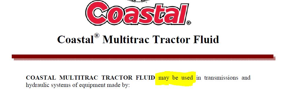

I don't think you're understanding what I said, and it's not opinion based it's fact based:
Even their PDS sheet does not say it's compatible, it says it may be used, that's a big difference.
I guess it's really a mote point as it sounds like your mind's made up no matter what anyone says.
And just for clarity I've worked on may a kubota that has had " compatible fluid" in it only to have it cause some major damage or severely affect operation of the tractor.
Sounds like you don't have an open mind and your opion is just that... you don't know... Have you seen an independent lab comparison?
What makes you think Coastal is cheep quality, and that no other company can make a quality hydrophilic oil?
Warren Oil Company
makes oil for most other oils brands like STP etc...
Just saying Kubota is not the only quality brand out there in case you don't know. I printed there pdf which stated ubota UDT and Super UDT.
In Kubotas own manual it stated use UDT or Super UDTII
it is over an hour drive to a Kubota dealership, and other quality brands are sold locally. like Coastal by Warren Oil Company. Warren Oil Company also make the exact same multitrac tractor fluid being sold by STP.
despite your opinion, I will post my finding and let you know if my loader lifts better and if my whining is quieter or not...
I would think some would say, let us know maybe the company does make it is a quality hydrophilic oil.

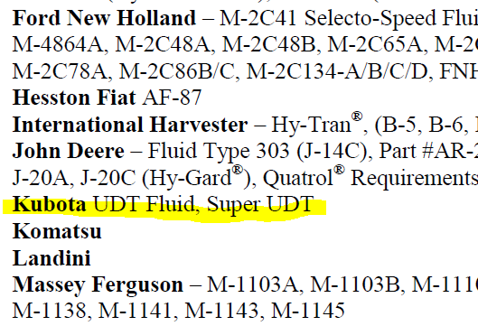

You stated that they claim their oil is equivalent to Kubota UDT and Super UDTII. Where do you see that it is equivalent? What are the facts that prove their oil is equivalent???
All their jug has is a list of manufacturers oils and I doubt that a small oil bottler has oil that meets all the manufacturer's specs.

According to Kubota, no one has a hydraulic oil that meets Super UDT II.
I see nowhere in Costals write up does it say that its oil is equivalent to any other hydraulic fluid. Costal is just implying that you can use their oil in place of the others.
Why would you skimp on oil or filters????

While costal is claiming ( and the tech support line, owned by them, backed up) that their fluid meets the same standards as Kubota UDT2 it's simply not true!
It's not even close.
It's your tractor, but don't be surprised if you have issues down the line.

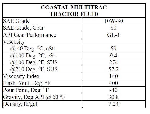

Kubota Super UDT2 Synthetic Universal Trans-Hydraulic Fluid (1 Gallon)
  • Gravity, degree API: 34.5.
  • Viscosity @ -40 C, cP: 16000.
  • Viscosity @ 100 C, cSt: 8.1.
  • Viscosity @ 40 C, cSt: 37.
  • Viscosity Index: 199.
  • Pour Point, C max: -42.
  • Zinc, % wt.: 0.1122.
I’m not sure how I could look at these physical properties and still come away thinking these are the same thing. (well unless I had already bought a truckload and was trying to feel better about it :oops:)
the company has been great in getting back to me with the information that I have requested.

I have a very open mind, and I'm not using a bit of opinion I'm using engineering specs as the facts.
I can read and understand a PDS that point out it's not the same.
You're being extremely argumentative, rude, and yelling at people (yes multiple people, that have answered your posts) that have worked on thousands of Kubota's for years and I really don't understand why. :unsure:
I never said that coastal was bad, or cheap or anything of the sort.o_O
I'm just pointing out the FACT that even Costal does not say it compatible... and that the physical characteristics of the fluid are different even by coastal's admission, they never say compatible they just say you may use it.
If your having loader performance issues on Kubota stock fluid, it's more than likely not the fluid that's the issue, there is some other issue affecting its performance, like a pressure relief valve, and clogged filter, a failing loader cylinder seal.
FYI: I don't even use Kubota UDT or Super UDT2 in my tractors, why, because I have a much easier to acquire alternative, that yes does have the same specs as UDT, it's got specs closer to SUDT2 but is not a full synthetic.
