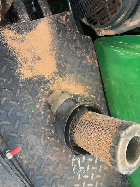

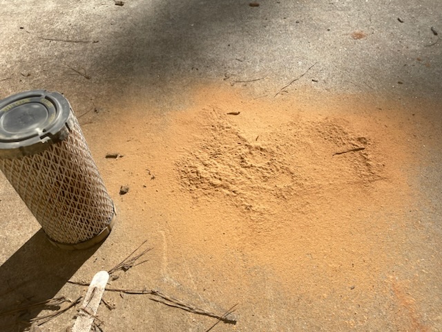

Infield dirt, from dragging ball fields. It’s the consistency of baby powder.
I have to wonder what the engine oil is like with that stuff being sucked into the engine. :oops:

That is on a John Deere 1200A bunker rake. We use them to prep our ballfields.
Almost nothing should pass thru the filter, you have a serious problem with the filter assembly. Either the filter media is compromised or the housing has a problem. I would bet that considerable engine life has been lost.

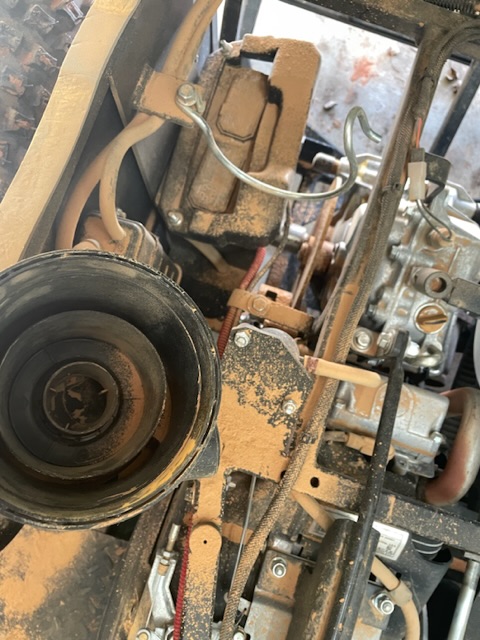

Oil actually wasn’t terrible. I did hose down the intake stem while carb was in the ultrasonic. It was covered in dirt also. Spark screen in muffler was clear, which I found a bit odd.

You are probably correct. I’d bet the last guy to knock/blow the filter out, didn’t put it back on correctly, clamp the lid right or something. Everything looked ok when I was disassembling, so who knows.

You will know in a few hundred hours when the engine starts to burn oil. From the look of the carburetor, there is no way that the engine didn't digest a lot of that dust, which will act like sandpaper on the cylinder walls.

I agree. I'm just the messenger/part swapper.

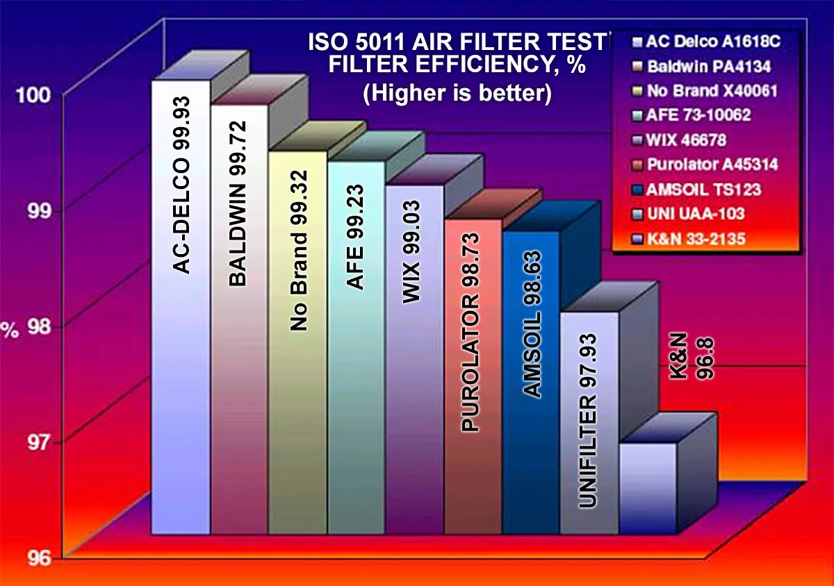

I've run a K&N oiled cotton filter on my Jeep TJ for many, many years and sometimes wonder if that was a good decision. I check the oil regularly when I'm using it and it barely consumes a drop between oil changes. I ended up buying a K&N "sock" to slip over the conical air filter in the summer months due to the road below me generating a lot of dust (until it's treated with MgCl) and the dusty conditions on some of the trails I go on. Perhaps more money down the drain for a couple of extra hp based on a good marketing campaign.

K&N "filters" are absolute junk, they have no place on any engine, especially a tractor.
