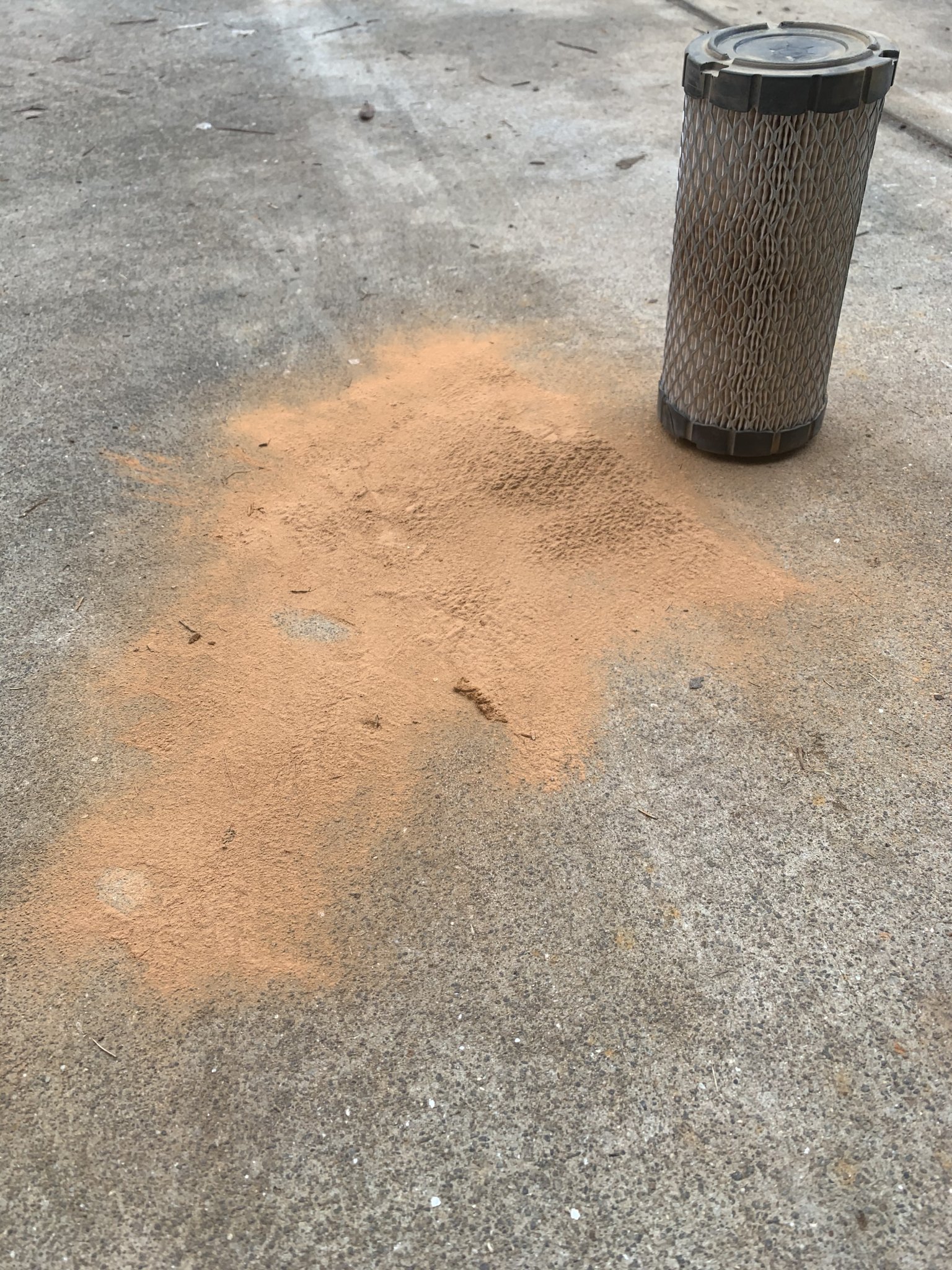

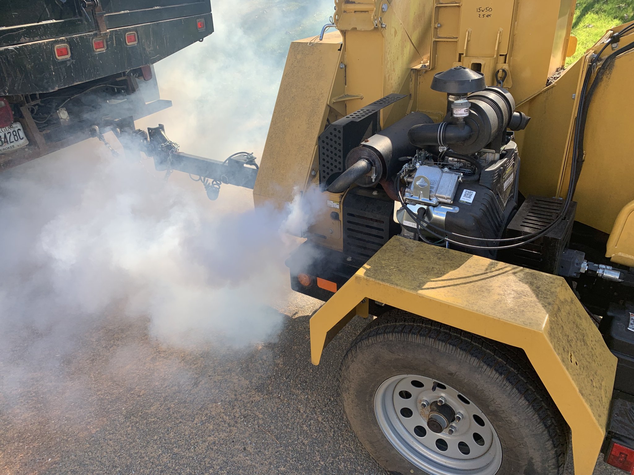

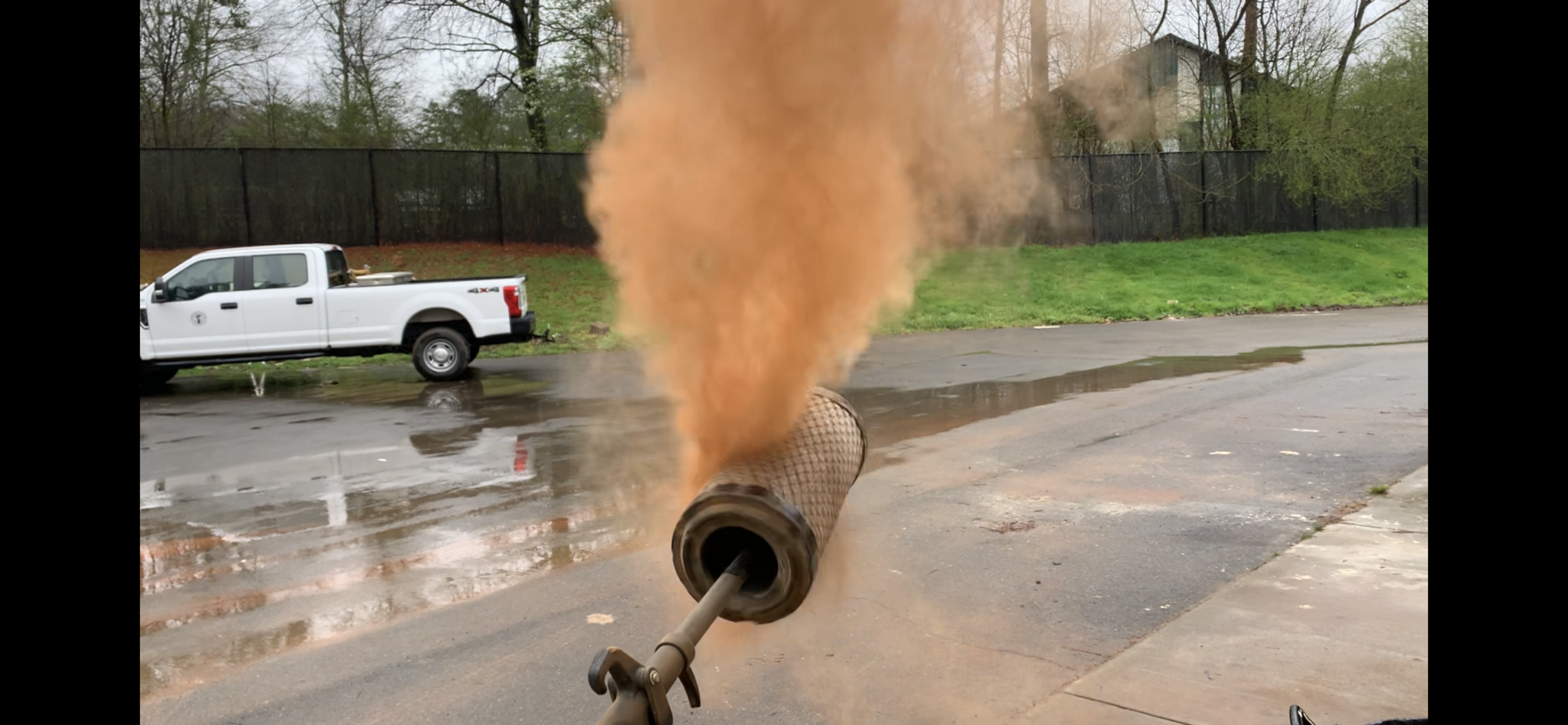

They work well. This is an extreme example I believe. This filter was off of a JD 1200a bunker rake. We use them for dragging ballfields. The guys don’t blow them out, like ever. I was just tapping out before getting the blow gun. This came out of another unit.
