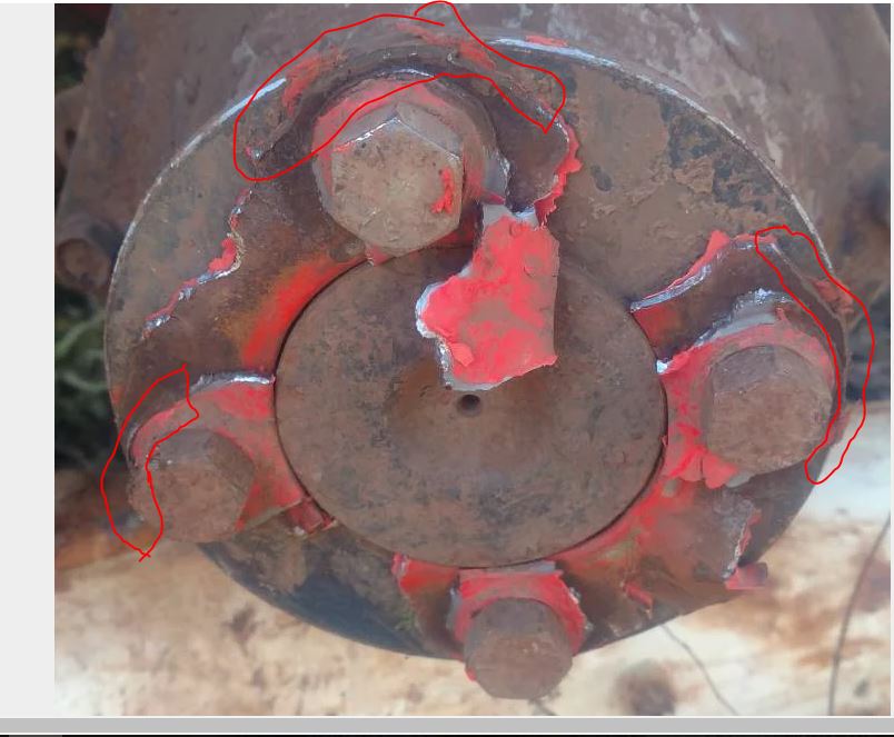

975 hours...I'm guessing it's because we added tubes to the front tires...instead of breaking the bead on the tire this happened...as my friend said...you reinforce one thing and something else in the chain will break...

this looks as if the machine was dragged sideways, looking at how the rim is sheared away......
aint no tube or whatever caused that !

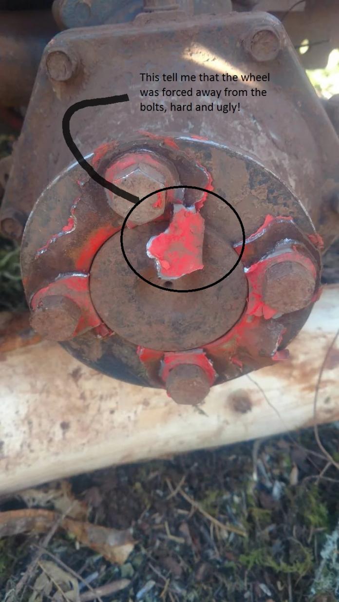

Looking at this a little closer........
THIS would be a hellva lot of stress....not sure how it could be done and NOT know something was wrong!

Maybe the loader was full of material and a sharp turn was attempted going a too fast and wheel separated from the bolts.
No matter how it happened it has absolutely nothing to do with tubes installed.

When were the tubes installed and were the lugs torqued when the wheels put back on?
9,066
4,544
That's what I was wondering as well. If some of the lug nuts were loose, with weight in the bucket and a turn. Maybe something putting some force on the side of the tire at the same time. :confused:

Tubing a tire will not cause a tire to break, it's the same pressure and force as just putting air in the tire!

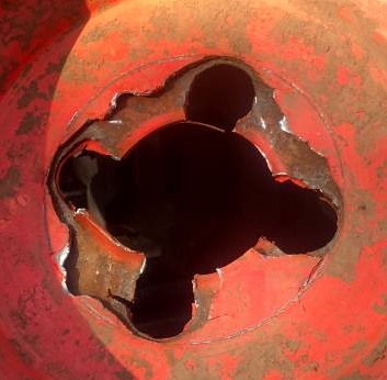

look at the picture of the inside of the rim, the 2 halves of the rim is not separated.
This kind of failure is a stress failure from turning hard, turning fast, turning and hitting objects that don't move, turning on a hard surface with a load on the tires.
If you look at the picture of the hub, you can see rust on the outside edges of the breaks just outside the lug bolts.
I'm also betting if he looks on the other rim he will see the same cracks.

I didn't explain myself well enough, my point was: If the wheels were recently removed to install tubes they may not have been properly torqued back on. The front wheels on the BX2370 call for 110 to 132 ft-lbs, anything less would certainly expedite the type of failure you described.

You are supposed to check the tire and fell bolts every 50 or so.
The rust pointed out by niw shows that they were loose at one time cracked and rusted out.
So the poor neighbor was the unlucky one to have it break on him as the camel was overloaded and he was the last straw.
So everyone neds to check their bolts tonight.

10,349
